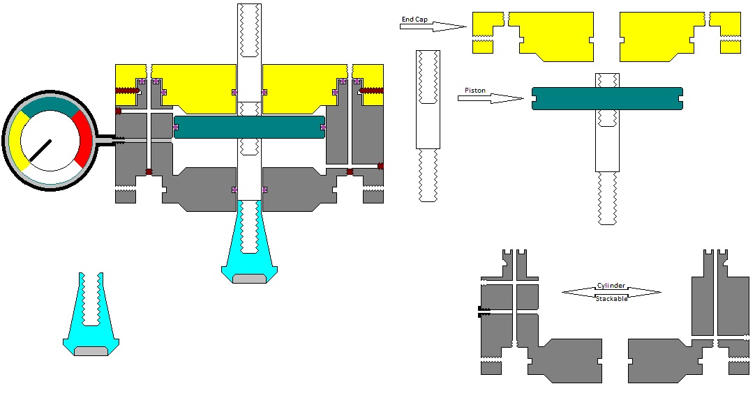

Hi All a different question from me this time, I currently use Mach3 & Vcarve Pro as my main CNC Mill software Combination, Now what would you suggest for my CNC lathe to go with Mach3....
I would like something as intuitive as Vcarve if at all possible...:confused:
Attachment 4383
This will be the first major project but as you can see it is only a concept drawing at the moment.:idea:
I will of course be doing some simple stuff first to get used to the software you help me choose...:naughty:
So the question is if you use Mach3 on your lathe what software do you use with it..

What is the part you've drawn for? It looks simple enough to do an a manual lathe...

It is a simple air ram for my ATC but the main body needs to be repeatable to a resonable level of accuracy. Its a Stacking design
the more pressure you require the more cylinders and pistons you bolt on..

I see, that explains a lot.
Clearly it depends how many you need to make - there's no reason for it not to be precise on a manual lathe...just obviously takes a bit longer.

I think i could make 1 no problems but a few of my friends have seen my ATC plans and they all want one so i just dont have the time to stand there pushing them out..
