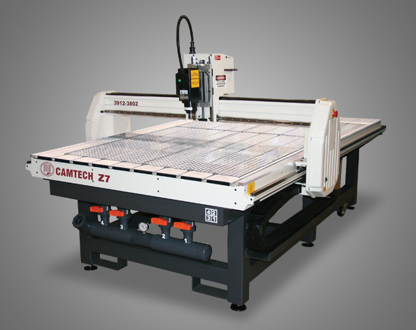

I am in the process of designing the bed for my CNC machine and would appreciate any guidance regarding frame dimensions and material choice.
My plan is to weld a steel frame together with 10mm * 50mm plate welded to the sides of the upper rails, which will then be milled by a local machine company in readiness to accept the linear guide rails. They have quoted £800 to mill the side rails and drill all of the holes.
Their machine is super accurate and will ensure that the rails are 100% parallel and level to each other, resulting in super accuracy. Whilst £800 is expensive it will save me the headache of getting the rails aligned
My plan is to base it on the axyz 4000 series machine as shown below.
Attachment 4739

If it's mainly for wood then that sort of accuracy is not going to make an appreciable difference. £800 sounds a lot ... invest it in profile rails etc. How can you be sure that after the frame has been machined when you fix it to the floor it does not distort.
Getting the rails parallel is not a problem - once you have the gantry mounted and put a couple of bolts in one rail the other will self align. Either that or you can use a DTI to align them by affixing it to one carrage with the needle against the other rail.
Another way to get them parallel in the vertical plane is to mount them on (the right type of) epoxy. Pour the epoxy on the rail mounting surfaces with a channel (or several channels) in between and gravity will level it 'automatically' with very high accuracy.

80 x 80 x 6 box section can still distort. The size of the machine you are building will be rather heavy, 80 x 80 x 6 box section aint light. Unless you level it very well it will still move. If you decide to bolt it down then make sure it is perfectly level on its feet or you will pull it out of alignment with the bolts.
Yep, anything will distort. It's a matter of how much and the effect it has.
Heavy frame = good, as long as you don't have to move it!
For a machine purely for woods it does seem a bit excessive, however you seem to want to use it for milling aluminium too in which case it pays to make it as strong as you can.
What sort of tolerances do you require as that it what determines if machining the rail surfaces perfectly parallel is necessary? You can compensate for it perfectly well in software.

Ideally, I would like to have an accuracy of at least 0.05mm. Worst case scenario I could stretch to 0.1mm, but no worse

Hi Ian,
Completely agree it's not neccesory to spend £800 to get the machine you want.
Regards your question of do they setup professional machines on site then yes they do and to a very high degree taking a great deal of time using very costly precision levels etc, also they are bolted to the floor more often than not on shock dampening feet.
Obviously good build quality is required but Setting up the machine while in situ is the key to an accurate machine, time taken here will make or break the machine.
The heavist machines built from quality cast iron still bend and twist requiring carefull leveling and setup so don't think for one second 80x80 is substantial and won't move or require setup.!. . . In real machine terms it's banna material.!!
Also regards Epoxy, Yes it will self level to a high degree but it still requires the machine to be fixed and levelled to high degree before application and will only be accurately level to that one spot.
Basicly what I'm saying is if you want good accurecy then Yes 80x80 will do what you want it to do and with good build quality and attention to detail will give the accurecy you require but the machine needs to be fixed down with adjustment built into the design.
If good strong design with carefull welding and attention to detail is used, mixed with very carefull setup then you will easily surpass the accurecy you desire without having to spend £800 on surfacing.
£800 would be far better spent on using quality components.!!
