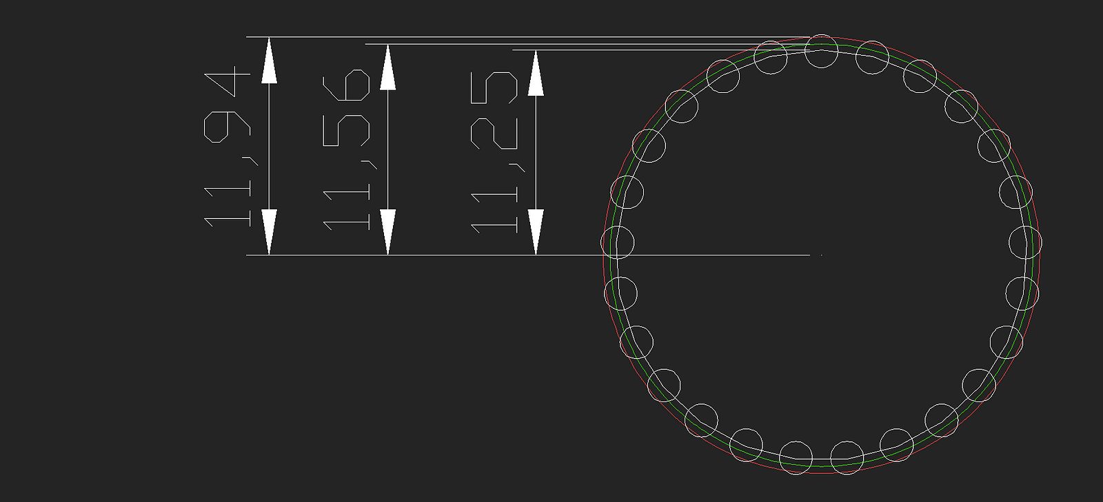

I like this idea a lot, is there a method to calculate the hole sizes and position around the edge?
I did like this:
number of holes multiply by the pulley pitch
25 x 3mm = 75mm circumference of pitch circle
so the radius will be 75/2 x 3.14 - it's not the pulley diameter which going to be smaller
Attachment 4888
The hole between teeth diameter is 1.8mm in case of 3m HTD pulley
From the radius length previously calculated subtract 0.691 mm (as per pics above)
11.9366 -0.691 = 11.2456mm radius of circle where you drill holes
In any CAD program draw polygon which number of sides correspond to the teeth number inscribed in circle of diameter previously calculated (11.2456mm - in my case)
Place circles of 1.8 dia in a peaks of polygon
and now the resulting ring of small circles is a pattern for cnc to drill
Hope I described it logically :smile:
I'll try to upload some drawing later

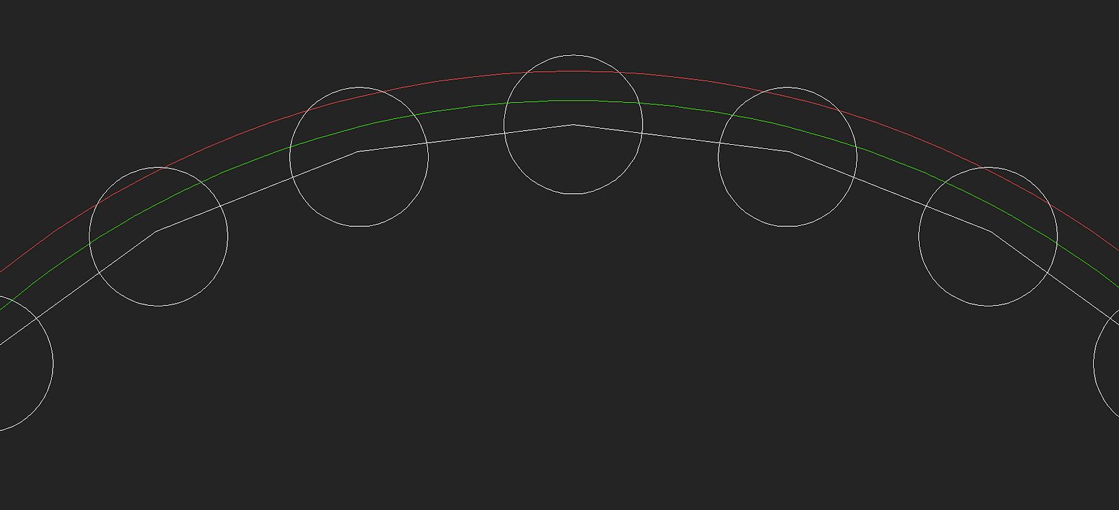

That's an actual drawing of my pulley
red circle is the pulley pitch
green - pulley diameter which i turned down after milling + filing to chamfer an edge
white polygon inscribed in circle of 11.2456mm
Attachment 4891
Attachment 4892
That's the way I did it, but if you have Gearotic it will draw you nice pulley shape- that's easier way, but for my curiosity and making my life more complicated I troubled myself with all the calculations :rofl:.

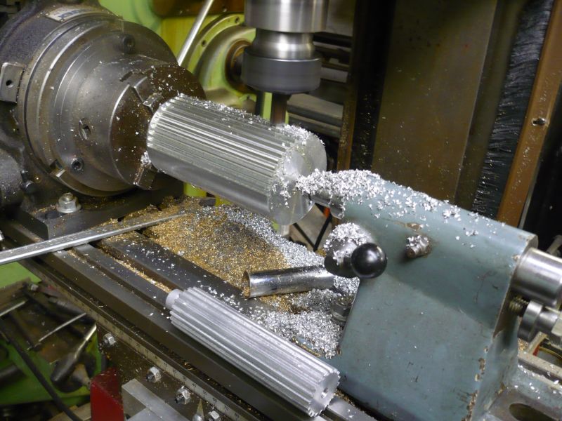

Doing a stack at the moment.
These are 5m's
Attachment 4981
And the finished job.
Attachment 4982
5M's are a doddle, 1/8" ball nose cutter 2.16mm deep plunged in from the OD which you can get off the HPC website.
For 3M's you need a 2mm ball nose 1.28 deep.

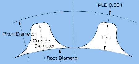

Calculations worked for me:
pulleys PCD radius - 0.381mm gives you pulley radius.
then cut depth if 1.21mm.
However I found slight dimensional variations for pulley dia /doc. I used those from pic uploaded

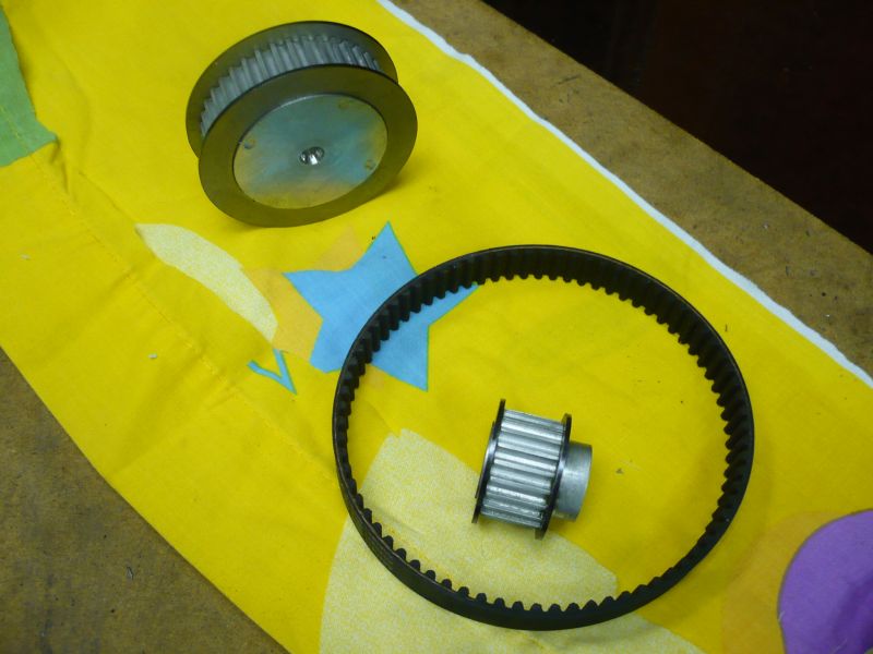

I have only done XL series pulleys, so trapezoidal not round. Looks like it's easier to get it right with HTD. Should start replacing mine on the router.
JohnS' makes mine look a bit amateur:
Attachment 4983
Attachment 4984
As those went on my router they've had a lot of use and the pulleys under where the belt runs has got polished. Same is true for the bought ones. I wonder if it's worth anodising them to harden the surface? Would have to be careful not to change the dimensions too much in the process.
