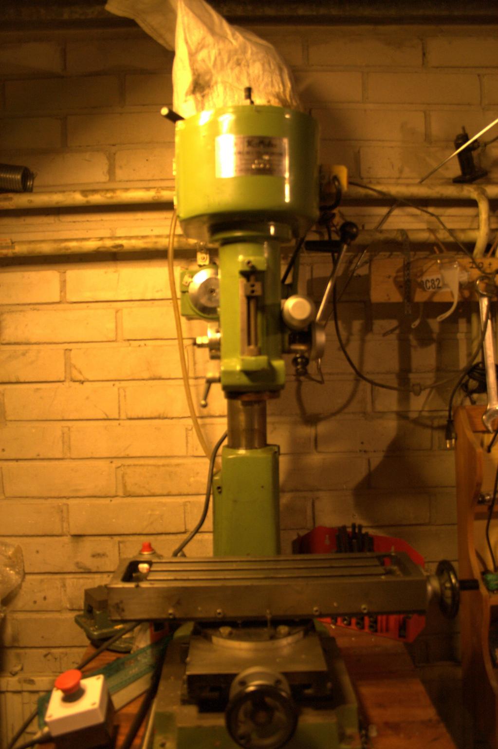

Subject of conversion in this thread is a mill from 1980's.
Attachment 5426
There are some underlying issues that I would hope to address during the conversion:
- huge slack on Z-axis (covered here in detail: http://www.mycncuk.com/forums/showth...g-a-conversion )
- large slack on both X and Y -axis
Have read as much as possible, trying to learn from other machinists build-logs. As a result, here is a draft shopping list

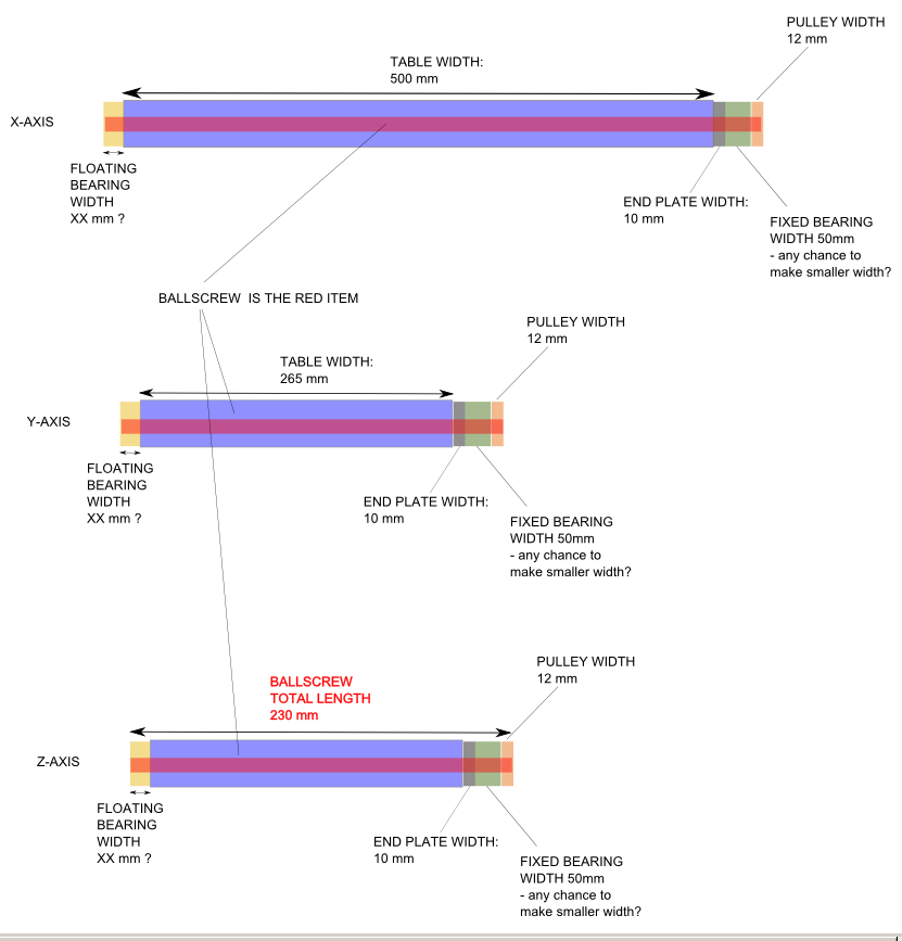

In view of the mill, please can anyone spot here
1) Something clearly wrong ? (something one would regret later?)
- eg. size of motors
2) USB vs. parallel port
- that is something I keep on thinking. Have read about arguments for / against.
- Kind of would like to go USB, but I have read parallel port is the right thing to do.
3) Cables and sundries
- worried about little bits missing from the list. (trying to buy all in one go, to save on shipping fees)
For now I have left out from shopping list "pulleys" and "belts". Hope could have this machine running some day, then later add belts/pulleys. Not sure how this conversion is going to turn out, will it run or not.

The proposed set up looks good for a backlash of around .015 -> .025mm if you get it right. Plenty good enough to remake the machine after the screws bed in and .025 mm start to hack you off, which it probably will :smile:
A stepper does 400 half steps per rev. A 5:4 belt reduction on to a 5mm screw would give you 0.01 mm per half step, add one microstep for .005 mm and it becomes credible. You could reduce it 5:2 and avoid the springy microstep but that could seriously affect your rapid at 36 volts.

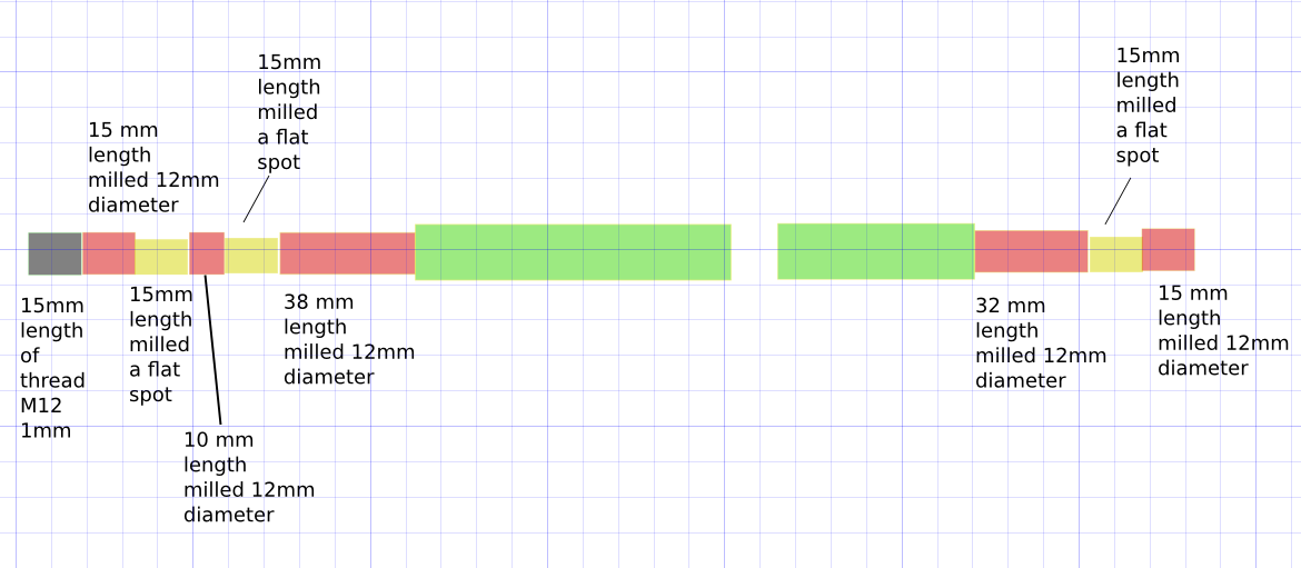

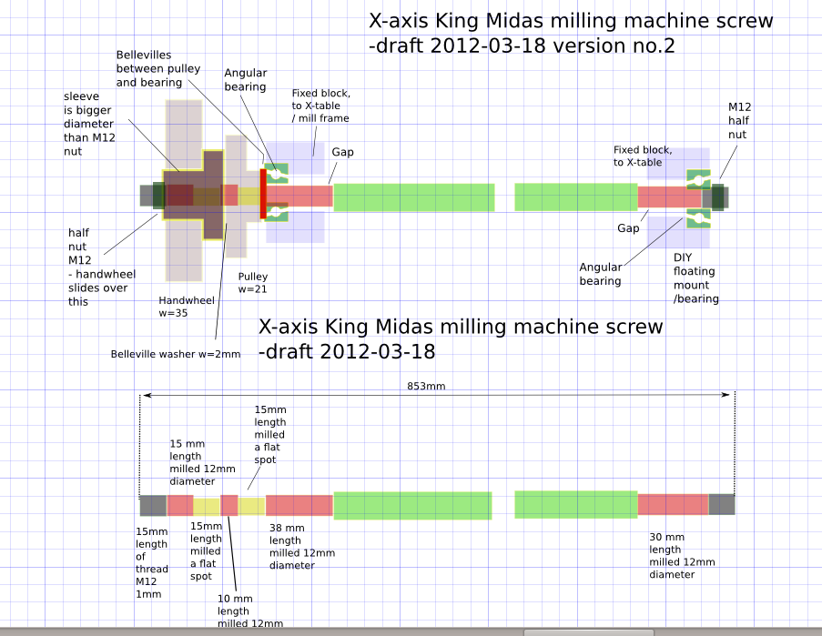

Here is a new draft of the ballscrews. Lengths change a bit, from going to pulleys/belts instead of directly driving the screws
.Attachment 5442
Re: King Midas mill conversion
A ball screw is best held in tension by Belleville washers to compensate for thermal expansion, one thrust race at either end.
If you lengthen the XY shafts at one end you can keep the handles.
Run the table to it's ful travel and ask yourself where the CNC parts are going to fit in the available space.
Experience tells me that being new to this you are very unlikely to believe this is necessary. You feel a compelling desire to see it cutting, don't want to go back to the drawing board now and spend extra money on machining screws. I only mention it so I can say, "Told you so" later on :naughty:

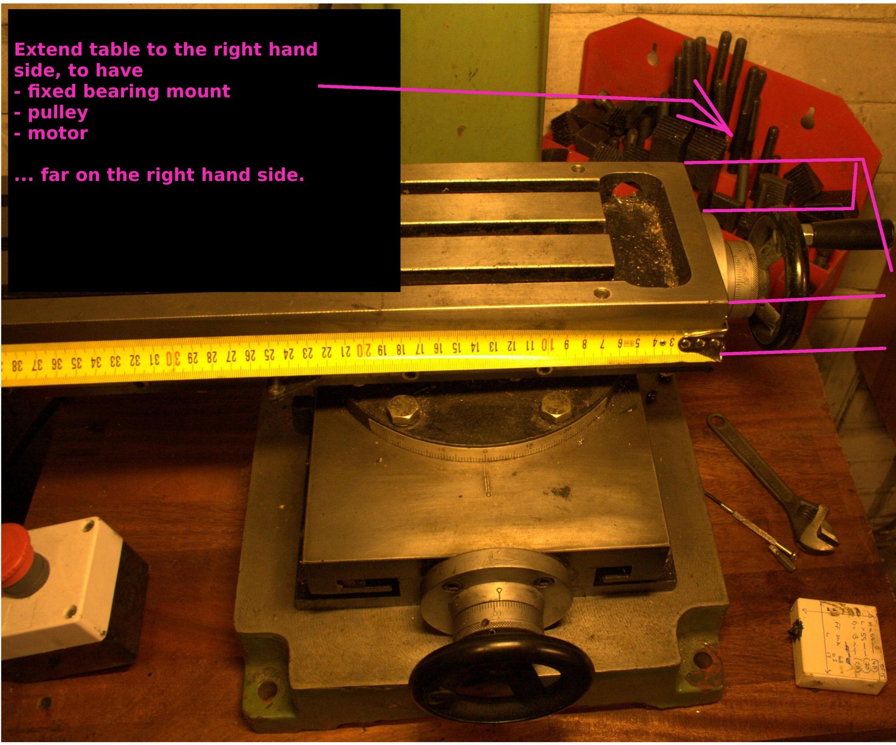

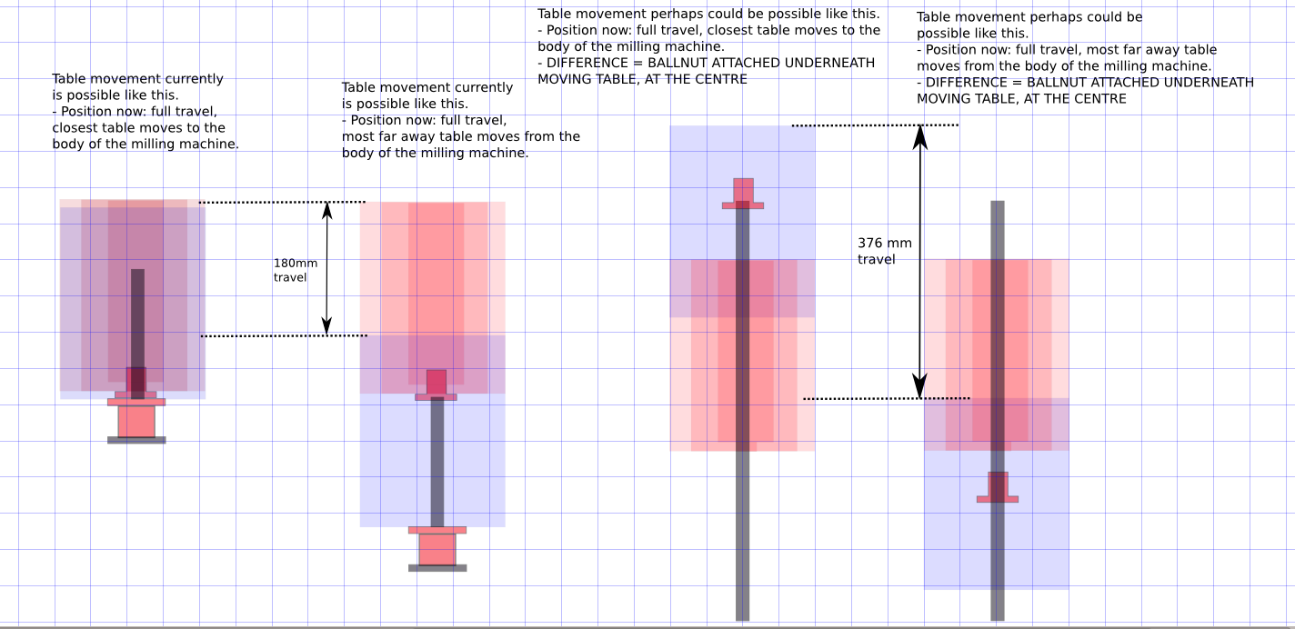

Yes Robin, back to drawing board it is. Really appreciate your advice, glad I didn't yet buy wrong length ballscrews. :smile:

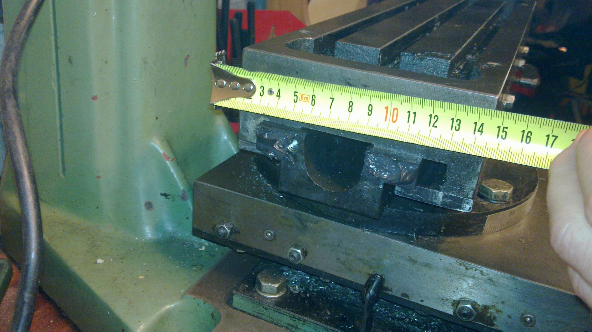

Went to garage, moved X/Y -axis back and forth full travel. Need to lengthen the ballscrews, pulleys would now crash to the table.
Not only that, but realized that it might be possible to extend X/Y -axis travel a good couple of inches, with minor changes.
- Had not really thought, where one would fit the ballnut, and where screw would be mounted. (attach ballnut to upper part (the one sliding), or lower part vs. the other way around, that kind of things)
- Below is a sketch of the Y-axis movement (current vs. possibly future). Changes would be: 1) a longer ballscrew; 2) attach ballscrew to the table that does not move; 3) attach ballnut to the table that moves, at the centre.
Attachment 5443
This is all new to me. Thanks will look for pics from google. Another thing I don't quite understand yet, is the construction of the "fixed mount" for the ballscrew. (still thinking whether to buy ready made, or DIY).

diy-john
Wow! If you are okay to take advice you can make one hell of a machine. I got it right on my third set of screws when the penny finally dropped.
Problem is, you need a CNC mill to make a pretty CNC mill which is why I was suggesting you cobble something together first. Hope you have a lathe, really do need a lathe.
I used pairs of Belleville washers to apply a preload of 500 lbf. One pair for each screw to hold the axial bearings in tension, one pair for each double ball nut.
That means there is no play in the system, apart from the column bending, so long as the load does not exceed 500 lbf. It was a lot of work but is quite delightful to use and all self adjusting.

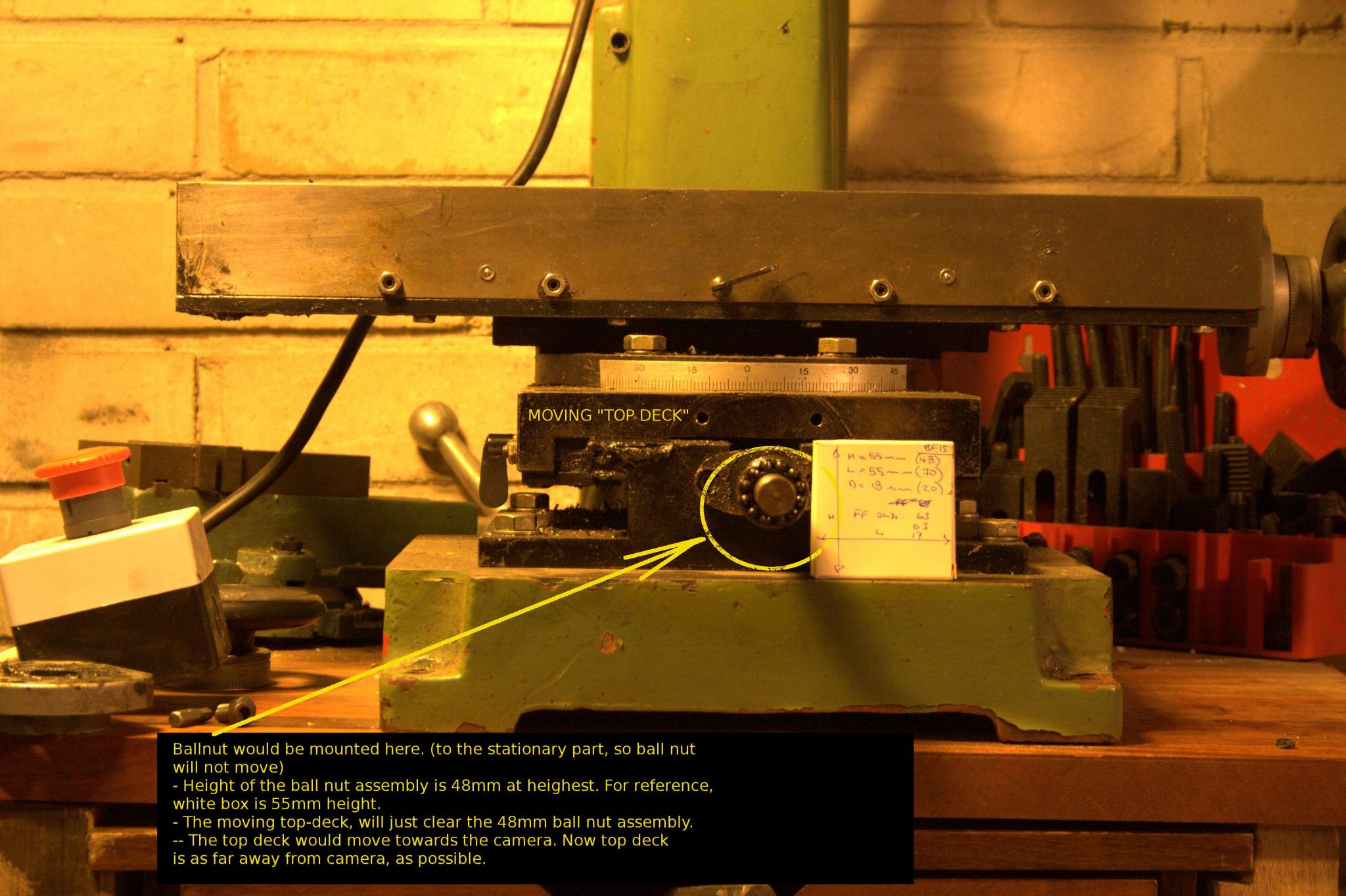

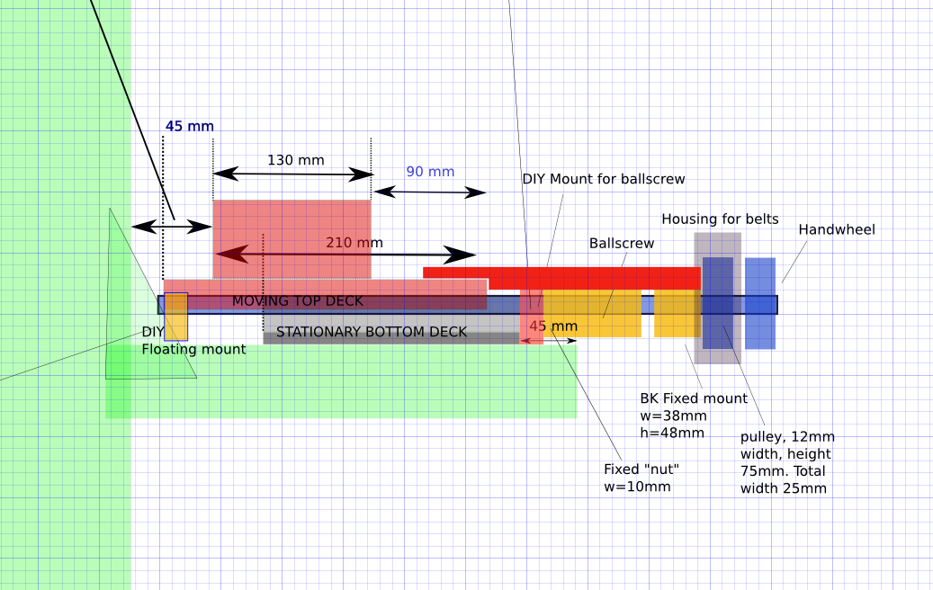

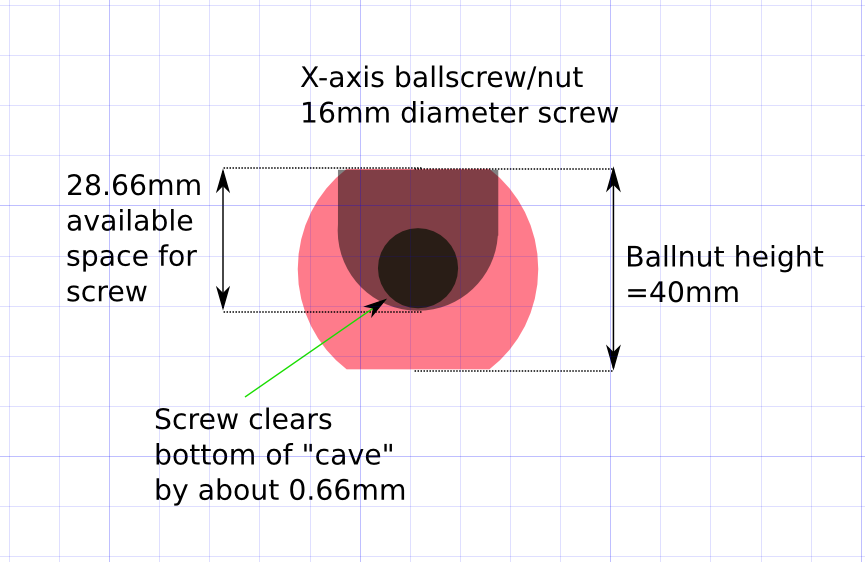

King Midas conversion last couple of days has been measuring + and thinking how/where conversion related components will be. From all your comments, I have realized how distant my thoughts have been from this project. Feel one has been watching this project sort of from cloud -level, but now there is need for much closer look. Exciting.
1) Y-axis ballscrew -related
1.1) Ballnut would be attached to "lower", "stationary" bed of the mill. (view from front of the mill)
Attachment 5448

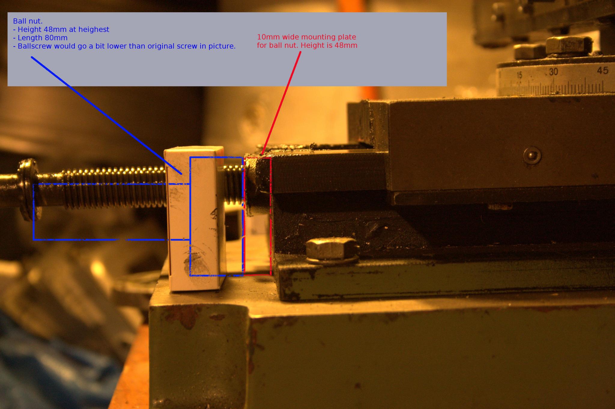

1.2) Y-axis ballnut would be attached to "lower", "stationary" bed of the mill. (side -view, from right hand -side of the mill)
- white box, height is 55mm, width is 18mm (for reference only)
Attachment 5449
1.3) Overview / sketch of Y-axis ballscrew (side view, from LEFT -hand side of the mill)
- colours have no specific meaning, just different colours for different components
- length of ballscrew is now at 508mm. (note how it has grown, initially one was going to buy a 346mm screw...LOL)
Attachment 5450

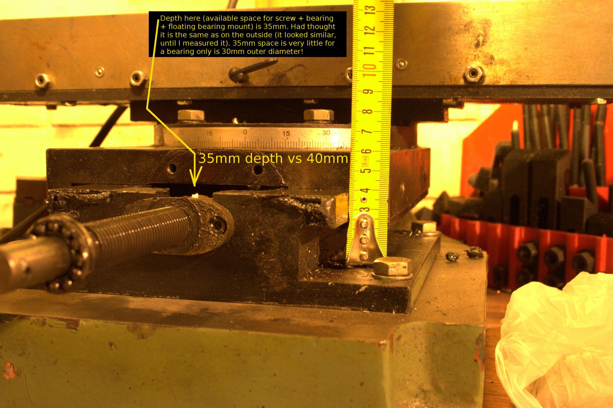

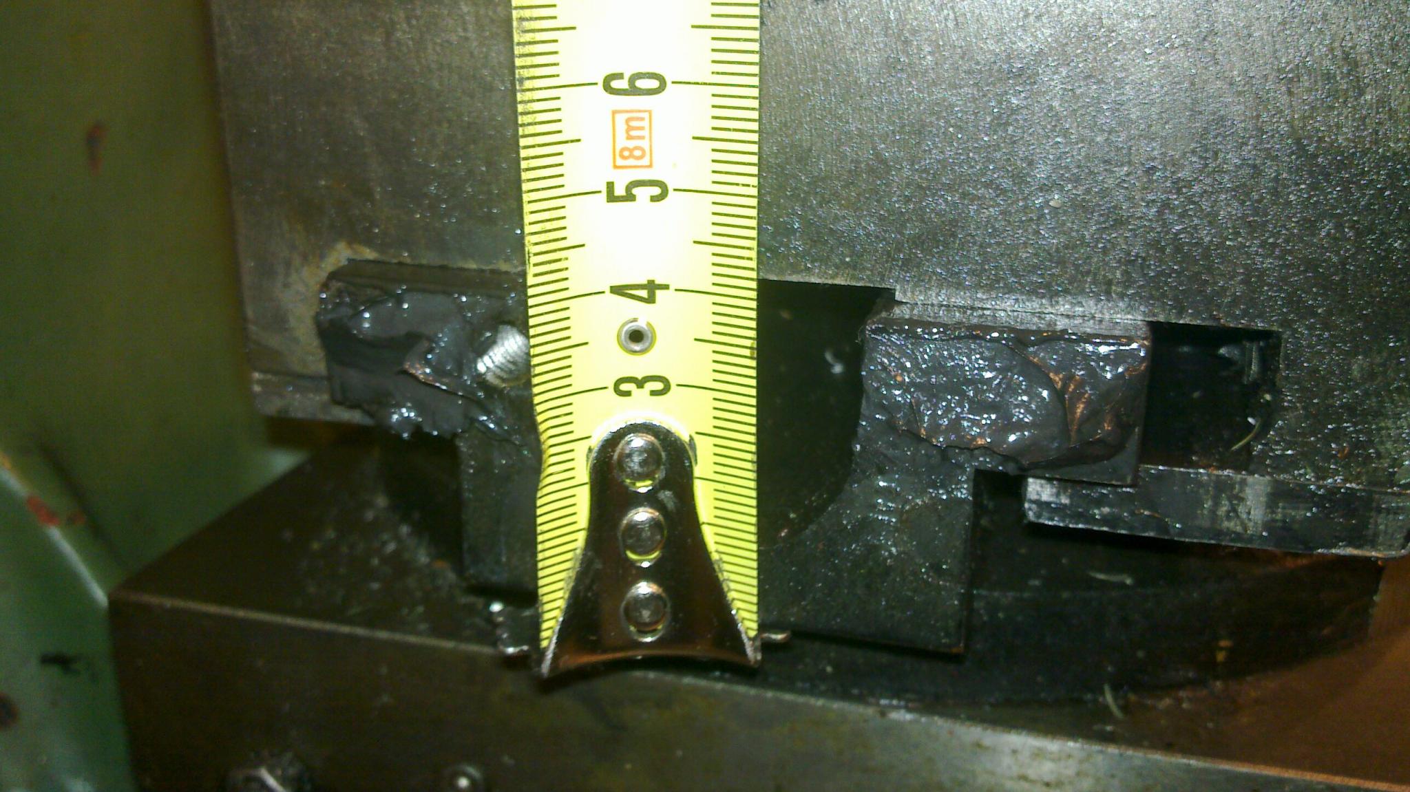

1.4) A challenge in Y-axis ballscrew is a 35mm vertical space here
- thought initially there is 40mm space, since the "cave" bottom looked like level with "outside" (see picture attached)
- need to make DIY "slim" ballscrew floating end-mount. Haven't found a slim-enough ready made mount.
- SKF 7200 BEP bearing outer diameter, for a 16mm diameter screw, is 30mm
- Would mount screw to "moving upper deck".
Attachment 5451

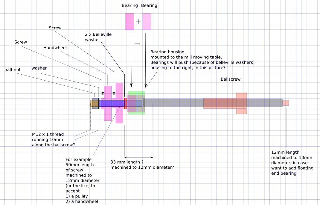

I haven't got a lathe yet. Tool/workshop -wise I am in the wrong league. Looking to do premier league, but my skills/tools are only 5th division. But thanks to this forum and careful planning, maybe this game is possible..

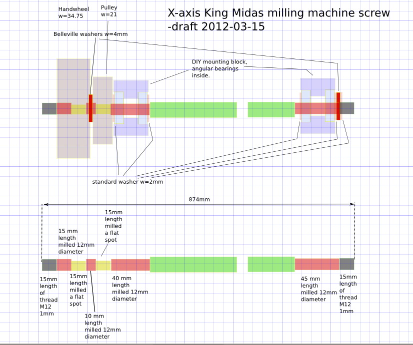

You will need to get the ends of the 16mm screws turned down to 12mm and partially threaded 1mm pitch.
Watch out, 12mm single row, angular contact bearings don't have dust shields, you will want to bury them in grease.
You can't use double row bearings with shields because they aren't crushable.
This is how I built up my Y screw assembly...
I put on one bearing
the aluminium mount that bolts to the machine
then another bearing
then a pair of Belleville washers
then the pulley
Robin, tried to understand how things would go on the ball screw. Now, this is getting to the far edge of my knowledge, this is all new.
Made a sketch of how I have understood:
Attachment 5459
So, starting from the right hand side, in the picture, requirements for machining screw:
- Machine 12mm length of screw to 10mm diameter (if want a bearing at the far end of the screw). Moving further from right to left, add
Robin Hewitt
<--- 1 bearing, shaft=12mm, OD=32mm, W=15.9mm, like this http://3.bp.blogspot.com/_3D8MX6Q_YG...G_0326+sml.jpg so machine ballscrew width=15.9mm diameter=12mm
<--- For this, machine 3mm length of ballscrew diameter=12mm. Bearings will go mostly inside this mount(?)
<--- machine ballscrew width=15.9mm diameter=12mm
<--- like this http://www.trakar.com/spring-trainin...rings/disc.jpg machine 2mm length of ball screw to diameter = 12mm
then the pulley
<--- machine total width of pulley (eg. 25mm) diameter = 12mm + flat spot
then a stepped iron sleeve to carry the indicator dial and the handle
then a 12mm half nut
<--- machine a thread M12 x 1mm to the end of the screw, perhaps for a length of 10mm
OR: machine the screw like this:
http://www.slidesandballscrews.com/images/machining ball screw-1100mm.jpg
- Except no.1 : that there would be a longer piece of screw machined to 12mm diameter (perhaps 35.8 mm length instead of 23mm in picture, to allow 2 x bearings (30.8 mm) + bearing housing (3mm) + belleville washers (2mm) = 35.8mm
- Except no.2 : Make a 12mm "flat spot of 50mm length" (to take pulley and handwheel)
For now, this project focus is trying to understand requirements: how / to what specification machine ballscrews.
Please comment!
Thanks!
Can you read an AutoCAD .dwg or .dxf? My drawing is a bit chaotic but it's al there if you look hard enough. I draw to get the dimensions then draw individual pieces for cutting.
I have lots of 12mm Belleville washers left, the minimum order was generous. I can send you half a dozen for the three screws if you PM an address, may take a while to find them though. I may have some 16mm I used for the ballnuts, spec is at www.bellevillesprings.com
4 Attachment(s)
Robin, your offer is very generous, thank you very much. Will send you a PM.

Today thought better still check available space for X-axis ball screw.
- X -axis ball screw would have to go through this hole:
Attachment 5469
- The hole height is equal to 28.66mm, which sounds great when you think it is only a 16mm ballscrew to put in there.
Attachment 5470 Attachment 5471
- However it comes so close, because the ball nut height = 40mm, and the nut must clear the moving "top deck" (which slides over the ball-nut).
Attachment 5473
Think there will be only 0.66mm of air underneath the screw, if one will go for 16mm screw. (and if the screw really is 16.00 mm). Challenge is, that one can not move the ballscrew higher, because then the ball nut would not clear the sliding "top deck".
A bit frustrating perhaps to just measure and measure, when one wants metal chips and sparks to fly. But guess you really don't want buy ballscrews that are only good to post to classifieds section... so slowly it goes. :)
In most conversions of machines of this size that i have been involved with the ballnut between the X and Y needed to be the FSI of DFI type that has two fixing holes either side of the flange and 2mm lower profile than the standard FSU type.
This will get over you space problem.
Gary
Thanks Gary - Please do you know the "height" of the lower-profile ballnut, for a 16mm diameter screw (1605)?
- Have used 40mm in my calculations, thinking might have by coincidence already used a lower profile version(?)
- If one could get 2mm lower than 40mm, then it would be great yes.
With a bit of help from Robin, latest draft -version for X -screw is here:
Attachment 5475
Total length of screw now is 871mm. (it has grown an extra 290mm from the original plan).
Hope that "custom" screw would not break the bank. (don't know how much extra cost that machining will add on top).
- Have prepared to go "conventional" cuttings, too, if it becomes really dear.
- One facet: want to get the screws as good as possible
- Another facet: being a newbie at this, would be very, very surprised if one gets it right first time round. Not sure how much point there is in paying top money for ballscrews, only to want something else next month. Of course trying very hard to get it right first time, but have to be realistic.

The X screw is best held in tension, suggest you put a thread and one bearing at either end.
I have found 31pcs of the 12mm Belleville washers I used...
www.bellevillesprings.com pn: D2812215
You are welcome to half a dozen, just shout.
Looking at the drawing is seems over complicated.
If you want zero backlash and don't want any movement on the support bearing just go for a good quality FK12, the gten R1605 ballscrew and the R1605T3-FDID-P1
This is the link to the datasheet for the FDI and FDU type ballnuts and it is 34mm between the flats, so it is actually 6mm difference.
http://www.zappautomation.co.uk%2Fpd...%2FFDU-FDI.pdf
The ballnut is already pre loaded for zero backlash and has been tested on the screw.

Robin Hewitt
Made another draft of X-axis screw. Please is this any good now?
- added a thread to the other end. And also a similar "structure, a fixed mount" for the ballscrew. So there are now two such mounts, one at either end of the screw.
- there are two (2) screws in picture below, but it is the same one single screw.
-- The other one just highlights, what components would fit, and where. Like hand-wheel, pulley, shims, Belleville washers.
Attachment 5483
Not sure about the dynamics, kind of figured out, that with this setup, the Belleville -washers + half nuts at either end of the screw ---> would tension the screw sort of around either end fixed mounts. Please correct if you think one has mis-understood the principle.
Gary
Gary, the 34mm height ballnut gets me off the hook. Thanks for pointing out these alternatives. Will speak to you about other components.
Thanks!

To put the screw in tension you don't want to have pairs of angular contact bearings at both ends, as that fixes both. You need a pair of angular contact bearings at one end, and a standard deep groove bearing plus Belleville washers and thrust bearing at the other end to provide contact force for the tension. If both ends were fixed rigidly with angular contact bearings the tension in the screw would depend on the relative spacing of the bearing blocks and the length of the screw between them, so there's no way to set it.
By 'standard washer' I assume you mean an accurately machined washer with parallel faces. You don't need a washer between the ballscrew end and angular contact bearing as the bearing is most accurate resting on the machined shoulder on the screw.
That looks horrible. I'm obviously not explaining this at all well.
To put the screw in tension you just need one angular contact bearing at either end. The Bellevilles try to stretch the entire screw end to end. Adding more bearings just gives you an alignment nightmare. There is hardly any side loading on the screw to worry about, so don't worry. I used one bearing at either end of my overlength X screw and it was fine and dandy.
I used a pair of bearings at the handle end of my Y screw simply because I couldn't fit any bearings at all on the far end.
Not a problem for the X so I put one bearing at either end.
The whole she-bang should be sloppy, right up to the moment you tighten down on the Belleville's.

... and only one pair of Belleville washers, you don't want to balance the screw between two springs because that can move.
A few design tips.
I bolted the X screw pulley solid to the inner race. I sprung the sleeve that takes the handle at the other end. This reduced the bearing overhang I couldn't avoid on the Y.
Putting the handle on a sleeve means I can pop the handle off without detensioning the screw. Handy if I want to work on something that overhangs the end of the bed.
I mounted the X motor facing the unlikely way round and extended the screw to get clearance on it. This makes it a lot easier to mount, easier to change the belt and easy to pop a cover over to keep the crut and fingers out.
My X motor mount isn't actually bolted to the machine, it's free to turn. I was going to Loctite it in place but found the 500 lbf screw tension quite sufficient to hold it. I lean on it occasionally, if it ever moves I will know I have lost tension.

Please would this setup make the X-ballscrew dandy? (is this what you mean?)
Attachment 5500
Sorry if this obvious to some of you. I tried to figure it out, that
- if you now tighten the screws at each end of the X-axis screw ---> the nut(s) will push the Belleville washer ---> the Belleville washer will push the bearing ---> the bearing will push the fixed bearing mount. But because the bearing mount is fixed, then tightening the nut(s) will pull (try to stretch) the screw from either end.
Please correct. (is this getting better or worse? Tell me)
Thanks!
Try this pic for the X screw in tension... :smile:
Right hand nut down tight.
Left hand nut tensions the screw.
Personally I'd put the pulley at the other end to reduce the overhang.
I should have drawn the handle fitting bigger than the nut. That way you can put the handle on and off without removing the nut.
Edit: I should also have put the Belleville washers on the other side of the pulley so the pulley grub screw doesn't have to slide. I can redraw it if you want.
Cool Robin :) - Thanks!
That picture is worth a thousand words. Updated X-axis draft accordingly.
- added Belleville -washers on the other side of the pulley, like you say
- the sleeve, on top of which the handwheel comes is a nice feature.
Attachment 5503
Robin Hewitt
Now, have thought about this overhang. Might as well say now, what I have had in mind, but before reading further, make sure you sit tight and don't spill any coffee.. :lol:
The challenge is, that the X-axis movement is a mere 220mm, though the table is 500mm wide.
Thought of moving the
- handwheel
- pulley
- motor
way out of the end of the table, on the right hand side.
Attachment 5504
Attachment 5505
This "extension" would change X-axis movement from 220mm to around 400mm. Think there might be challenges ahead, with accuracy/slack, at the far end of the X-table movements. However, I have reasoned, that perhaps one could bring the slack down with careful adjustment. Just have been thinking, that there may be situations, I would rather live with a small slack at far end, than reposition the object on the table (because of lack of X-axis movement).
Of course people will wonder, why one didn't buy a larger mill in the first place. But what do you think, is this "extension" something one definitely should not do? Please comment :)
- extension would not be for attaching, or supporting pieces on table, but rather bring out the X-axis motor, pulley, bearing block.
On my mill the original handle / bearing arrangement already clears the casting that the bed runs on. The extra travel that 'gains' has proven invaluable on numerous occasions. As you say it's bound to not be as rigid as using the standard travel, but I've never noticed it.
You could use some decent size aluminium bar for the extension and use it to house the bearings. Convenient as you can do it all on a lathe.
Is it convenient to add another (e.g. 6201) bearing at the driven end of the screw? I'd prefer to have the screw supported with two bearings at one end as otherwise I suspect the significant radial force due to the tension of the timing belt will tend to bend the screw about the single angular contact bearing. Might be negligible in reality as clearly it works for Robin without ... ?
Good, only one small mistake. You only leave a gap on the left hand side, the tension end. On the right you want the 12mm nut to grip the angular bearing inner ring against the step in the screw. That gives you something to tighten the nut against so it stays where you put it. Don't want that right end nut free to unscrew itself.
The gap on the left only needs to be long enough to stop the 16mm part of the screw ever touching the bearing. If it does touch then the Belleville washers stop pulling on the screw.
My handle fitted inside the saddle, if it didn't I would have extended it. My X motor didn't fit so I extended that end a long way.
The extension can be as long as you need, it doesn't have to be wide.
A wide extension could get in the way of the motor. Allow room for the motor, you don't want the motor hitting the saddle or getting in the way when you want to turn the handle.
The extension has to take a big axial load from the Bellevilles.
The radial load is the motor torque.
The side loading is ordinary workshop bumps and knocks.
It has to hold the bearing square, otherwise the screw will flex when you turn it.
It is comforting if the extension carries any motor heat in to the bed, so the screw doesn't warm up.
