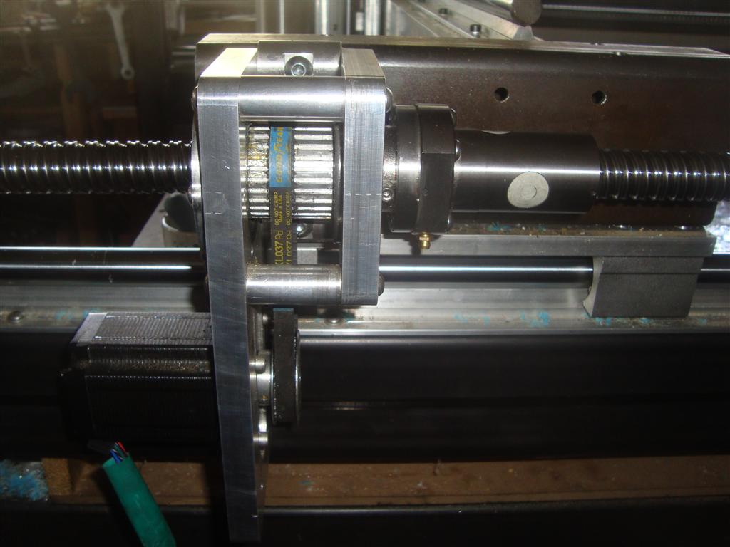

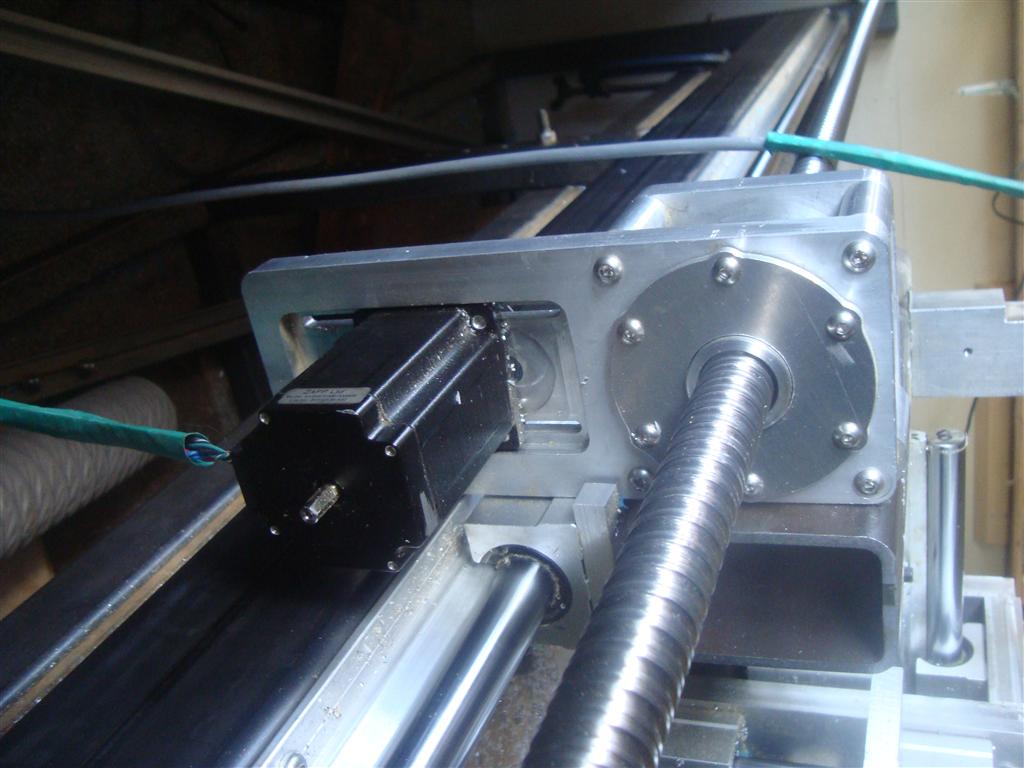

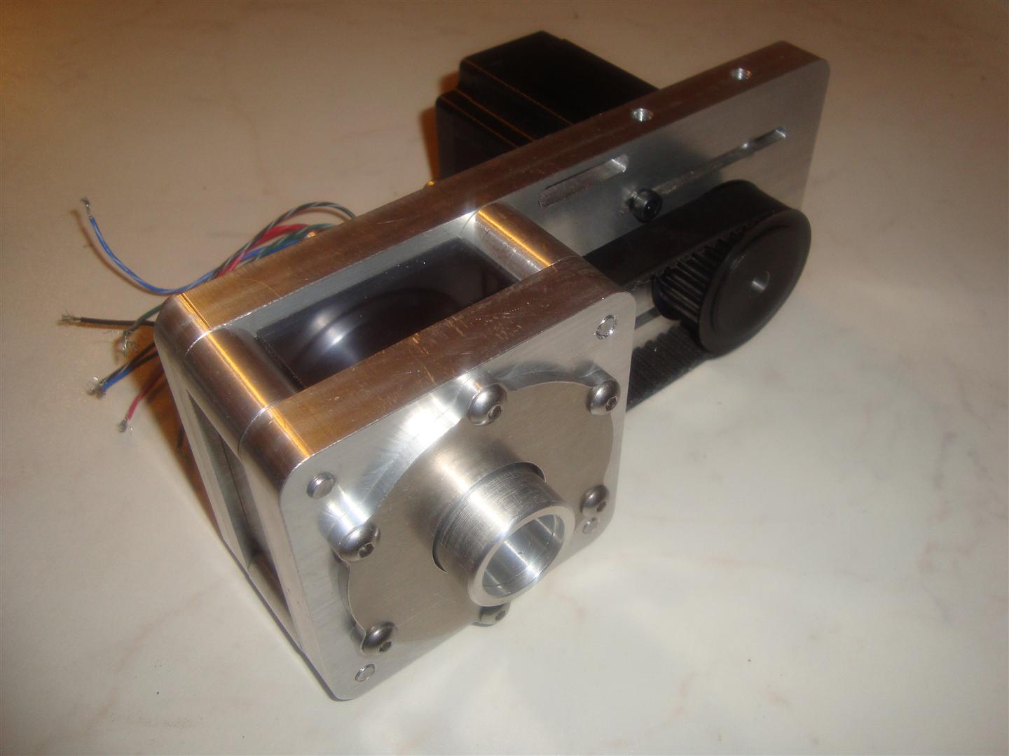

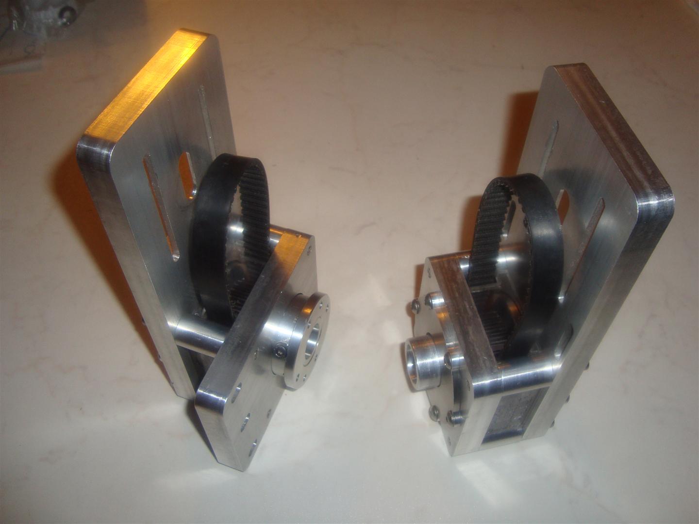

The other option is, as Jazz suggested, to use rotating ballnuts. See here for my experience with this setup:
http://www.mycncuk.com/forums/showth...-design-ideas/
(On the last page you'll find pictures of what I'm suggesting below, but the rest is worth reading for a more in depth explanation of why they work so well.)
To get the same (feederate and acceleration) as the above, probably better and certainly more than you'll ever need from a rotating ballnut setup you'll need:
2* m752, £80 (eBay)
PSU for 2 motors is shared with Y/Z motors so about £15 extra.
2* 3nm motor, £50 (eBay)
Two RM1610 ballscrews from eBay, £150
4 * 30T HTD pulleys, £22
2 * short timing belts, £10
4 * 7206 angular contact bearings, £40
Ballscrew end bearings & mounts, DIY for £10.
Total £376
So if I wanted to I could charge £187 to machine two rotating ballnut mounts and you'd end up with a better system for the same price. Realistically I'd charge less so it would be cheaper overall.* When I've worked it out before the price difference has been greater since I worked it out with two nema34 motors, not one, but either way it's a significant saving.
Or for about the same price (£376) you could just use the RM1610 and spin the screws as normal. I'm confident that will be adequate and a better option than RM2005 since the critical speed (speed at which the screw starts whipping, so the limiting speed) for a RM2005 screw is well under twice the critical speed of a 1500mm RM1610 screw so it wont actually get a better feedrate. Plus it clearly requires much more torque to accelerate a 20mm ballscrew compared to 16mm, so you'd need a bigger motor anyway.
In your situation I'd go for RM1610 and either rotate the screw or the nut. I went for rotating nuts since my machine has 2000mm ballscrews so rotating a 16mm screw wasn't an option...and equally because I wanted to try something new(ish). I've left my machine on 10m/min with 1m/s^2 acceleration on X and 1:1 ratio. It will do about 15m/min, even more if I change the pulleys, but 10m/min is already plenty so no point stressing the components. That's with the same 3nm motors and drivers, so you can expect better.
To give you an idea of how much more stable a system rotating ballnuts are; I recently didn't notice that one of my ballscrews had worked loose. So one end wasn't fixed at all and the other wasn't tight either. I only noticed the problem when after a few hours cutting aluminium I leant over/on the ballscrew to remove the tool and it moved... i.e. it made no difference! Try that with a rotating screw and you'd probably have ended up with a bent ballscrew.

Yep I can do any size, that's what I'm using:
Attachment 5559Attachment 5560
If you want 2510, although I think you'll be fine with 1610, you'd be much better off getting it from linearmotionbearings2008 on eBay. He sells 1605,1610,2005,2505 and 2510.
This is the version I did which is suitable for 16mm or 20mm screws:
Attachment 5557Attachment 5558
The bracket on the right of the picture (and in the final picture) looks good for me as I'd want to mount it under the gantry. If you think 1610 will be enough then lets go for that, though the saving seems small (about £15 each screw).
