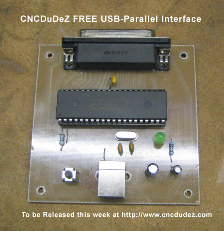

Find below the first picture of version 1.0
As you can see, this is not going to cost you a lot of money to make!!!!!!!!!
Attachment 25572
PCB and Components.

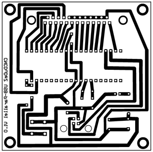

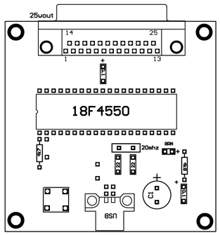

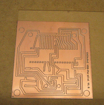

Please find below the PCB layout.
Size of PCB is 75MM * 75MM
Attachment 25569
Attachment 25573
Click here to download the Hi Resolution images: Attachment 25574
These are 600DPI JPG and need to be viewed and printed in Adobe Photoshop for an exact scale.
Also included are postscript files as well.

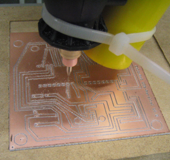

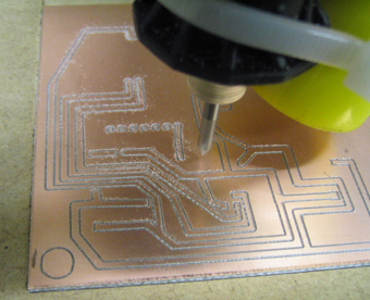

We are also releasing the PCB Layout in Gcode for people wanting to mill their own.
Attachment 25570
Milling PCB below with 0.2mm engraving bit.
Attachment 25571
Drilling PCB below with 0.8MM drill bit.

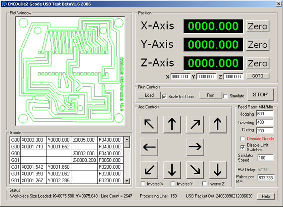

Application:
Please Check the USB-Software link to download our Beta Application: Attachment 25578
Attachment 25579
Setting up and testing:
After you have assembled your new Interface, simply plug in a USB lead and Windows XP will automatically detect the Interface as a USB Hid Device.
You can confirm this by checking in device manager of your machine.
Now connect your Printer Port cable from the Interface to your controller box and you are ready to go.
Run up the software, set up the pulses per MM parameter and try out the Jog.
Please make sure you read the HELP File first.

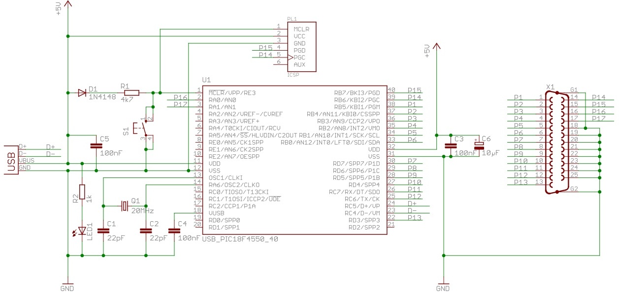

I've done a (very) quick hash at a schematic - with a few revisions:
- The PIC to be programmed in-circuit with a PICkit2 or PICkit3. You'll need to make sure your CNC device is unplugged when you do this (since it pings a couple of the pins), and also don't press the switch when you do it!
- The >400nF capacitor has been included
- The component numbering has been altered
The new layout is smaller, and doesn't have any wire jumpers. However, it is designed primarily for photo-etching (the .zip file contains the PDFs for the schematic, layout and PCB itself, at a 1:1 scale - I use the latter for my photo-etching of boards).
If you want to remain faithful to the original design (i.e. you don't need the ICSP header), then you can replace D1 with a wire, and remove PL1.
If this treads on anyone's toes, please let me know.

I did not see any connection of 5V and ground connection into the pcb design..
But in the schematic there is 5V and ground connection,
Any one please help me...
Re: USB TO Parallel Port DIY Interface
lkanta
see here: bottom two connections on right hand set of connectors.
