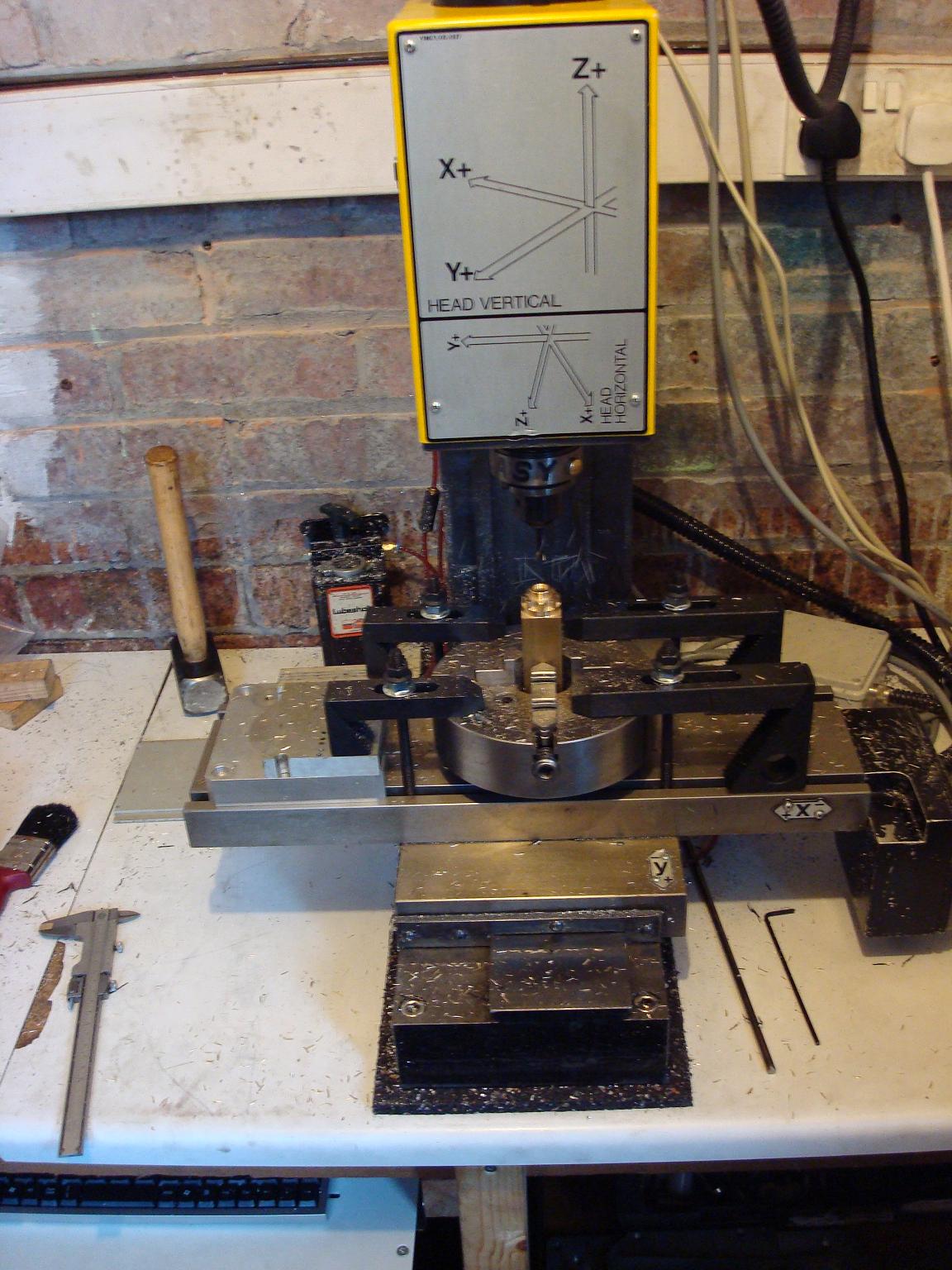

Hi All,
I bought a 260VMC a little while ago and converted it to Mach3. The problem was, The door of my workshop is only 65cm wide.
far too narrow to get the 260VMC thru it.... :(
I thought, no problem, I'll just take the mill out of its enclosure.... Nah! Boxford had the brilliant idea to cement the base and the back of the mill to the enclosure! Call Boxford, How do I get the mill out of the cabinet? ==>> Not possible sir!
Well, this was enough for me to give it a go.
1- move the table along the Y axis to both extreme position to expose the 5 M10 cap head screws. Take these off.
2- Place a scissor jack between the base of the mill (with a large piece of wood to protect and distribute the pressure) and the cabinet side.
3- start turning the screw a little bit at the time, slowly but surely! Crack!!! it's off! :-)
Attachment 5810
Now we have a 260VMC on the bench... :-) run a few test, run nicely!
Time to start the cleanup before doing anything serious with it...

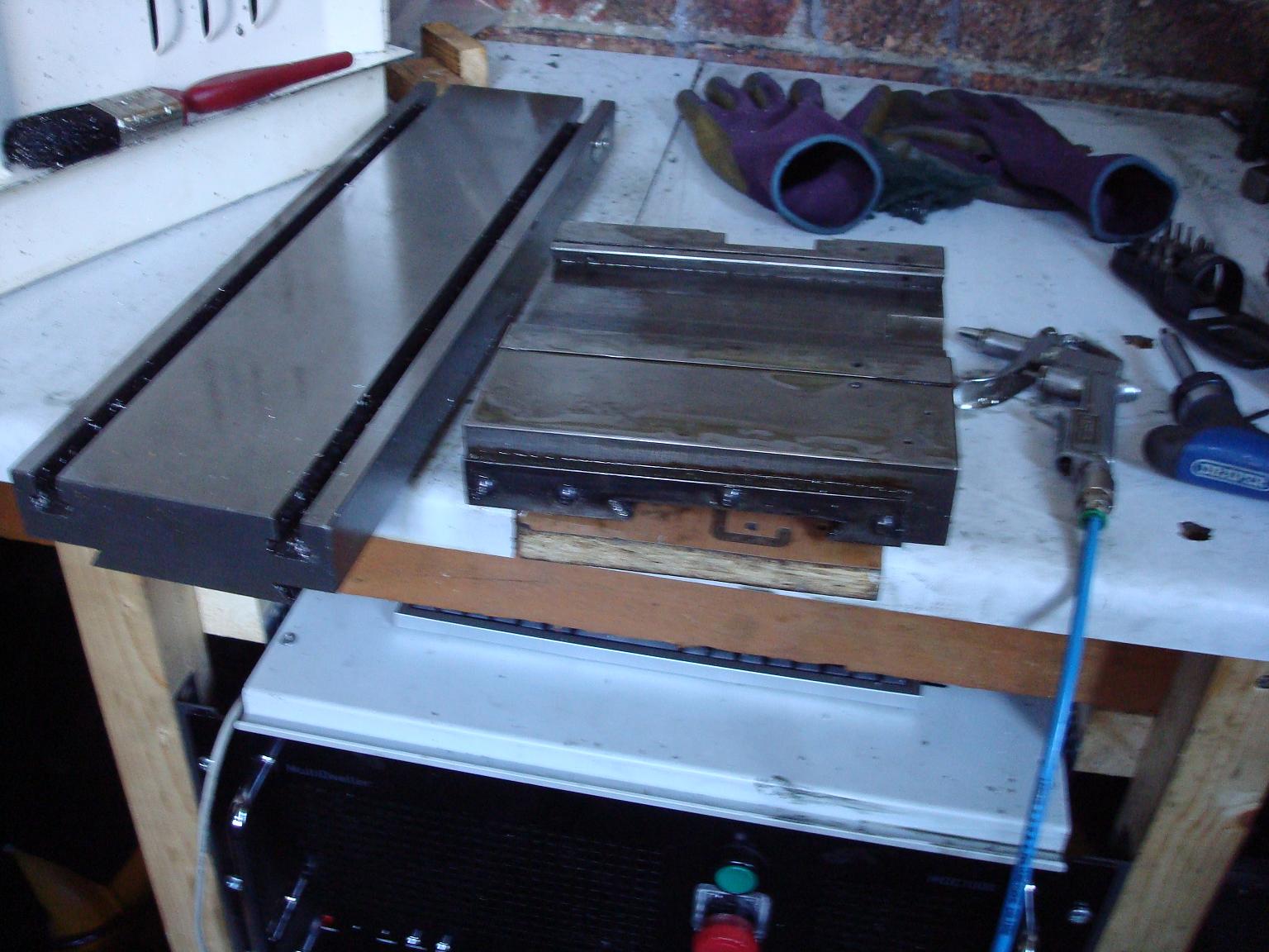

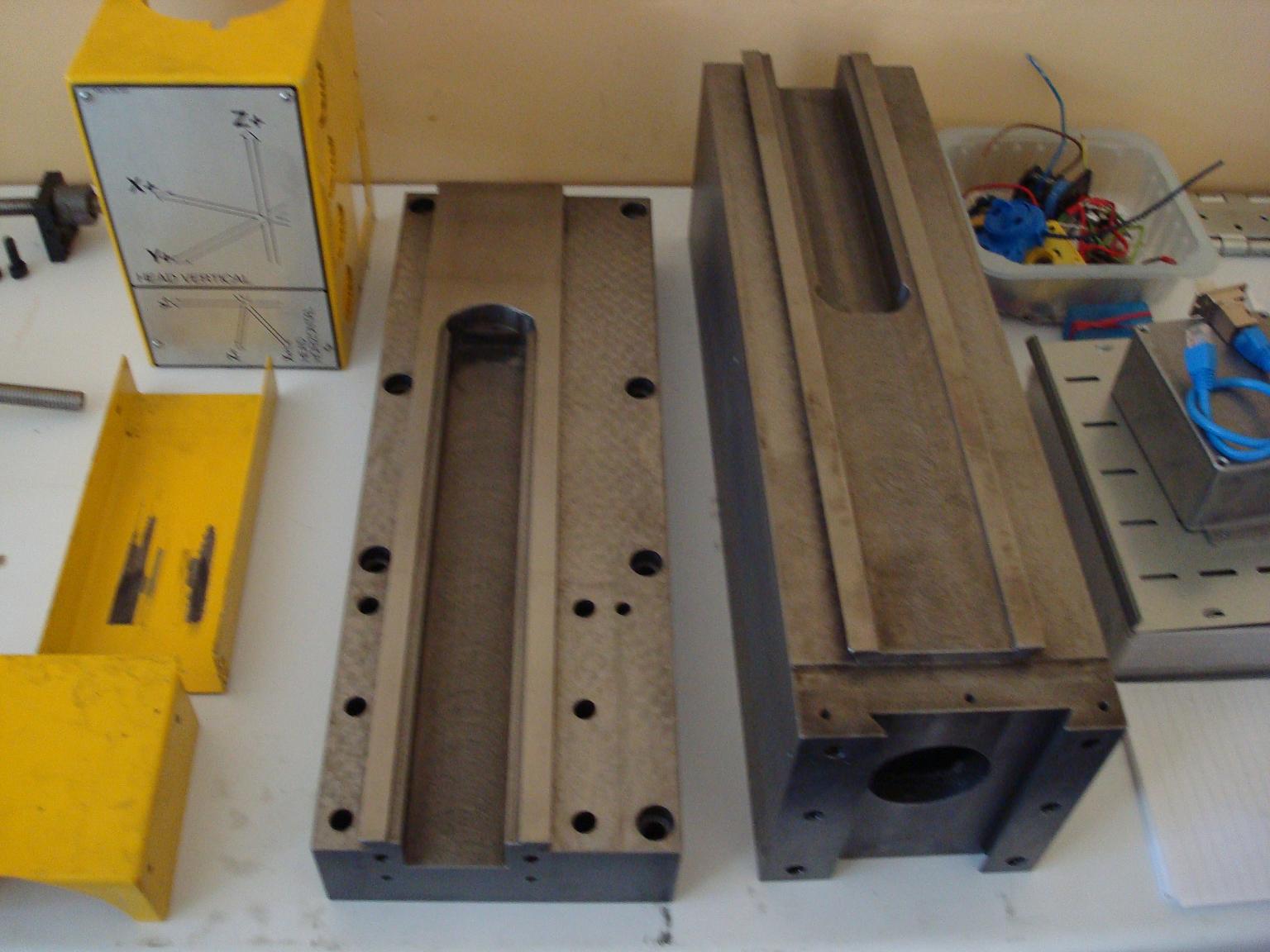

First, full disassemble!
Attachment 5811
Attachment 5812
Attachment 5813
I'll add some pictures of the electronic if any interest... :)
Laurent

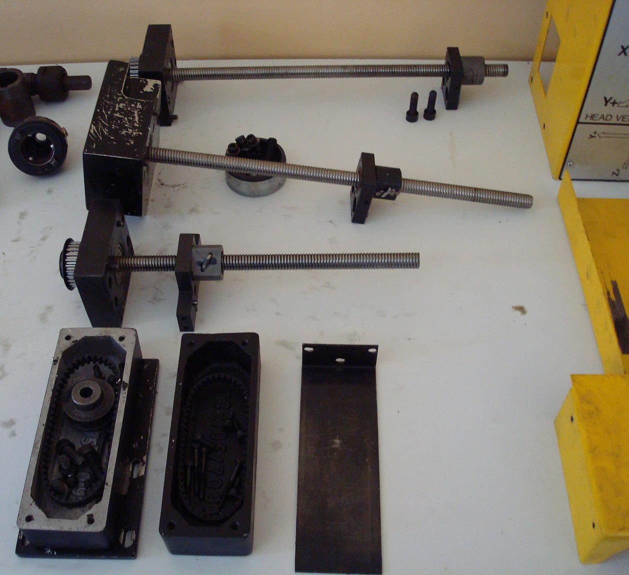

3 Attachment(s)
Re: The Boxford 260VMC as you probably never seen it before!
i2i
check the feel of the ballscrews, they are the weak link on that machine. Any notching or play they'll need to be replaced, i did one years ago and used ground 14x5mm pitch screws, also you'll need to sort out homing switches/sensors. Is your spindle R8, 30 int or coventry?

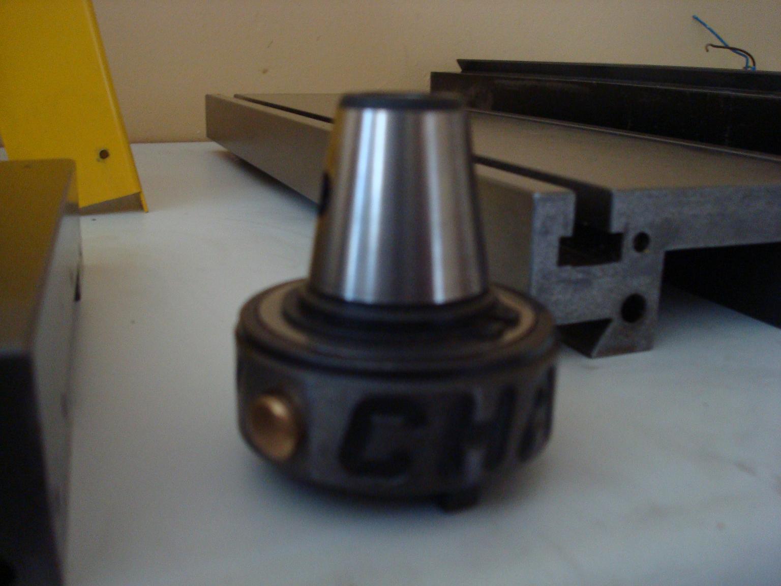

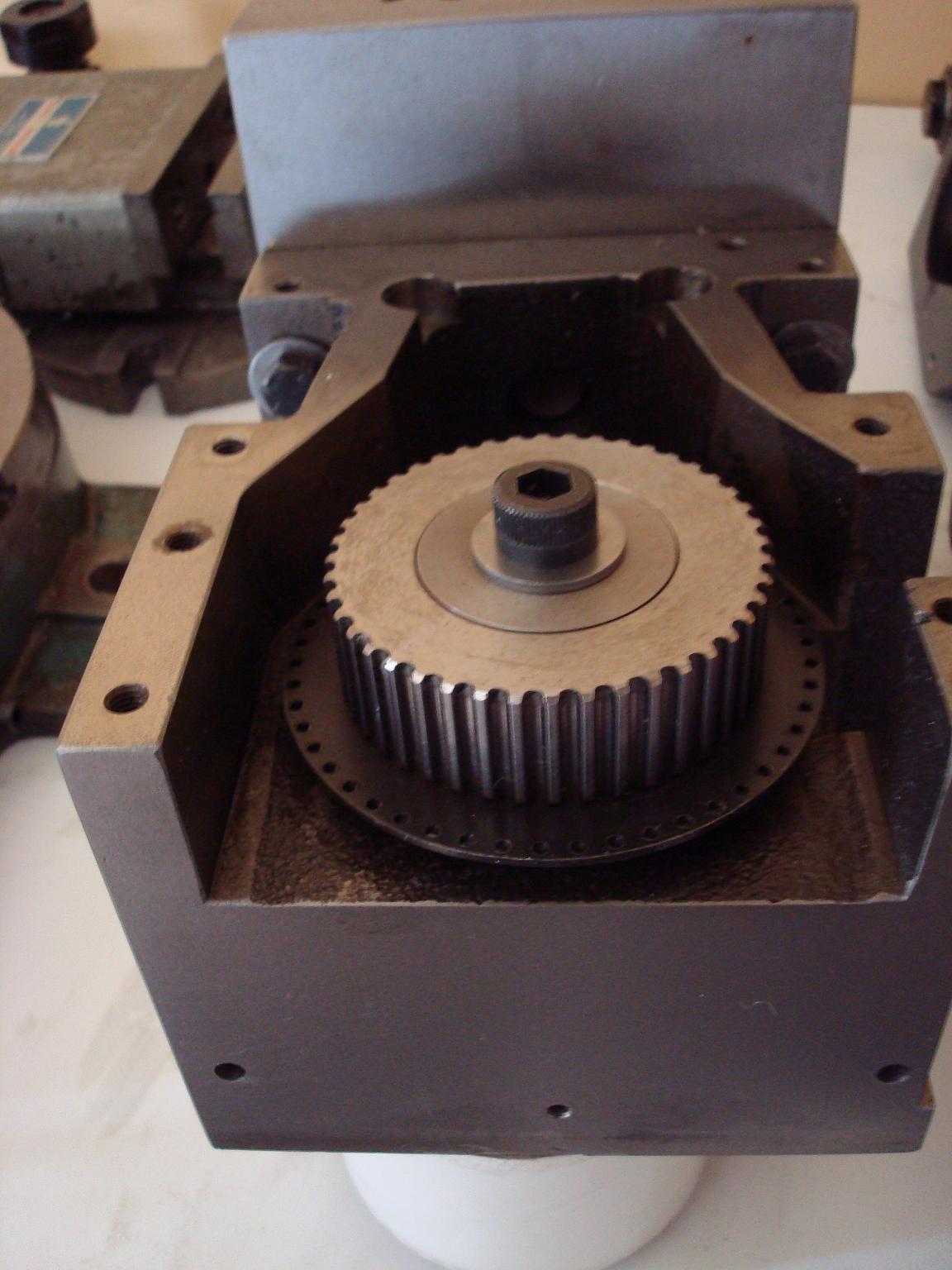

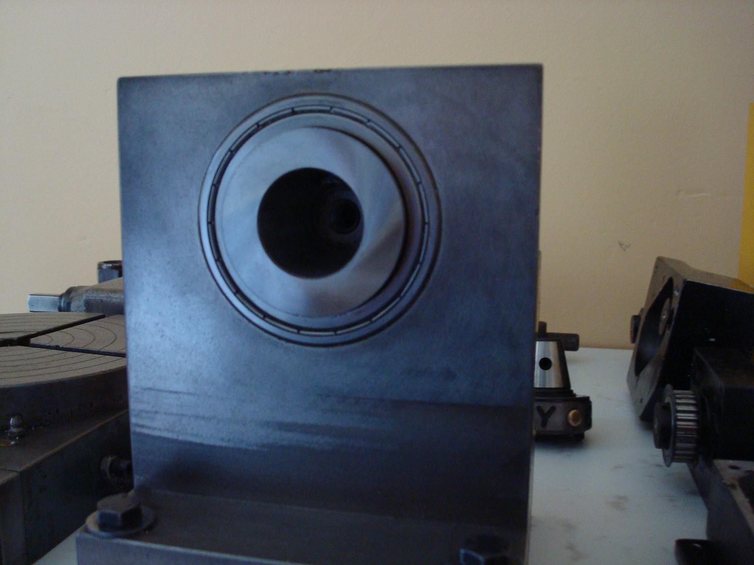

Hi i2i,
The spindle looks very much like the EasyChange itself but without the grove for the balls.
It was a pain to take off! See picture bellow:
Attachment 5816Attachment 5817

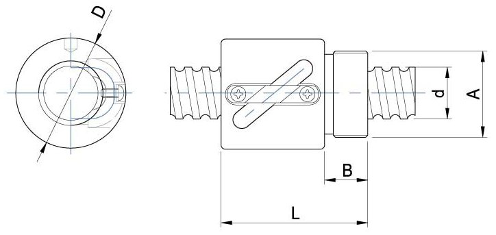

Where did you get your ballscrew from? did the new ballnut attach to the existing holders or did you make some new ones?
My X axis has no play at all, the Z got some play between the nut holder and the nut but not between the nut and the screw... How does the nut hold onto the holder? Is it screw in? I don't seems to be able to tight it...
The Y axis got some play.
Something else, I find the spindle a bit stiff. Is it supose to spin freely? I mean if I take the gear on the top of the spindle in my hand and give it a good twist, is it supose to spin a few turns? Cause right not, I can turn it easly, but it won't spin multiple turns if you see what I mean... The cap head screw on the top is it used to load the bearings?
Attachment 5818
Laurent
i used a company called BXR Ballscrews in Bideford, ask for Gerry.
the ballnuts screw into the holders so they must be tight, and i would expect the cap head screw locates the easychange holder. Preload on the bearings would be from a clamp nut above the bearings, which by the sound if it may be too tight, it's hard to judge without seeing it.

I had a quick look at that ballscrew page, But they seems to have the type of nut I am looking for only in the rolled type of screw...
Attachment 5819

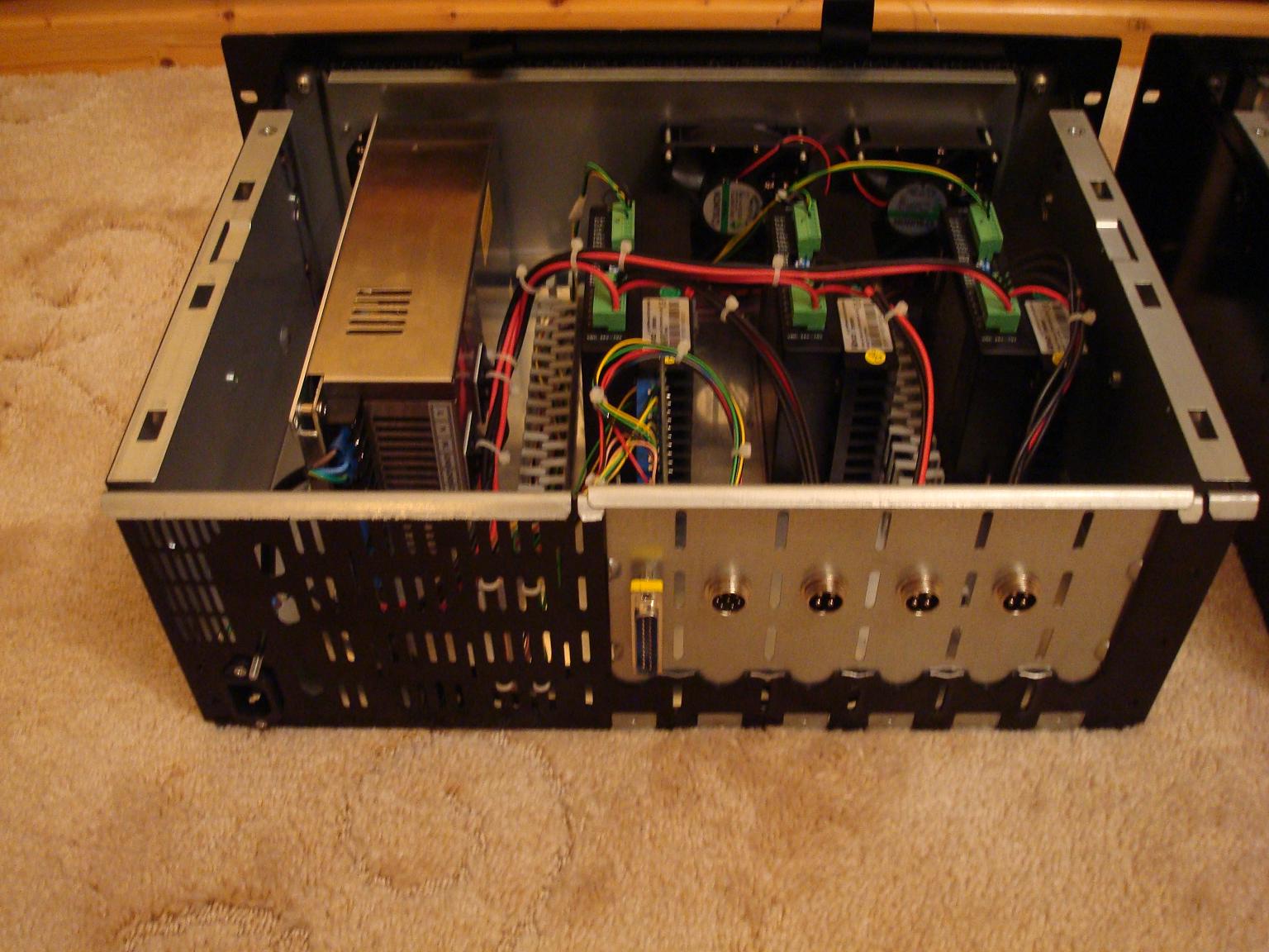

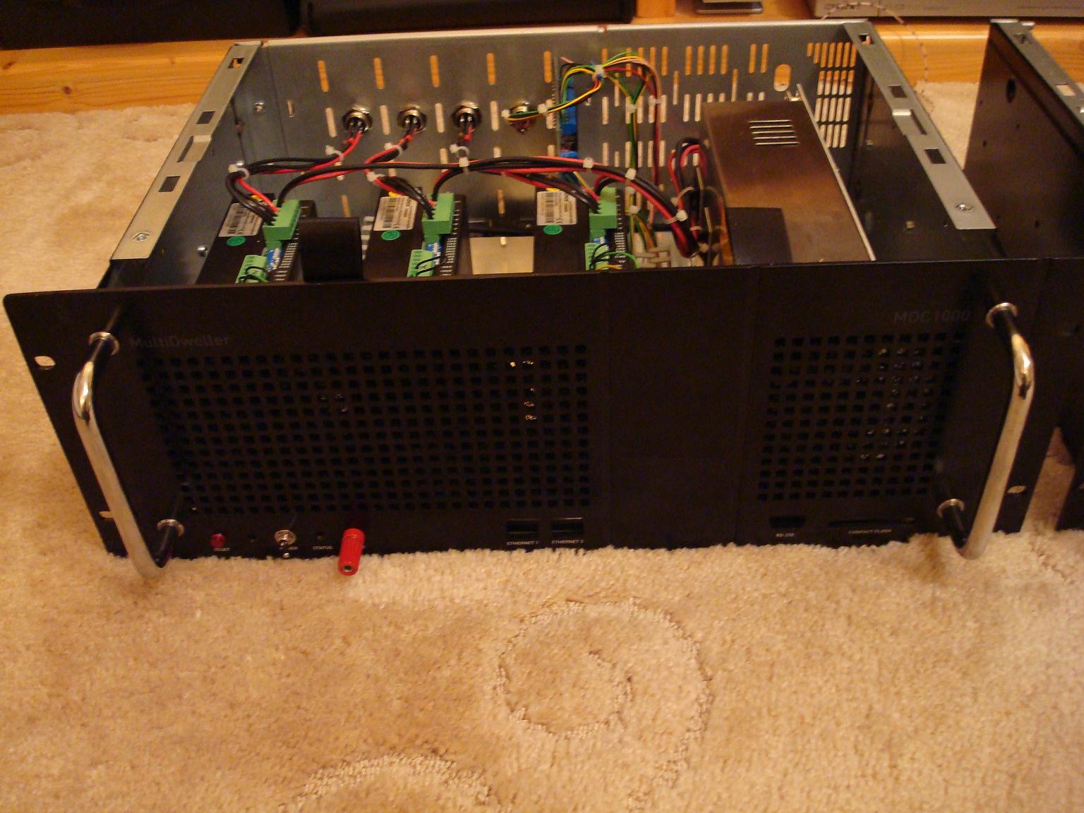

6 Attachment(s)
Ricardoco
Well i have more than a little interest, so post away i look forward to reading..

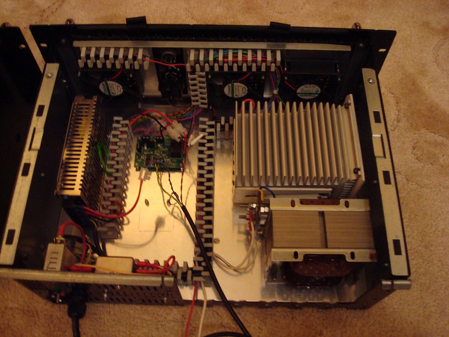

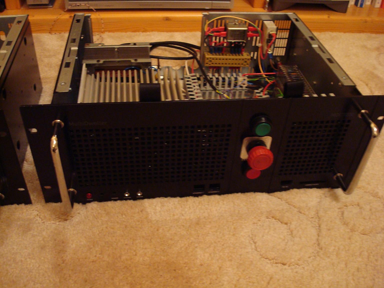

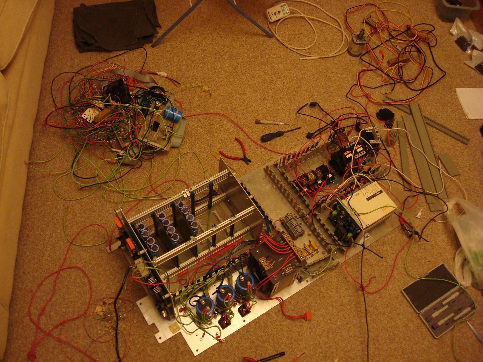

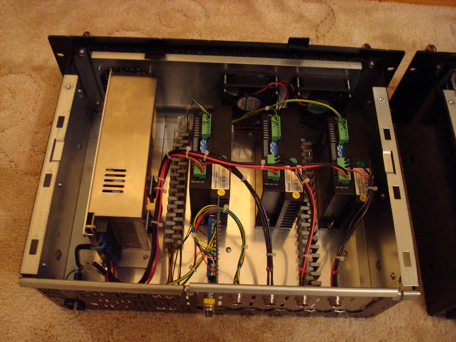

Here is the electronic...
Old stuff first:
Attachment 5820
Then the new stuff... I wanted to use rack mount 19" enclosure so it can be bolted underneath my bench, but could not find one big enough, so had to split spindle electronic in one box and steppers electronic in an other.
Attachment 5821Attachment 5822Attachment 5823Attachment 5824Attachment 5825
Got these nice rack mount enclosures from work. They've got extra holes on the front panel... I guess I will have to patch these at some point.
Laurent

Hi there, did you manage to source some new screws for your 260 or did make do with the old, i only ask as my Z spat its balls out and im using a old lead screw as a temporary measure, but will replace all with new machined screws if i can find a reasonable priced source...
Rick
you could machine out the ballnut mounting plate to take a standard flanged nut, and put up with the slight loss of axis movement.
i2i
Hi i2i, if i cannot get some of those threaded ball nuts thats what i will do its not like you would lose much using a conventional nut ...
you'd loose the thickness of the flange. The guy i got the set off for my 260 can't get the same nuts anymore, and even those were remachined to fit the threaded mounts.
I've just helped someone put a 14 x 5mm ground screw on a 240 lathe x axis and it worked well.

Hi Ricardoco,
I found a company that makes 14mm ballscrew with a threaded nut but these were only rolled ballscrews not ground. But the original ballscrews on the VMC260 are rolled, so....
http://www.mooreinternational.co.uk/...6/FGI14X4.html
I keep my existing ballscrew for now, I can not detect much backlash so far, so should be OK untill I get enough money aaside to get some new ones...
An other option I found is a guy specialised in fixing damaged ballscrew. May worth a try?

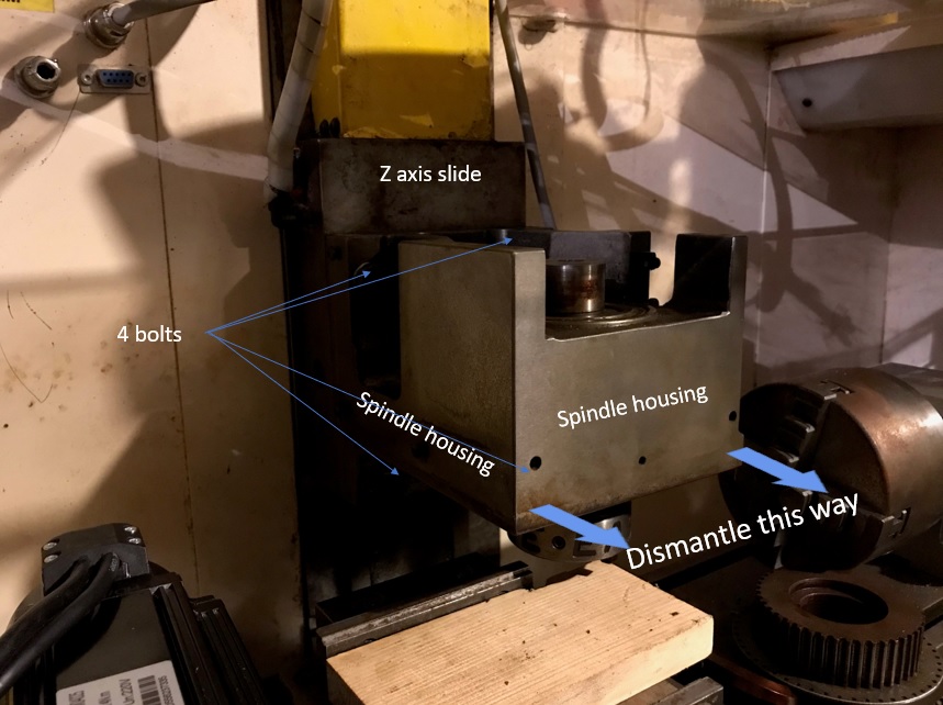

Hi Laurent,
I'm also rebuilding a VMC260, and I was wondering if you can remember if there is a way to remove the "rotating" spindle head from the Z axis slide? There appears to be a pivot in the centre of the spindle casting that allows it to rotate once you take out the 4 large bolts, but I don't seem to be able to separate the two from the central pivot? Do I need to remove the whole assembly including the slide to get to it, or is there some other way to remove it?
Any suggestions would be very gratefully appreciated!
Ben.
Hi Ben,
By "rotating" spindle head, do you mean the easy change head?
Could you post a few pictures?
Thank you,
Laurent
Hi Laurent,
Many thanks for your reply. Sorry - I didn't describe it very well.. I hope that this picture helps... What I'm trying to do is separate the spindle housing casting from the Z axis slide (I need to replace the spindle bearings). I undo the 4 bolts around in the corners of the spindle housing casting, but there is still a pivot in the middle which allows the casting to rotate into a horizontal position. I can't see a way to remove the casting from that central pivot (if possible without having to remove the Z axis slide)?
Attachment 29853
Hi Ben,
I think the only way to do that is to get the entire assembly off the machine.
There are screws behind the head.
Bring the head all the way up.
Look at my pictures on the first page of this thread you 'll see the cuts /groove in the column that show you the way to remove it is up. 😊
Laurent
