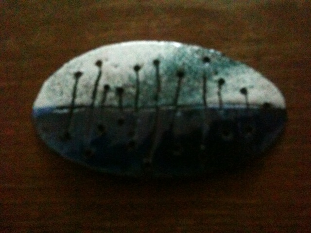

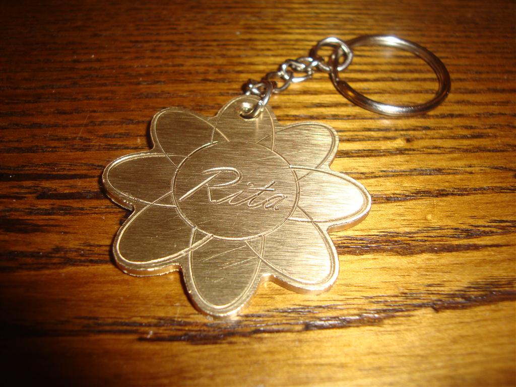

If you go for laser cutting you would need someone with an anti reflection/ polarising kit fitted to their laser. Materials like copper, brass and aluminium can cause problems with lasers, especially older types like the one we have at work. Are all of the broaches different designs? If so getting them laser cut would prove expensive I think given the continual changing of programs.
As for plasma cutting some of the smaller hand held machines are air cooled torches so no water cooling required. The big problem with plasma is the fumes it creates when cutting. You will need an extraction and filtration system for a plasma cutter. Also the kerf size on plasma might be an issue for you. Even at a low current cut you would probably still have a kerf value of around 3mm to 4mm and this might be too wide for the slots in your designs.
