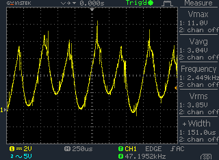

I would consider the voltage you get from the common formulas (20*V, 32*L^0.5 etc) to be a 'recommended minimum'. You will get better torque at high speed if you use 70-75V, plus seems a waste to get PM752 drivers if you're only going to run them on 42V.
A linear power supply handles current surges better than a switch mode power supply (smps), which means you can safely use a lower rated current than the smps. A 500VA transformer is fine for 3 motors, probably 4 and that's only 500/70=7.1A.
The current in a 2-phase stepper motor on a microstepping driver is, at intermediate speed, approximately sinosoidal and out of phase by 90°. This means that the maximum current is the maximum of I*(sin(thing)+cos(thing)), which is I*2^0.5 where I is the current in one phase - so 2.1*1.414=2.97A. This is 70.7% of 4.2A. Similarly if you work out the rms current for both phases (just integrate the previous formula squared etc), it is 2.1A - hence 50%. I'm guessing this is where your 50%-70% approximation comes from.

I just put an ammeter on my 500VA PSU and ran a few programs on the router. With 4 motors maximum current was 2.66A and at standstill 0.72A. Just going by eye (not great I know, should use my oscilloscope) the mean current looked to be about 1.9A. The drivers are set to 50% current at standstill, so since the power supply is outputting 68V we expect the current current when stationary for 4 motors to be 4*0.5*2.73*4.2/68*2=0.674A, so the measurement is fairly close.
So lets be very safe and calculate it with the peak current since we know if the temperature is fine at that current (2.66A) it must be fine for the lower current when running. The 8A rectifier I used is 2.2°C/W junction to case and forward voltage is 1V, so 2.66*1=2.66W to dissipate. (150-25)/2.2=68°C/W which is a large value, hence why it works with no heatsink. Also the datasheet specifies up to 3.2A with no heatsink, so clearly we're fine especially as in reality the mean current for 3 motors is less than 2.66A.
Edit: Just tried measuring using the oscilloscope with a shunt resistor and running one motor at the speed it draws the highest current I get 1.58A mean, so 4.75A for 3 motors which implies if I get all 4 motors running at their peak, it will draw 430W from the 500VA transformer.

No, they make life more interesting.
Here's a graph to brighten things up:
Attachment 6849
(0.47 ohm shunt resistor and one motor going at speed which obtains the highest current)
