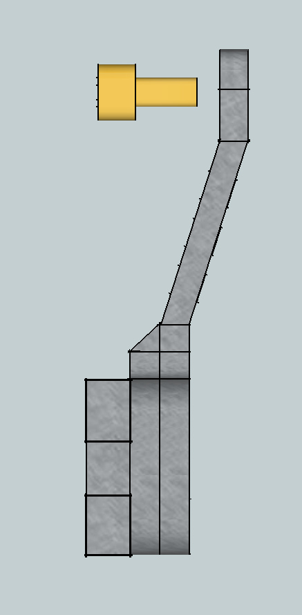

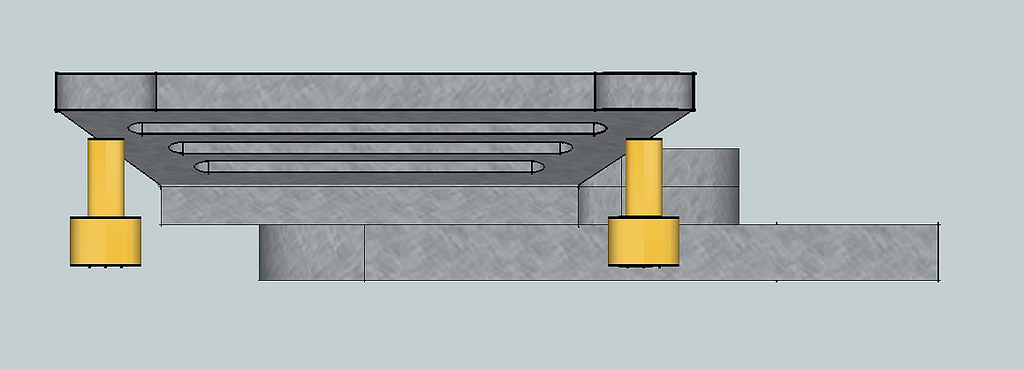

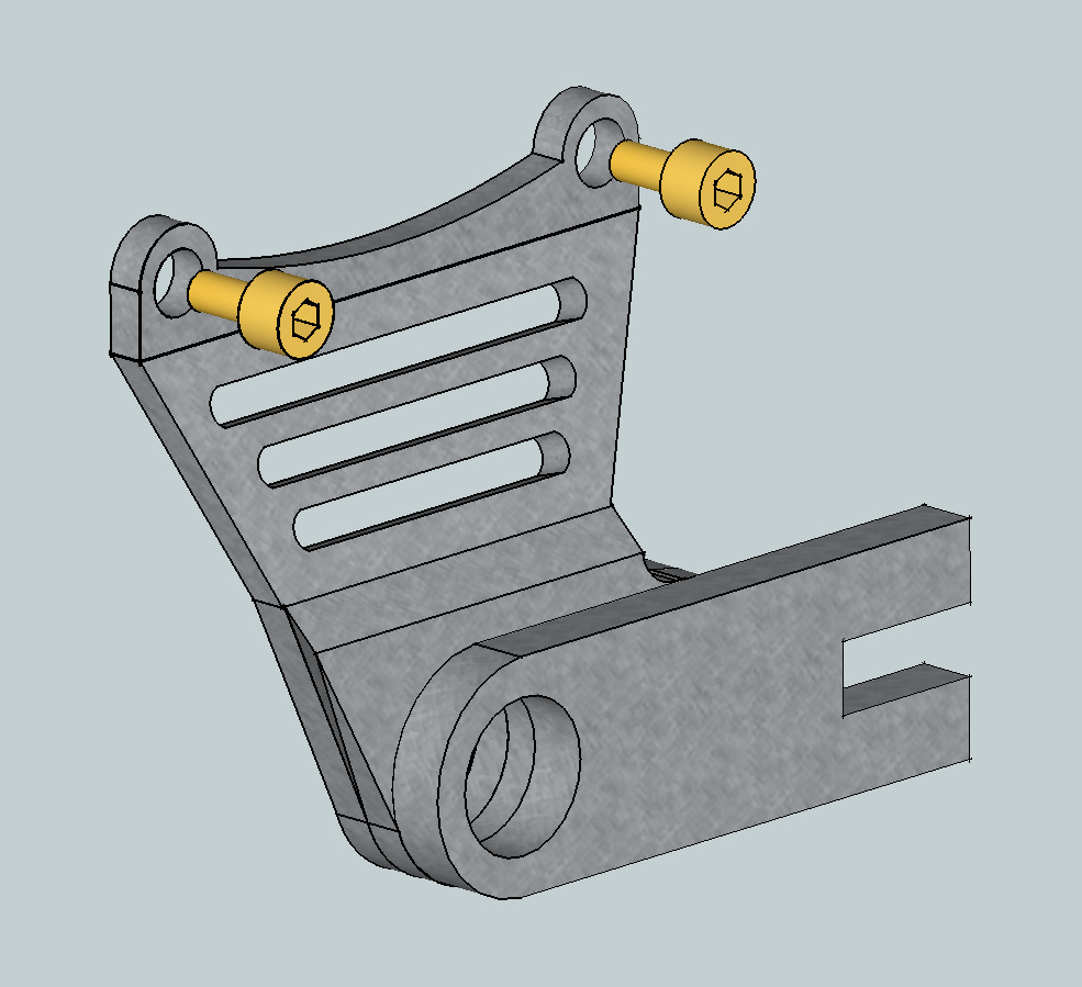

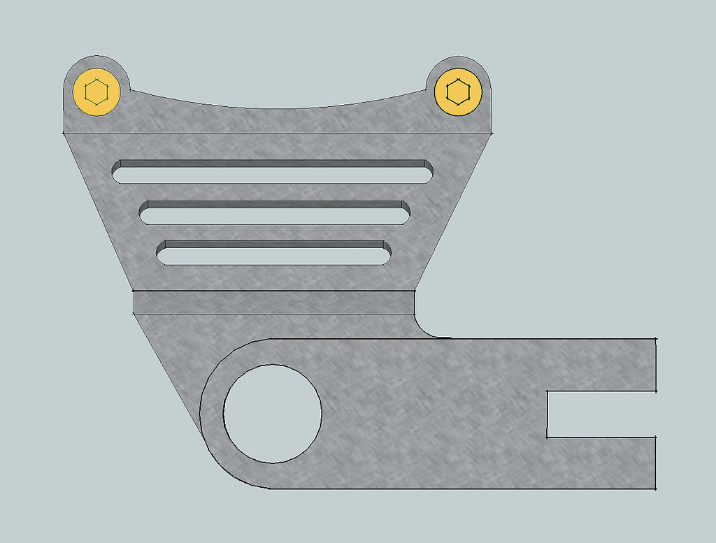

Re: Estimate for Motorcycle Part
Hi all.
Here's the part I'm after.
Its pretty basic, about 150mm x 130 x 70mm
It needs to be strong. Any Motorcycle guys will know immediately what it is / does.
I can supply the rear wheel and swingarm for you to take your measurements / tolerances etc and then machine as you wish.
Its not for production, its for a one-off special build.
Turnaround can be unto 6 weeks.
I'm based in London.
Attachment 7828
Attachment 7825
Attachment 7826
Attachment 7827

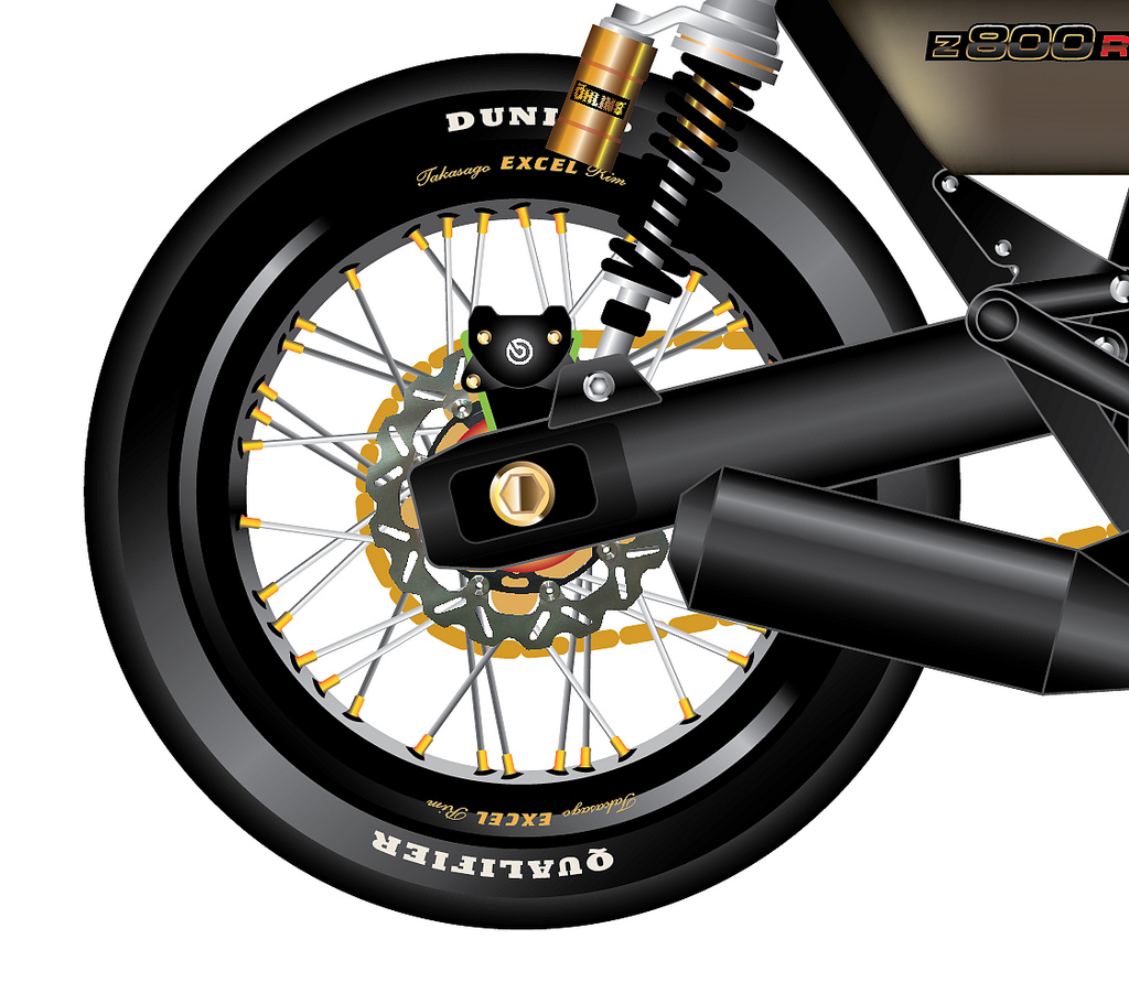

You can see it in place here, outlined in green.
Attachment 7806
Have amended the design slightly - but its essentially the same for an estimate.
Looking at this it looks like you have 2 piece design in mind and that just won't work and look the same.? It would need to be much more robust at the spindle portion to allow inter locking joint to stop rotation.
This part needs much more work on design and strength because has robsk1 says it wouldn't last 5 mins under heavy breaking with these proportions.
I Also doubt anyone will give you a quote for an incomplete design thats flawed in such a major area given the nature of it's importance.? I certainly wouldn't.!
Having said that, it could still be a 2 -piece item and work well.
Simpler to make if the hanger and brace are separated and slide into each other
as it could be cut from 2 thinner pieces in just 1 axis...
