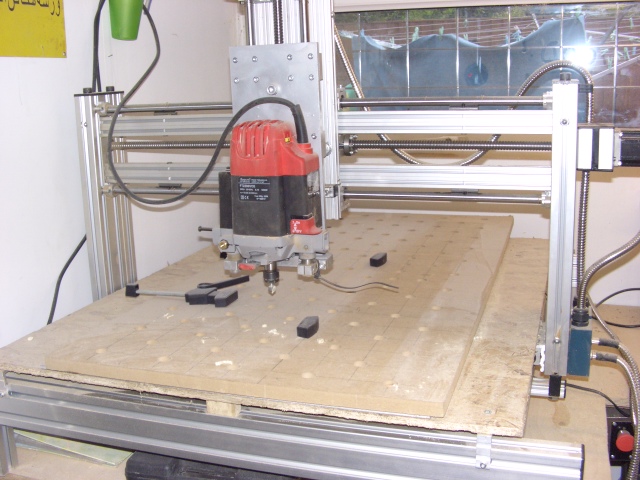

Hello everyone , i brout a home made Cnc router table , and the motors are wired up wrong ,i cant get in touch with the guy who made it , would there be any ane in the wolverhampton area willing to come have a look at it for me please....

the guy i got it from was ment to come sort it, but never did , thats what he said , iv a laser machine so was going to use it for deep engraving signs , its all hooked up with mach 3 , just judders when try to use it :(
it judders when try to operate it ,runs off mach 3 , the bloke i got it off said motors wired up wromg never got back in touch, i dont knw to much about it i mainly use laser machines

Attachment 7891this is router cnc

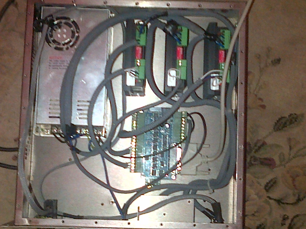

Need photo's of inside the control box, loads of them.

Attachment 7908Attachment 7909Attachment 7910Attachment 7911Attachment 7912
The drivers are micro step cw 5045 , on all ,the settings are first 4 off last 4 on
in last pic order of drivers left to right is x,y,z

At the moment you have it set for 1/2 Steps full current set at 4.5A
In Mach it should be configured for 400 steps

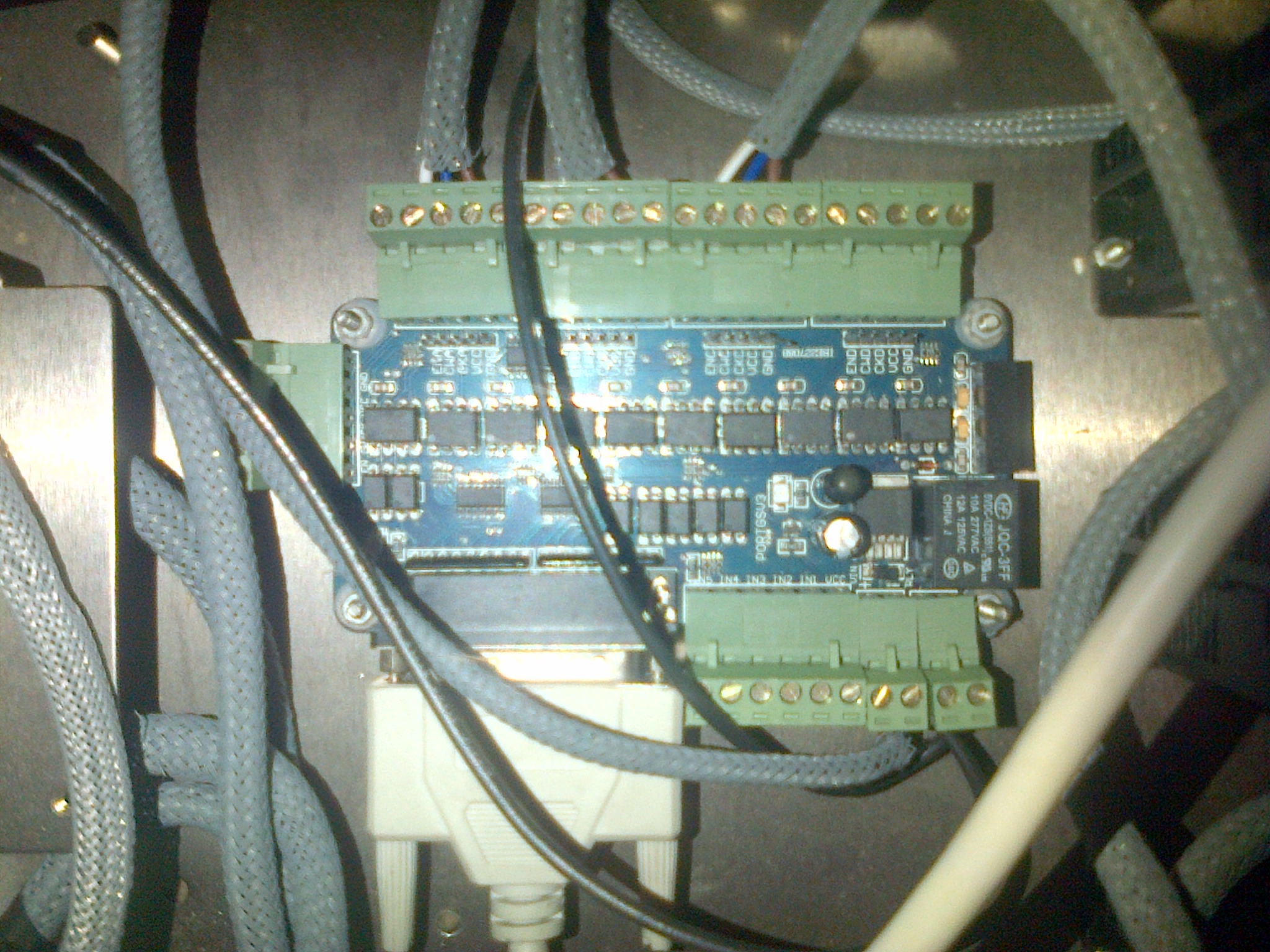

One thing to check is that it's got one of the weird Chinese breakout board fitted. Weird in that the pins are not consecutive like many and jumps about all over.

Think I see the problem.? but the picture is shite so can't be sure.?
Looks like the Puls + is jumped to the Dir + can somebody else look and check this with me.? Pic 3
I just relayed what i saw in his pic?
Come on Lads get your specs out.!! Am i seeing correct is the white wire Jumping from Pul+ to Dir +.?
Look at pic2 then pic3 and you'll see slightly better. That fully comprehensive Chinese Drive manual is about has much use chocolate fireguard. . .:nightmare:
Ok then looks like I'm talking to my self.!! . . .So I'll answer my own question . Lol . . . YES It IS.
Handywood man If I'm seeing correct then this is definitely your problem. The Step pulse and direction pulse are trying to use the same pin from PC and it will do what you say.
Just Swap the white jumper wire so it goes from (pul -) to (Dir-) and see if it works then.? Think you'll find it does.
yeah the way i read it & the link someone give before with the word doc he has got a little white jumper wire going from PUL+ to DIR+ although i have no idea what that means lol
Sorry Jazz had to go have me takeaway. I think you what they have done is connect the neg wires of step and pulse.

hold fire.. i'm gonna draw you what jazz is on about.. it's a really simple fix for you trust me
pul+ dir neg
wrong pul + dir +
i hope you can read this as i've had to compress it
Attachment 7915
let me know if you dont understand

so just moving both ends of the link wire to the left one terminal ?
Ok really this needs checking all the way back to the breakout board (Board with cable to parallel port)
EDIT: Forget what I said after 2epoz posted that link and seeing the breakout board then it's wired correct for that board.
