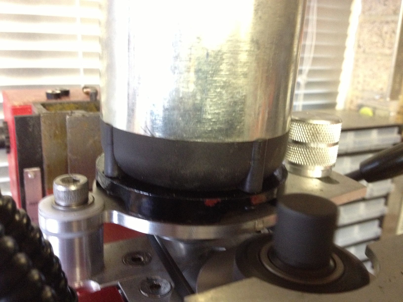

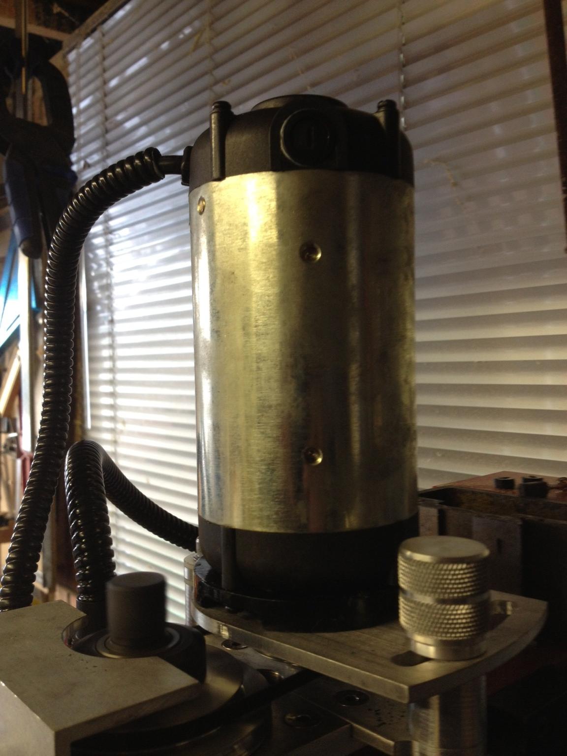

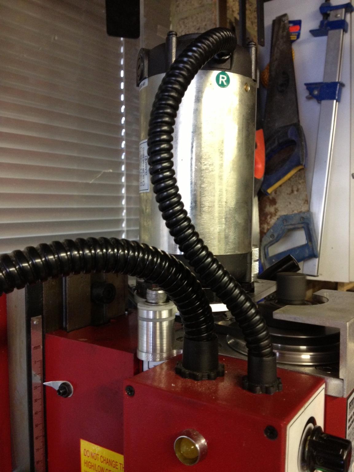

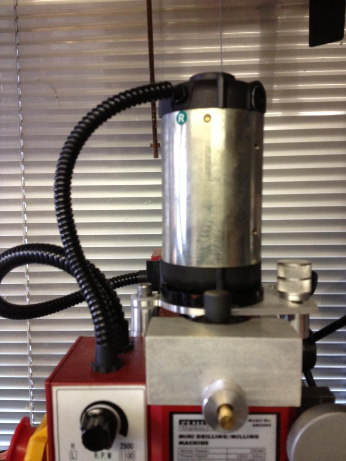

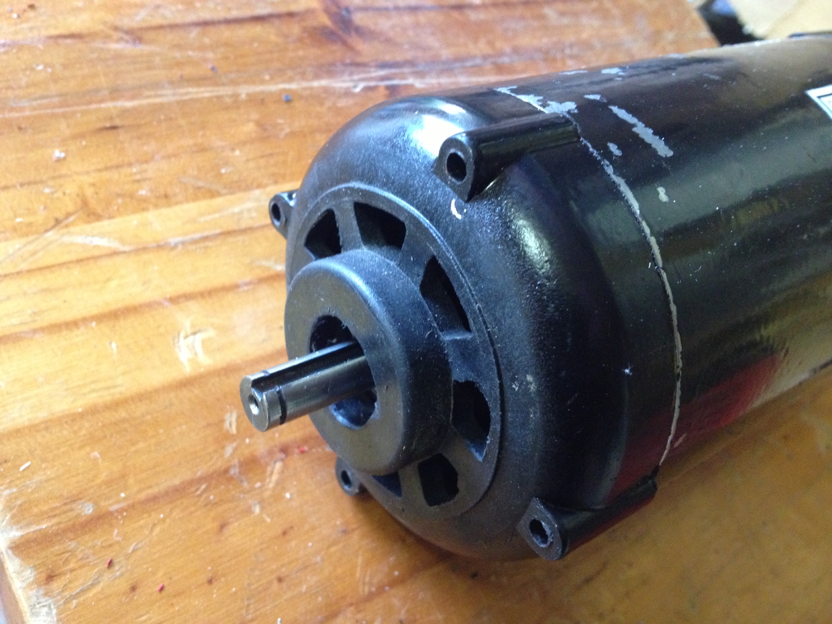

Update
Just thought I would post an update as it might help someone else out, It was the motor that was gone on my very little used X2, new price £195 delivered (too dear). After looking for a replacement with no luck I came across the C3 replacement motor on the Arc Euro Trade site, looked the same in the picture and all the dimensions are the same, so ordered it and it fit perfectly, you just have to take the 4 screws holding the front casing on and fit the mounting plate from the old motor. £65 for the motor delivered and it works perfect now, no tripping as soon as it spins up! Arc Euro Trade Ltd
