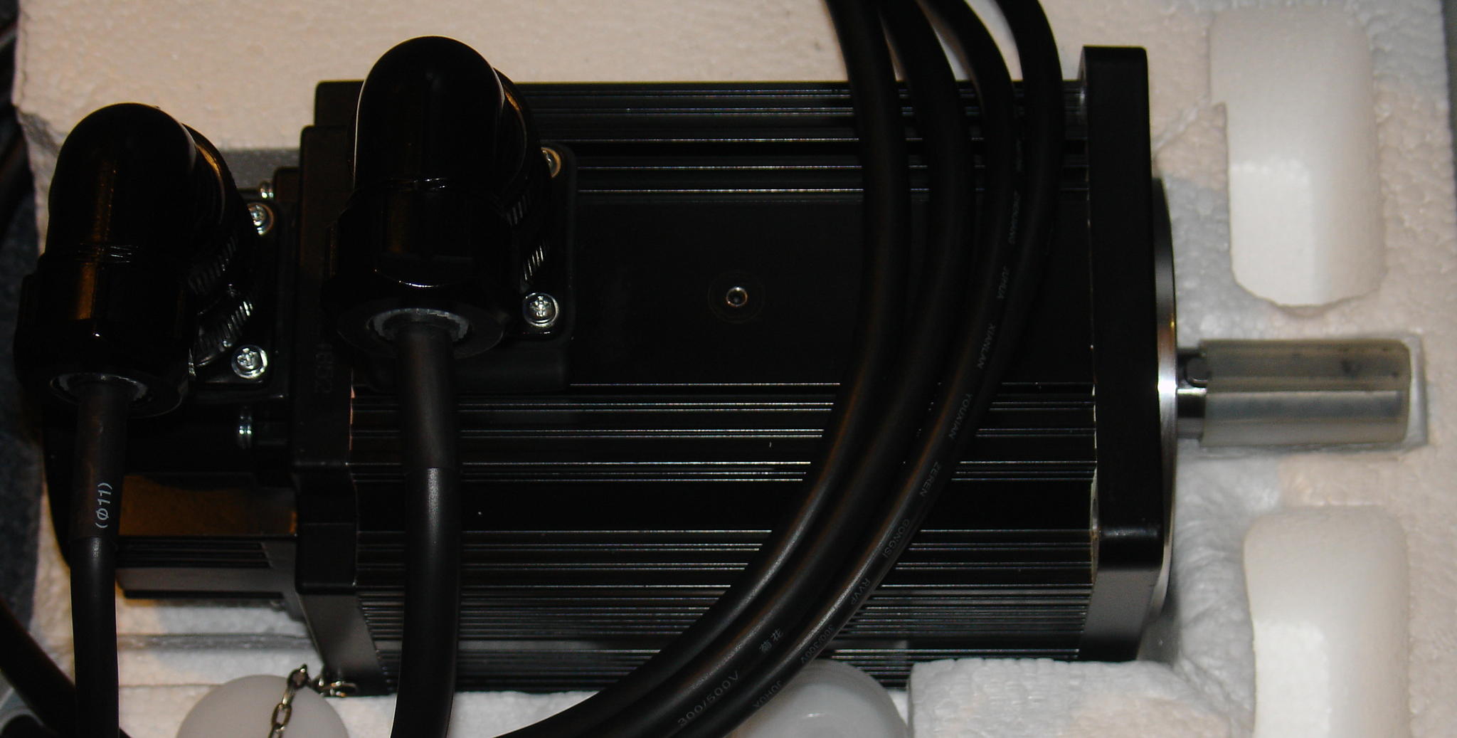

		Hi all,
I just bought a new AC servo motor + drive to make a 4th axis on my mill.
Everything looks good and solid, the problem is: It requires 3 phase supply !
I knew the motor was 3 phase but I assumed that the Drive had a 3 phase inverter built in !!!
(The manual says 3 phase 220V supply IN)
So, my questions now are:
1- Is it possible to run this kind of drives of a digital inverter (like a CUB...) ?
2- This servo drives have a Main supply (3 phase) and a control supply (single phase) and on the wiring diagram
     it shows the single phase supply taken from the 3 phase supply (Between 2 phases)
     Now, I don't think it is a good idea to use only 2 of the phases from an inverter...
     So, is this the same as Phase / Neutral supply ?

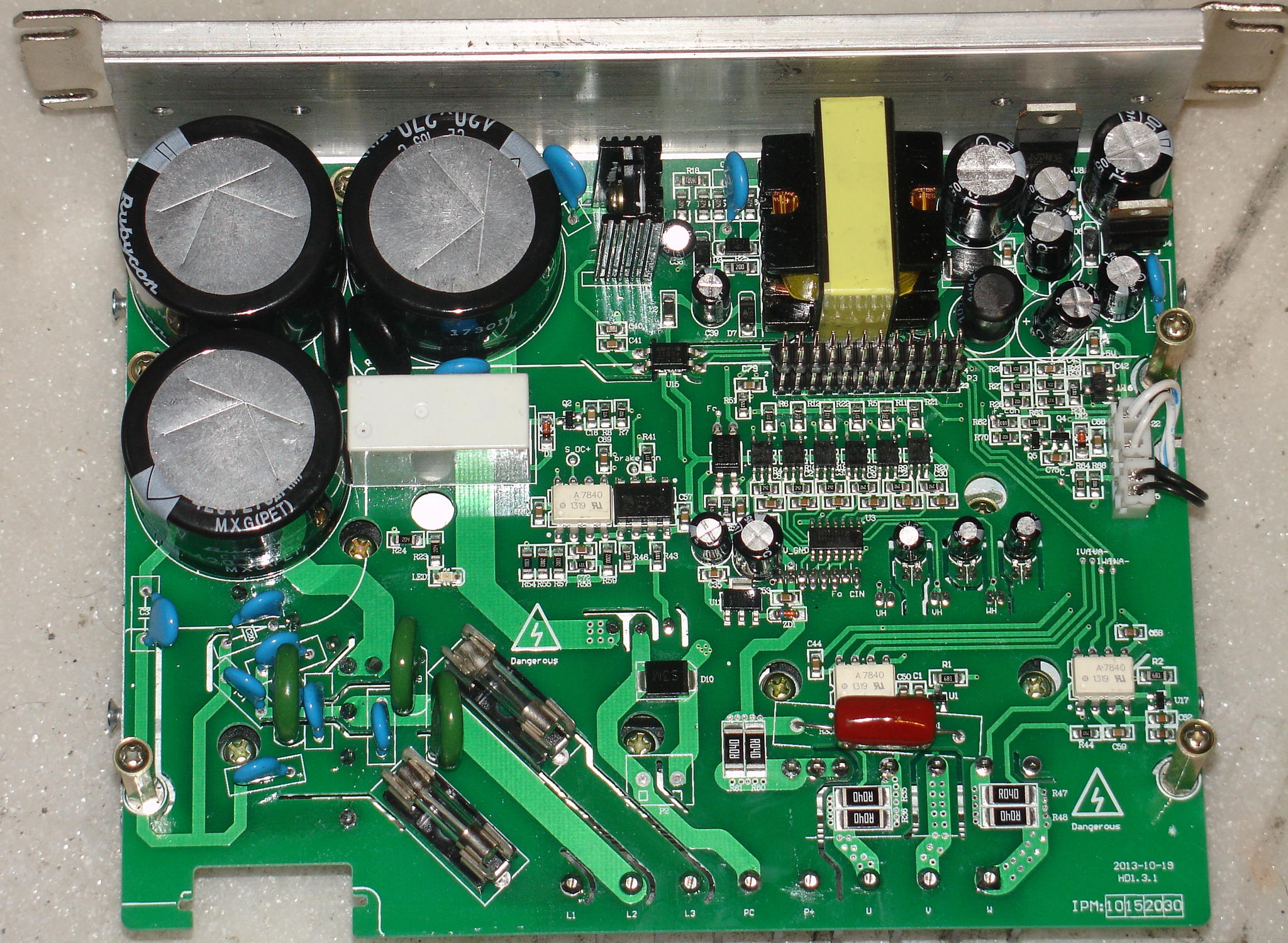

I opened up the enclosure of the drive and as you said, the AC from the 3 phases goes to 2 bridge rectifiers and a series of big caps.
So, using L and N single phase would use only 1 rectifier (and therefore geting it over worked...
Now, there is nothing in there requiering a phase shift between the 3 phases coming in....all the bridge rectifiers care about is 240V AC...
So, I decided to connect  Neutral, Live, Live where the 3 phase were supose to go (L1, L2, L3)... This way the load is spread over the 2 briges as per 3 phase setup.
Tryed that this morning... All good! Motor happy, drive happy... (all stays cool )
These servo motor are really quiete!  even at 3000 RPM !  amazing!

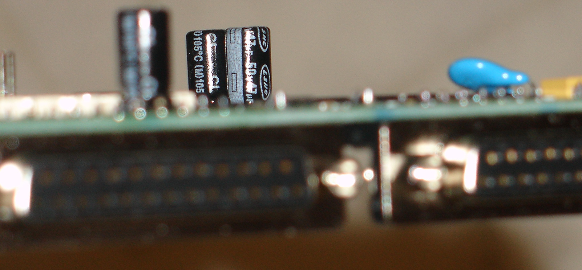

 Funny that you mention this...  :-)   On the PCB there is a foot print for 5 caps but only 4 fitted!  Could add an exta one I suppose...

			If you do add another capacitor, make sure it's a similar spec to the ones already fitted, and that it's capable of a pretty large ripple current i.e. don't go for the cheapest one you can find, as if it can't handle the ripple current it'll overheat and go pop pretty quickly.
 Yes... I thought so... There must be a reason why this particular model of cap cost over £30 where you can find some of same value for less than £5.00 !  :-)
All caps are in parallel...

The driver inside has 3 big 420V 270uf rubycon MXG(PET) capacitors ..
To use single phase supply without transformers If i add 3 same caps in parallel and connect phase to L1 terminal of driver neutral to L2 terminal and phase again to L3 will be ok ?

 To operate with single phase continuously at the rated power you would need three times the capacitance - so an extra 1620uF. Keep the wires from the new capacitors to the existing ones short. Also check the current rating of the rectifier.
Bear in mind that if you're not using the servo drive near it's rated power, you may well be fine leaving it as it is. Have you tried contacting the manufacturer about operating on single phase? They might have already included enough capacitance to work with single phase.

I don't know the manufacturer the drivers are chinese copy Special AC servo motor 110ST-M06030 6N. M 1.8KW+ drive Kit line - iBuyLa_Tmall_Taobao Angent - Online Shopping at iBuyLa.com in Singapore  .
I have oscilloscope so i can see the curve of voltage after rectification so i can find if smoothing is ok or not .
The enclosure of driver does not have space for extra caps so if i add more i will put them outside the drive.
The pcb has 2 rectifiers (4 legs each one) much be change them with bigger rectifiers ?

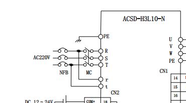

3 Attachment(s)
		Re: AC servo motor help !

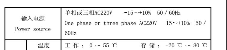

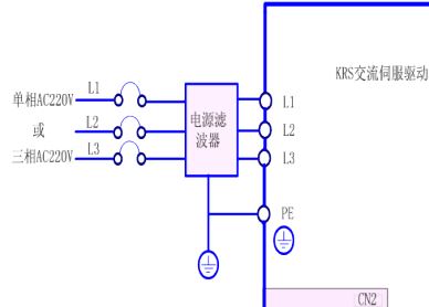

		Hi just send you the message with the manual. I believe there is should be enough capacitance and the drive to be prepared for the single phaze.
Look at the snip from the manual below and from another similar Chinese drive:
Attachment 11086Attachment 11087Attachment 11088
It seems the connection should be between L1 and L3/ judging from 3rd picture where they are  named R and T/- i mean the phase  and the middle one to be 0.
But dont trust me on this, just open it and see whats there and think

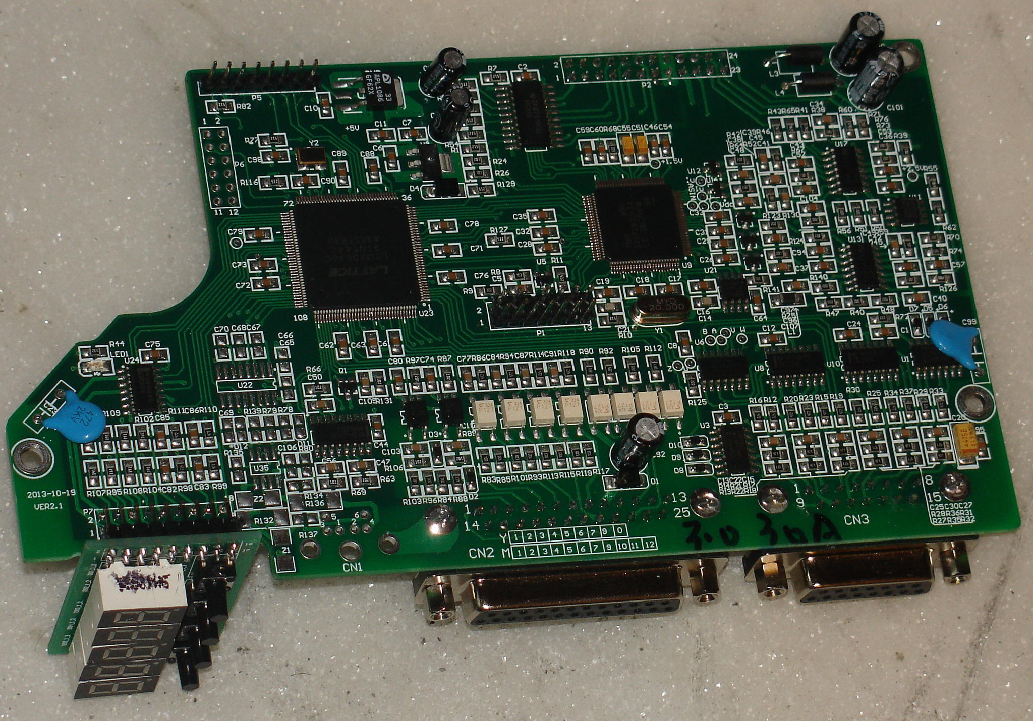

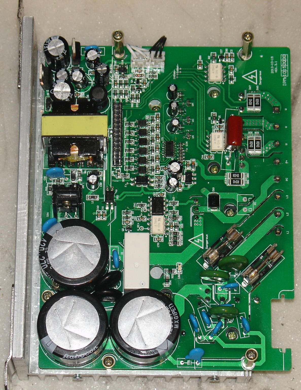

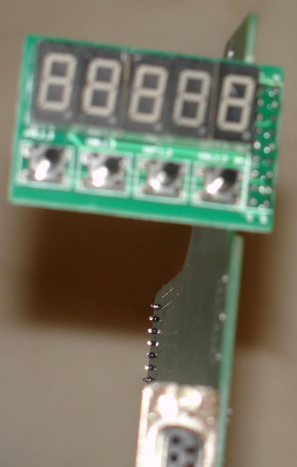

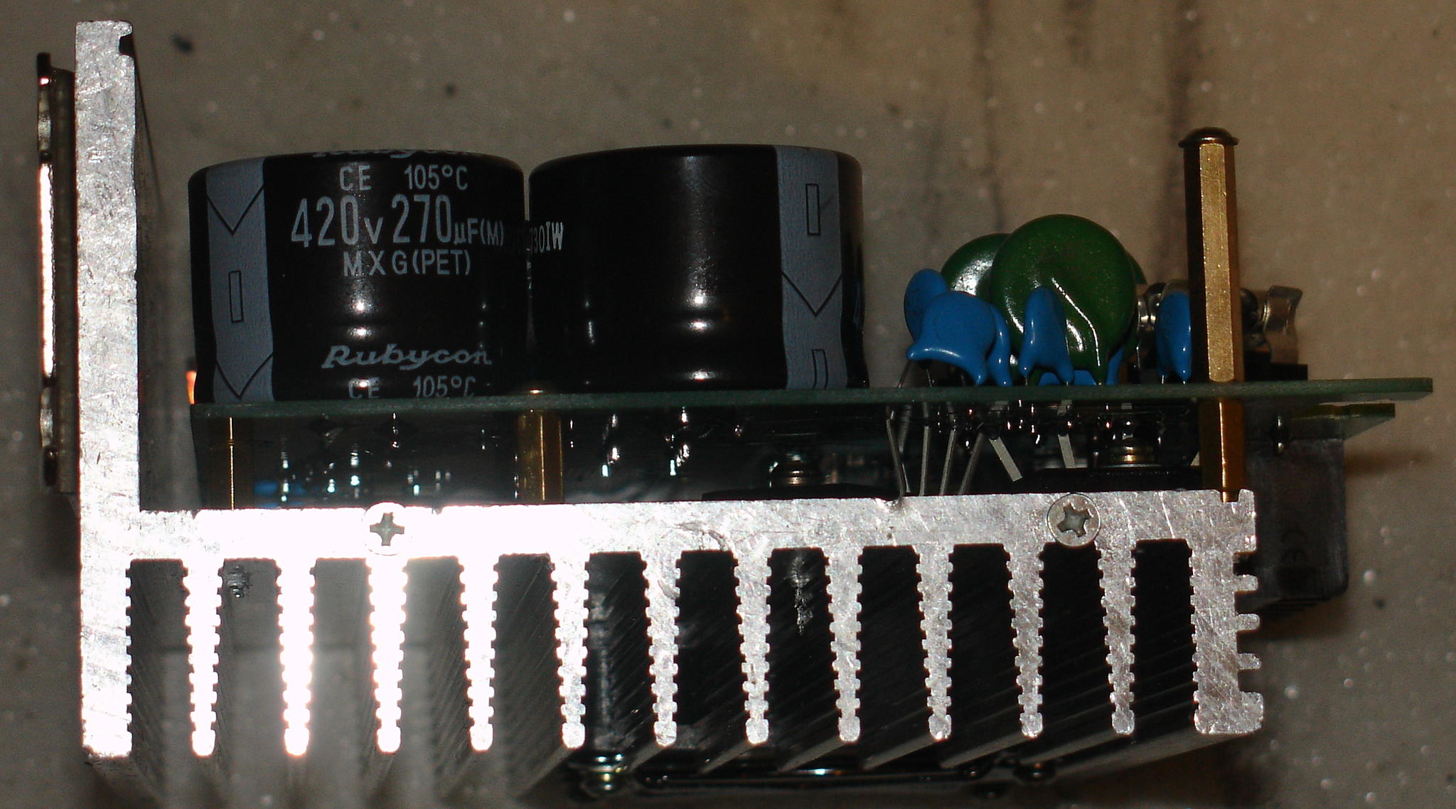

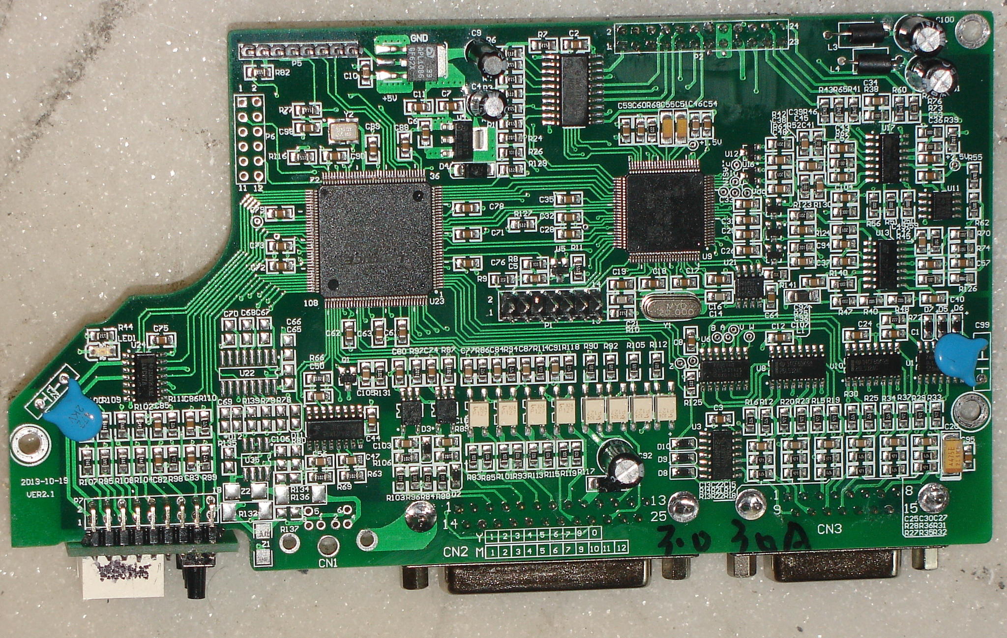

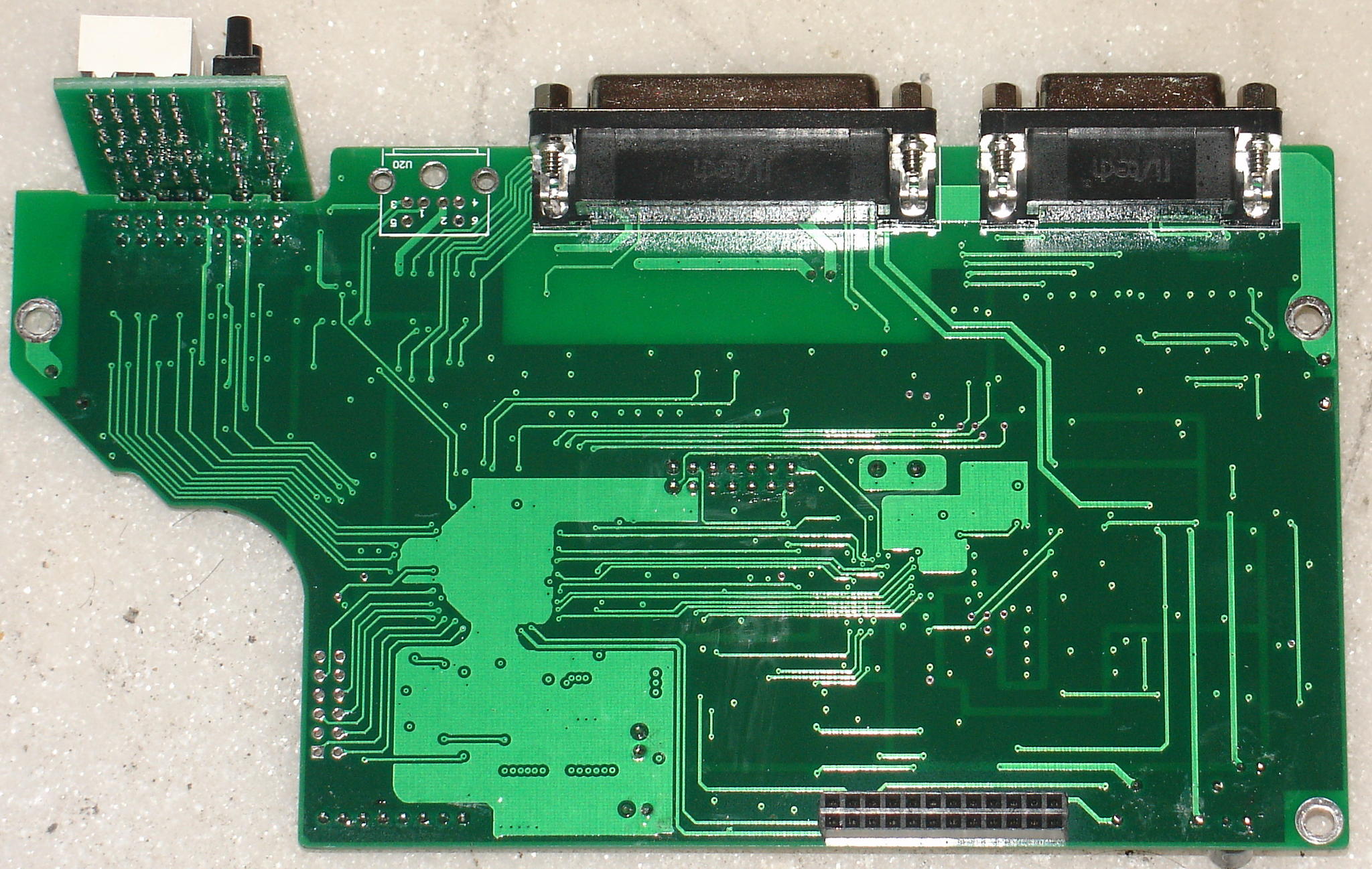

Some photos of this drive:
(You can see the big smoothing caps, the 2 rectifiers which are down from caps also you can see that pcb supports
CN1 connector but missing this connector and some smd components near it.
I believe that is rs232/485 connector. Has someone schematic to add the extra components ? )
Attachment 11092Attachment 11093Attachment 11094Attachment 11095Attachment 11096Attachment 11097Attachment 11098Attachment 11099Attachment 11100Attachment 11101

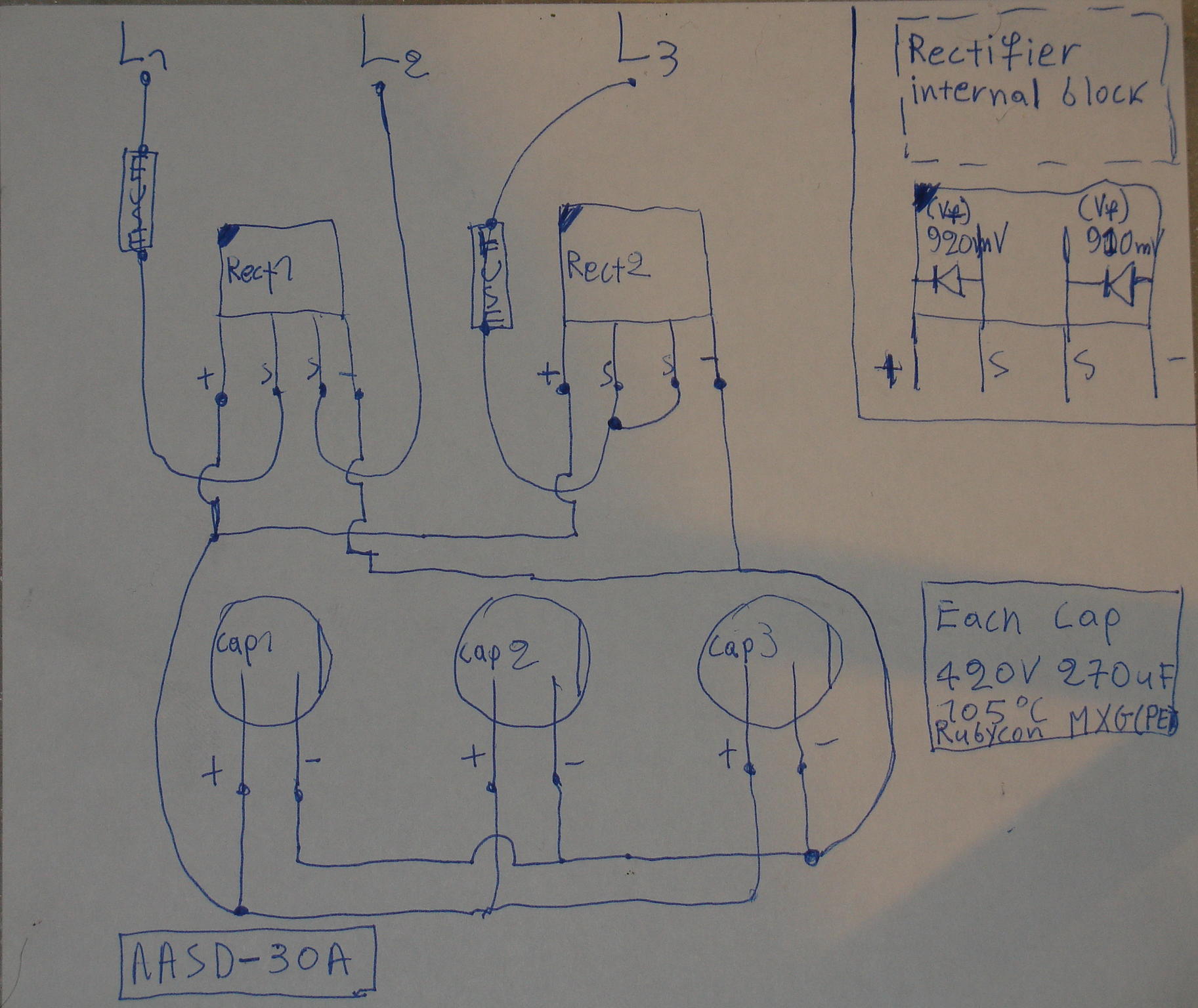

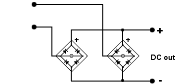

		I followed the pcb traces in AASD-30 servo driver and made a simple schematic
Attachment 11103

Not that i am an expert, but common sense tells me that by the way Lauren connected his drive he achieved nothing more than using only 1 rectifier, assuming his drive has similar schematic.
From what i see the way to use the 2 rectifiers will be to connect /phase and ground/  to each rectifiers 2 legs  /s and s /  in parallel which means the rect 2 s and s inputs MUST be un soldered or the path cut with exacto knife so that they are not together
It probably will work without problem with 1 rectifier.If is not possible to unsolder the rectifier legs or split the path with exacto knife, having in mind that on ebay are selling big heavy duty rectifiers for dirty cheap, just 1 bigger  rectifier and forget about connecting the second.
PS. Dont mess adding components, what is written on a board and is missing, does not mean you can add it without understanding what you are doing.

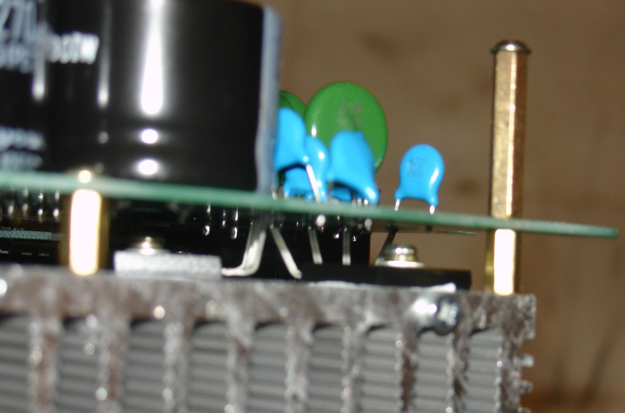

		The pcb over the rectifiers has some ceramic caps as shown in photos. So its probably better to not modify the pcb.
I will check what these small ceramic caps do...
I think (please correct me if iam wrong) that if you bridge 2 ~ of 1st rectifier (means to bridge L1 with L2) and connect phase/neutral to L1-L2/L3 i think all diodes (8 from 8) used without modifying the pcb.
To understand why this happens see following the image
Attachment 11114
(In second rectifier the 2 ~ are allready bridged so you must bridge the 2 ~ of first rectifier to make all diodes to work with single phase 230VAC)
I will check with oscilloscope if the smoothing in single phase is ok with default caps and if the driver need more caps for smoothing...
I have tested the servo motor/driver with phase/neutral connected in L1/L2 and L3 unconnected (using only 1 rectifier) and seems to working.
To use 6 diodes from 8 totally with this type of pcb wiring you must connect phase/neutral to L3/L1 or L3/L2 because the in 2nd rectifier
the 2 ~ legs are bridged. With phase/neutral to L1/L2 only 4 diodes of 8 used.
I have understand what missing components do. They are very cheap and i can't undestand why the manufacturer did not added them to give rs232/485 communication port.
The question is if LCMXO640C-3TN144C chip supports rs232/485...
Iam not having schematic for missing components but i found what they do.
U22 is a max232 ic (for rs232) and u35 is a sp485 ic (for rs485) 6 pin cn1 connector is a mini 6pin din ( PS/2 ) connector witch provides rs232 & rs485 connection.
I have downloaded the datasheets of these ics (show in example circuits adjacent components values) and followed the traces in pcb and from that i read in manual you send me i beleive that i would find the extra smd resistors/caps/choke coils/diodes.
I have already ordered from ebay max232 & sp485 also i have oscilloscope & some spare smd resistors/caps/chokes/diodes so i would try
to add in this servo driver serial communication port.
The is no risk to burn some critical because D11 & D12 missing diodes is for protecting the LCMXO640C-3TN144C chip.
		The bigger question is WHY? What benefit will you get adding rs232/485 capability? Seems a lot of work for little return plus the internal software of the VFD may not be configured to use it.
		No its not big work because i have PS/2 connector & spare smd parts
i have ordered 10pcs from each ICs (max232 & SP485) from ebay and i have allready found the most parts values.
The manufacturer price for this operation is only 50 cny ( 6 euros )
´®¿Ú¹¦Äܲ¹²î¼Û-ÌÔ±¦Íø so i will try to pay him to give me the values of components.
The driver supports rs232/485 with extra 6 euro.
I found manufacturer(perhaps wholesale seller) webpage: cnyfdz.com
Also i have tested the driver with the connection phase -> L1-L2 bridged , neutral -> L3 and works fine with using 2 rectifiers (8 of 8 diodes in the 2 rectifiers).
So this is the proper way to connect this drive in single phase 230VAC next is to measure DC bus for ripple on big electrolytic caps (with default 3 caps)
I want to connect these servos with pc (mach3) and because for first time iam using servos i need some help how to connect them with pc parallel port.
Here is the manual of this drive version 3 (in version 2 a lot of things are wrong/missing)
		I found all missing electronic components for rs232 rs485 connection (i have tested the connection with these components and works fine)
R78 470R
R79 470R
R134 4k7
R137 4k7
R80 5k1
R135 5k1
R139 5k1
R132 10R
R136 10R
C65 1uF
C66 1uF
C70 1uF
C67 1uF
C68 1uF
C69  0.1uF
C106 0.1uF
D11 S4 signal diode
D12 S4 signal diode
Z1 SMB 6.8CA TVS
Z2 SMB 6.8CA TVS
U22 MAX232 16pins  (with MAX232A C65 C66 C70 C67 C68 = 0.1uF)
U35 MAX485 8pins
CN1 PS/2 connector 6pins (The holder for the fuse in L1 line must removed and the fuse must soldered without the fuse holder because there is not enough free space for PS/2 6pins connector)
Also the new version of manual ASDD-30A ( v3.1 )
http://www.filedropper.com/asdd-30aenv31
http://www5.zippyshare.com/v/38122167/file.html
http://www.filedropper.com/asdd-30acnv31
http://www5.zippyshare.com/v/13393384/file.html
