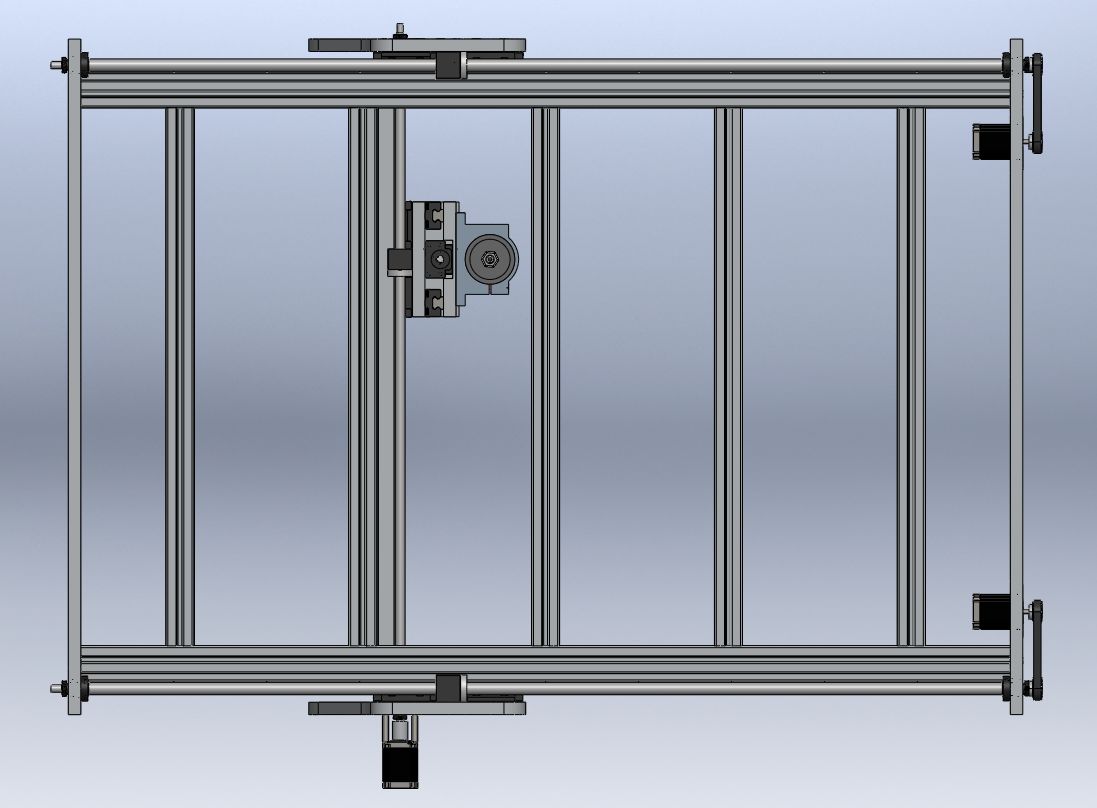

5 Attachment(s)
Re: 1rst build, time to do next step

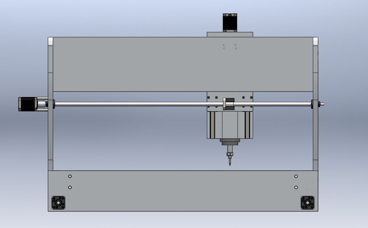

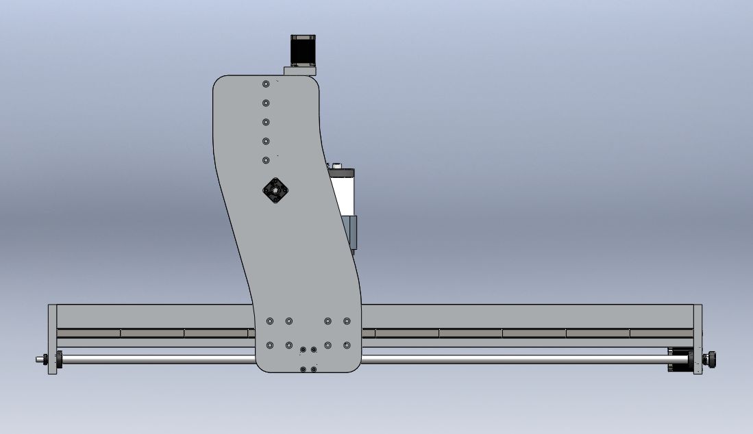

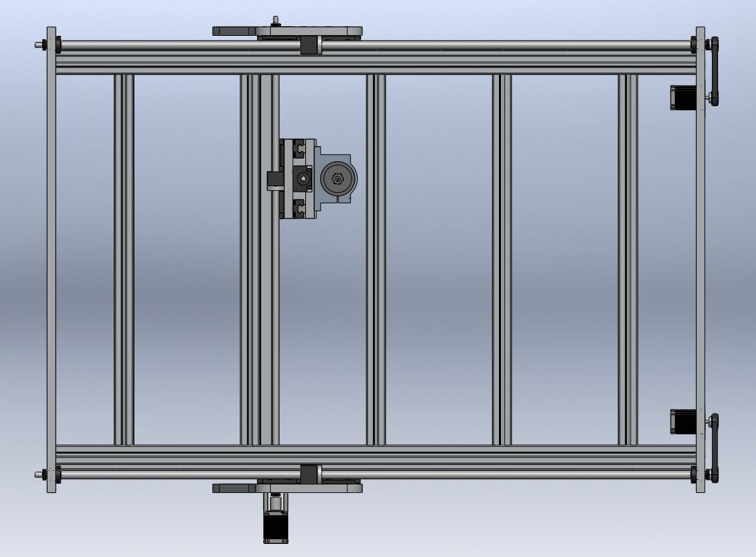

Hello,
quick update., the Version_2 is nearly done.
now I thinking about X axis ball screw fitting,
my very first idea was to put it between the aluminum profiles, but now I'm not sure or it good idea, I think distance is to big between rails and screw approx.150mm?
what if I run it through the side plate support box?, right now there is few brackets., just one what I do not like, that the screw will be very few cm. above the table.
But maybe I can fix on each side of the box some brush or seal to wipe the dust away from screw ?
btw, what about design? Version_2 will be stronger then the first?
There are two areas that look like they need strengthening on that design. The bed plate needs support otherwise it'll bounce and flex like nobody's business and you'll get a crap finish. Can you not just use the profile as the base and put profile laterally across under the bed plate to stiffen, seems like there's an awful lot of empty height under the bed plate?
The Y axis plate also looks like it needs a length of profile or two behind it otherwise it might also flex when cutting in the middle of it.
Hope this post doesn't sound negative, just a couple of observations :)
Hello Neil,
I just forgot to mention that now I working on Z axis, and this table top sitting just to see what travel I need in the Z or how low bed has to be.
Sorry for confusing you
Gytis
Okay you want to build an all round Gantry router to cut up to aluminium. Lower your bed and re-enforce it as suggested though don't over do it too much (we DIY folks do tend to over build). I would strongly, strongly suggest putting the Y axis screw behind the gantry beam if at all possible. it reduces issues with swarf and makes lubricating it much, much easier.
Go looking through the build logs as I know there is some very good designs there. You don't have to use any of them but they do give a very good head start. Also I don't see allowances for cable paths; that is something you really want to think about now. later it will bite your back side and cause issues (I can think of a few members who can tell about the headaches of wiring gone wrong).
Jonathan is correct that at that length 1610 will do you well and you can always work with the pulleys to get the resolution you want.
Good luck and keep asking questions.
Jonathan, Gecko are good equipment and they stand behind their warranty as more then a few folks have proven. Yes, they are a bit costly but they are serious kit for some one wanting a business level ROI (return on Investment). Next you will be telling me my Leadshine AM882's are over kill. Horses for courses.
-Michael
PS Contrary to my long absence I have not died nor fallen off the face of the earth just been very very busy.

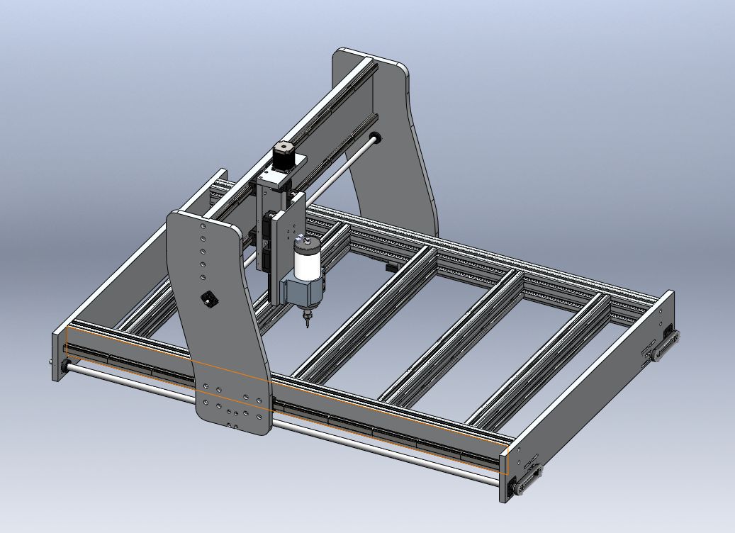

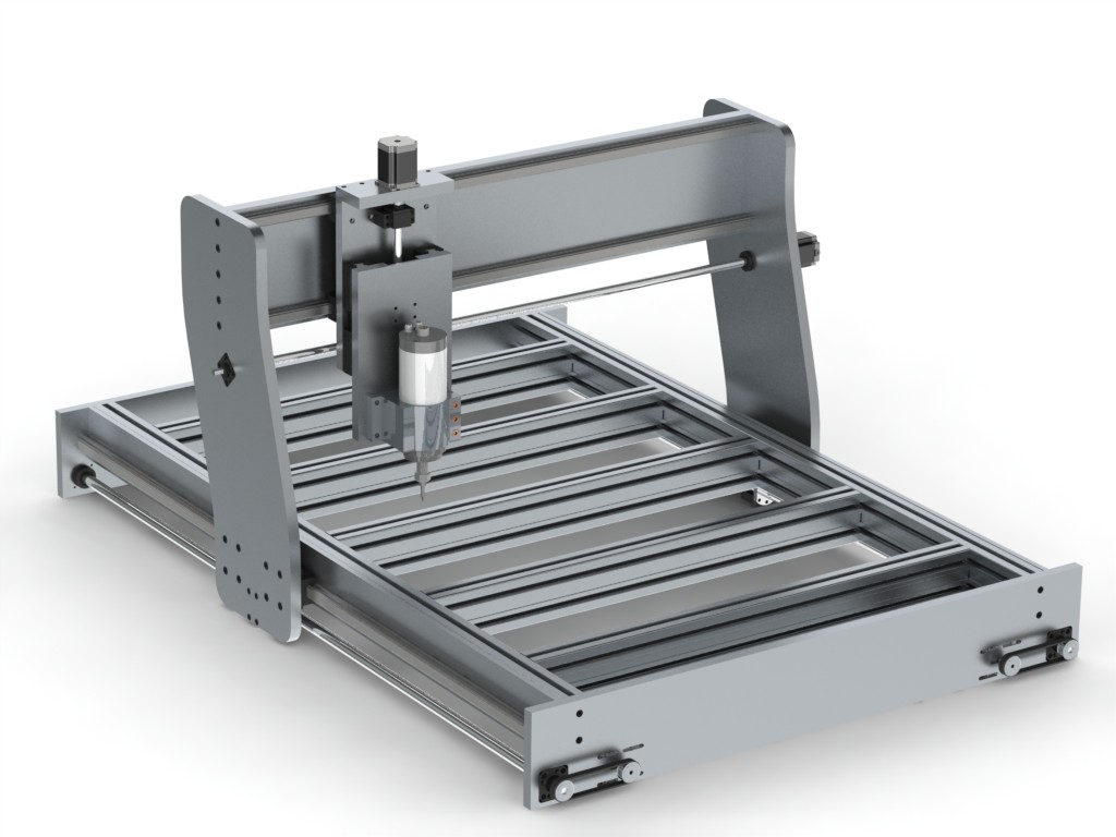

5 Attachment(s)
Hello,
OK guys, this is my new gantry and Z axis, I hope I'm in right direction this time to have a strong gantry? I'm just worry now about the weight, now solidworks showing 70kg.,
this is not too heavy for motors 380oz(2.68Nm?)?
Thanks in advance!
6 Attachment(s)
Presuming this is all ALU plate.?
Quite a bit of unnecessary weight on there.?
Don't need inner and outer gantry sides or spacers between them. They add very little extra strength only excess flab
Don't need the all the Motor plates etc sitting on gantry side and could just mount motor on inside above screw and thru gantry side if single gantry side.
Don't need the piece that Y axis ballscrew fastens too with small change of design.
The cross piece that rails sit on still looks like single piece of Alu with no bracing.? This is the major weak area which will flex under cutting conditions.
I've built a gantry using plate like what you seem to be wanting which is very very strong. With just a few changes it's half the weight and much stronger and lot neater. It protects the ballscrew and motor by completely encasing it. See pics of it part built and Cad model.
Actual Design was modified to Cad model and ballscrew raised and Motor brought inside gantry connected to screw with timing belt.
Pics of actual machined parts are only for visual purposes.!! IE ballscrew sat on offcuts to show rough position with quite a few pieces like bearing plates and strengthening braces missing.
There's also braces inside the Gantry which are not shown in Cad or pics. The Z axis motor mount is also different and doesn't use upstand pieces shown in Cad instead using a solid 2 piece machined spacer part which covers belt/pulley.
Hope this helps.!

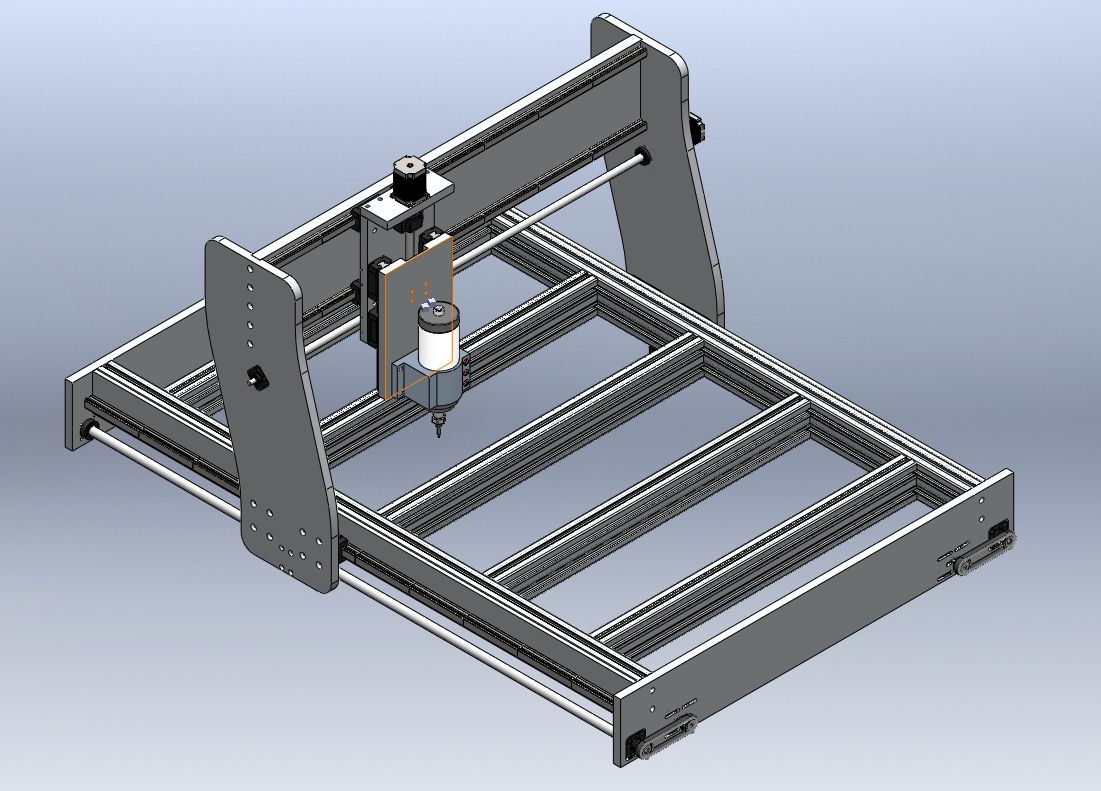

4 Attachment(s)
JAZZCNC
Thank you for pointing it out!
Well, now I have redesigned gantry, this time I took JAZZ ideas (hope you don't mind JAZZ?),
not yet finished but you can see general idea.
Gytis
Nope don't mind at all, only show what I don't mind being plagiarized.!!
Couple of pointers to avoid pit falls which can easily get ya.?
Slot will probably need lifting (or lowering).? Reason being chances are you won't find a timing belt short enough to keep slot in middle and still fit motor in.! The pics don't show it but the slot is offset towards top, the Ball-screw actually mounts above the slot. The ballnut fastens on top side of plate that fastens to backside of Z axis rear plate.
Would use BK/BF not FF/FK blocks mounted straight onto rear of front plate then you can get rid of those plates. Will also make assembly much easier.
With rear covers Instead of 3 flats I'd consider having a nice Arc so single piece of plate bends and follows it's shape instead of 3 separate plates.
On my design I've done it slightly different with the top/bottom rail plates shaped then single 2mm plate bends and follows shape when fastened. This way less work in making the braces and less needed has you don't need any near gantry sides to old the shape.
I'd also beef up the braces just removing enough material so Ballnut passes thru.

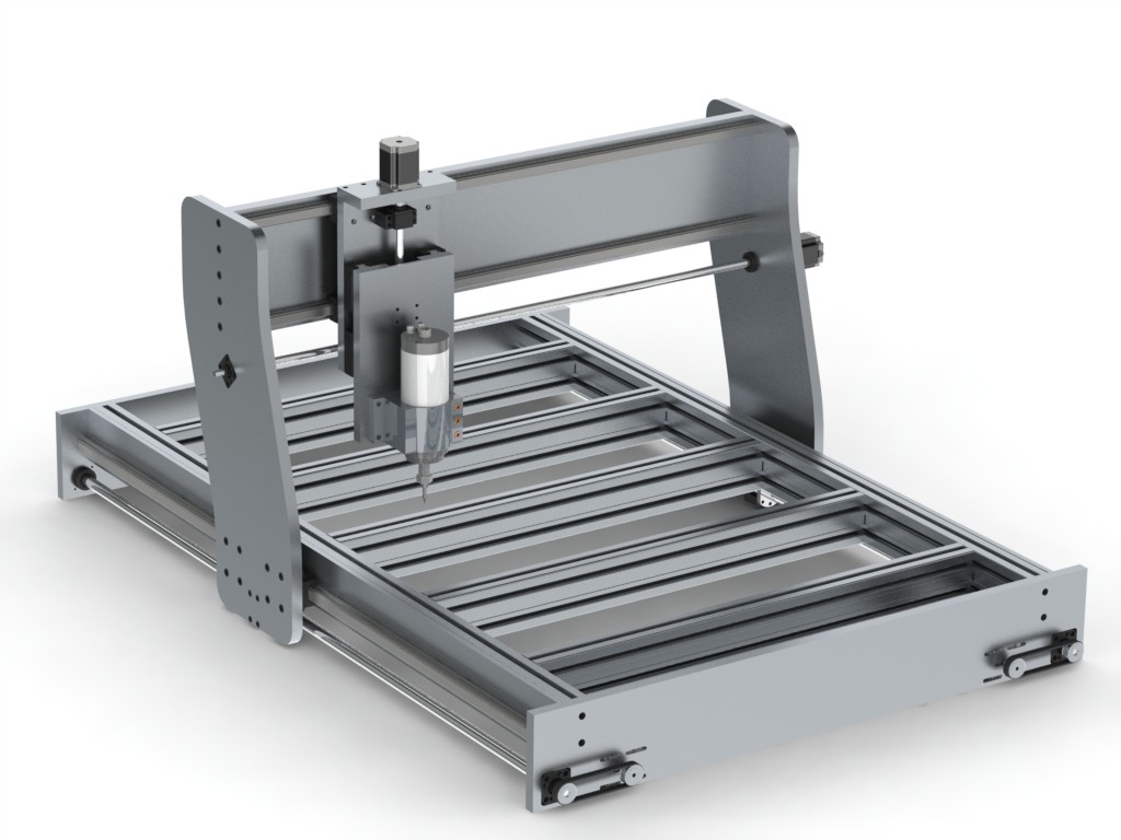

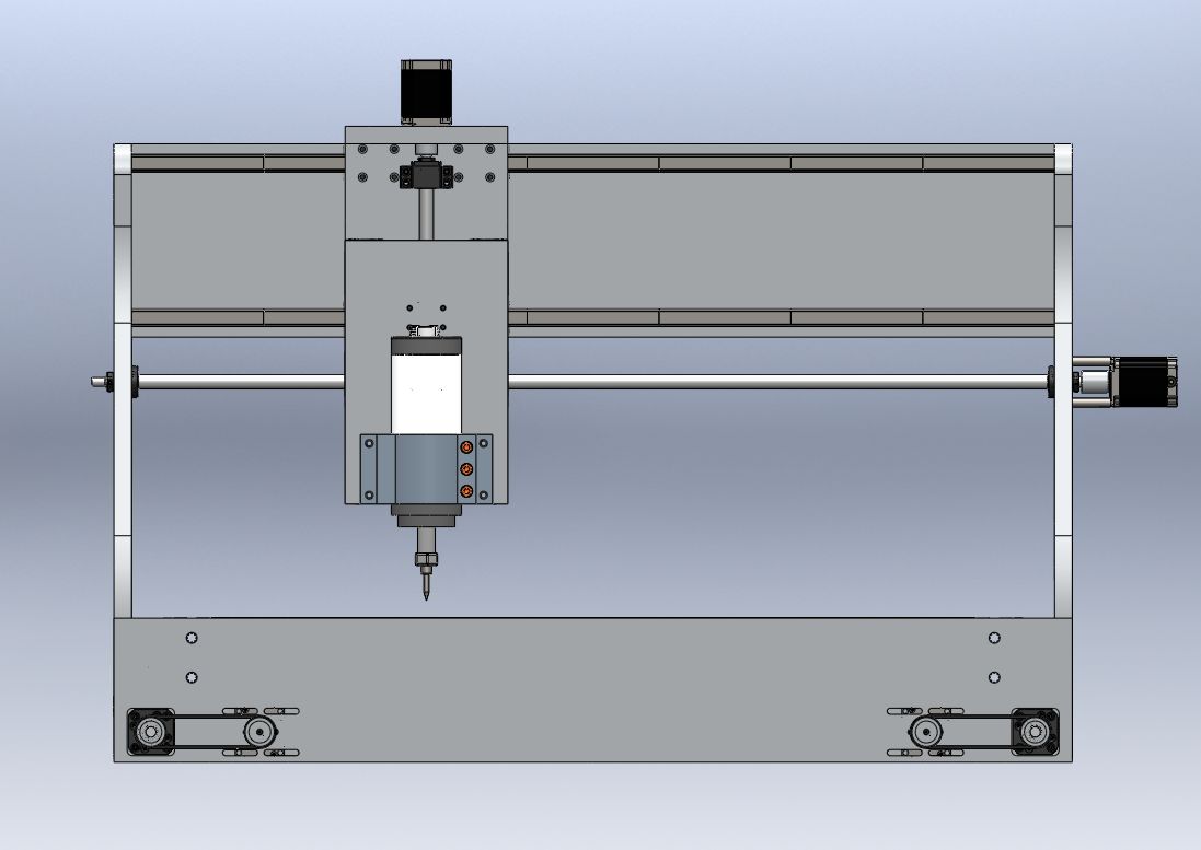

6 Attachment(s)
JAZZCNC
Come on JAZZ!, show your secret projects:link:
I left slot in the same position, just lifted ball screw up as you suggest, I think now there is enough space (in the model now fitted T5-20 tooth pulleys)
I did it, now both sides BK fitted. It really makes difference in assembly, and less machining in the parts.
well, arch is nice but I followed the angle of side plate, that's why I made braces like this shape, 3 plates is just in the model, in real life it will be in 1 piece (I hope).
Thanks for the useful tips JAZZ !:beer:

And finally, one question:
timing belts width 15mm or enough 10mm ?, pulleys T5 or different?
Thanks to all !
15mm and T5 . . . Don't go less than 18T on the pulleys and I find 20T the best for belt life and fitting etc.

5 Attachment(s)
HI,
this is my almost finished CNC machine model,
bed is from the aluminum extrusions (heavy) 90 x 45 and 45 x 45, it will cost me about 800 eu + delivery?, only for the extrusions!:dejection:
overall dimensions (bed) is 1590 x 1250 x 590 mm.
Wow your really making that harder and more expensive than it needs to be.? Also has a flaw.?
First I'd use Steel for the frame and save 600eu.!! . . but that's not what I mean here.?
Orientate the side profiles on there edges and you'll gain strength and be able to do away with those aluminium braces and the 2 long middle profile, then Extend the 3 uprights to meet top rail.
Put the ball screws on the outside and make drop brackets part of gantry sides, sides will be shorter than drop bracket, less material,weight,money. Easier to setup and adjust screws/motors has they are more accessible. Then you can line the inside walls doing away with the slot and stop crap hitting the screws completely.!! . . . . Your way has a BIG flaw in that it will allow chips into the sides, still hitting screw and eventually filling up the sealed cavity.:thumbdown:
You'll be constantly cleaning it out and believe me it won't take long to fill the void between middle profile and slot. Chips spray in a linear direction off the cutting tool and that Gap is in direct firing line so you'll be surprised just how much disappear thru it.!. . . . Kid you not Bet I could fill that gap with alu chips within 3weeks and that's allowing for sizeable percentage not hitting slot gap.!!!!
One other thing.?. . . If those bed supports are 45x45 then I think you'll find there not strong enough at that length and allow bed to potentially bow in centre when cutting or plunging. My suggestion is to put 2 or 3 45x90 on there edge for main supports and make rest up with 4x45.
Sorry to keep pulling at your designs but with experience these things just jump out at you and I'd feel shit if didn't mention them, then at later date you came back and said wished I'd done this or that which I'd spotted.!!
