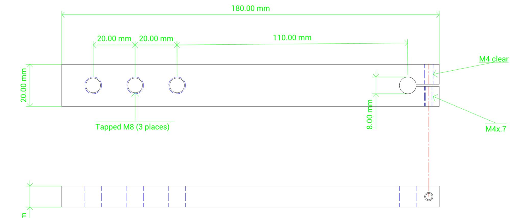

Parts for hand ergometer (exercise bike)
Following on from the project thread and some redesign I now need some parts made. Happy to pay reasonable rate for work and materials (given situation it would be easier if you can source them), not looking for charity (but not going to turn it down either :biggrin: ).
The first drawings are for handles & crank assembly, others to follow. Ideally I'd like to get these done within next month. PM me if you can help.
Attachment 9387Attachment 9392

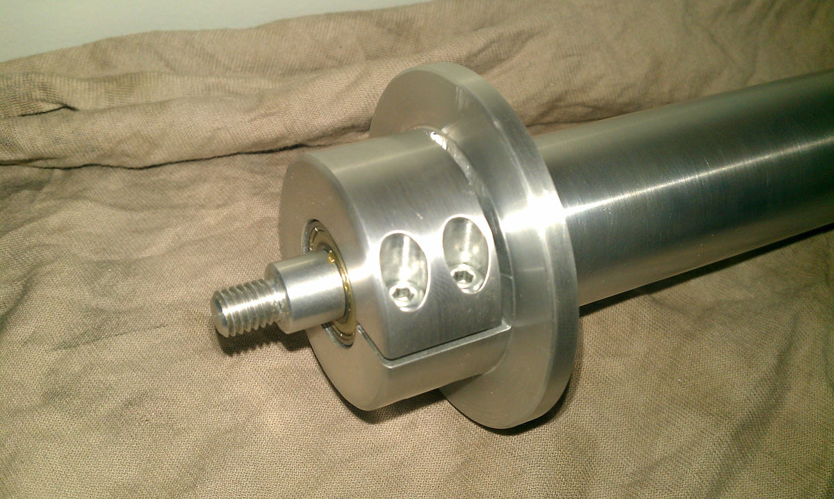

With regard to current drawing for handle, is depth of boss (10mm) into tube enough or should I increase to 20mm?
The axial slot on the larger side of the boss is to allow the cross screws to clamp the outer shells of two 10x22x6 bearings. I copied this from an existing assembly which I couldn't dismantle. Will this work or does it need a slot radially where the clamp section meets the 64mm dia, 3mm thick hand guard section to allow the clamp to, well, clamp?

irving2008
Yes more the merrier I think considering the handle is 150mm long thats not much holding it.
irving2008
Know what you mean and yes it would clamp better if this was slotted.
I'll PM you Email address.
Re: Parts for hand ergometer (exercise bike)
Hi irving
If i was making the handle assembly i would manufacture from one piece of ally with an interference fit for your two bearings. also make the 150mm length 22mm Dia & then you can fit some proper cycle handlebar covers.I bought that ring gear just to see if i could work out the gear form(probable modular) don't know if the required wheel size will mesh though as the mating components from the hub it came from are rather small.
Take care M8

Thanks for your input.
I had considered machining it from the solid but thats a huge amount of wastage of a 65 or 70mm bar x ~350mm. Thats over £50 +p&p on ebay to throw 50% away! However if someone wants to provide the stock for free then I'm not proud :biggrin:
Not sure a pure interference fit would be stable enough and all the designs i looked at use a clamp arrangement with either one or two clamp bolts. Two bolts might be overkill tho.
The diameter of the grip needs to be much bigger than a normal cycle handle bar as I cant wrap my fingers that tightly. The 32mm dia is the same size as the one I use at the rehab unit and will be wrapped in bar tape or sleeved with rubber tube heatshrunk on.

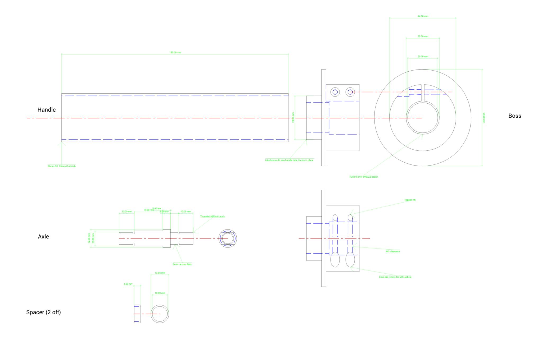

2 Attachment(s)
JAZZCNC
No problem if you want it from Solid Irving I can sort that, thou it will mean a slight delay has I have to get from a mate.
Prefer the tube approach as less inertia as well.
Whats your view on 1 v 2 clamp bolts?
Updated drawings attached. I've only taken the radial slot down to the top of the bearing, think that'l give enough movement?

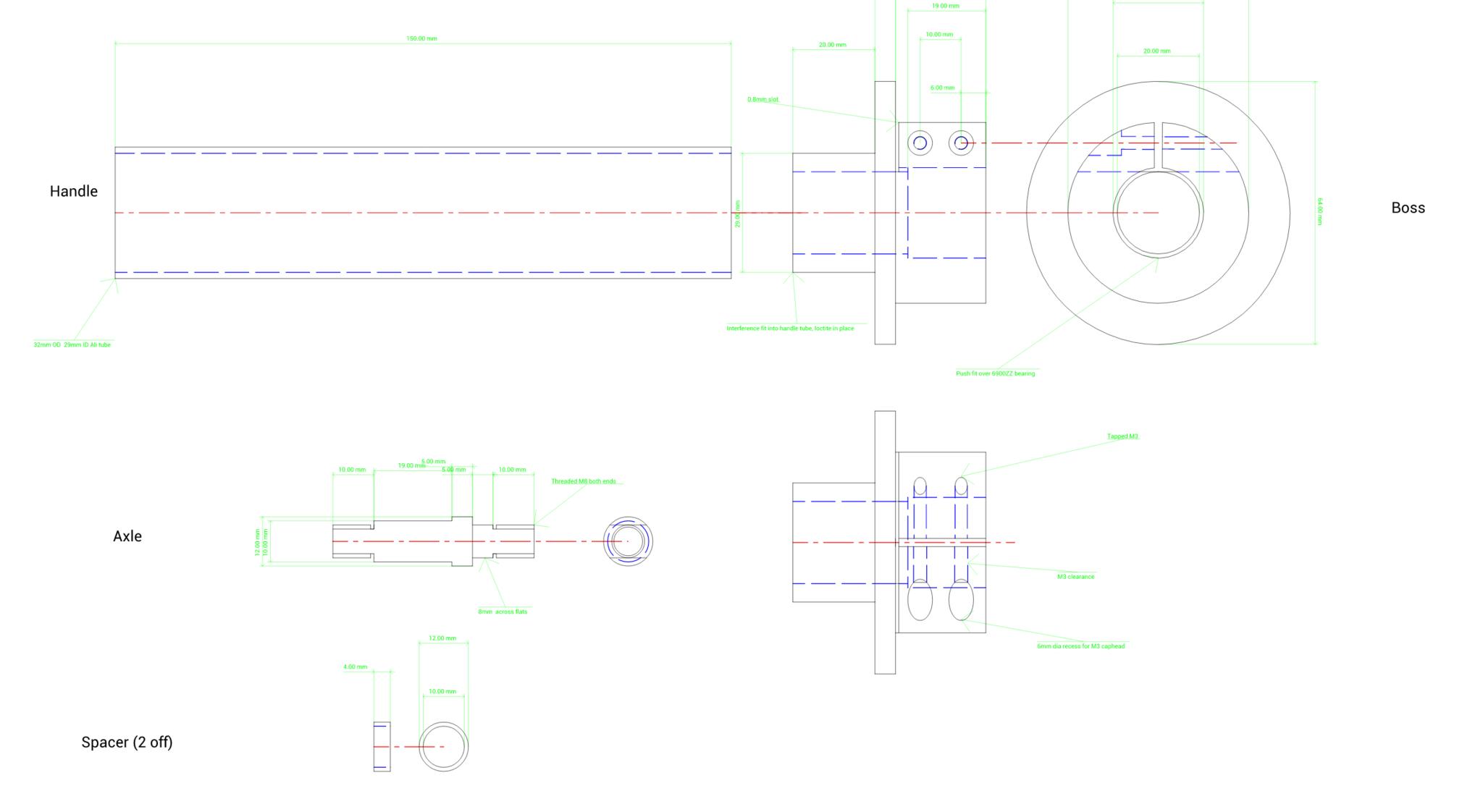

6 Attachment(s)
irving2008
Personally I'd have gone for solid and let me take the weight out of it by boring.!
Regards clamps bolts then probably 2 has it will clamp more even. How many bearings are you planning on using.?
Also the specs for 6900zz are 22x10x6 and if this is being assembled like I think (see pics) then you have allowed for 2 bearings @8mm is this correct.?
See pic6 and you'll see what I mean with 6mm bearing and 4mm spacer between, it leaves shaft sticking out.!
Let me know if I'm wrong and if this is the final drawing.
cheers
Dean.

Dean,
If you prefer to machine from solid and dont mind the wastage feel free :biggrin: I went for the lowest cost approach.

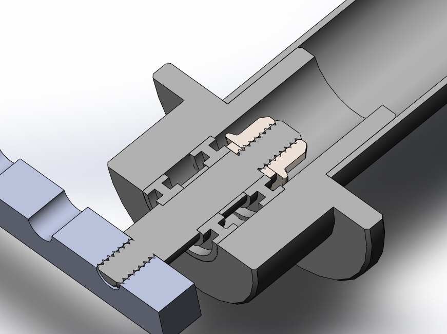

When you say 'shaft sticking out' I assume you mean the inner end of the axle? Thats why there are 2 spacers, the second goes on the end of the axle and a standard M8 nyloc nut & washer bears against it. I did it this way as in the past i found a M8 nut is too large and fouls the bearing outer race (da max for bearing 12mm, A/C for nut is 15mm) and turning an M8 washer down to 12mm is fiddly.
But if you have a better solution....
irving2008
Dean,
Ok will do not a problem just small delay on material, which I've sorted. I Should have material for weekend so will do it then.
irving2008
Ah ah my mistake didn't see x 2. . . . Lol . . . . Thou think it better to space the bearings far apart has possible so I'd be inclined to make a washer, so I'll do that if you don't mind. I'll make wider spacer and turn a washer down, turning washer down is easy enough so no problem.
Like this. Attachment 9440
That works for me!
Those renderings are great, really helps to visualise things. What are you using? Sadly there's nothing that runs on Android that does that.
I'll post other drawings tomorrow, need to review them to see if I can simplify them.

[QUOTE=irving2008;47875]That works for me!
second that jazz, very impressive.
irving2008
That works for me!
Yes 3D models are great for showing visually unfortunately software to do this quickly and easy is not cheap. These are done with Solid works and it's bloody expensive fortunately I have it thru business so effectively tax mans bought it or should say not getting it. . .Lol

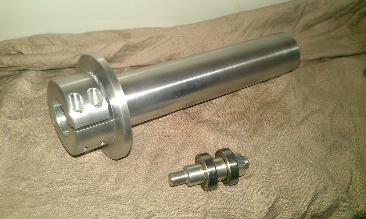

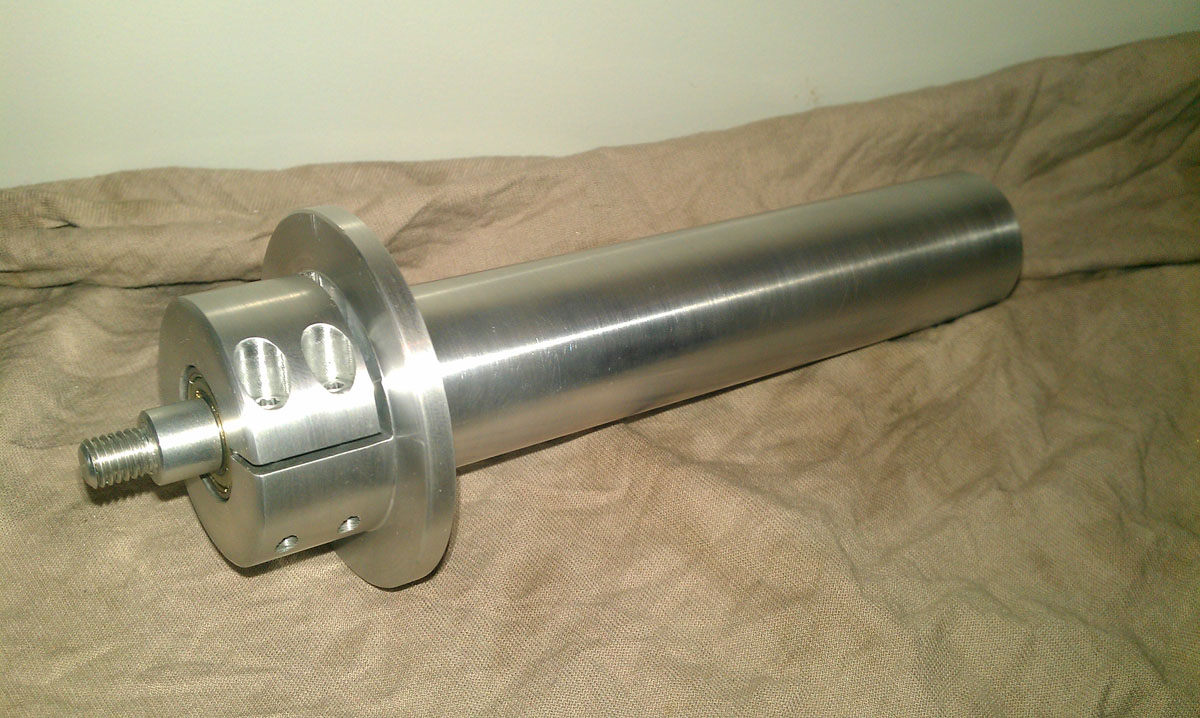

3 Attachment(s)
Hi Irving,
Nearly done mate had loads of problems with Lathe and my dosy mate bring me wrong stuff.!! . . . But here's a couple of pics to wet your appetite. Just got flats to put on pin and whip crank up on CNC machine then done.
Attachment 10136Attachment 10137Attachment 10138
Dean.
Very nice Dean, how did you do the split to make the clamp bit? ..Clive
Clive S
MAGIC.!!. . . . . . . Or . . . 1.5mm end mill in cnc machine. . .Lol
