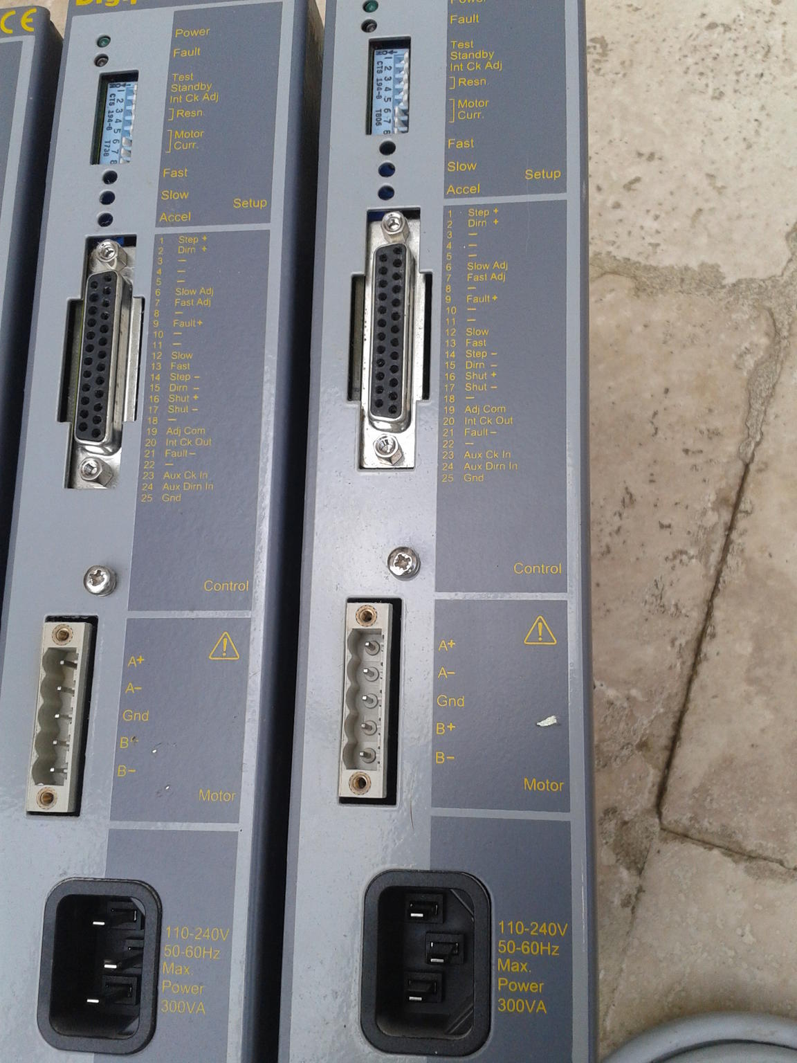

need an experienced eye to cast a look over this driver

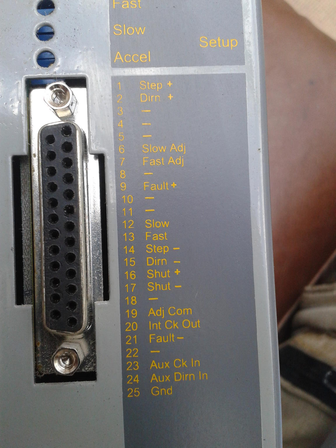

got these from a scrap machine, as they look quite professional though maybe i could use them on my upcoming build, i considered if i could connect the break out board correctly it should work (should is the magic word), after all it only needs a few wires connecting to get it going, i did like the fact it only needs 240v kettle lead to work , no need for power supplies although i did get a switchmode supply and a 4 way indexer which im sure i dont need, cheers Nik
Attachment 9455
Attachment 9456

Looks like step and direction into 1 and 2 then 14 and 15 link together and go to ground on the BOB
No idea how you set amperage though ?
Re: need an experienced eye to cast a look over this driver
any part numbers or other identifying marks?
John S

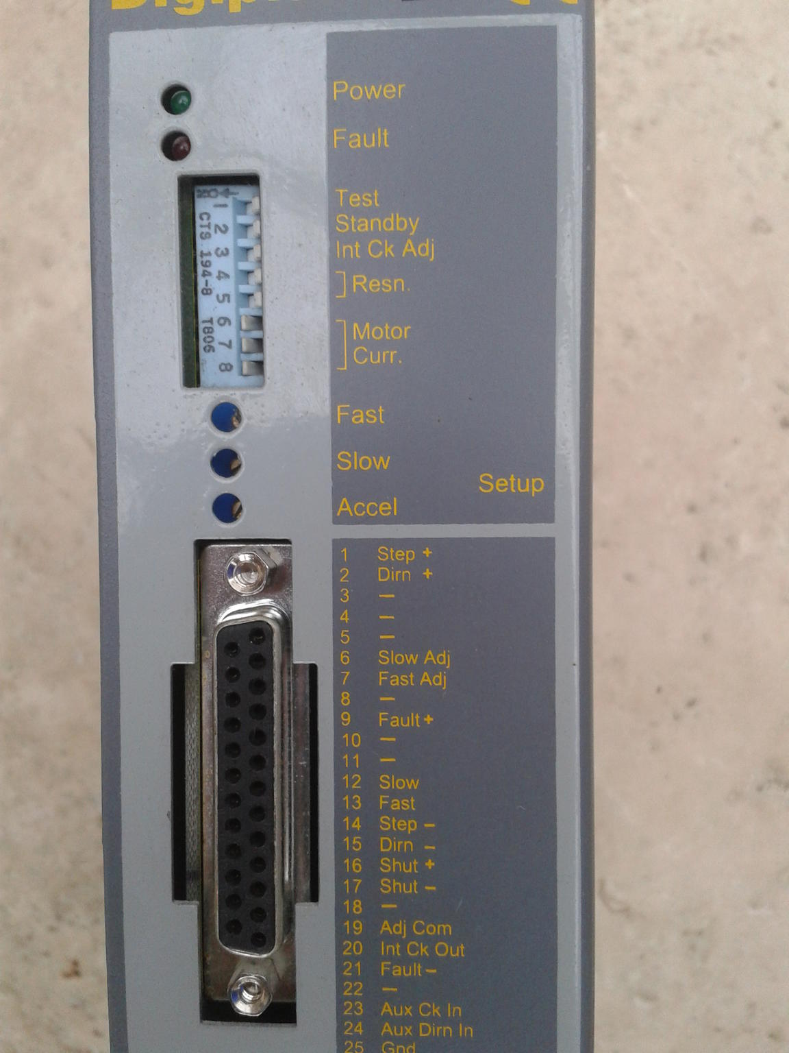

Looks like the dip switches at top John.?
Can you show pic of those switches Drnik.
The bottom 3 switches of the top bank are labelled 'motor curr'. Also 2 switches labelled 'resn' I'd guess are microstep setting?
More intriguing are the 'setup' trimmers for accel, etc.

irving2008
Hi Irving
These are used with DIP Switch 3 where you can have internal speed control.

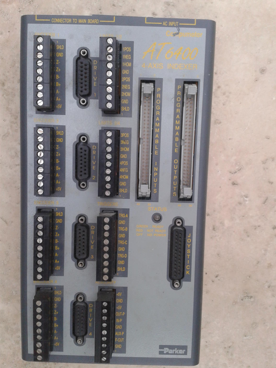

3 Attachment(s)
well cheers Andy, i'll post these pictures
Attachment 9494
Attachment 9495

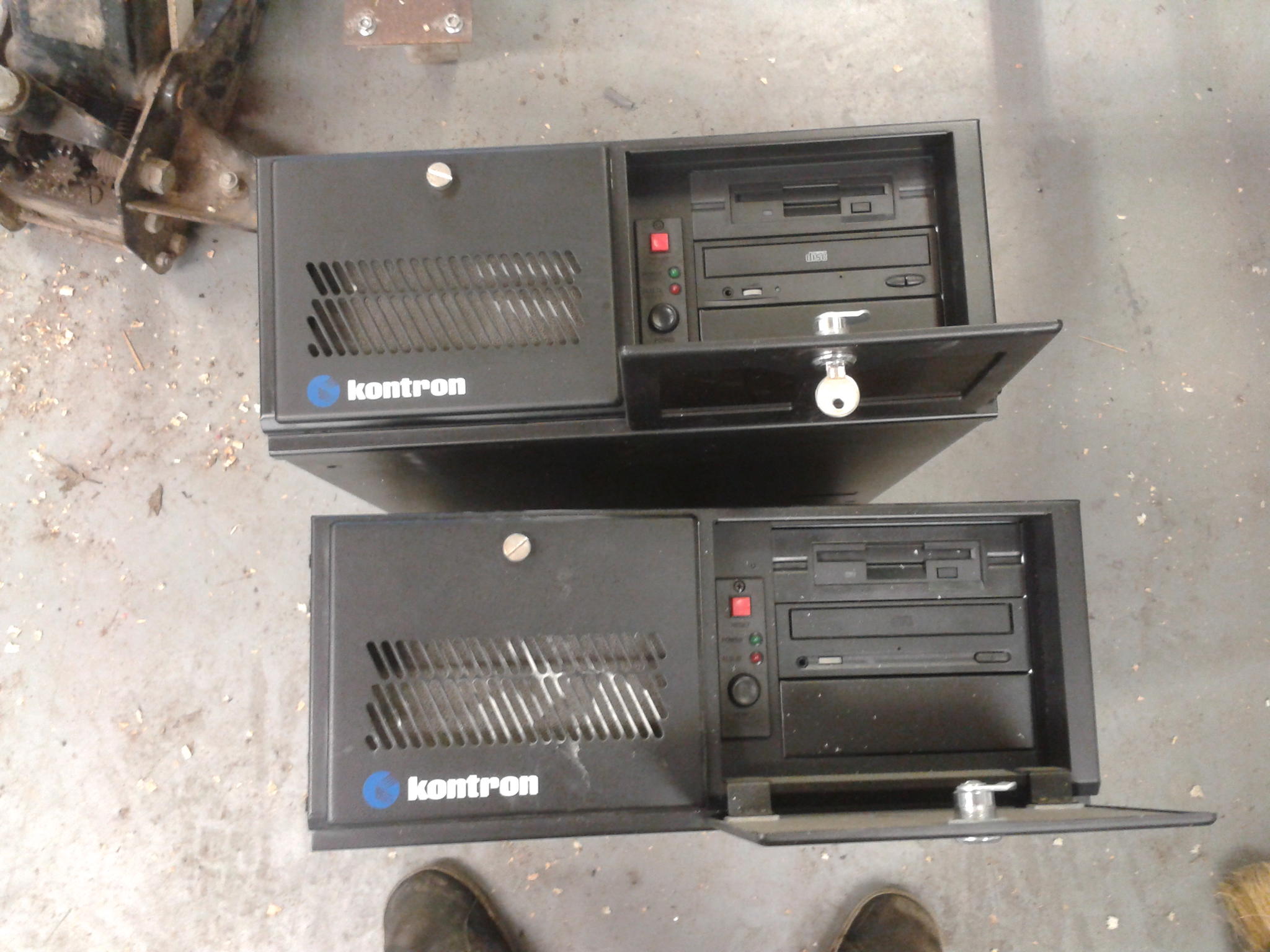

i also got this as it was attached to the 3 drivers, im not going to be using it,
Attachment 9496
Manual here http://www.parkermotion.com/manuals/PD/PDS_E.pdf
2.5A min, 5A max driver in 350mA steps
step settings 400, 1000, 2000, 4000 (i.e. 1/2, 1/5, 1/10, 1/20)
opto-isolated inputs
regenerative dump circuit
irving2008
is that good???? ive looked at the manual, but how easy is it to connect to a BOB board (if it can be run off a BOB board)
Hi Nik
The 6400 is a programmable motion controller we have some of the old 6200 which I have programmed, not really any good for CNC.
You will have no problem running the drives from a breakout board.
I have some of the same drives which I removed from decommissioned equipment at work, I haven't had time to play around with them yet.
Is there anything in particular you want to know about the drives?
Andy
well as they had their own mains connection i did think i wouldnt need a big transformer or power supply to run my motors, thus an easier way to supply each motor, being a newbie i was hoping it was a simple act of connecting to the right break out board and they would all work in harmony, but as i didnt give anything for them its no loss,
what actually comes out of a break out board to in turn make the motor driver do what it does
DrNik
Just a 5 volt signal,the direction signal is either high or low which determines which way the motor turns and the step signal is a pulse (square wave).
If I get time this weekend I will connect one of the drives I have to a motor and have play then let you know how I get on.
Andy

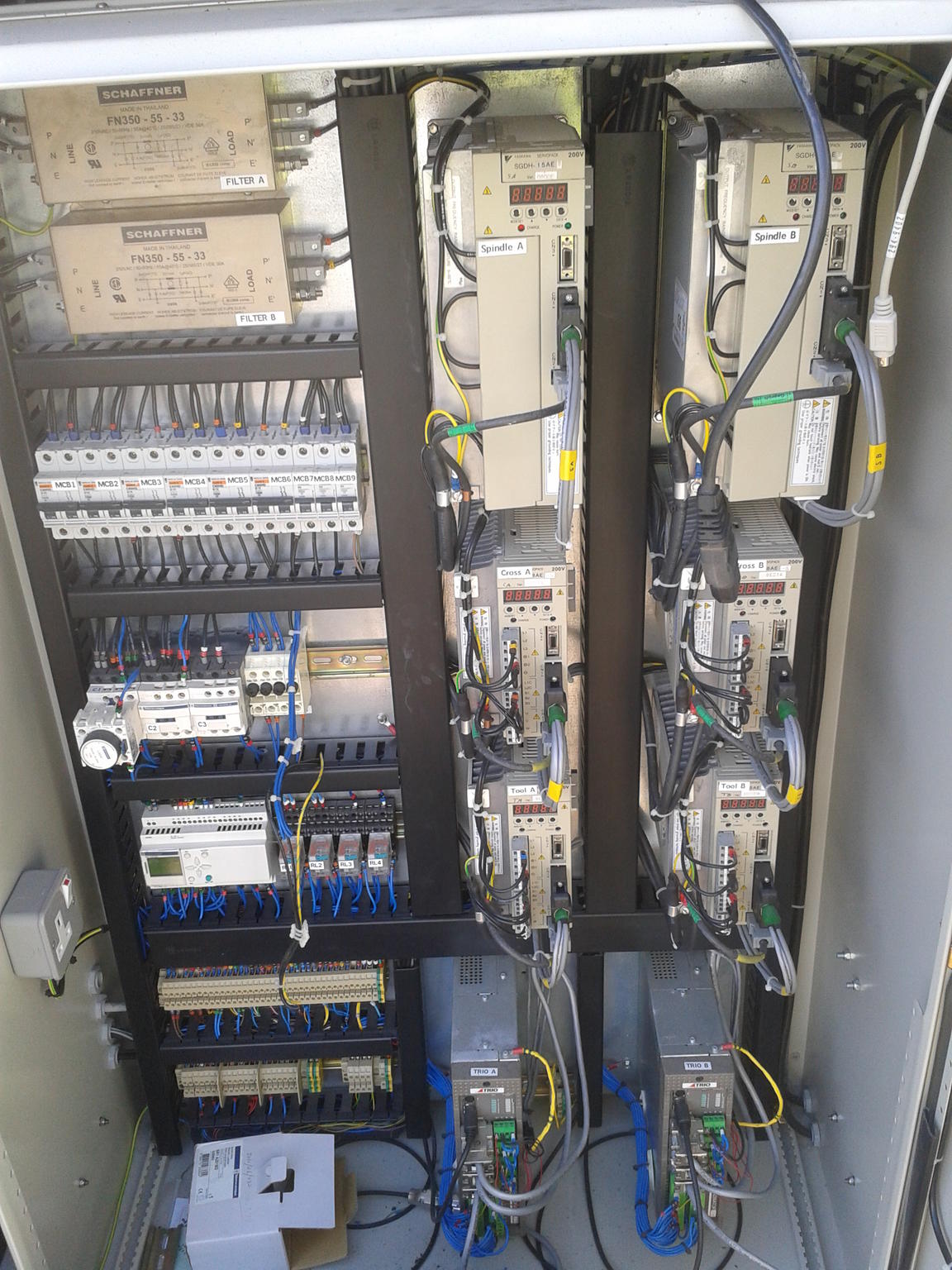

4 Attachment(s)

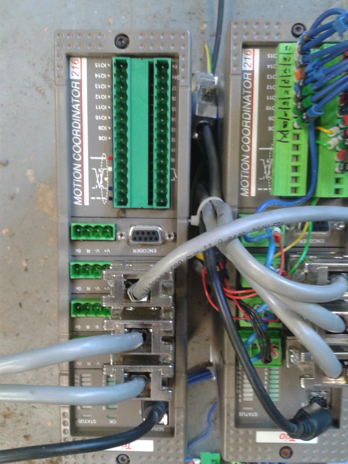

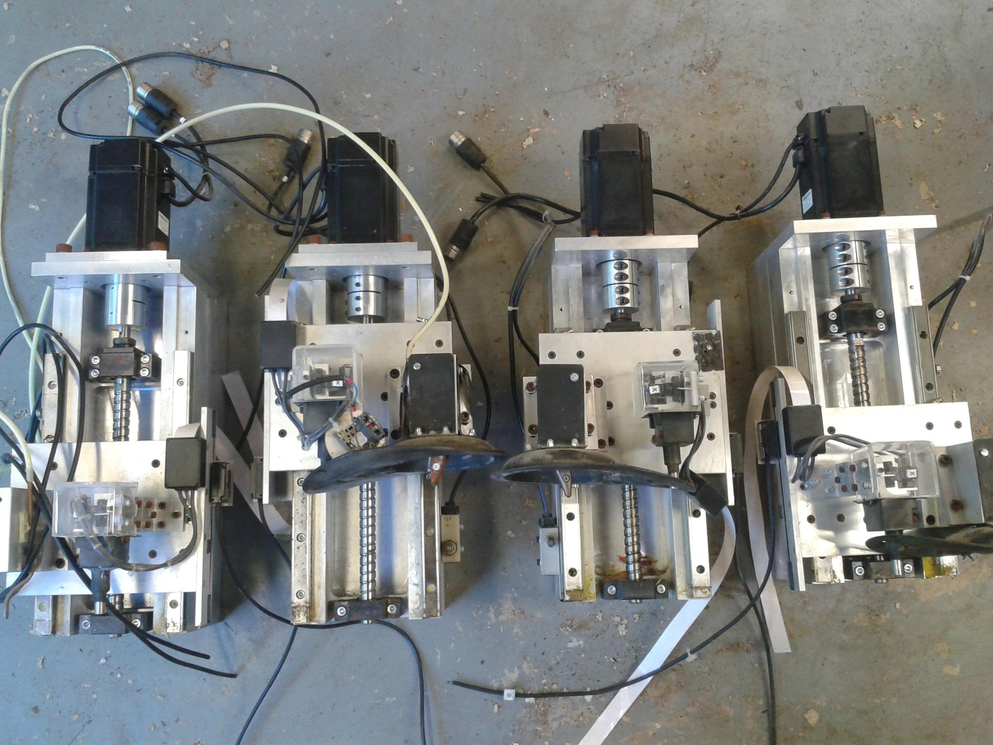

thanks andy thats great, but.........well it gets worse.......... popped in to see a mate today, id mentioed i was going to build a cnc plasma and should he come across anything keep it for me, well.............
Attachment 9518
Attachment 9519
Attachment 9520
Attachment 9521
ive got 5 decent sized machines, was in excess of £125,000 each, all with 2 heads that machine 2 items at the same time, so ive got 10 lots of z axis setups,everything to run them as a stand alone system, even temperature controllers to keep them warm/cool, i'll list everything one ive managed to strip just the one, but take a look at the pics and see you guys think
WOW, I wish I had a friend like that. Well done!!! G.
Hi Nick
Looks like you might have some useful stuff there.
The Trio Motion controllers are pigs to program (in my opinion anyway)we had a machine at work that used them we ripped them out and replaced with the Parker stuff.
Keep us posted.
Andy
