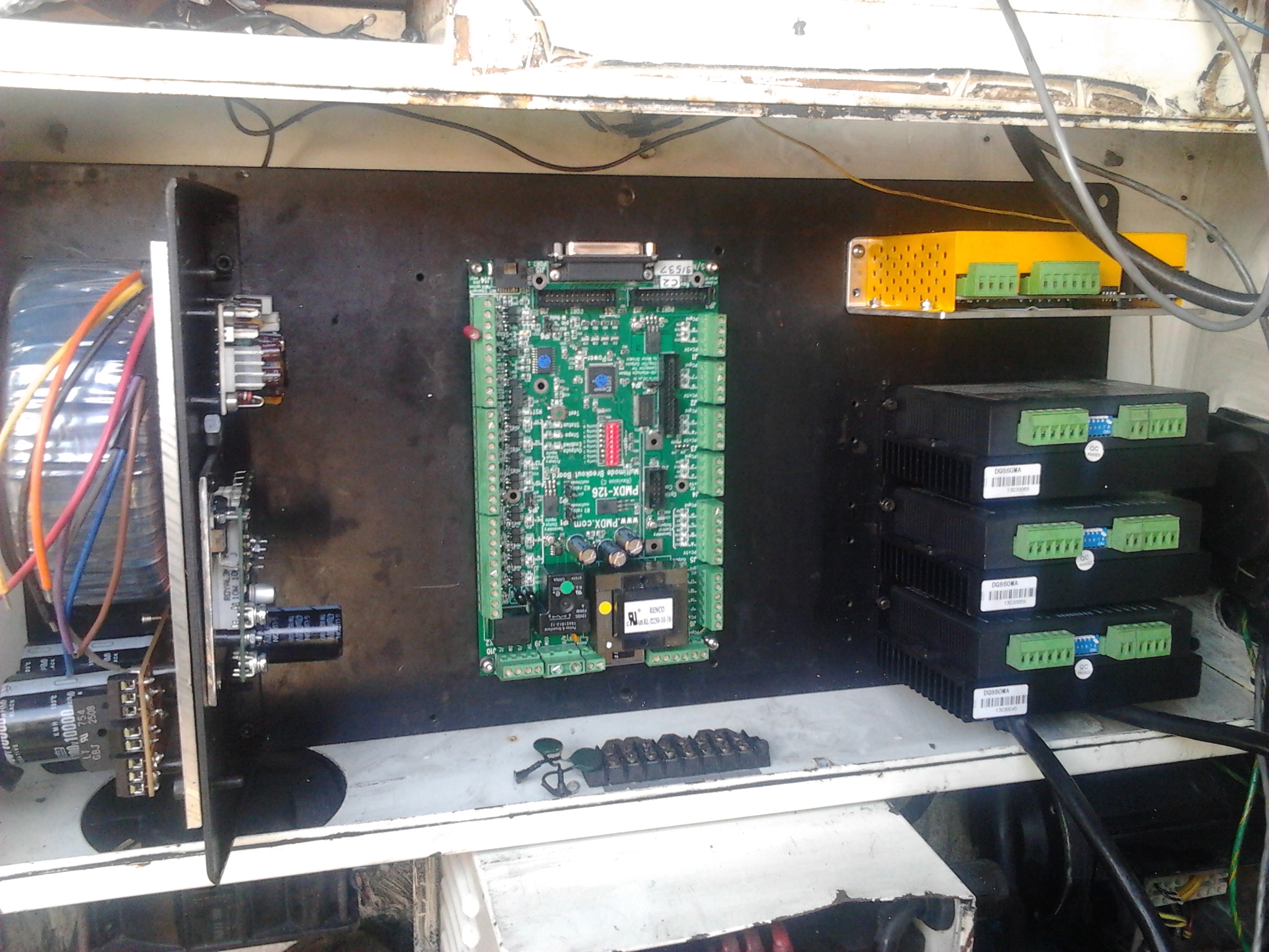

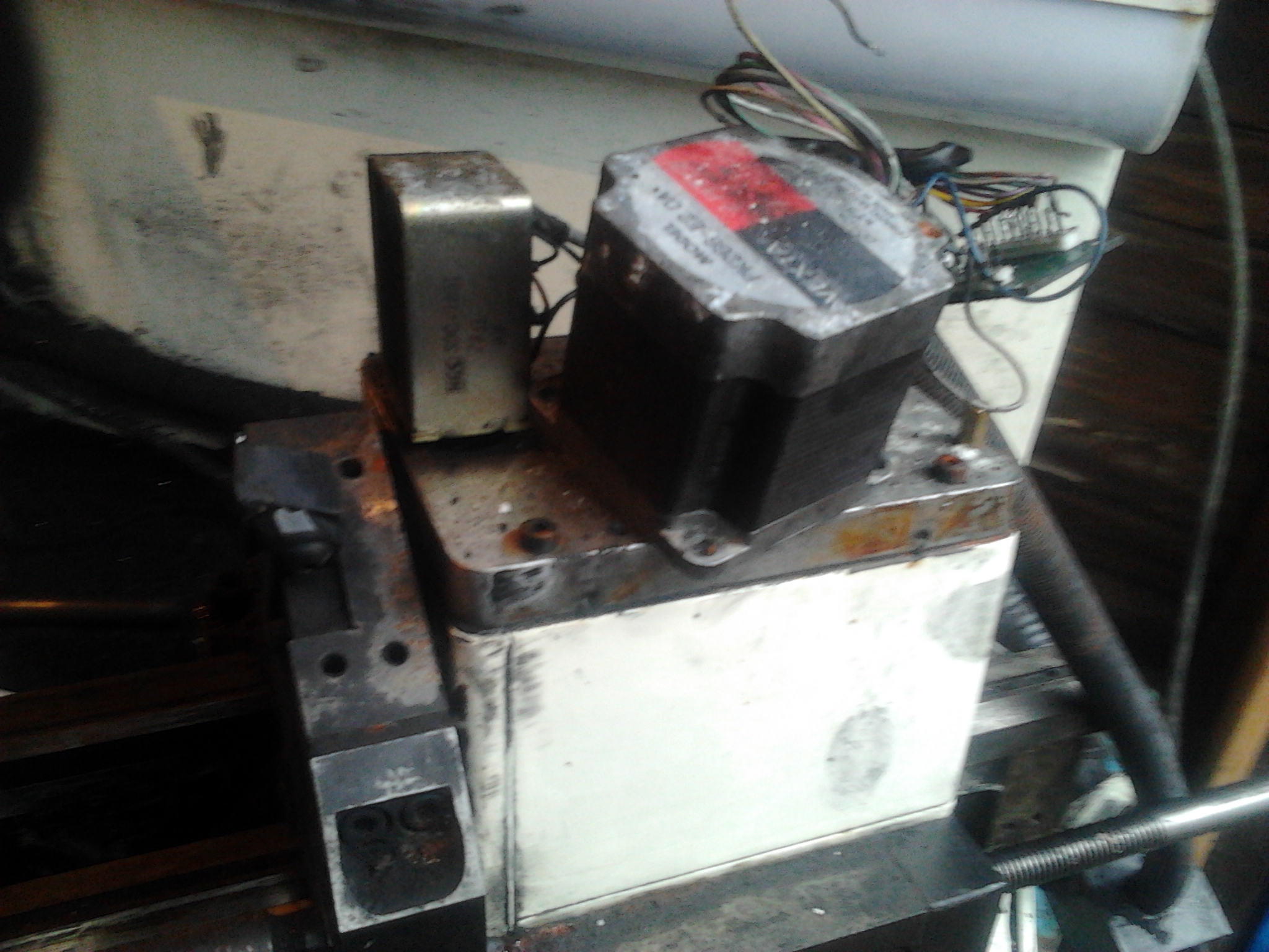

From your pictures it looks like the stepper motors are Nema34. Have you tried googling the part numbers on them to see if you can find a datasheet? If you're lucky the current ratings might be written on them.

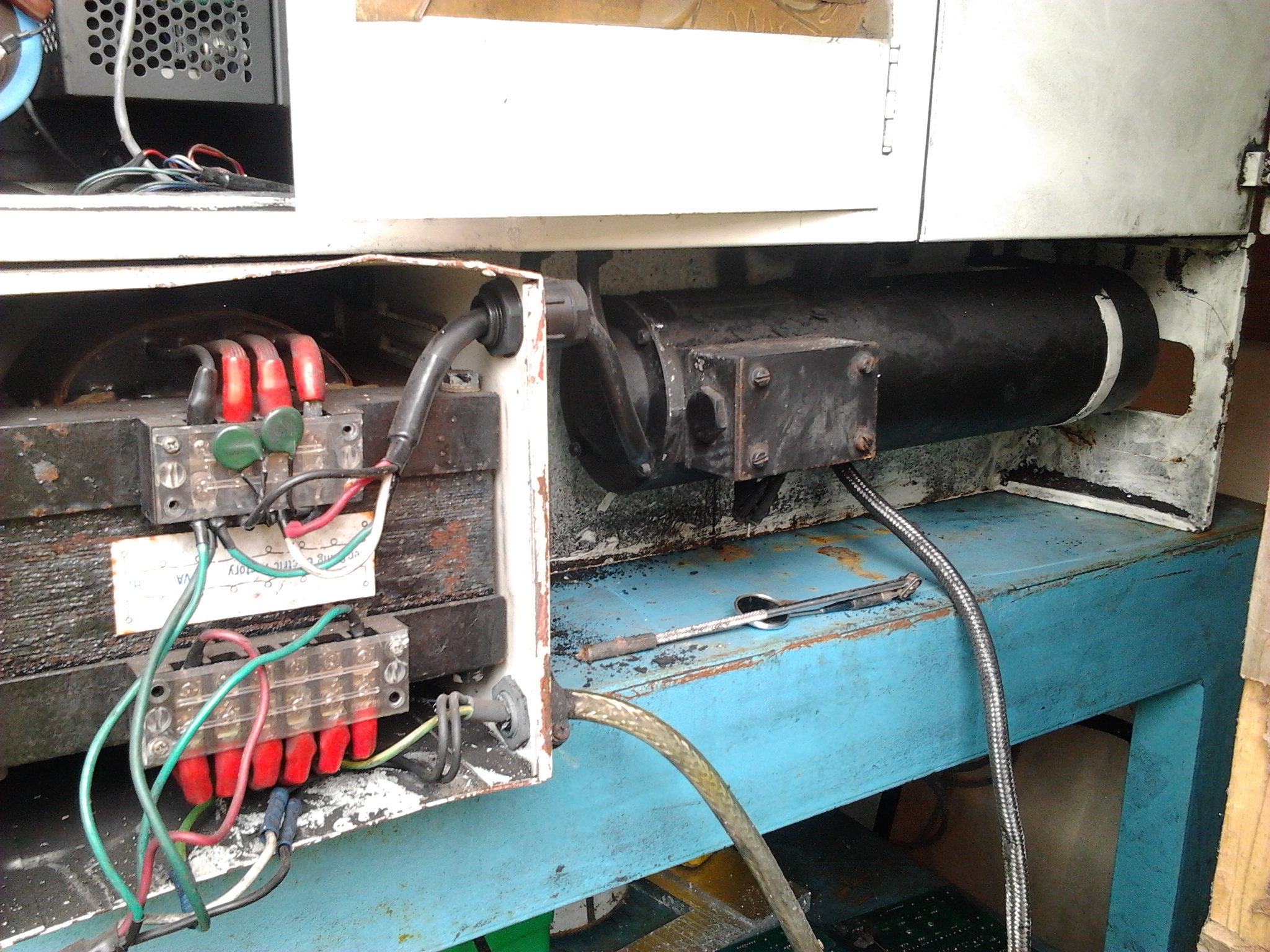

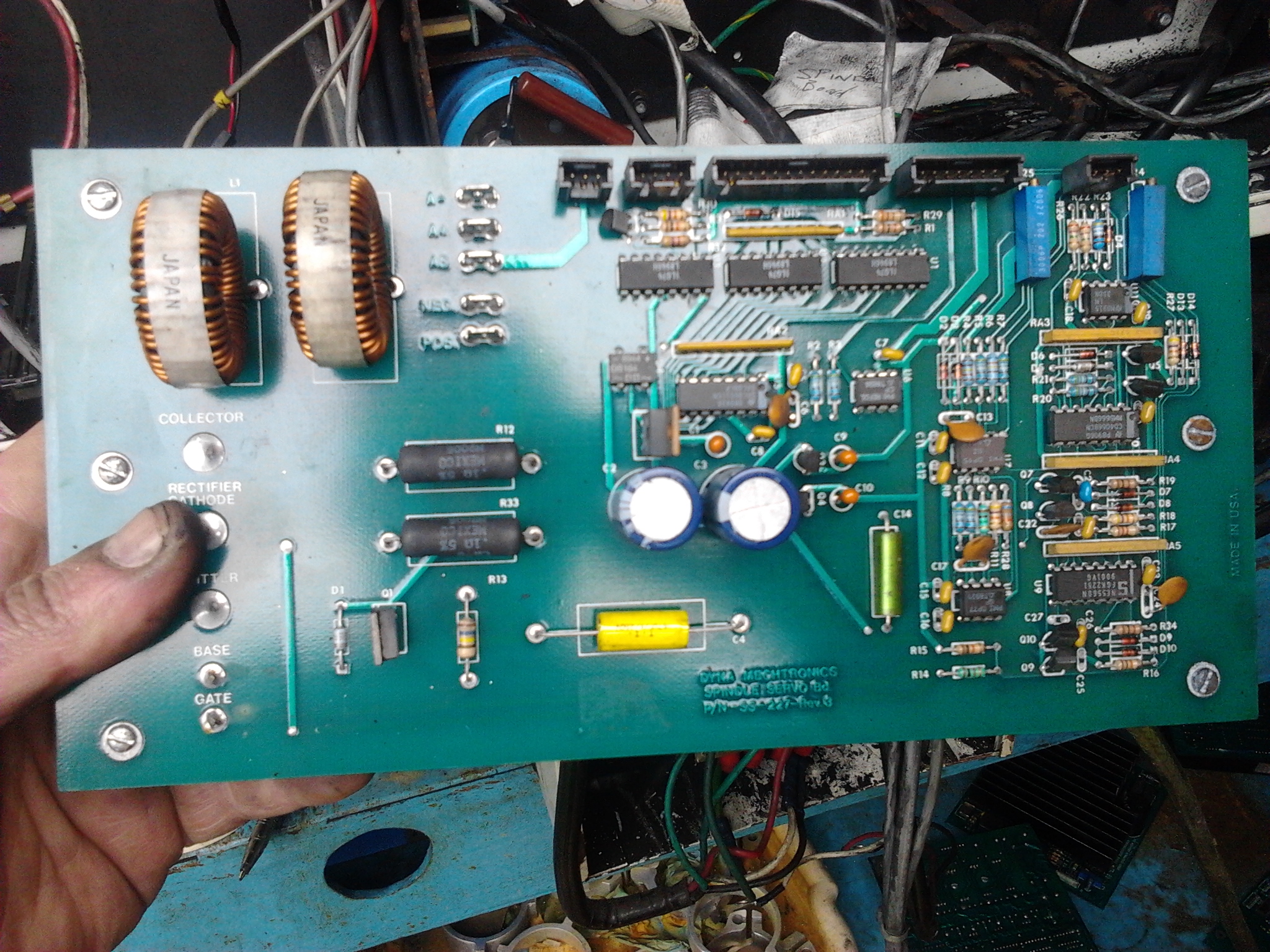

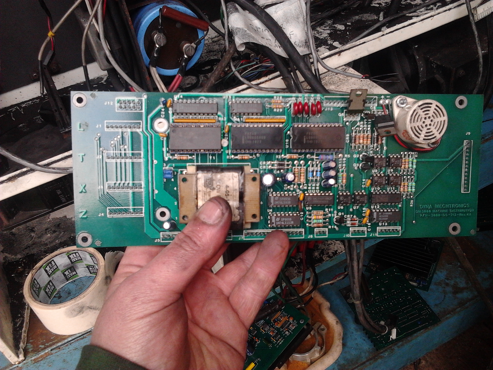

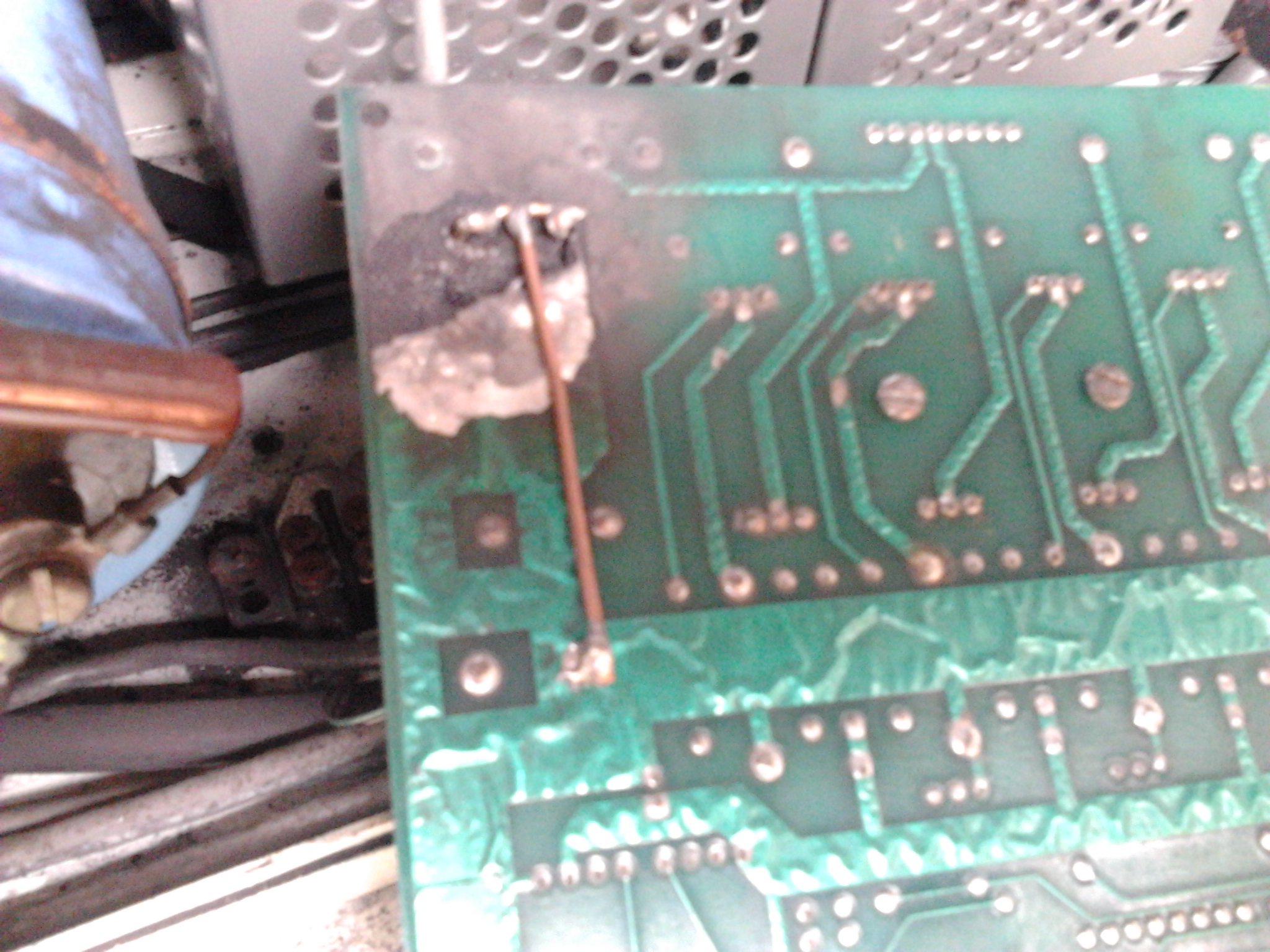

8 Attachment(s)
Re: Dyna mechtronics DM3000 lathe , mach conversion
[QUOTE=Jonathan;51530]
Look at what the spindle (which oddly enough I can't see in the photos?) is connected to - there's likely an encoder and some sort of driver for the motor. Also see what the toolchanger connected to.
QUOTE]

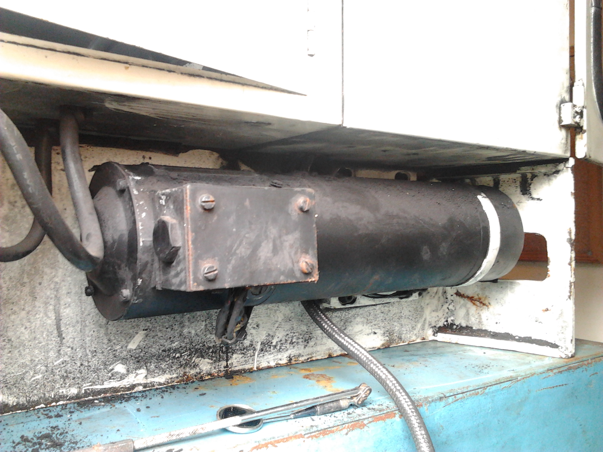

the spindle motors an SEM MT30 U4-48 MT30 Series Servomotors
theres a big board see image for the spindle motor, theres so many parts,and the manual really only covers operation and maintenance below spindle servo board p/n-ss-227-rev.3
Attachment 12312
Attachment 12313
Attachment 12314

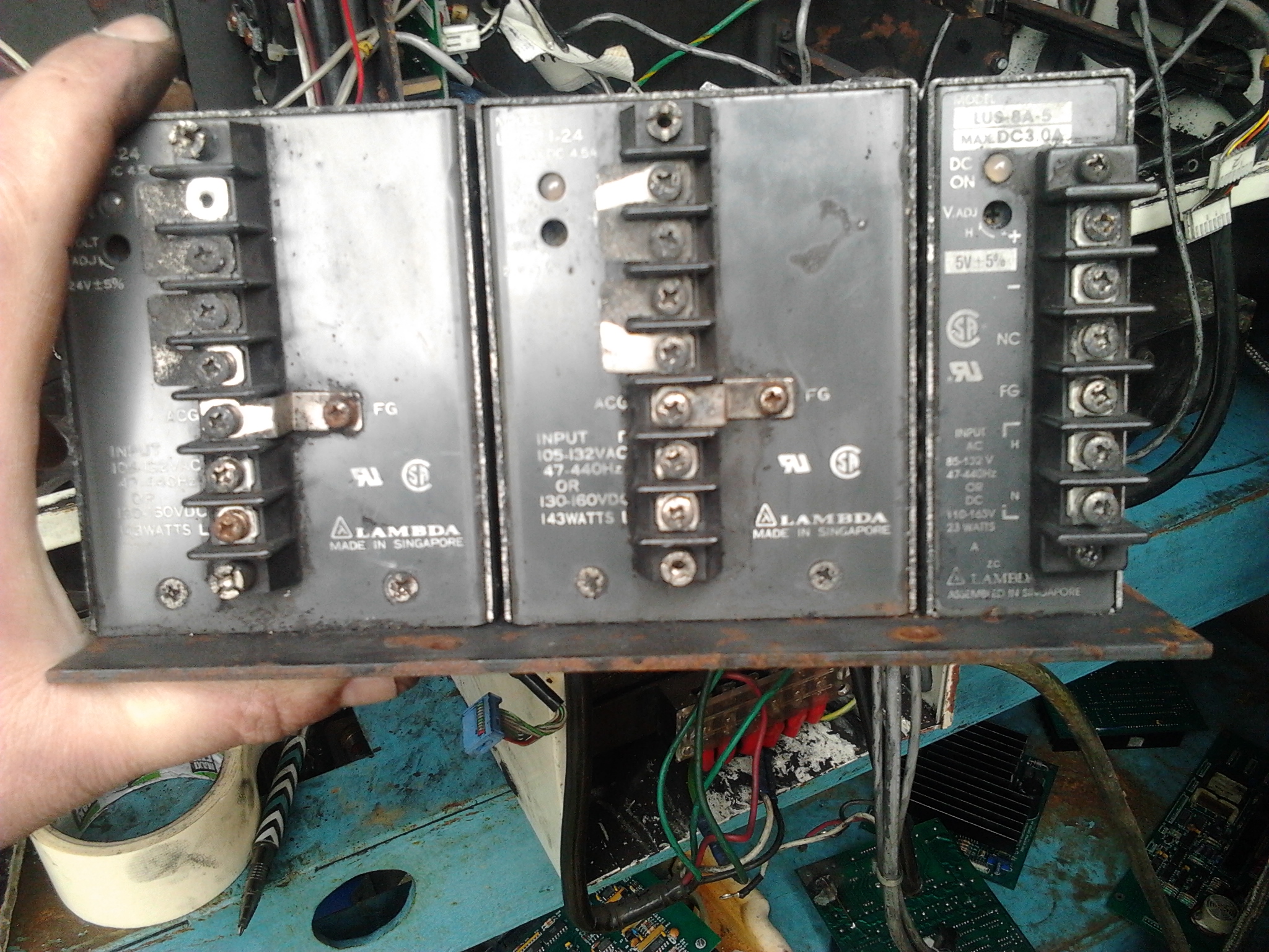

the power supplys are both 24v and the one on the end 5v
Attachment 12315

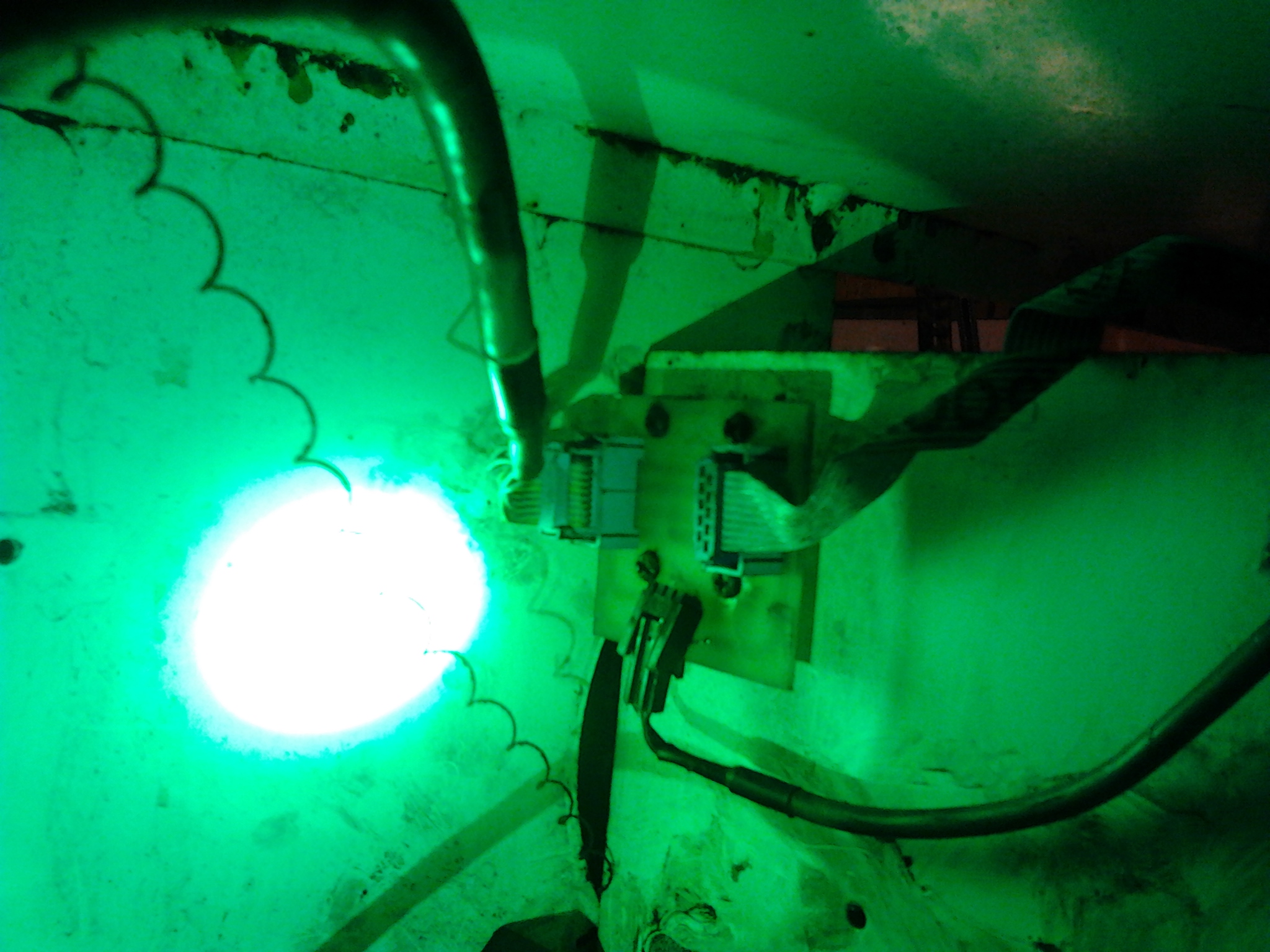

various other bits,the board below looks to be some kind of breakout board, theres connector sockets marked L,T,X,Z, T being for the tool changer and the L? and a blue socket on the back the encoder ribbon plugged in to. p/n-3000-ds-213-rev.4a
Attachment 12316
drivers were in a sorry state and looked to have been repaired a number of times
Attachment 12317

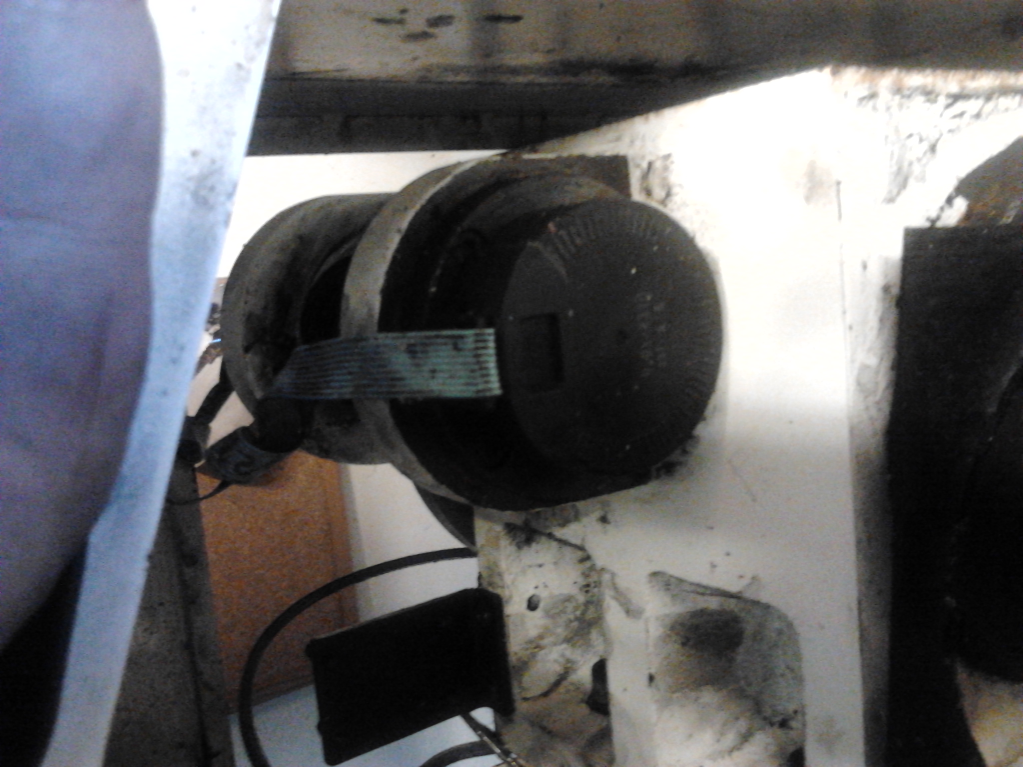

tach
Attachment 12318
Attachment 12319
The specs for that motor are a bit vague, however I'm guessing it has a tach built in going by the fact tach details are listed on all the pages for that motor.
To make them run closed loop using the PMDX, you'd need some form of driver that would close the loop and be controlled via step-dir.
If you're not bothered about running the spindle fully closed loop, a simple step/dir to 0-10V converter combined with a suitable servo amplifier (one of those boards will be a servo amplifier, but you'd need to research exactly what kind of input it takes) will give you open loop speed control.
Alternatively, you could just run the motor as a basic DC motor, using something like a KB driver board, which simply takes a 0-10V input and adjusts the output accordingly.

That drive should work. However you need to ensure you have an incremental encoder, that outputs a quadrature signal (usually referenced as A & B outputs). You'll need to figure out eaxctly what the existing feedback device is, to see if it'll be any use.
thanks again mc the encoders a HP heads-6310 021 a s. from what ive read it does use A & B outputs,id forgotten the schematics on page 1 so hopefully the pin info is in there
edited heds 5000 and 6000 series encoders seem to be the same diagram,

thanks again mc the encoders a HP heads-6310 021 a s. from what ive read it does use A & B outputs,id forgotten the schematics on page one so hopefully the pin info is in there
This thread on CNCzone says it has A,B outputs and an index pulse with 5V supply voltage, so that's ideal. The second schematic you posted has the connection diagram for the encoder. That's sufficient - so long as you still have the same connector on the encoder and know which is pin 1 (i.e. which way round it goes)? If this guy responds that would help if you don't know which way round.
Edit: Helpful post about these encoders on CNCZone here:
fkaCarel @ CNCZone
From an 1985 HP databook.
The 5 in 5310 is the size 28 mm diameter encoders. The 3 in 5310 points to ordering info, emitter plate only(?), 0 is a complete kit. The 1 is 3 channel (+index), 0 is no index. The 0 is mechanical configuration, 0.6 mtr flatcable. It must be followed by an option letter for resolution:
C - 100 CPR

Ballscrews fitted,steppers fitted,its almost there.
Attachment 13508
Attachment 13509
Attachment 13510

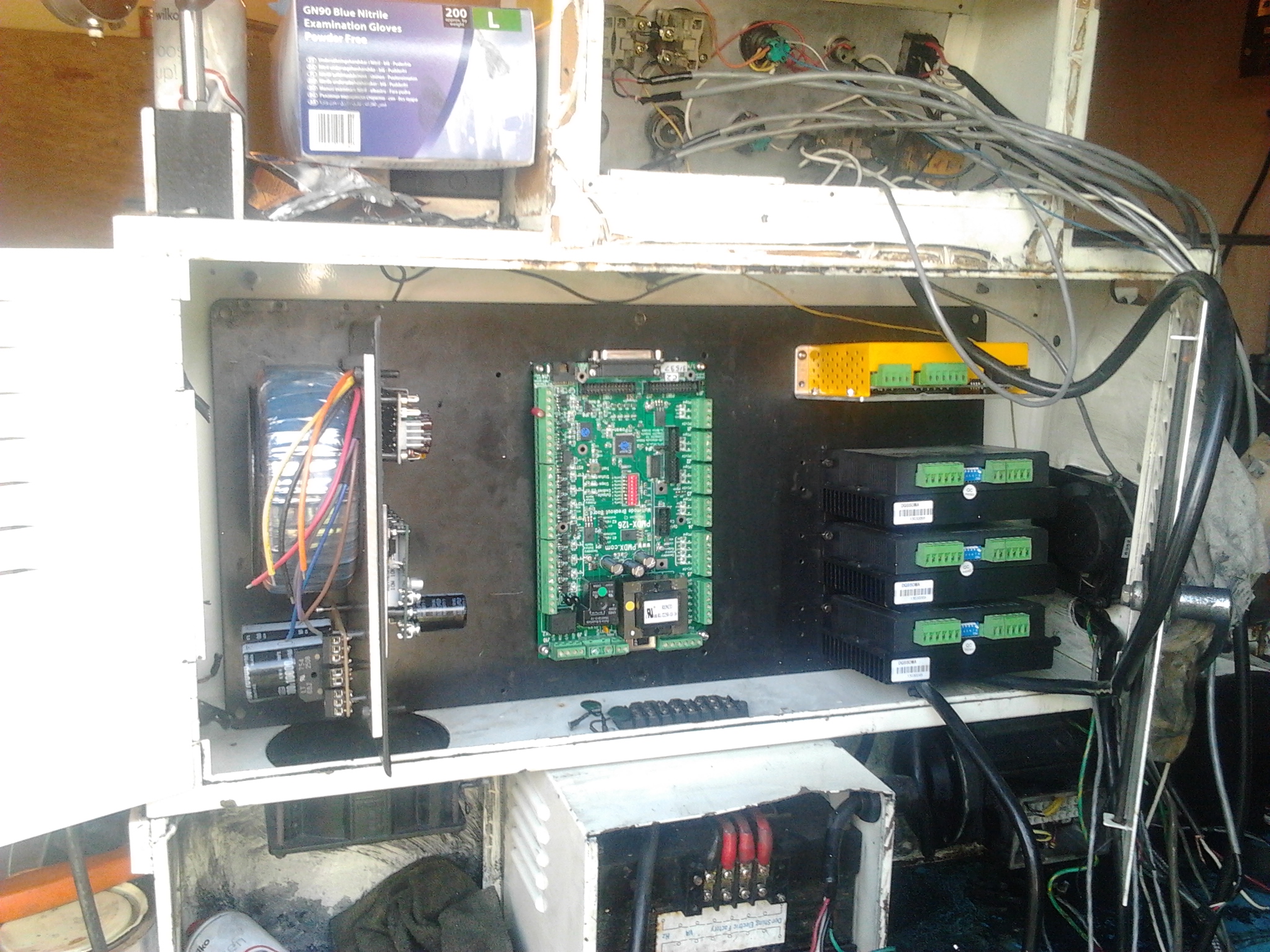

Ive made a start on the electricals /enclosure (photos will be up soon) and decided to go for the DG4S-16035 positioning DC servo drive and a BRKC-180 braking circuit to power the spindle motor..i had come across a few on the zone using these on there mills with no complaints
Attachment 13197
im assuming the heds encoder/blue ribbon will need to be rigged up to this DG drive via one of these differential line drivers in the link http://cncdrive.com/Difflinedriver.html.

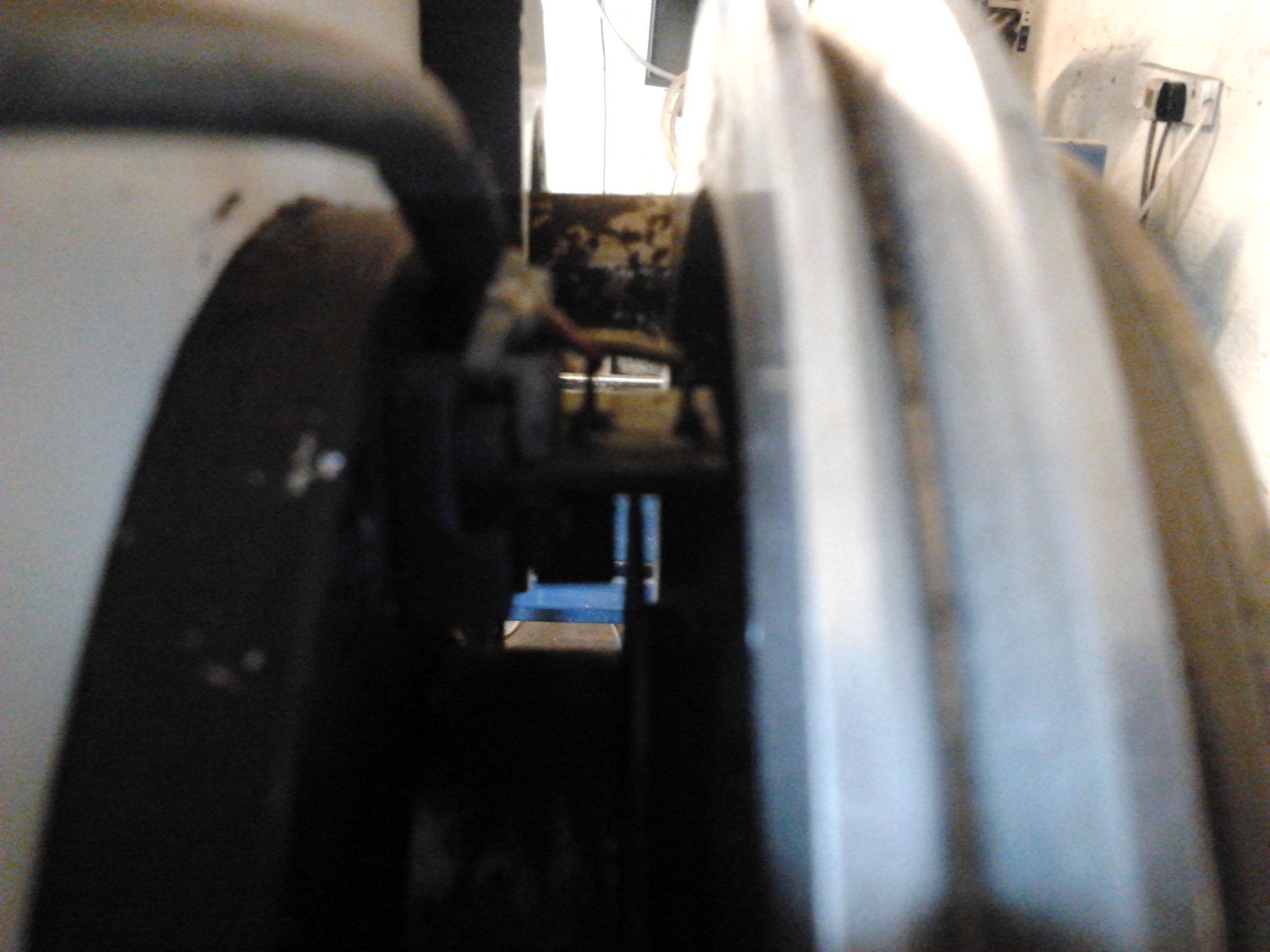

2 Attachment(s)
Had a poke around the spindle motor area took off the wiring cover to reveal the connection block.
the block is printed with he following wire colours to each letter
T1 RED
T2 BLACK
K1 RED
K2 BLACK
A1 WHITE
A1 BLACK
B1 RED
B2 BLACK
.edited i completely missed the pin out info on the back of the lid so will stick below as I couldn't find it on line edited..what are the K1and K2 wires with the T/0 below it ?

second question I have is..
with me using the heds encoder and plugging that into the dc servo drive as the manual instructs,
is the optical sensor that sits on top of the spindle and the tach no longer required??
Attachment 13215
I don't understand why I would need 3 forms of feedback yet they were all installed as standard when the lathe was in its original state.
7 Attachment(s)
It turns out I don't need to be concerned with anything other than the encoder so I don't need the rest

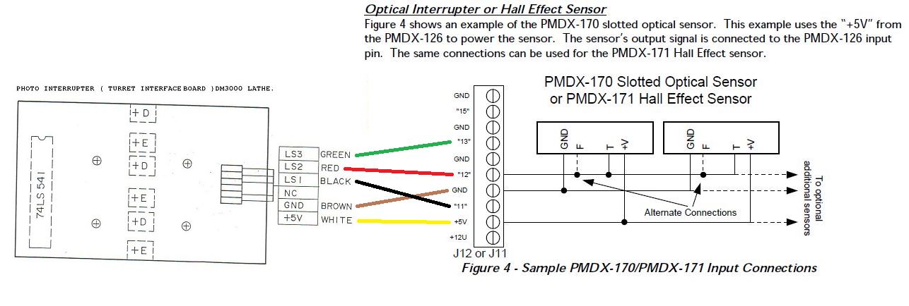

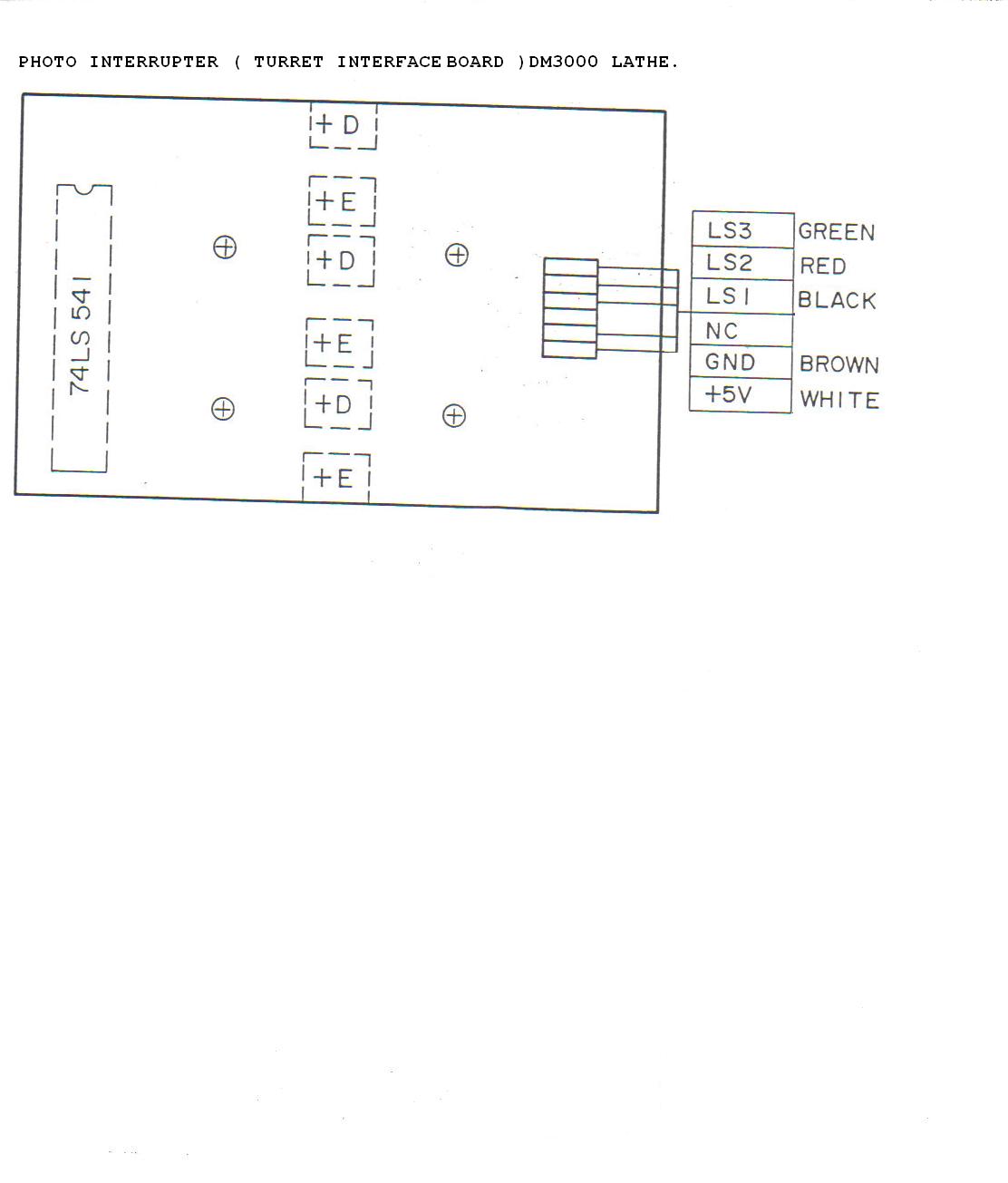

one thing im struggling with and cant find info on is the tool turret card and the 24v solenoid that operates the turret lock and how/where I would go about wiring these into the pmdx 126 board.
EDITED Found the info for the board
Attachment 13264
right apparently I can use the k1 relay on the pmdx board to work the turret solenoid .
does the wiring from my turret board to the pmdx look ok in the image below?if so can/should I daisy chain the grounds on the pmdx?
Ive also received an email telling me as the lathe has a turret I will need either a smooth stepper or a second parallel port.. so im thinking this if anyone has any thoughts on it.http://www.cncdrive.com/UC300.html

Not sure if the PMDX is common gnd (Edit: Looks like it is) or if the 5V Gnd is isolated from the inputs.? If common gnd it will use the 5V supply Gnd as it's potential ref so won't need jumpers. If not then you will need you to connect the Input Gnd's to 5v supply Gnd's. In either case won't hurt to daisy chain if unsure.
Same if you use external 5V or 12V you will need to reference Inputs to that supply's Gnd.
