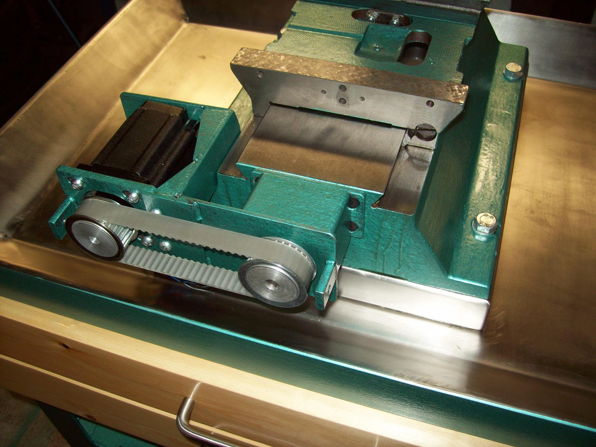

I'm currently testing the first (Y) axis on my Warco WM16 mill conversion. I'm using standard M542 drives with THESE 4.2A, 3nm stepper motors and have noticed significant vibration at very low speeds. Is this a problem caused by lack of cable screening or is it a setup issue? At certain speeds the whole machine and stand will vibrate. At higher speeds, there are no issues. I've tried running the motor unmounted but it still vibrates at very low speeds. The motor is bolted to a solid mounting. Should I use some sort of rubber mounting to reduce the vibration or is it something I will have to live with?

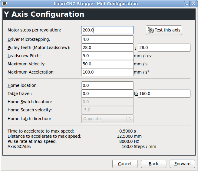

I'm using LinuxCNC set as per the picture below. Dip switches on drive are set to 800 steps (all switches 'off' except for 5, 7 and 8). I've also tried running at 1600 steps (and changed "Driver Microstepping" to 8) which did improve the resonance slightly. At 3200 steps, I had some error message related to the RTAI (realtime kernel). I didn't look up the specifics of the error as I just assumed it was related to the step rate being too high.
Attachment 10817
Re: M542 driver - motor vibration at low speeds
Sorry for assuming you used Mach3, from my limited knowledge the settings appear to be okay, you've probably been at this longer than me anyway. I would be into trying a different motor and swapping the M542 just to eliminate those from the equation. If you think it's maybe a screening problem why not run a temporary cable between the motor and M542 that is well away from everything else. There was another thread a few weeks ago about rubber mountings and I suggested using heatproof silicone sheet like this SILICONE RUBBER SHEET 200MMSQ, 1,1.5,2,3,4,5,6,8,AND 10MMTHK | eBay, but the opinion was to bolt the motors straight onto metal.

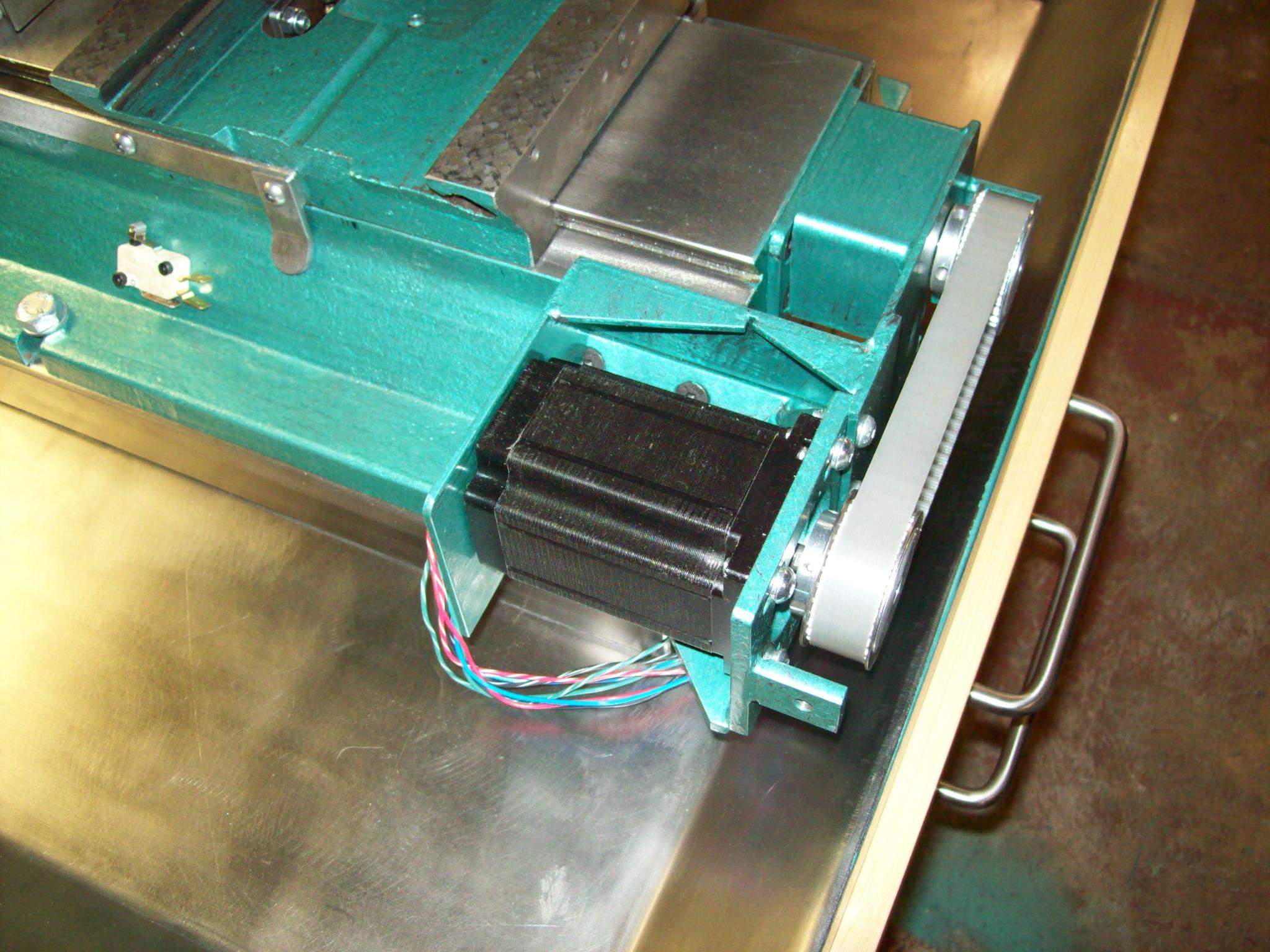

Bugger my luck. Yes, they're Zapp motors. Bought them about 2 or 3 years ago and dragged my arse on the CNC conversion as I was doing manual milling. I'll take a look at the motor wire colours and report back...
Can't see your wiring for certain but looks like it should be
Blue/White - Red A+
Red/White - Blue A-
Green/White - Black B+
Black/White - Green B-

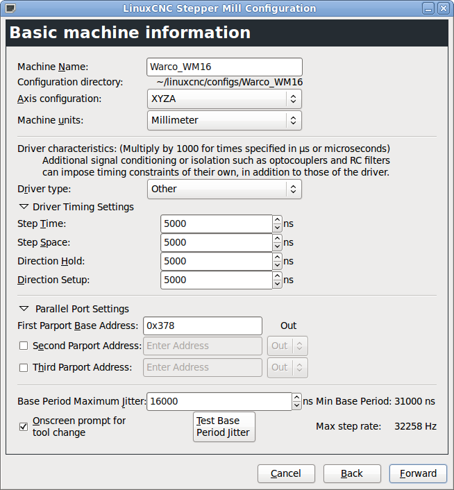

Out of interest, what step rate do you guys normally set your 542/752 drives at? 800, 1600 or some higher value? Don't forget I'm a newbie, so am just wondering what range of settings are considered "normal".
Attachment 10839 . Attachment 10838 . Attachment 10840 . Attachment 10841
birchy
Do these numbers look OK to you? I'm not sure about the timing settings of 5000 as I can't find any actual values in the drive manual.
Yes, 5000 works for me. You should be able to use much higher acceleration than 50mm/s^2. Around 500mm/s^2 is probably a good starting point.
Generally 'guys' normally don't use any finer than 1/8th microstepping, so 1600 step/rev. Search 'microstepping' on the forum and you'll find plenty of explanation...

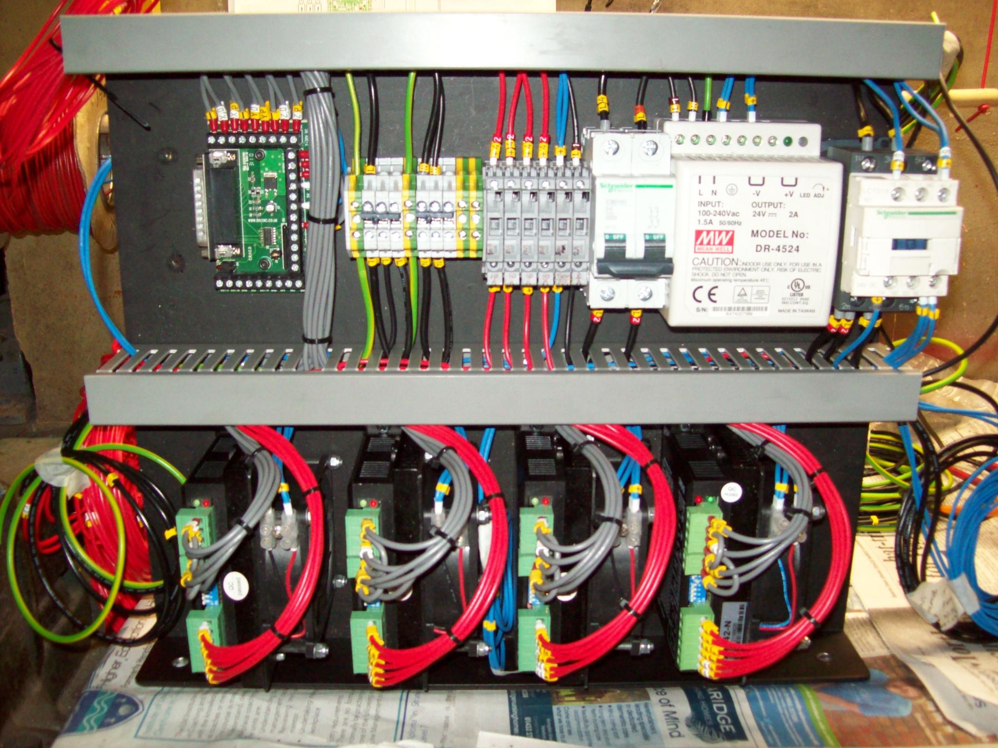

This is probably nothing to do with it but I'll mention it anyway.
When I first powered up my system, 4 x AM882 and CNC4YOU Nema23 4Nm motors, it sounded like a load of whales singing from one particular driver and the motor was noisy when running. I thought it was goosed so I tried another motor on it with the same result. There is a utility with the AM882's called Protune and I had been playing with this connected to one of the drivers via a special cable (connections available on Leadshine website to make one). I therefore connected the noisy driver to Protune and ran the Auto Current Tuning section, immediately no more whale song and motor nice and quite when running. Without looking at the manual for your drivers I don't know if this utility is relevant but it shows that something on the current side was having a huge effect on motor noise.
Just typed "stepper resonance" into Youtube and came up with this. Interesting that they have an almost identical machine to mine (looks like the Amadeal version) and to quote "I was so FED UP of stepper motor resonance". So he fitted Servo motors instead. Seems a bit OTT though.
http://www.youtube.com/watch?v=y7gOPmVlh1c
EddyCurrent
Nice feeling isn't it Eddy knowing you can deal with almost anything the machine throws at your drives/motors. This alone justifies the extra cost IMO not to mention the far smoother motor operation than analogue drives.
Birchy if you do end up buying new drives then the AM882 is the drive if your having Resonance problems because you can adjust the Resonance range the drive covers with Pro tune. Your Analogue drives are stuck to set range which is narrow and if indeed it is resonance then your drives Resonance algorithms are not looking in that range or even working at all.?
The Dampers you see are usually only affective on cheap drives that don't have any resonance handling capability and I'm sure the M542 does have some basic capability and although it may only be basic it's better than none.?
Regards Micro stepping then above 2000 is generally pointless has the motors can't resolve much more than that and your only stressing the machine and increasing chance of dropped pulses/steps etc.
Higher MS does help with smoother motors and I generally prefer 2000 if the PC/Parallel port can handle it but anywhere above 800 generally works ok.

Since my last post, I have refitted the Y-axis motor and pulleys, belts and X table (with a 25Kg lump on top) so that I'm testing the motor under normal conditions. I then created a g-code file to test all feed rates from 0 to maximum velocity, increasing in 5% steps. This helped me isolate the speeds/frequencies at which resonance was most noticeable. Starting at 2 microsteps (1/2 stepping), I ran the test file for each setting up to 64 microsteps. The resonance band was tightest and least noticeable at 8 microsteps, so that appears to be the optimal setting for my machine. I also gave the machine a good hammering with randomly generated G0 codes (thanks Jonathon) at full speed and acceleration of 2000. The machine danced around a little due to the high inertia changes but the main thing is that it didn't lose any positional steps. I've now put the acceleration to a more sensible 250 to prolong machine life.
Now I need to stop farting about and get on with finishing the Y-axis before contemplating the X and Z...
