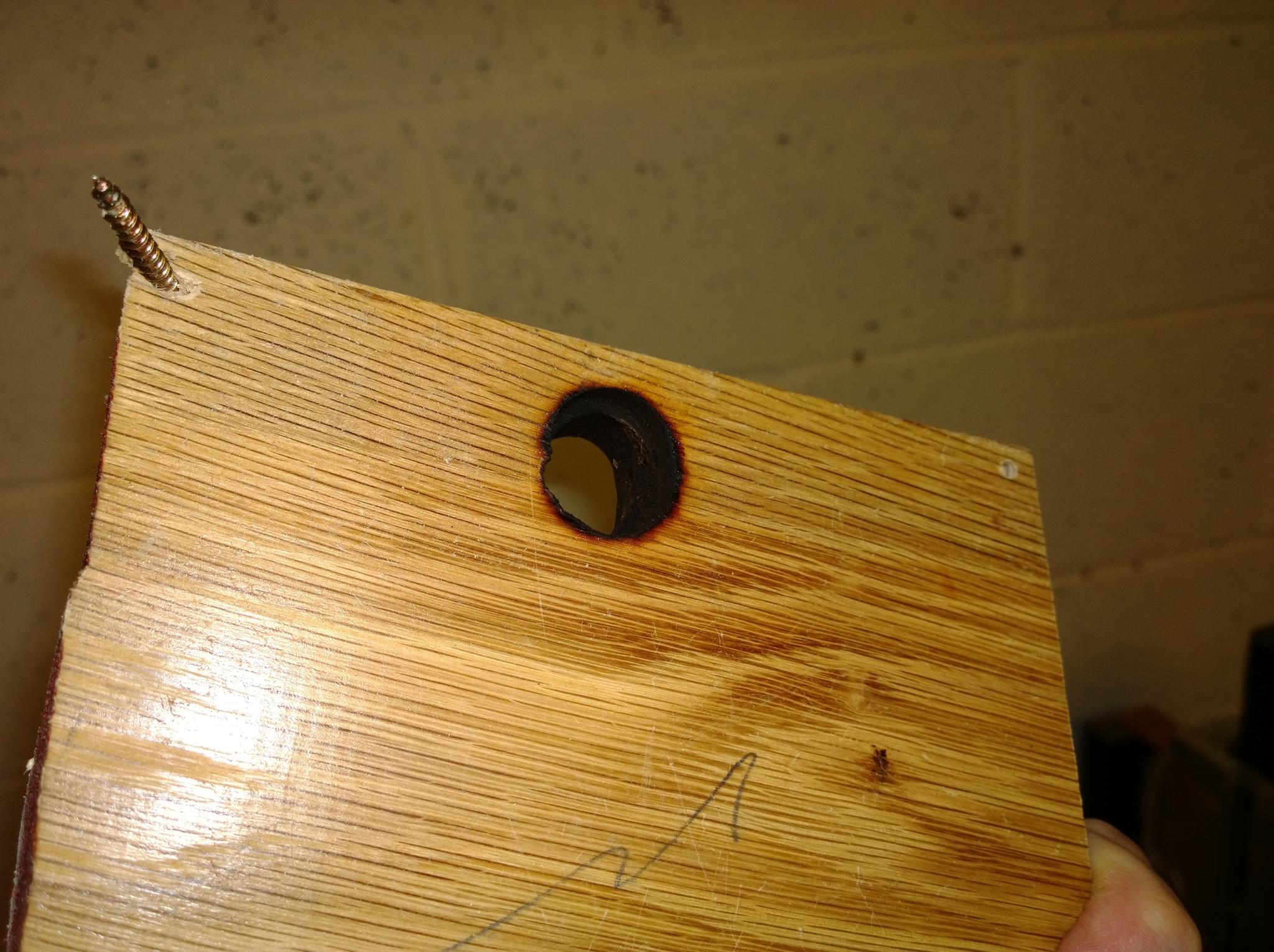

So I was making a nice little decorative wooden doo-dad for my brother's birthday at the start of the year. Computer told me it would take 90 minutes so I decided to step out and check back every 10 minutes or so......hmmmm....not one of my best ideas!
The next time I go to the garage I am met by thick smoke which started to burn my eyes! Over to the machine I run fumbling for the estop.

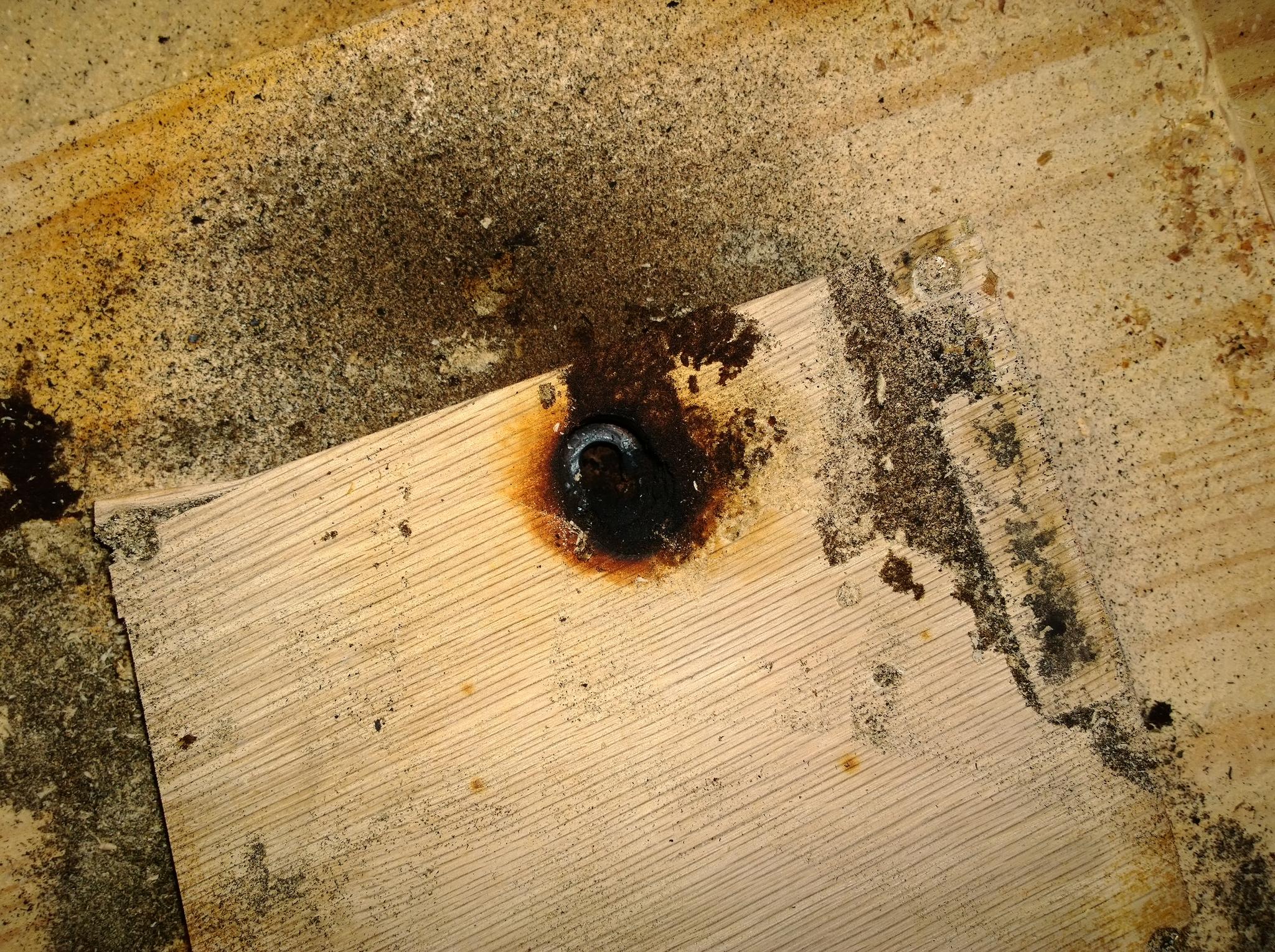

Once the smoke cleared (35 minutes!) I took a look at what had happened.

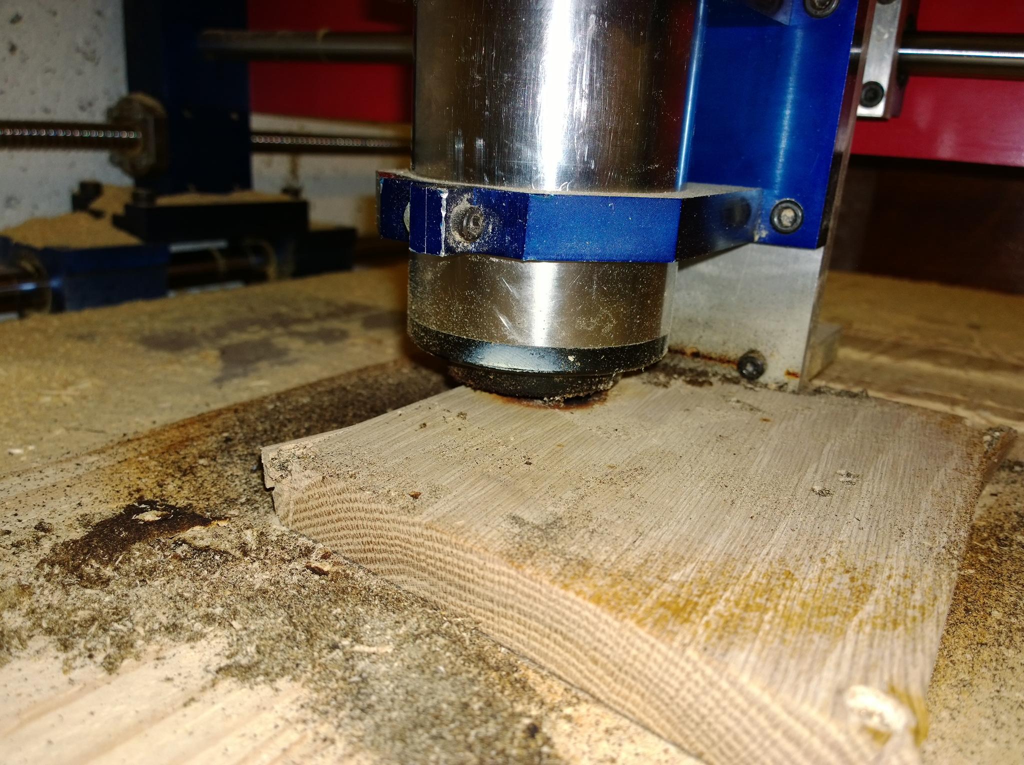

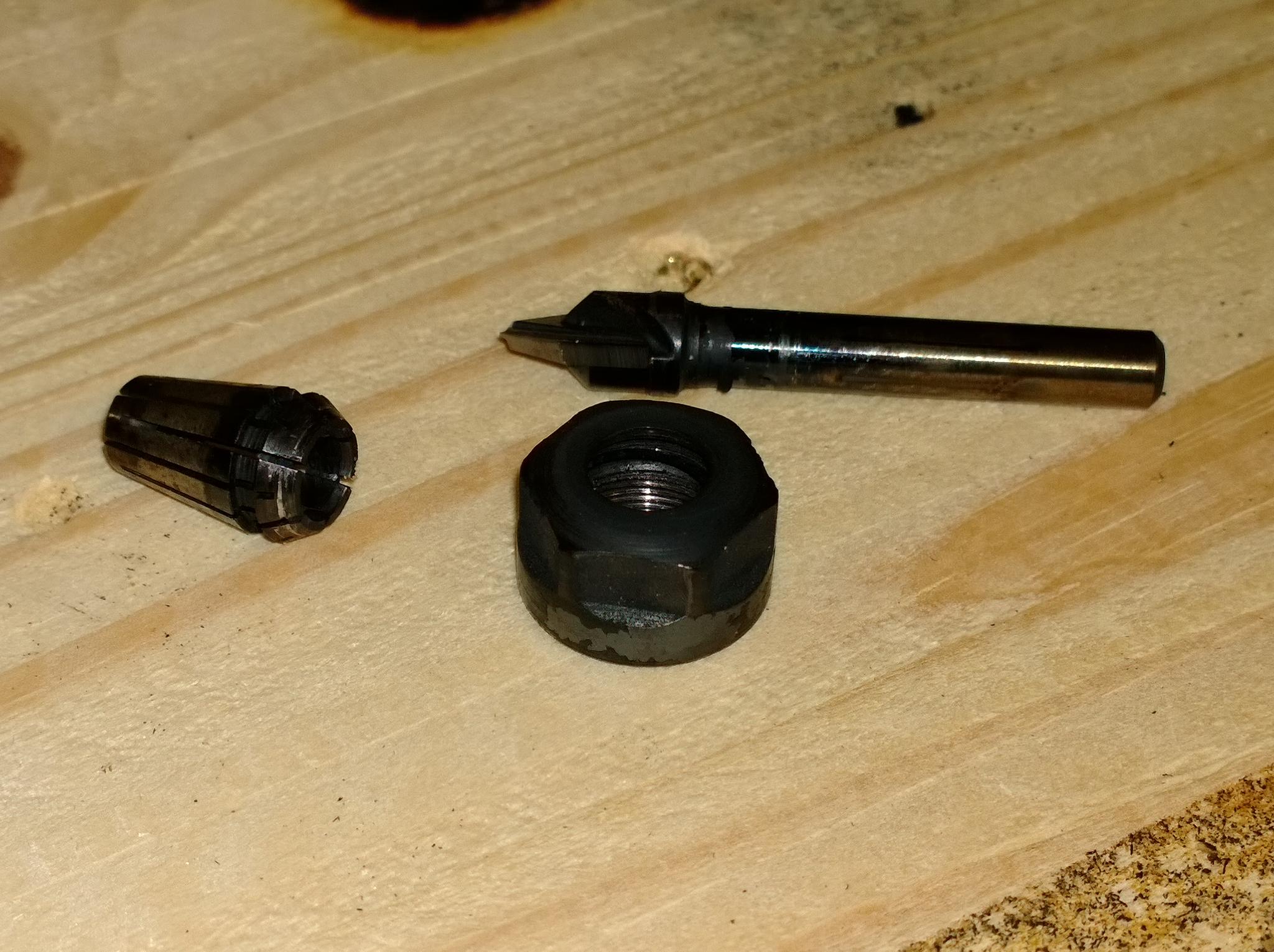

Turns out the z axis coupling had come loose and the whole spindle had dropped into the work piece. The v bit I was using cut through the 15mm oak workpiece, a 10mm bit of sacrificial pine and the 25mm mdf bed But the thing that surprised me was that the spindle collet nut had also managed to "mill" through the above mentioned wood!
Attachment 11354Attachment 11355Attachment 11356Attachment 11357Attachment 11358

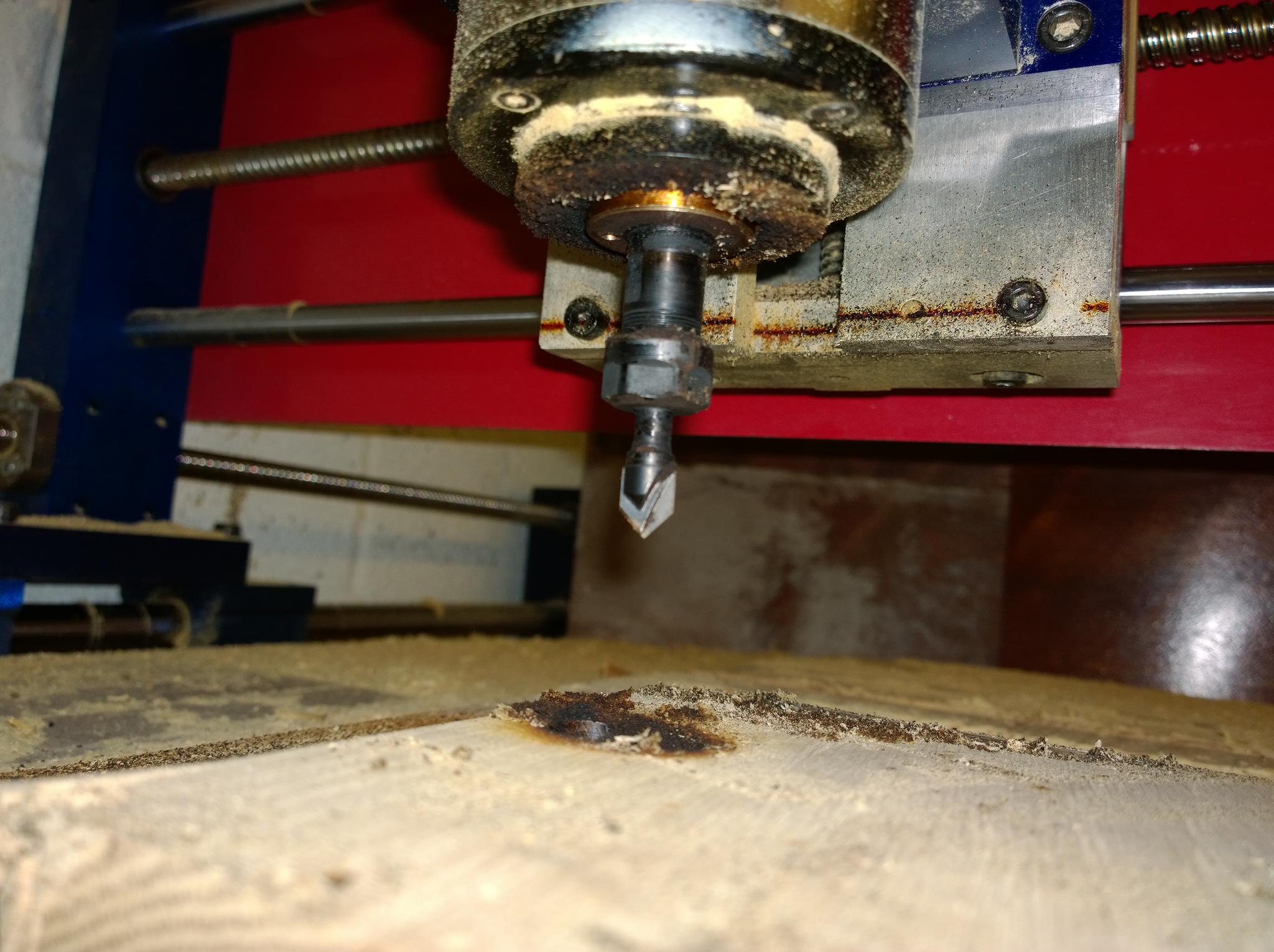

I tightened the grub screw on the z axis and tried to move the spindle up - this is where my new found respect for the power of the stepper motors coupled to ballscrews came from - The spindle was stuck fast. As I tried to raise the z the spindle stayed put and the whole machine flexed like a banana! Now I'm the first to admit that my machine is no heavy weight (x - 25mm unsupported | y - 20mm unsupported | z - 20mm unsupported) but I thought the steppers would have stalled before the frame tried to fold in half!
I do feel lucky though, I'm sure I was seconds from a fire starting and I am glad I at least had an estop button, can't imagine how long it would have taken to find the mouse and try and find the estop button in mach!
Thinking back I remember looking at the first cuts it was making thinking it didn't look 100%. I put it down to me not setting my z zero correctly (just started using a probe to set z) and thought I would let it run and investigate it after. Should have seen the signs!!!! :nightmare:
I have now placed a smoke alarm and fire extinguisher in the garage!!!!!

It looks like from the picture that the spindle clamp is tightened right up till the faces meet. If this is so then the clamp isn't right, there should still be a bit if a gap between the faces. This allows the clamp to fully tighten on the spindle.
Good spot - Your right I don't think there is a gap at all on either clamp. I haden't really thought about that. I guess the easiest thing would be take 1 or 2mm off the clamp?

I would be concerned for the spindle bearings. From your photo is looks like things got hot enough to discolor the collet? If so then I expect the bearings would have got very hot as there's not much distance between the collet and the bearings.
The bearings on my spindle do have seals, although due to being high speed bearings they rely more on the labyrinth seal. These pictures should give you an idea what to expect:
Attachment 11359Attachment 11360Attachment 11361Attachment 11362
If this had happened to me I'd definitely dismantle the spindle and have a look at the bearings. It's not too difficult to disassemble the spindle - the only difficult bit is removing the nut on the collet end. You might be fine as it is, or you might find the oil/grease has burnt away and the bearings fail in a few months.

Thanks Jonathan, I am in two minds about opening it up. Part of me wants to open it up and check it out but then I think stuff it, keep running it until I have problems, and deal with the bearings then.?

If you leave the bearings and the grease/oil is no longer present they're not going to last very long, then you'll need new bearings - i.e 7005 matched pair for about £50-£100. Compare that to a few £'s on the right lubricant. However you might find that there's nothing wrong...
Just looked at the photos again, and it looks like the spindle itself has blackened? Is that just soot? I hope it's not got hot enough to anneal the collet taper, as that would clearly be a big problem.

The spindle shaft is machined from a grade of steel which can subsequently be hardened and ground. This is necessary to ensure that the wear caused by changing the tool/collet doesn't wear the taper out (much), which would lead to high run-out. If yours has been heated above a certain temperature (which depends on the grade of steel), it will be softened and will wear out much more quickly. The temperature range is quite wide though, and we've not really got much idea how hot it got, although the colour can be an indication of that. Either way it's hard to tell...

Jim I'd strip it just to be safe better spending 60mins and £1 worth of grease than 2 weeks waiting and £150 for new spindle or even £80 on bearings.
Like Jon says there's nothing to it other than plucking up the balls to do it.!!
Wouldn't worry to much about the annealing has while it could have I doubt it did because it didn't fire up and the amount of heat required to anneal would have set the wood on fire.!!
