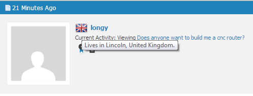

It might be a good idea to say were about your from in the UK so as members local to you might be able to help.
It used to say under the member's ID where they come from. Recently an option was changed in the forum software so you rather inconveniently have to move your mouse over the flag to see that he's in Norwich:
Attachment 11912
Re: Does anyone want to build me a cnc router?
If you fancy a drive over to sheffield Peter I can show you what I made that will certainly do what you need
Ian
Jonathan
Attachment 11912
Thanks Jonathan, least I will know now.
