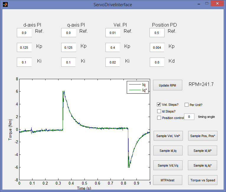

In addition to the usual methods to control the driver, I made an interface using MATLAB, so you can adjust all the controller gains and try different tests (e.g. measure torque vs speed characteristic of load) by clicking buttons. Here's an example - graph shows q-axis current controller (part of the vector control algorithm - torque is proportional to q-axis current):
Attachment 12487

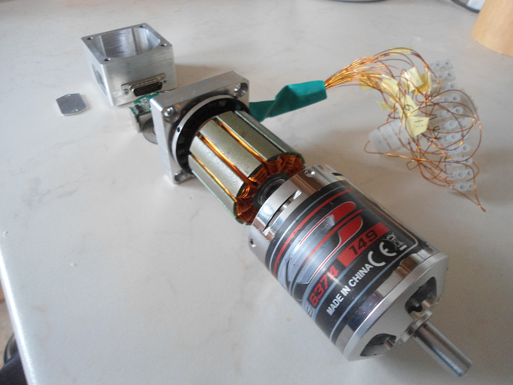

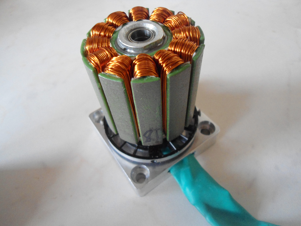

I rewound the motor, to make the current ratings more reasonable and enable it to be driven directly from the mains (instead of requiring a big expensive PSU):
Attachment 12489

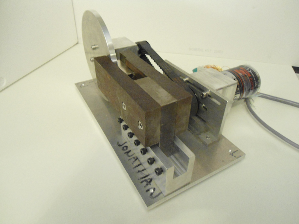

To test the motor under load I made an eddy current brake, which worked well:
Attachment 12488

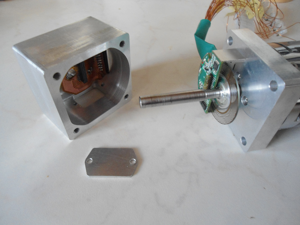

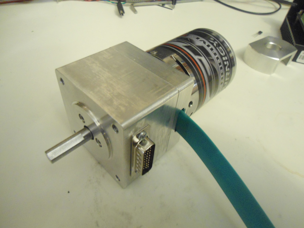

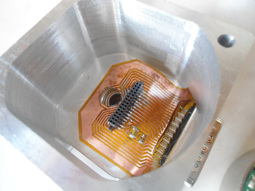

Here's some pictures of the motor parts with the housing I machined to hold the 17-bit encoder and adapt the mounting to Nema 23. Note the flexible PCB:
Attachment 12490Attachment 12491Attachment 12492Attachment 12493

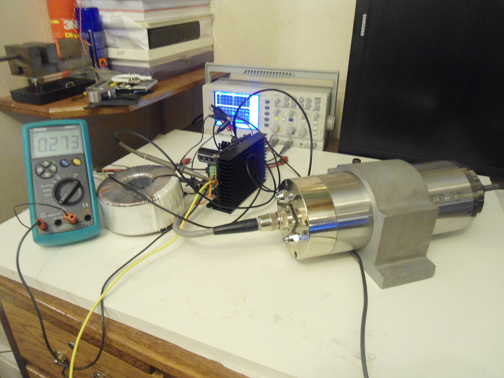

Testing with 3kW spindle:
Attachment 12494

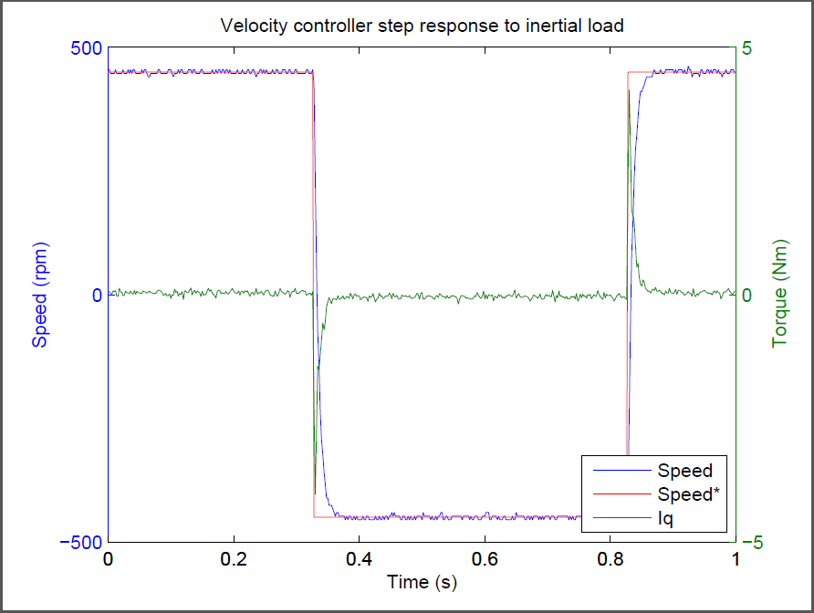

Typical step response (note load inertia of brake is *VERY* high compared to CNC router/mill, so response is not as fast):
Attachment 12495

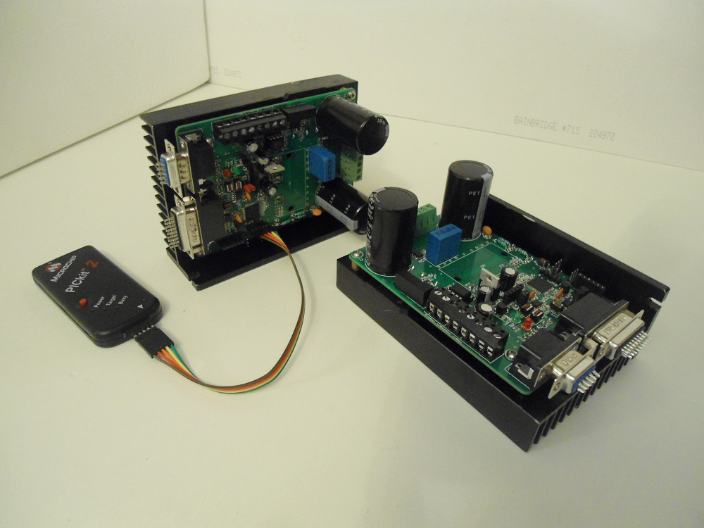

The position controller step response isn't so good - it oscillates quite a bit, but I think I know how to solve that now so I'll try it again when I have time.

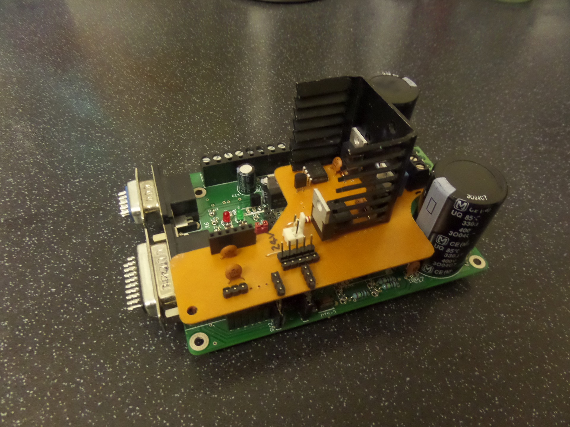

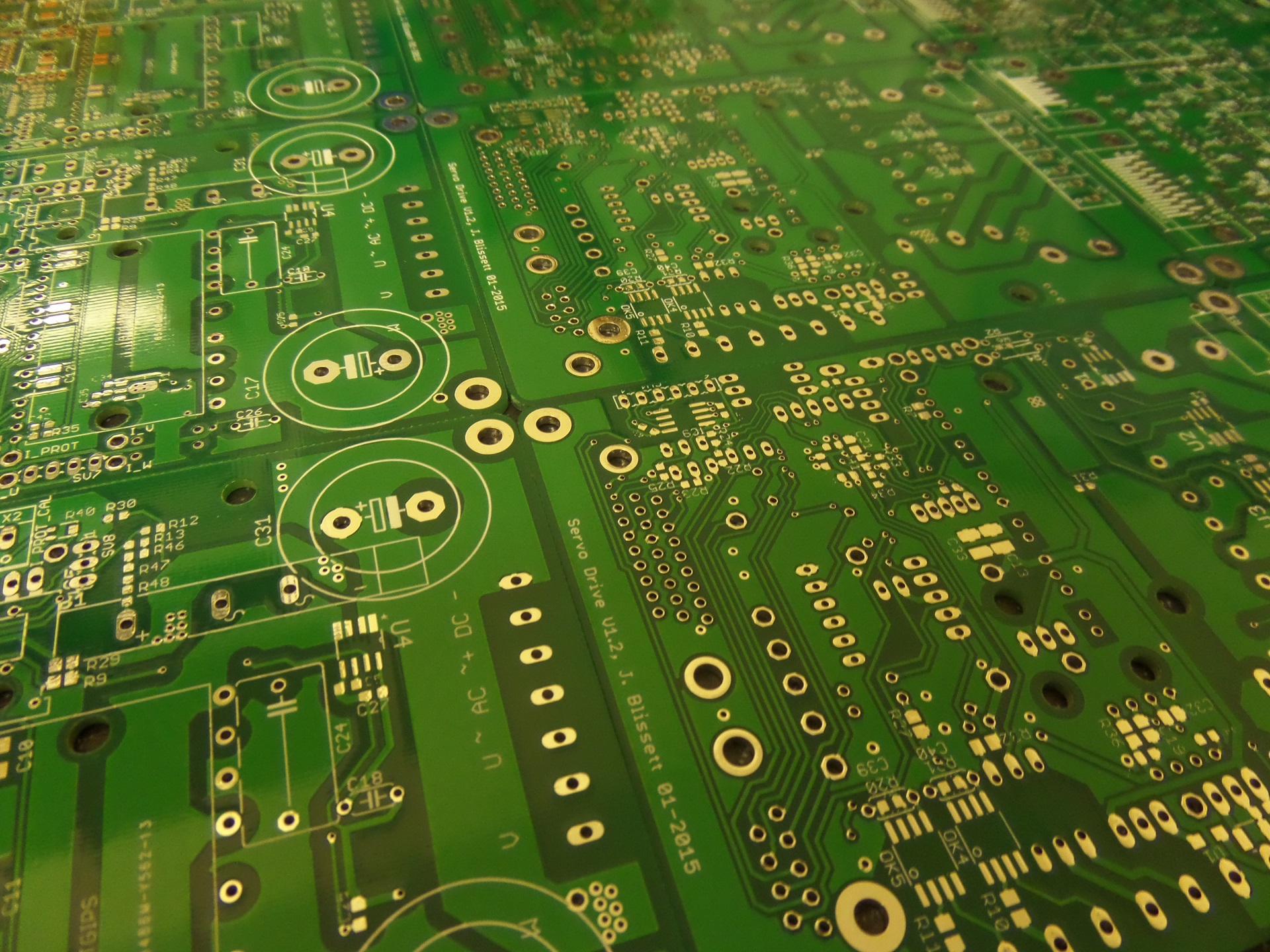

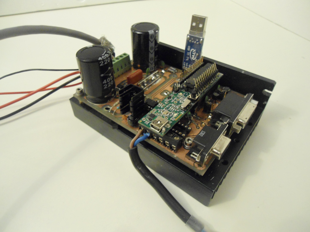

Last but not least, here's the actual driver - first version of PCB made using toner transfer, 2nd one got made professionally (both use SMT components):
Attachment 12496Attachment 12497
This was quite a big project (barely scratched the surface with this post) so any questions welcome. I might upload some videos, but I don't think there's much point as I'm sure you can imagine what a spinning motor looks like...

I seem to have made some progress:
http://www.mycncuk.com/attachment.ph...id=14474&stc=1
So need to buy VFDs from China now. I was intending to split the design into a logic board and power board, but realised that realistically it's going to be a some time until I have time to complete that design, so instead I made a few improvements to the previous PCB and got a heap of them made.
I've worked a bit on the code too - it can now drive motors with hall sensors. I'm using the sensors to generate a position reference field oriented (vector) control, so it's smoother than the generic method of just switching on hall signal transitions. I'll take a video soon, but for now here's a picture:
http://www.mycncuk.com/attachment.ph...id=14476&stc=1
With the previous design and more-so with this one, I've made is so spare I/O and signals are available on headers, so I can make 'expansion boards'. Here's one to add a 4th output to enable controlling stepper motors:
http://www.mycncuk.com/attachment.ph...id=14475&stc=1
Now I've actually thought about it, I'm pretty confident you can control a stepper motor properly with a 3-phase inverter, so I might instead use this board to do power factor correction or just an isolated buck converter to eliminate the need for a transformer when using low voltages. If you connect the two phases of a stepper motor together, then connect the center point and two ends to the 3-phase inverter, you can still apply bipolar voltages to each.
I also mounted a 12-bit encoder on a 3Nm stepper motor yesterday, so I'm planning to use that to implement sensored vector control, rather like the Leadshine closed loop version ... but open source and cheap. There's plenty of information on how to do it, such as this, so I'll try it and see. That paper makes it look straightforward ... watch this space.

Really trying to keep the ball rolling with this project, but my PhD work and related things keep getting in the way as I tend to be spending 9am~8pm in the lab. Still, I have however done some more soldering on a few of the PCBs. Here are a few pictures:
http://www.mycncuk.com/attachment.ph...id=14924&stc=1http://www.mycncuk.com/attachment.ph...id=14925&stc=1
Can anyone spot the mistake in this one...
http://www.mycncuk.com/attachment.ph...id=14926&stc=1
Time to stop now though as it's 1:30am and I don't want to miss the eclipse this morning...
Re: Build Log: Servo Drive and VFD with vector control
I cant see that great on my phone, but is it that component across the pins on the microcontroller?
Great work!
Gotty101
Yes that's right - I accidentally connected the core voltage regulation filter pin to Vss instead of the capacitor. Fortunately that pin is only connected to a capacitor, so I'm instead lifting that pin and soldering an 0402 capacitor between it and the adjacent Vss pin. Bit fiddly, but it works ...
I've not found any other mistakes yet.
