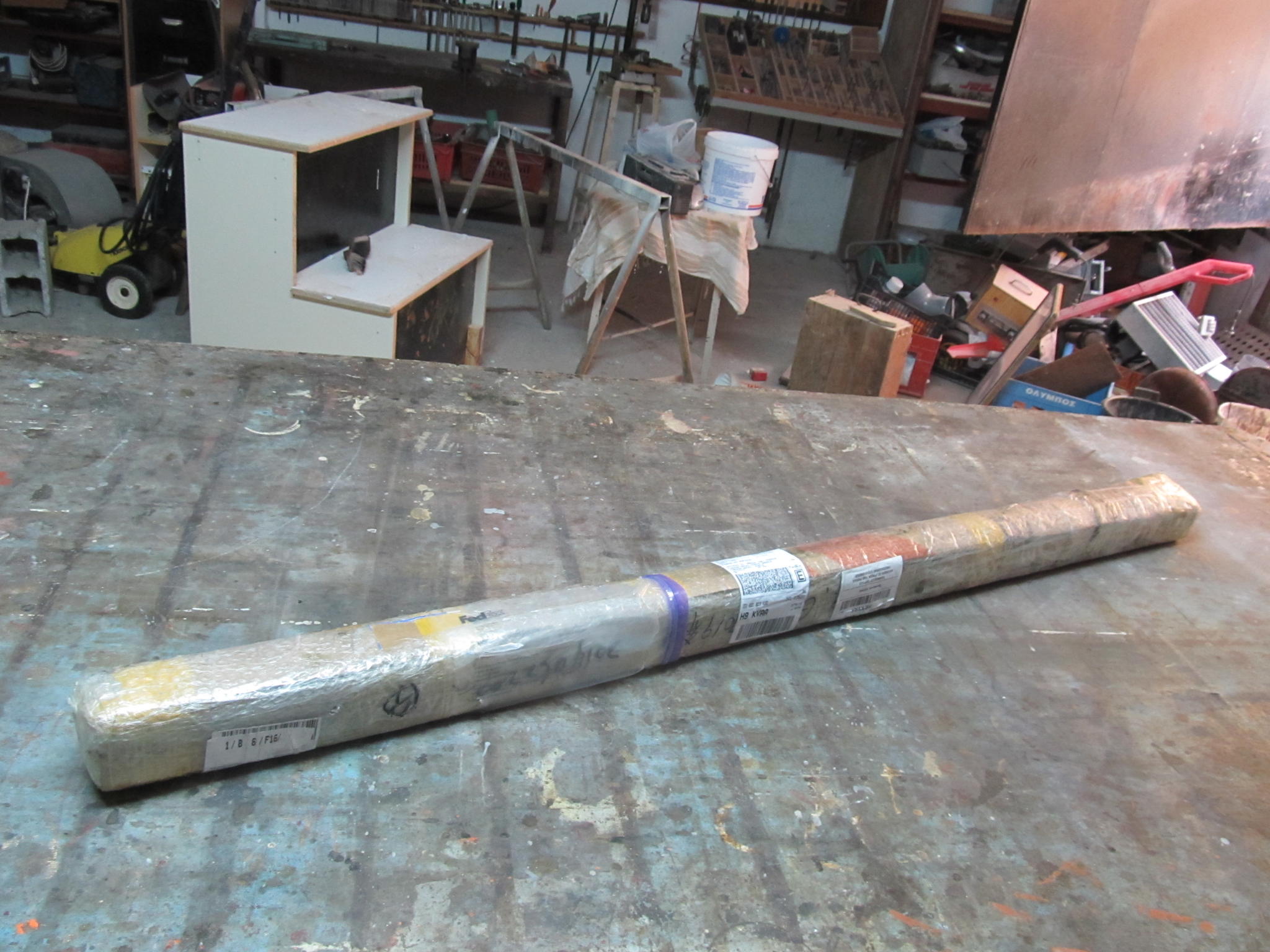

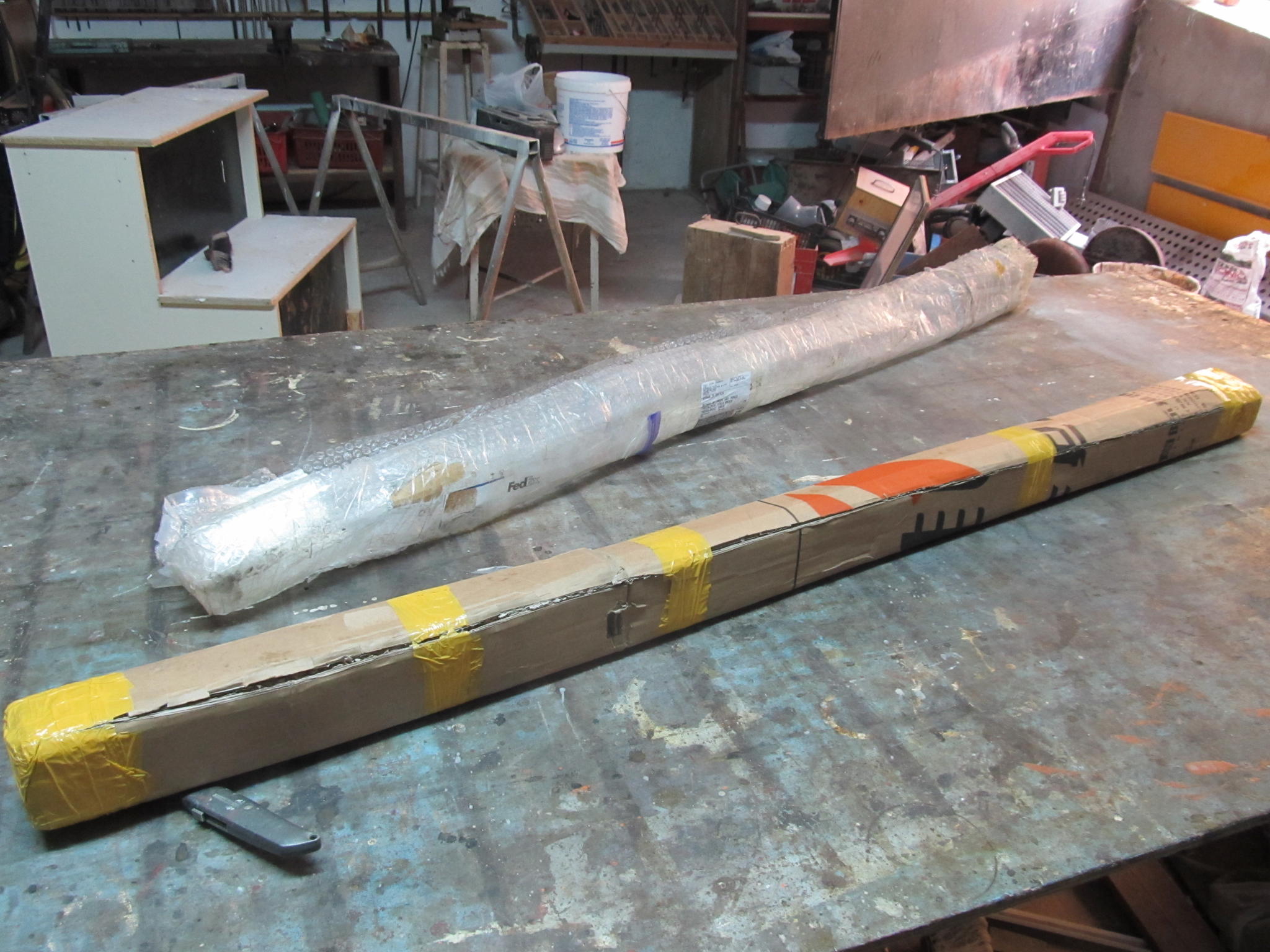

Yesterday i receive from Chai the above things
2X anti backlash ballscrews RM 2010 C7 end machined -1603mm Overall length
2 ballnuts for 2010 ballscrews |
1X anti backlash ballscrews RM 2010 C7 end machined -1153mm Overall length
1X anti backlash ballscrews RM1605 C7 end machined -501mm Overall length
1 ballnut for 1605 ballscrew |
| 3 Set of BK/BF15 |
| 1 Set of BK/BF12 |
| 1x Ball Nut Mount/Bracket Flange For 1605 |
| 3XBall Nut Mount/Bracket Flange For 2010 |
Attachment 12515Attachment 12517Attachment 12518Attachment 12519

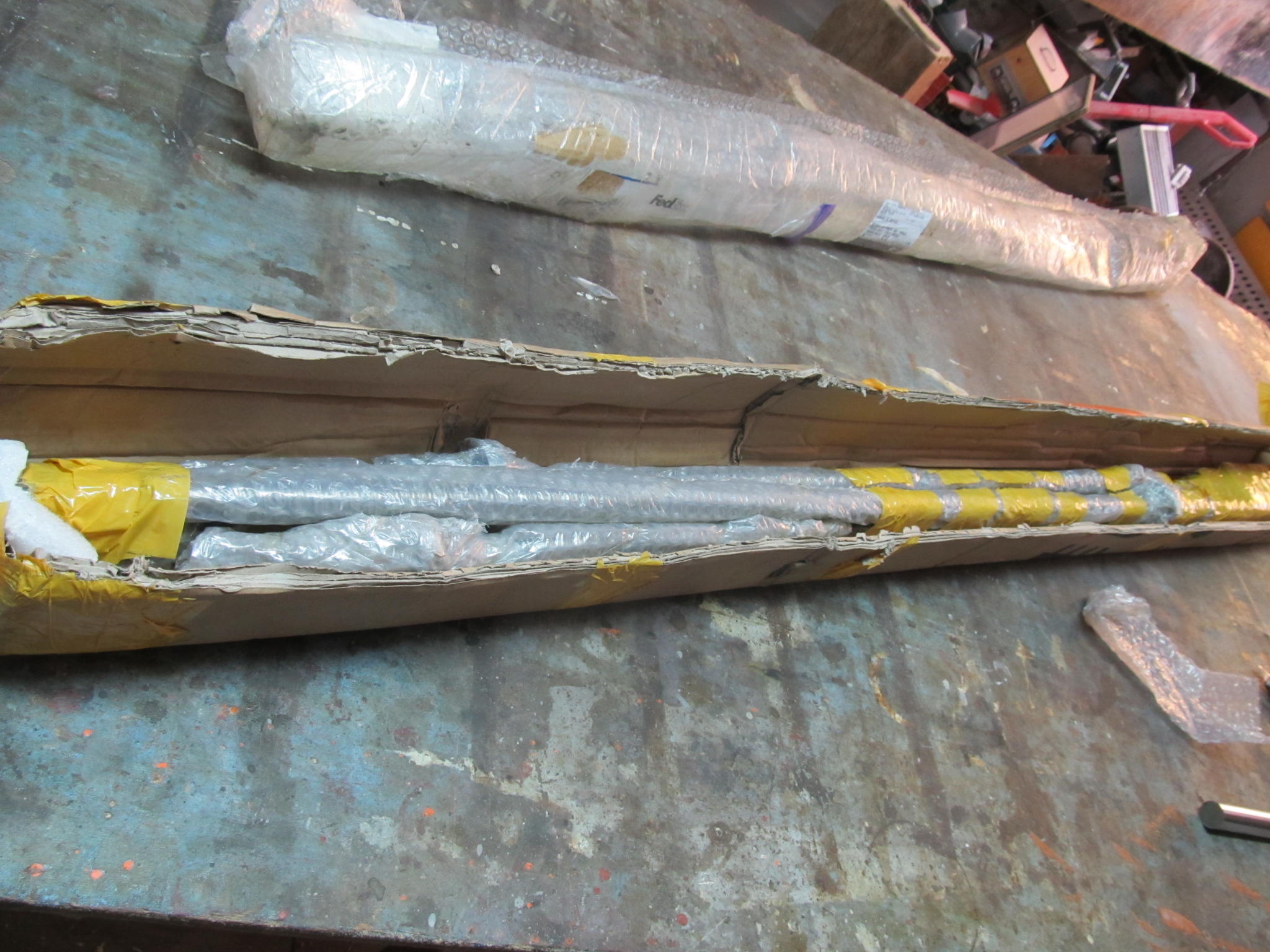

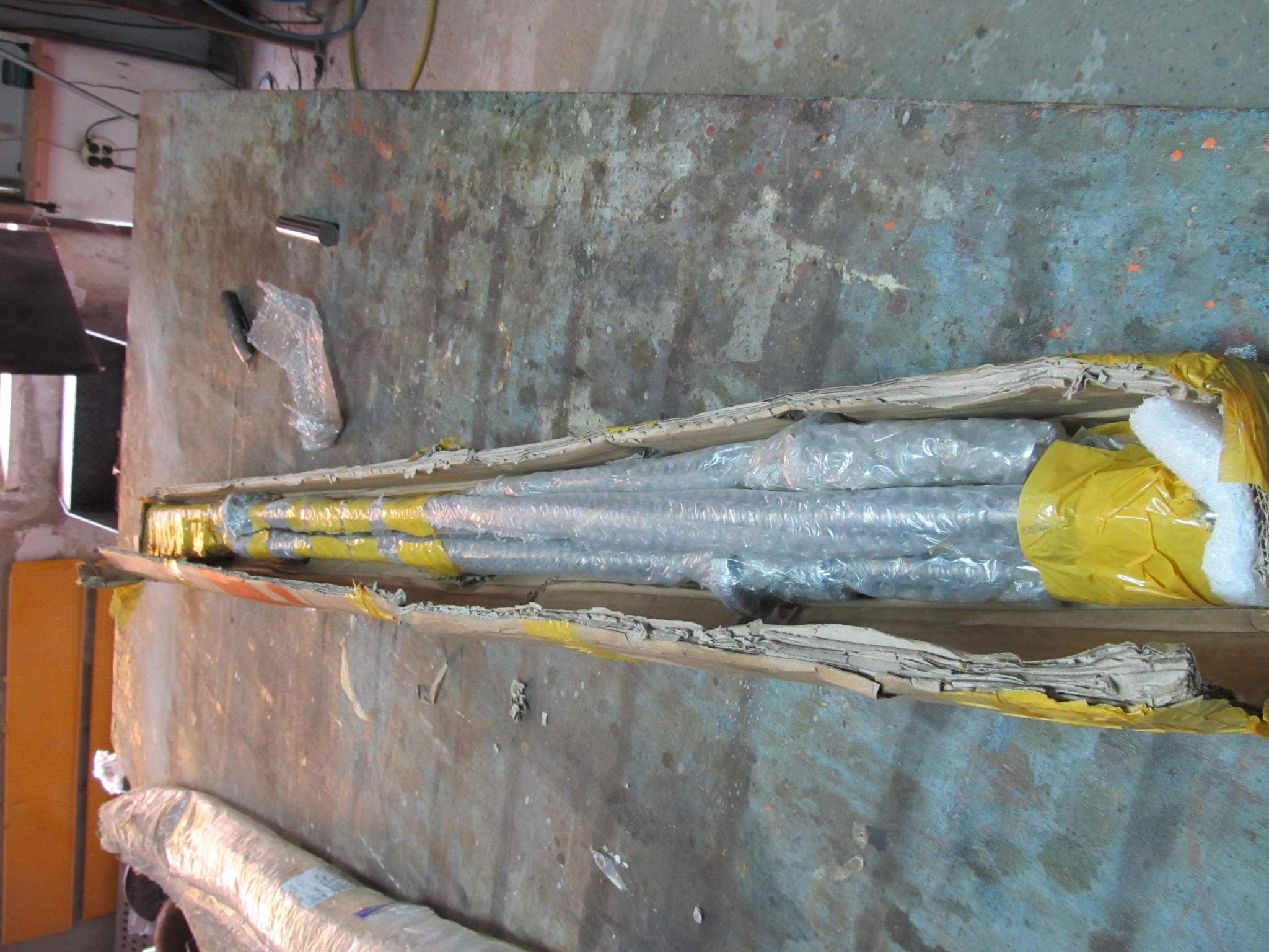

I open the box to see if everything is ok
I attach the bf/bk at the ballscrews, and i realize that the screws seems to be bended
I give them motion with a wireless drill and they are "dancing" like crazy especially one of the 2010 1603mm long ballscrew. It seems to move 4-5mm out of the center axis. Also the other three are whipping(1-2mm).

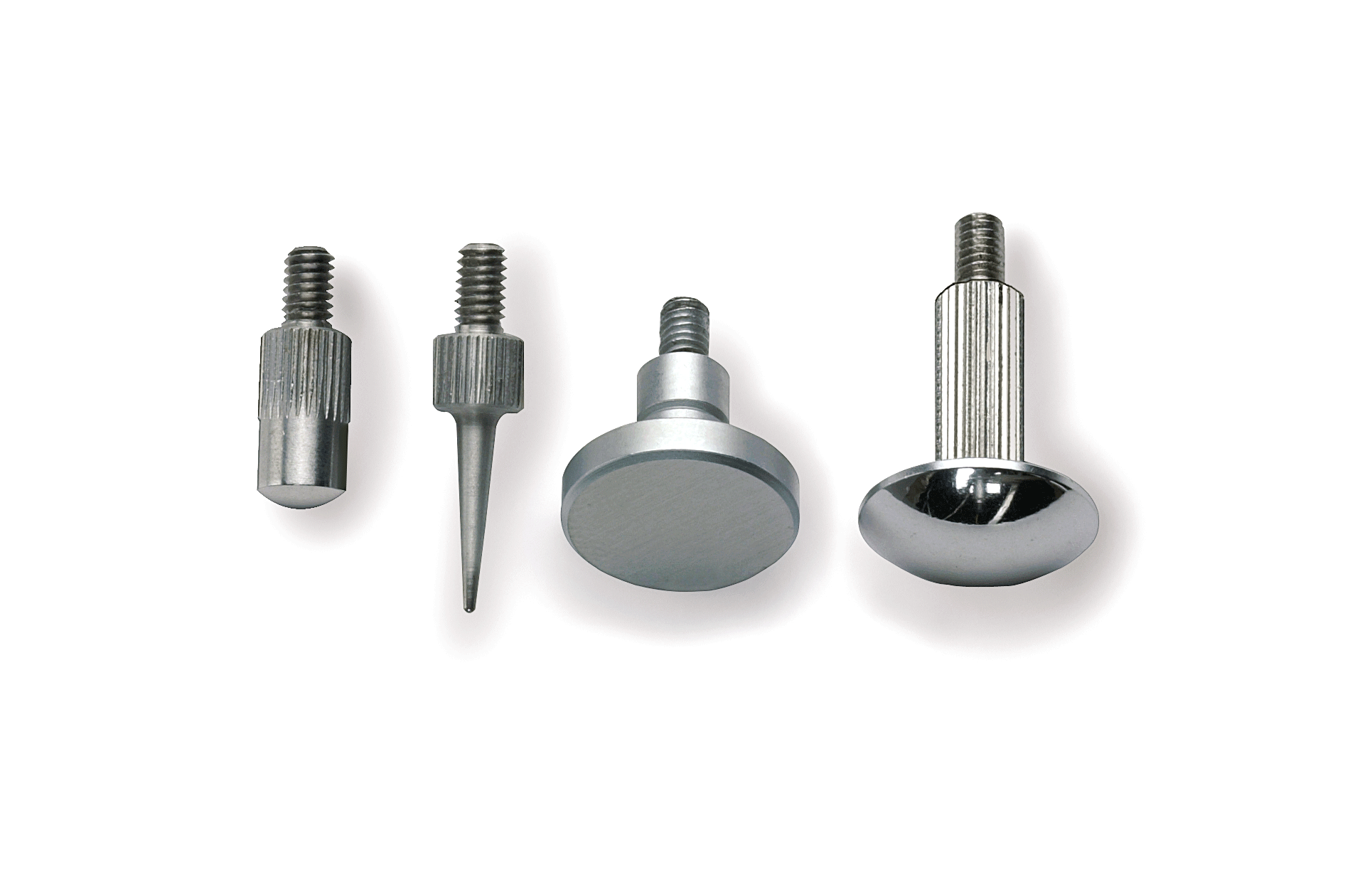

Q1 You can't use the Node of the indicator directly on the screw you need something flat between the screw and the indicator node.

Would you not use a flat tip probe - like the one 2nd from the right in the pic..?
Attachment 12540
Wal.
Re: Bended ballscrews. What i can do?
Wal
Attachment 12540
Wal.
Yep them's what's needed Wal but like finding Hen's Teeth unless your prepared to splashout on expensive dial gauges and then they are expensive for a one off job.!
Edit: I retract that statement I've just found this set at Arc eurotrade (bottom of page).!!. . . http://www.arceurotrade.co.uk/Catalo...nt/Dial-Gauges

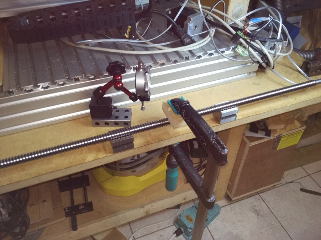

After finding this topic, I thought to give it a go.
As numerous people with Chinese rolled 1605-C7 ballscrews, I have to somehow deal with bends ...or live with them. In my case, we are talking about 3 items of 720~780mm lengths and 0.54~1.32mm runout (the latter can be seen with naked eye). This is how I am trying to deal with it.
Attachment 21393
After finding the high spot, I have tried several variations:
- v blocks at ends, quarters, 100mm and 50mm from high spot
- bending down by 0.5*runout, 0.6*runout, 1*runout, 2*runout
- applying force for 1m, 2m, 10m, 1h, 10h
Of course I have not tried all the combinations of the above and I have lost track of what combinations I have actually tried so far. I am trying to deal with the worse runout of 1.32mm and after a couple of days I am down to 1.21mm. I would not call this a progress.
Therefore my question to people that have had (some) success in the past is whether they remember what recipe (v block spacing, amount of bend, time of bend) started showing results.
I think you just need to bend them further, to not spring back. You are probably not applying enough stress to go past the material's elastic limit.
Jonathan
This.
If you don't bend past the elastic limit, then they will just spring back, regardless of how long you leave the clamp on. Position of support blocks, and pressure application point depends on the bend. How much pressure is very much trial and error. Apply pressure, release pressure, check to see how much things spring back, then repeat with more pressure if needed.
auhopu
I put them on v-blocks and tried to apply force in the middle.
For straightening you ideally need to apply a precise displacement then measure to see if you have achieved a permanent change, then keep increasing the displacement applied until you get the required change.
Measuring force is an imprecise way of straightening things, a press with a dial gauge is your friend ;-)
- Nick
