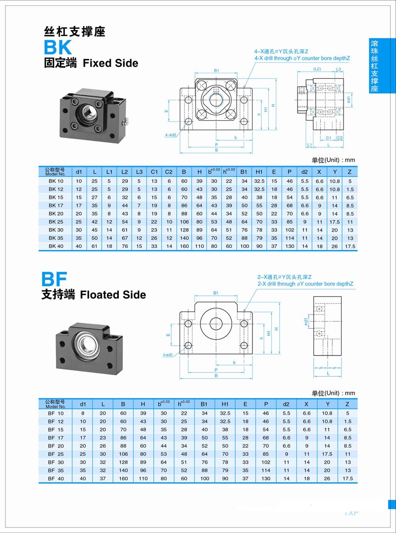

hi Jazz, i'm looking for dimensions for bearing blocks for 20 mm ballscrews, could you point me in the direction? i have been reading that fixed blocks at both ends is the best option, ya? i have a frame sketched and am starting into the y axis gantry design
Re: Let the fun begin !!! ???
Here you go this should help.
Attachment 12649

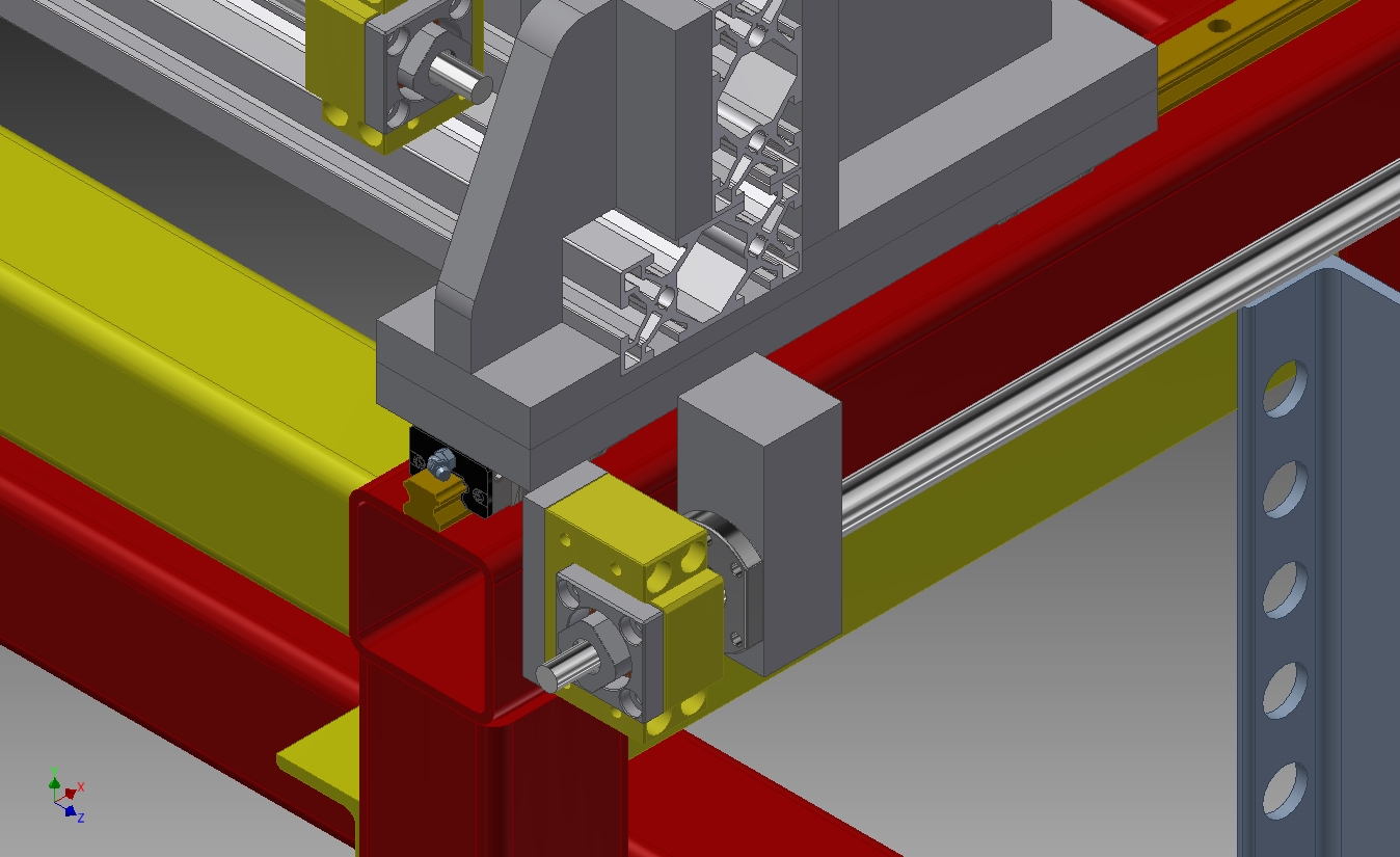

4 Attachment(s)

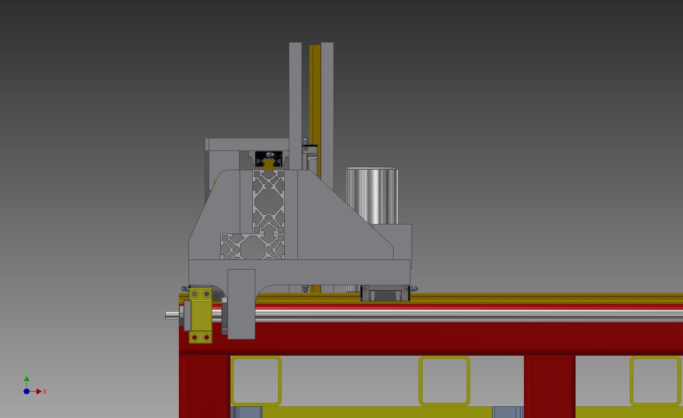

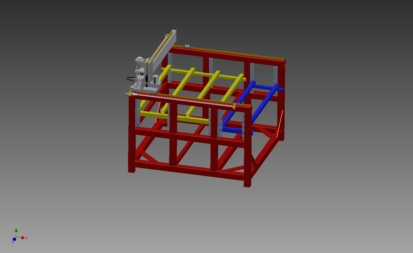

At last i have an opportunity to get some images of the intended build posted for comment. i have read a lot of material on this forum and tried to include as much advice as possible . i haven't purchased any materials yet even though i'm itching to get started , but taking the advice given to other potential builders from Jazz, Jonathan , among others, i will build the frame first and then once i'm sure of key dims. i will take on the mechanical purchases and build. the gantry images are posted as a reference to my intended build but as always i'm open to suggestions.
the frame size should take a half a standard sheet ( 1220 x 1220 ) built from 80 x 80 box section. 5 mm wall for the top rails and 3 mm for the rest. the adjustable bed ( yellow) will be held in place by graduated 50 mm x 6 mm angle ( green) secured to the frames uprights. the stand alone box section ( blue ) is detachable to allow space for a fourth axis , eventually!!
i have a choice of extrusion for the gantry ( length 1610 mm ) either 100 x 50 , 4.18 kg/m, 120 x 40 , 4.35 kg /m or 120 x 40 , 6.8 kg /m .
the linear slides, 20 mm hiwins , ballscrews 16 mm and aluminum plate for gantry , 20 mm . i haven't any motor specs yet so i didn't finish the z axis assembly . I might use 20 mm linear slides on the z axis ( off cuts from the 2m x rails ) or just purchase 15 mm rails. i will use epoxy to create a plane for both x axis and a permanent bridge for this and the x axis motor to belt drive the twin ball screws, OR use separate motors for each x axis ballscrew. all to be decided with the advice from the experienced builders here, hopefully!!!! i'm also looking for some motor dims, nema 23 , 3nm. they seem to be the weapons of choice for what i'm about to take on , so if any one can point me in a direction for a reputable supplier that has dims i can use to finish the z axis dwgs i would appreciate it. cheers Paulro.
The gantry ends look quite substantial but I'm not sure how well the structure will resist twist at the centre, here's some info relating to that subject.
Machine stiffness; http://www.mycncuk.com/threads/7155-...4942#post54942
Stiffness calculator; http://www.mycncuk.com/threads/2214-...5791#post15791
Hi Paulro,
Got your PM.
Yes the gantry will be fine for your use as a wood router and yes I've built one about same size using same design so know it works. What you doing with the ends of gantry and how you connecting to ballscrews.? Drawing with gantry mated to frame would be good to see.
Regards Y axis ballscrew mount then you'll need to brace the drop bracket more.

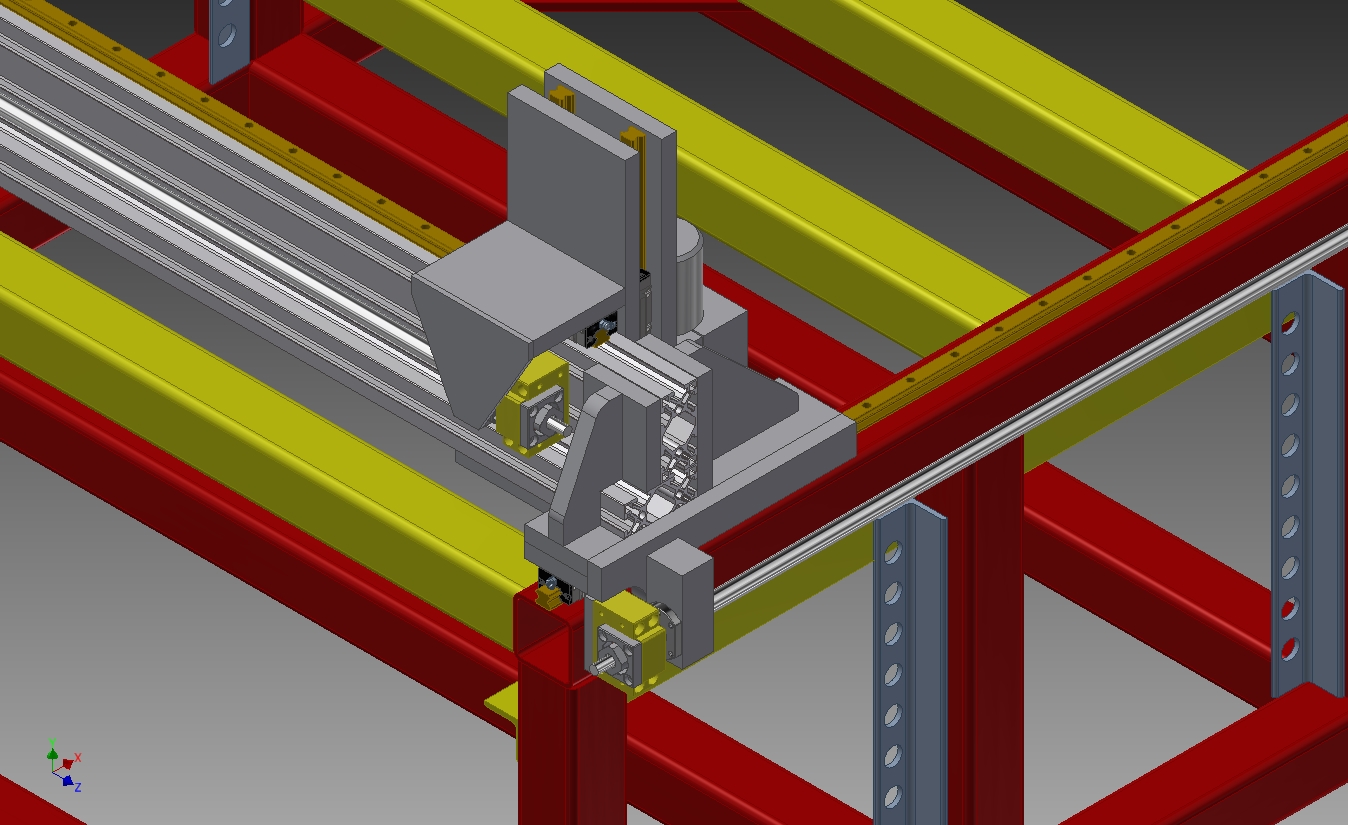

4 Attachment(s)

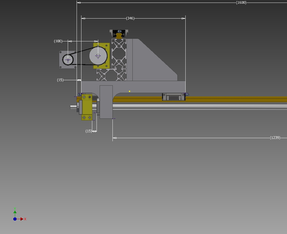

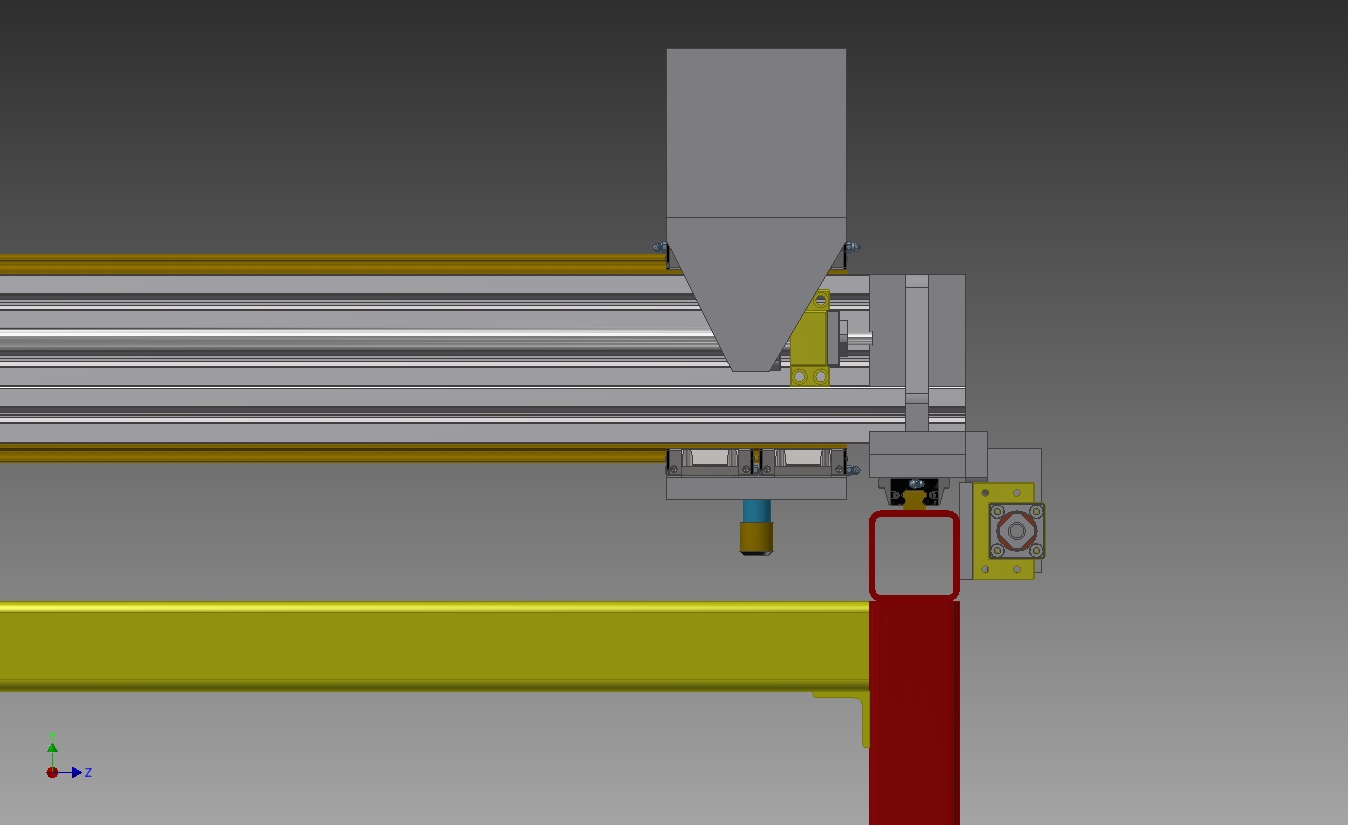

I could go with a heavier extrusion if that would aid the machining of plastics and aluminum (light gauge) from time to time. i have a choice of extrusion for the gantry ( length 1610 mm ) either 100 x 50 , 4.18 kg/m, 120 x 40 , 4.35 kg /m or 120 x 40 , 6.8 kg /m. i don't know if that would make for a better or worse situation.
Attachment 12986Attachment 12987Attachment 12988Attachment 12989
the images above show the gantry attached. i have yet to spec motors so haven't any motors mounts designed. i'm currently getting through Irvings tutorial on motor specs. what a great read!! i'm hoping nema 23s 3nm will do the job , by the way if i do go with these motors should i go for the heaviest i can get? any thoughts on this and the gantry extrusion choice would be appreciated.:indecisiveness:
100x50 will be fine but if possible get the HD version.
3Nm motors will work ok with 16mm screws but with 20mm you'll need to slow things down due to extra inertia so you'll get lower rapid feeds.
You'll want 10mm pitch which will be more suited to wood and plastics. Now if you use 20mm pitch screws and gear 2:1 ratio then you will still get same feed rates as 10mm pitch with 3Nm motors but with a couple of nice advantages.?
The ratio halfs the speed 20mm pitch gives but this gives same feed and resolution as 10mm so we get same speed but with half the screw speed but at same time doubles the motor torque. Lower screw speed means less chance of whip on long screws so it's win win.!
You'll need to run the motors around 70Vdc on decent drives to get best from them.

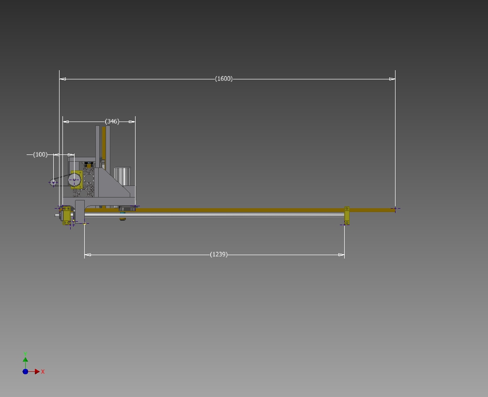

3 Attachment(s)

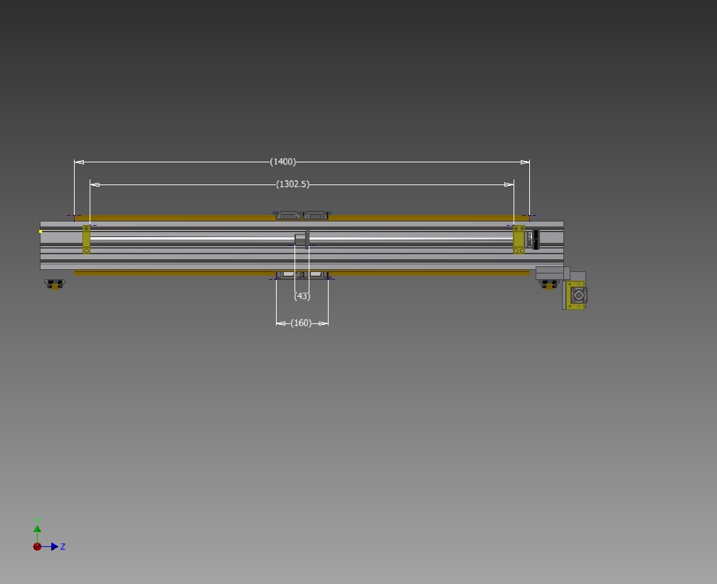

originally i designed around 16 mm x 10 mm ballscrews for X (1440 long) and y ( 1395 long) and 16mm x 5mm for z . i know from reading your previous posts that the length is critical or rather going over a certain length will almost certainly introduce whip at high speeds. i would like at some stage to tackle a Mayan calender and so i'm curious about resolution if i go with a 20 mm pitch. I'm not sure also about the amount of clearance i should leave between ballnut and bearing blocks either end. is there a standard clearance that i should factor in ? i have left 15mm either end but i'm not sure if this is enough.
Attachment 12990Attachment 12991Attachment 12992
i could also use nema 23 4Nm motors instead of 3Nm. (courtesy of Eddycurrent ) would the same psu ,motor drivers , smooth stepper, break out board etc. do for both? just trying to get a handle on the cost of everything required is a job in inself!!!!:hypnotysed:
At this length then go with 16mm you'll be ok, 16mm will allow slightly faster acceleration due to less inertia. Resolution with 20mm isn't a problem because the ratio effectively makes it same as 10mm and even with 1:1 ratio 20mm res you'd still have enough to cut the mayan calender.
There's very little between the 3Nm and 4Nm motors in terms of performance so you wouldn't really see much differance. Either will work fine with what your planning to use. Just run them around 70Vdc and you'll be fine.
With bearing blocks/ballnut then all you need is to leave a enough clearance in case you over run limits. In which case the limits should stop the machine so you need enough clearence for the over run. That said your better fitting hard stops in case of over run and have the bearing blocks just past these.
To be honest I wouldn't sweat over it you can control this with adjusting limits and they take a fair old bang to damage anyway so worst you'll do is knock something out of alianment.
Let me just say if your at the point of planning in cad to this level of detail then your wasting time that could be better put to use building the machine because in reality you'll more than likely to see a better place to put them on the actual machine.!! . . . . . Time to put the pencils down and pick up the tools.

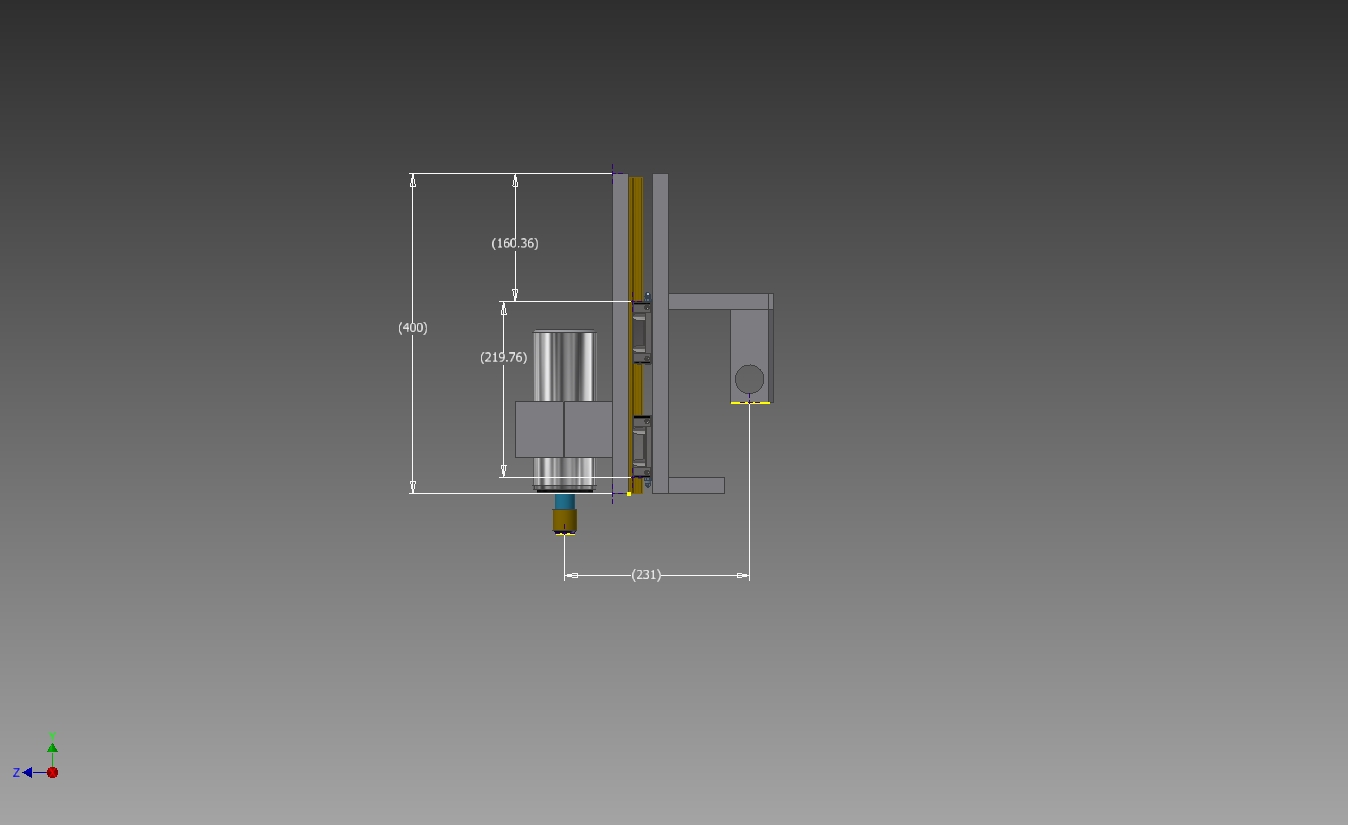

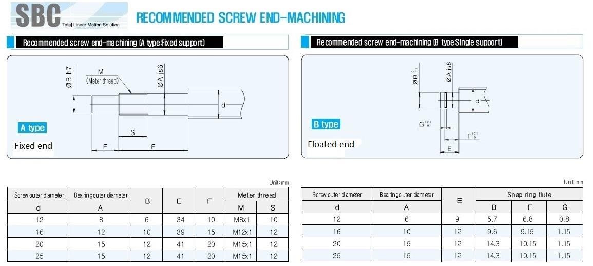

2 Attachment(s)
i have touched base with chai and just need to work out the 16mm ballscrew lengths. i also notice that the bearing shaft diameters for BK and BF are different and am curious to know why this is.
Attachment 13000
Attachment 12999
this is my z axis end view, it has 20 mm rails and a travel of 160 mm. i'm thinking of a z axis ballscrew length of 400+ 30 for for a timing pulley. i'm sure this is enough or should i go more?
I may be wrong but the BK end will have AC type bearings and the BF end will have a radial bearing they use a larger bearing at the BK end. Not sure if they make the ac bearings in the same sizes as the radial.
You will need to order the F measurement on the screw to be at least 30mm I think Chai standard is 15mm. ..Clive

PAULRO
If the backplate is 400mm same as the spindle mounting plate you will likely want the outside faces of the bearing blocks to be 400mm apart so they are flush top and bottom, this will allow the maximum travel.
So the BK bearing is 25mm thick (excluding the end cap and locknut) the BF is 20mm thick, so that gives a ball screw length of 355mm between shoulders. Then 12mm turned section on the BF end, 69mm on the BK end (E+F = 39+30). Total length = 436mm. You have to allow for the Z ball nut thickness , this will reduce the overall travel, I drew mine out using Sketchup to make sure I was getting the expected travel.
Also you might as well get the ball screw as long as possible because the price difference for a few mm is going to negligible.
PAULRO
Why is the rear plate so long.? you only need the rear plate long enough to fit bearings onto and give travel required. If your only wanting 160mm of movement then you would get away with shorter back plate and ballscrew.
Also one thing to take into account if your trying to get every last bit of travel out of screw is to allow for the bolt heads holding ballnut, you can easily loose 10mm depending on how tight you make it.
Regards the Z axis screw bearings then with screw being so short you don't really need one at the bottom if you want to keep cost down and it makes setting up that bit easier.
i had intended to use 20 mm rails on the z axis but after reading the various posts of your good self I am now going to use 15mm rails and guides to suit so i think a redesign is in order.
the rear plate should be shorter alright i just left it long enough to house the motor with a body of 100mm long and a plate to hold it.
i suppose the travel of the z axis could be longer but i went with that travel because of all the discussions about the length of the lever created by the extension. i suppose it's another trade off , keeping it to a minimum while having enough scope to machine to a reasonable depth. i'll get cracking at it again tomorrow, my shutters are starting to descend !

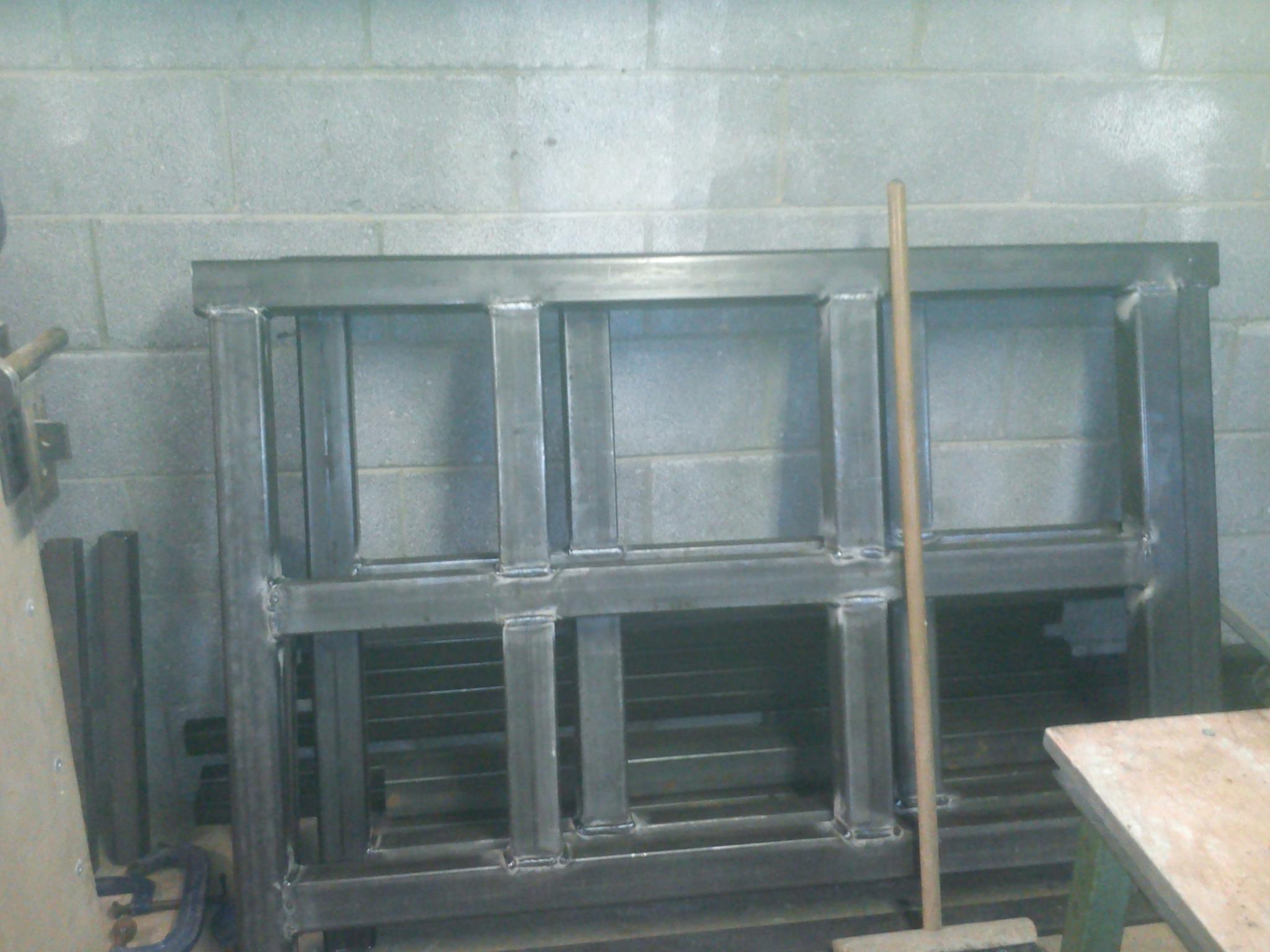

2 Attachment(s)

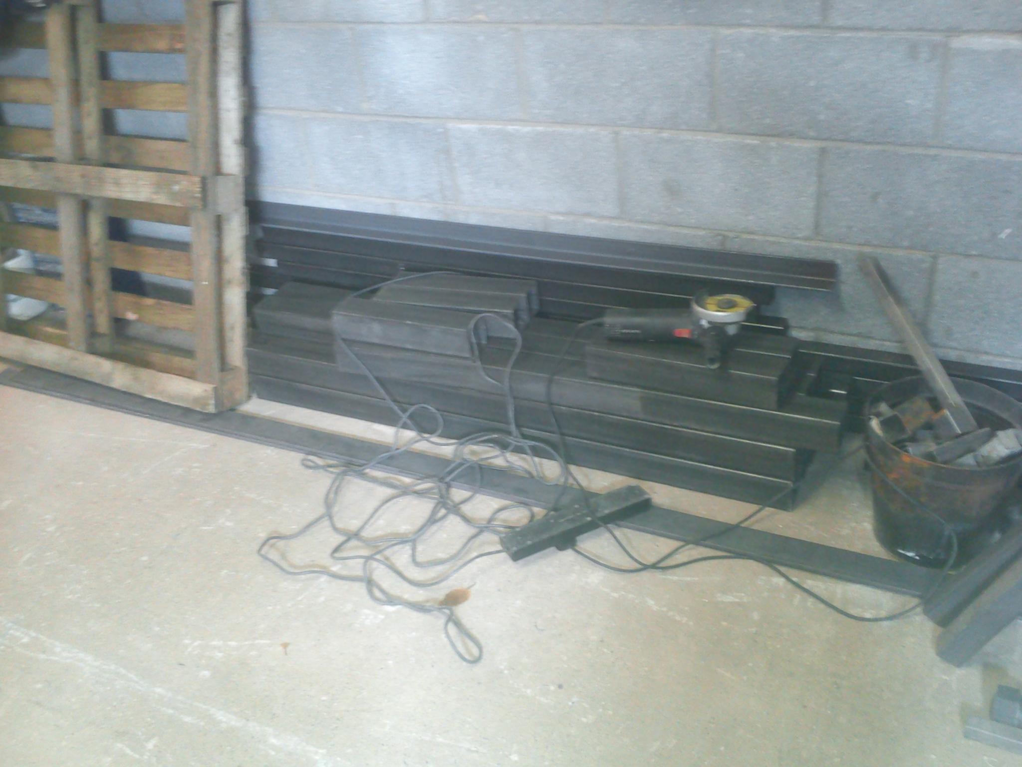

steel has arrived and is cut and both sidewalls are welded.
Attachment 13138Attachment 13139
I have to string the crossbeams and tie both together.
