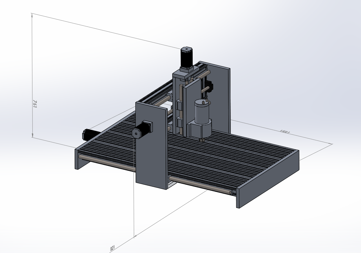

I'm about to start a build of an all aluminum router. It's not my first build, but the previous ones were MDF abominations that should have been birthed squatting over a bucket of water. Let's not mention them again.
Right now I'm in a design phase, and I'm very open to input. My build is constrained by rather small space, complete lack of decent tools, severely lacking metalworking skills and a tight budget.
I've uploaded an album with some pictures of the build, and a few FEA simulations giving a hint of where the weak areas of the construction are.
http://imgur.com/a/F77V6#0
Edit: Revised build after getting some tips - http://imgur.com/a/pM3GU
Edit: Third iteration: http://imgur.com/a/kszzz
Edit: Fourth iteration: http://imgur.com/a/zyBVw
Attachment 12715
It's designed using 60x60 aluminum profiles and 20mm 5083 alu plates. I know 5083 is less than ideal, but it's what motedis.co.uk is carrying, which is where I plan to buy the bulk of the materials.
The linear parts are designed from a kit: http://www.aliexpress.com/item/3-SBR20-300-600-1000mm-set-3-ballscrews-RM1605-ballscrew-support-3-BK-BF12-3-couplers/522559269.html
My questions are:
Will I be severely crippled by using 5083 instead of 6061 or 6083? If so, do you have a recommendation of an alternative to motedis? Apart from that, I am very impressed by them, without actually having bought anything yet.
I'm considering going dual ballscrews on the x-axis. But I only have 3 steppers+drivers, meaning it would be a pretty hefty investment to get everything extra for that. Is it worth it? Is it essential for success?
I'm having some trouble finding a good way to mount the ballscrew supports, any ideas?
I'm going to use a 2.2kw water cooled spindle. Any ideas on a cheap, closed loop cooling system? Also, anyone tried the "Sanven" spindles on amazon.co.uk?
Apart from that, I'm looking for any and all input on how the design could be improved. I'd like this one to be near perfect before I start buying stuff.

You haven't mentioned what you want to cut, but with a machine like that you will be limited. Wood and plastic would be reasonable if accuracy was not critical - e.g. engraving, or general shape cutting.
Beyond that there are many features which limit this machine, the high sides and single ballscrew being the immediate ones.
Looking at your lateral stiffness analysis this shows 1000N gives 0.39mm. This equates to about 2500N/mm. Although this would be a reasonable start point if you could achieve it, it's not clear if the force is being applied at the spindle centre line, or closer to the gantry on the Z plate. If it is on the Z plate then the real figure would be much less. This analysis is also idealised assuming ballscrew bearings etc. are all solid. Putting this analysis to one side I would say based on your comment about 'near perfect before buying . . . ' this needs more work on the general design before you worry about material spec (e.g. 5083 vs 6061).
Your other analysis showing maximum stress of 18MPa for 1000N is not that useful since all it shows is that the machine is massively strong enough and will not break during cutting. For example yield for 6061-T6 is about 240MPa and I think your cutting forces will be much less than 1000N. But don't confuse this with stiff enough because this will be a very basic machine as mentioned above.

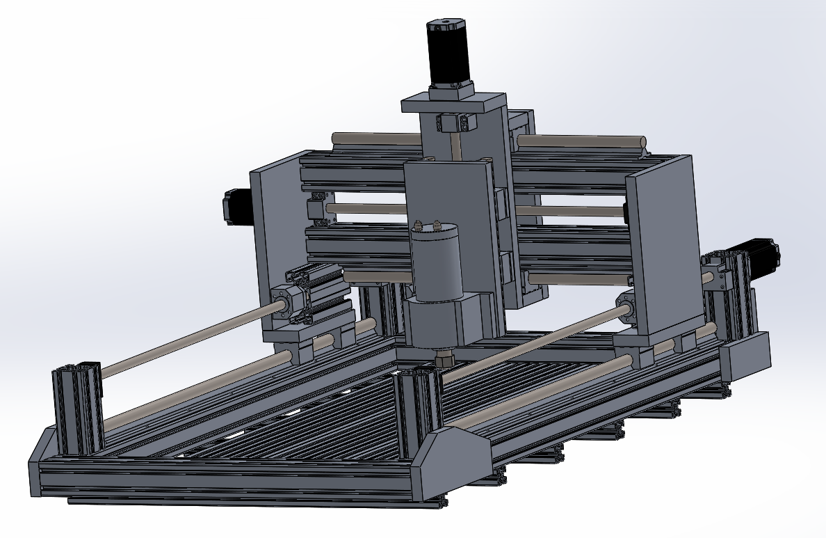

2 Attachment(s)
Re: Aluminum router build - Could use some input
To help you get more feedback I've dropped a screengrab from your site into this post - hope this is OK.
Here is your version 1:
Attachment 12595
Here is your version 2:
Attachment 12594
If you are keen to stay with supported rails and aluminium extrusion then this is a pretty good layout, and much better than the first one. My view is that you will be able to cut wood easily and accurately, and the occasional bit of aluminium.
But if you end up doing a lot of aluminium then you will find that this machine is not enough. An upgrade to profile linear rails on at least Y and Z is recommended, the gantry sections are too small and not joined to each other (e.g at least a plate over the back), and the X axis stepper motors are mounted off long brackets.
With the layout you have now I would look at moving the X ballscrews outwards and down, level with the supported rails. Then extend the small horizontal plate which the gantry sits outwards and screw the ballnut to the underside of it. There are other variations but you get the idea. This will enable you to mount the motors nearer to the frame, effectively stiffening the X direction when cutting. If this is too big a change then at least make the small plates on the outside much bigger and triangulate up to the motor position.

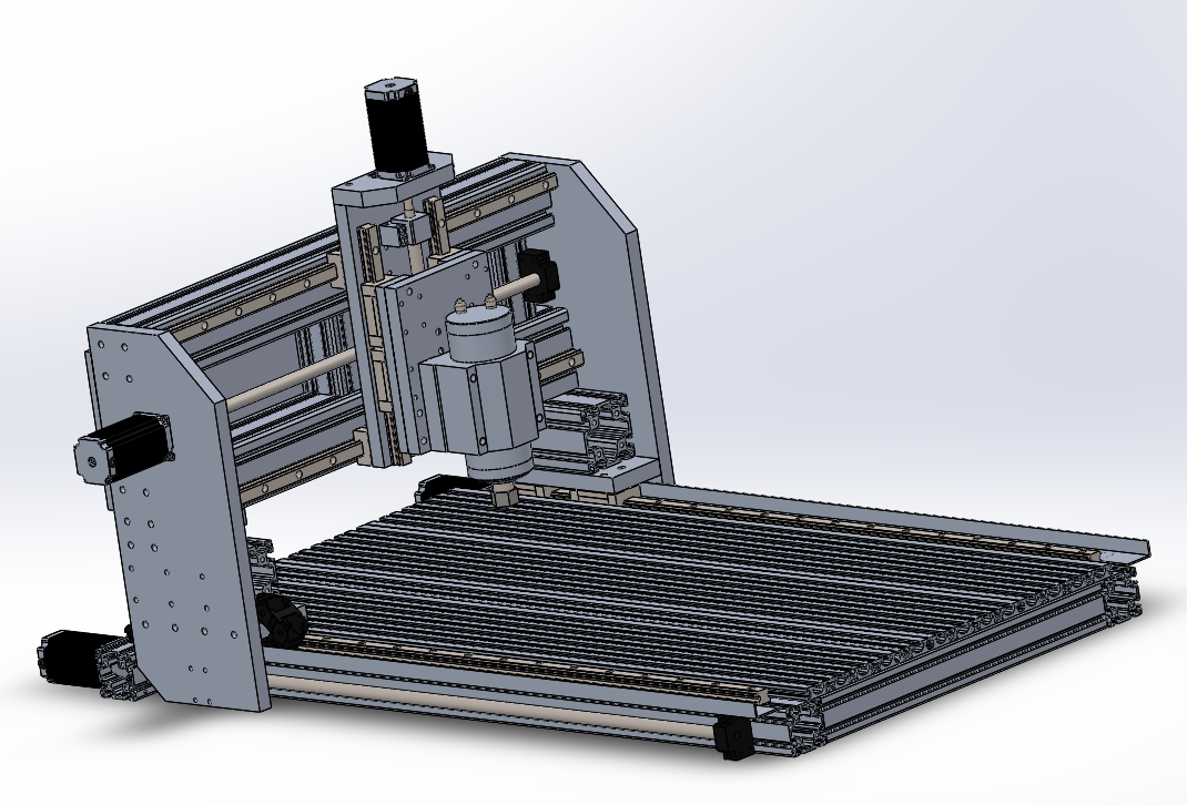

There we go, third iteration. I've switched to square rails, 20mm. The frame is now a mix of 60x60mm and 80x80mm alu profiles. The alu plates are 20mm, except for the backpiece spanning the gantry, that one is 10mm.
The steppers should be more securely mounted, the gantry should be stiffer and hopefully I think it might be slightly easier to assemble.
What do you think? For some reason it just looks "wrong" to me, can't really put my finger on it.
Made some smaller adjustments, mostly cosmetic, but should have made it slightly more stable as well. Especially the table.
Any input is most welcome, I'm about to start ordering parts unless someone has any objections and/or improvements...
Looking pretty good now in my opinion. Again, if you are intent on lots of aluminium with a really good finish and short job times then the raised X-axis designs are really the way to go (i.e. not this layout).
However, with this design as it stands you should be able to cut wood, plastic, and the occasional aluminium without any problems. I'd say it fulfills your brief and will make a nice machine.
I'll just make this comment, which you can take or leave! The extrusion pieces between the gantry sides, rails, and lower plate - I can see why you've done it like that and it will help alot with the corner stiffness. But they look a little unfinished, if that sort of thing bothers you, then one of your first cnc jobs could be to cut out some 6-10mm aluminium plates to go over the ends and tidy it up a bit. The rear end cover plate could easily be larger and join all the gantry, side and lower plates together. In your link the rear view is shown in the 5th picture.
Good luck with the build and post back as you go.

2 Attachment(s)
This machine will be ok for medium duty aluminium cutting and will cut at those feeds and speeds but you will need some form of cooling with aluminium to get good results with finish. either Mist, flood or blown air.
One thing I would do is get rid of those openended profiles has the offer very little strength and they will actually make building harder.? How will you access the Bearing bolts.?
You will get the same or better strength from some simple 90deg triangle shaped plates bolted thru the gantry sides and into the bearing plates. Something like in the pics but made better looking this was just quick throw together.
This will also allow easy access to the bearing bolts and make simpler to build and adjust etc. You could drop that plate at rear or just use some Thin 2mm plate as a blank if you want to close gantry but I wouldn't and would leave open so chips fly thru.!
Attachment 12719Attachment 12720
Also I wouldn't connect direct to the screws with steppers but use timing belts and pulleys. This will help with resonance and give other advantages by allowing ratio to be applied if needed. It's been discussed many times on forum so do a search if you need to know more.
