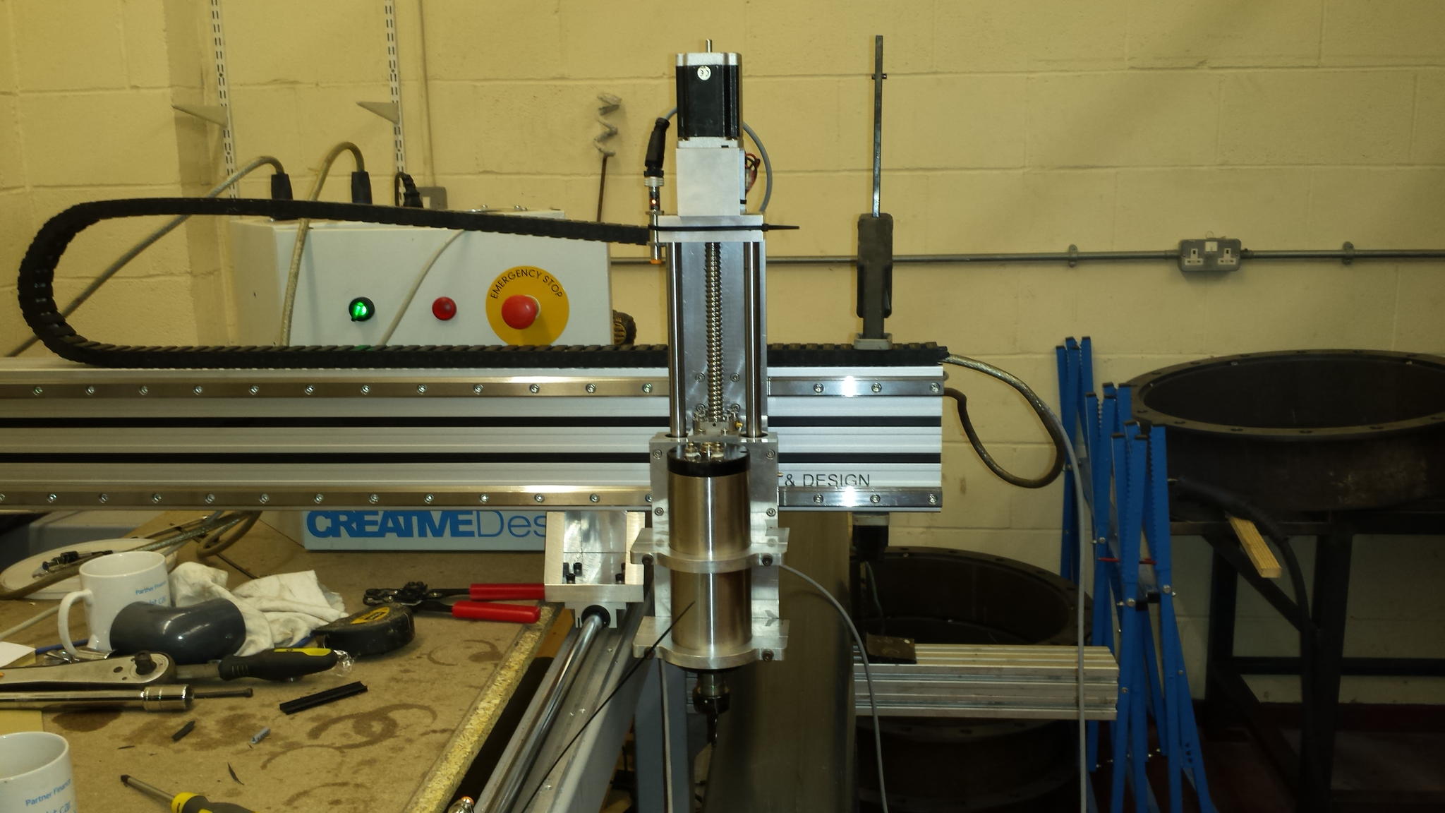

Hi Clive. I will be driving 1605 ballscrews on all axes 1100 x 700 x 300 nominal flying gantry style router from alu plate and extrustions (see pic attached)
Attachment 12861

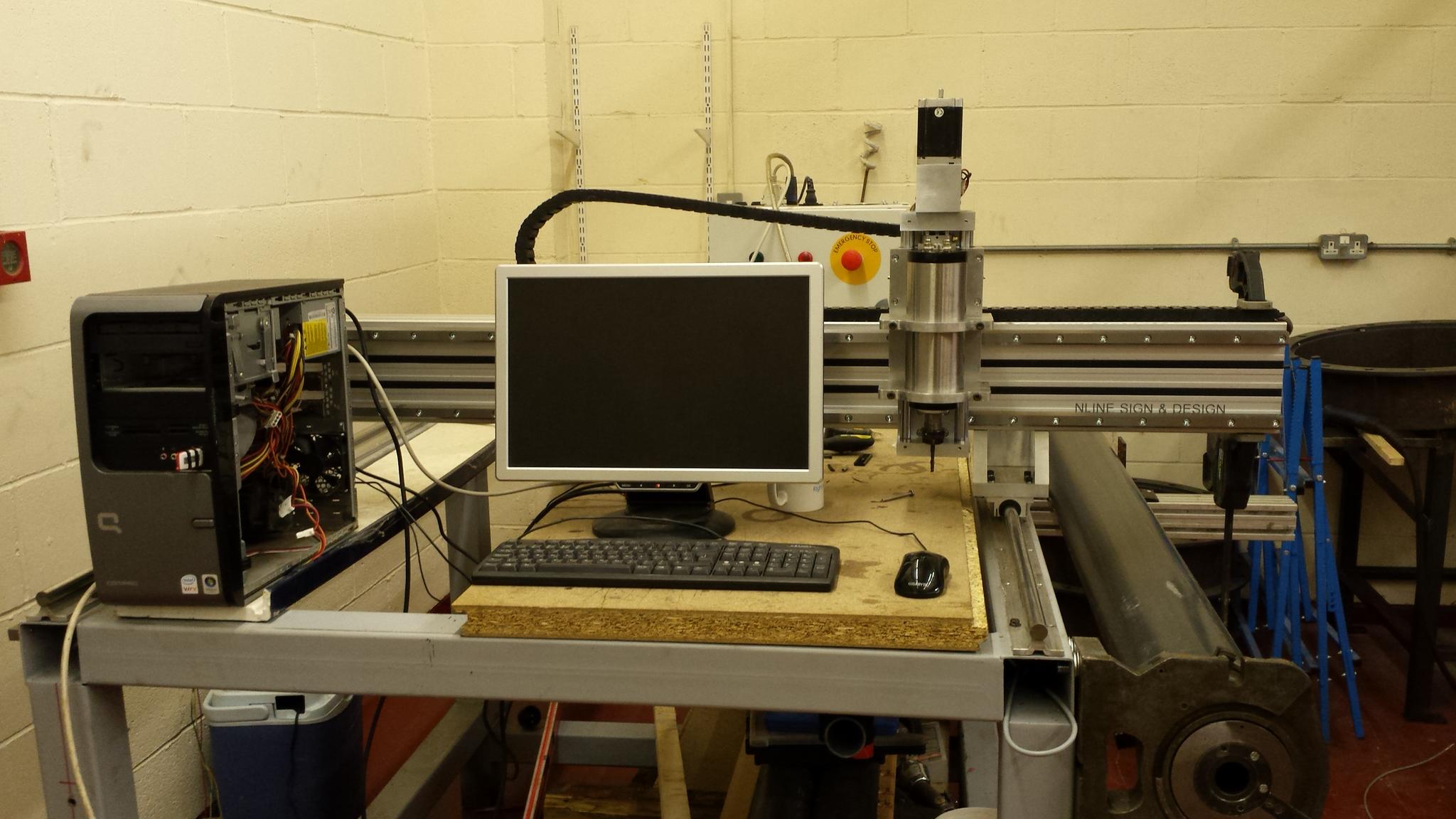

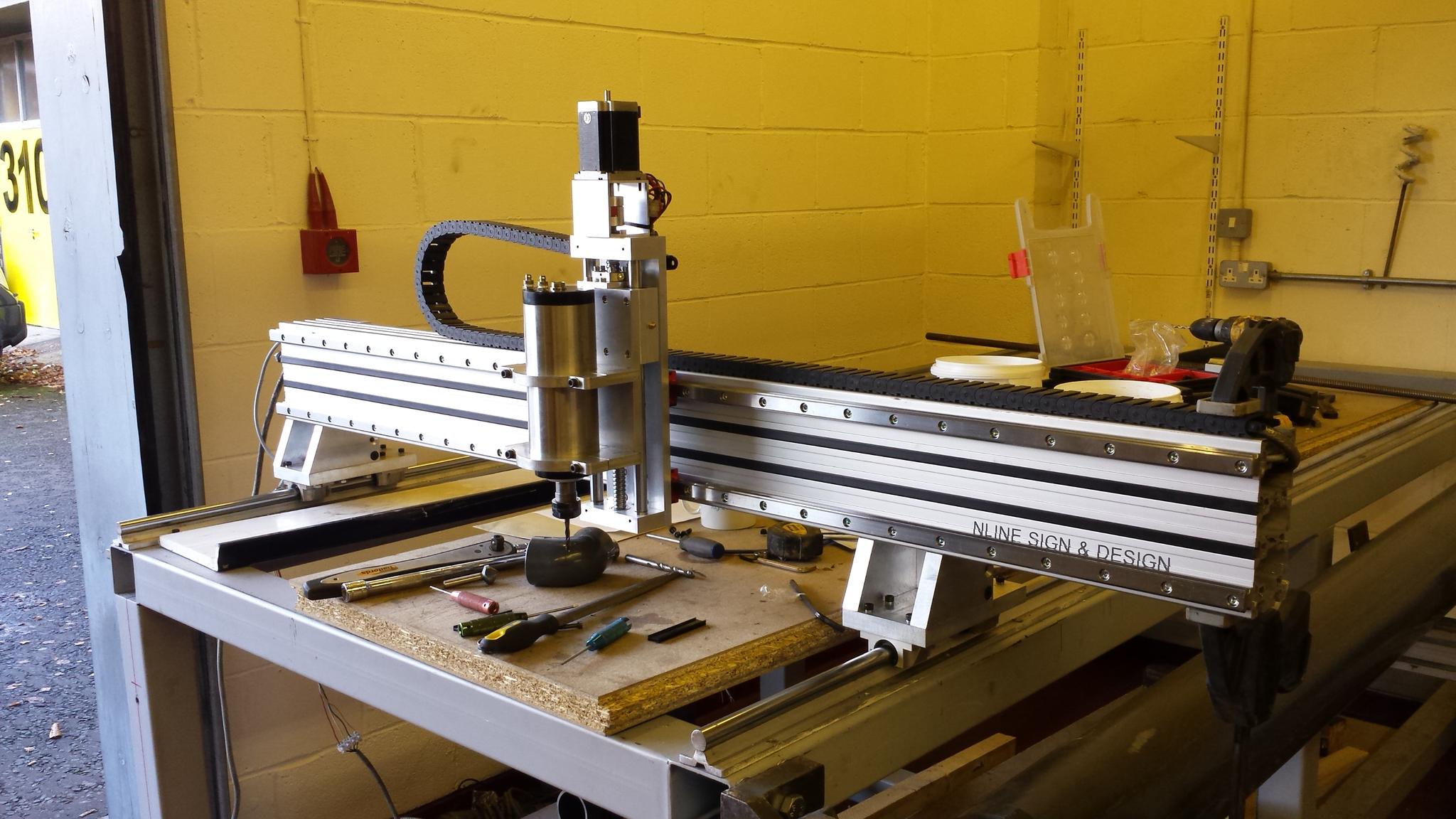

Thanks Clive, Yeah i need 34 all round as its a heavy gantry with future plans for it to put on a little more weight! This is the setup i had before i stripped my last machine down due to a huge bust up with my last boss. unfortunatly everything else was left :(
I decided to run R&P on the X with cncrouterparts pro drives
http://www.mycncuk.com/attachment.ph...id=13593&stc=1http://www.mycncuk.com/attachment.ph...id=13594&stc=1http://www.mycncuk.com/attachment.ph...id=13595&stc=1
