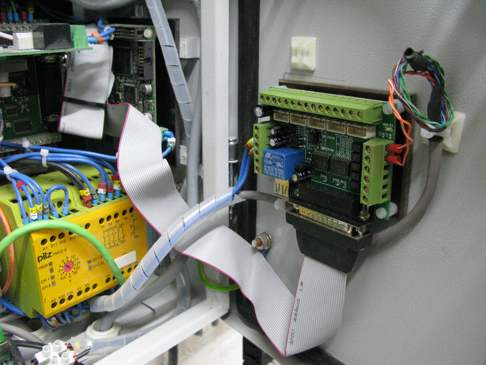

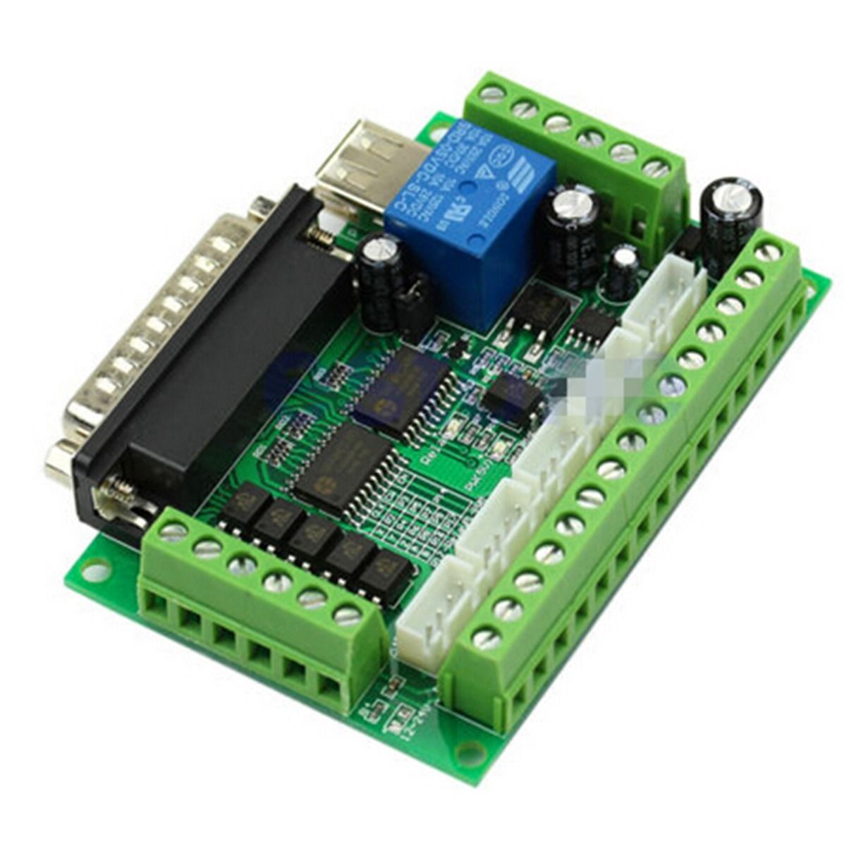

I'm not familiar with what the diffferent wires are, but the BOB has a 4pin connector for each axis. 3 of the 4 pins are used and the 4th pin has a loose wire hanging from it. The BOB looks like it has also the option of output via screw terminals, so I could cut the terminal blocks off and use those. But I'm wary of doing that before I hear from the seller, and if I get a replacement BOB Id rather just plug it in.
The wiring all looks pretty nice to me, but I'm not an electrics person. All the sockets into the controller feel like plastic, but they are conductive, I've tested the continuity of the casing.
Just grabbed this pic of my BOB from ebayAttachment 13217
Re: my 6040 experience (yeah, and problems) so far
Ok well I'm not a fan of those silly plugs and I'd wire to the terminals every time but your correct to wait untill seller responds.
That said if the problem moved then it won't be the BOB and chances are it's a drive or wiring to drive.? . . Again I would check the connections at the drives.

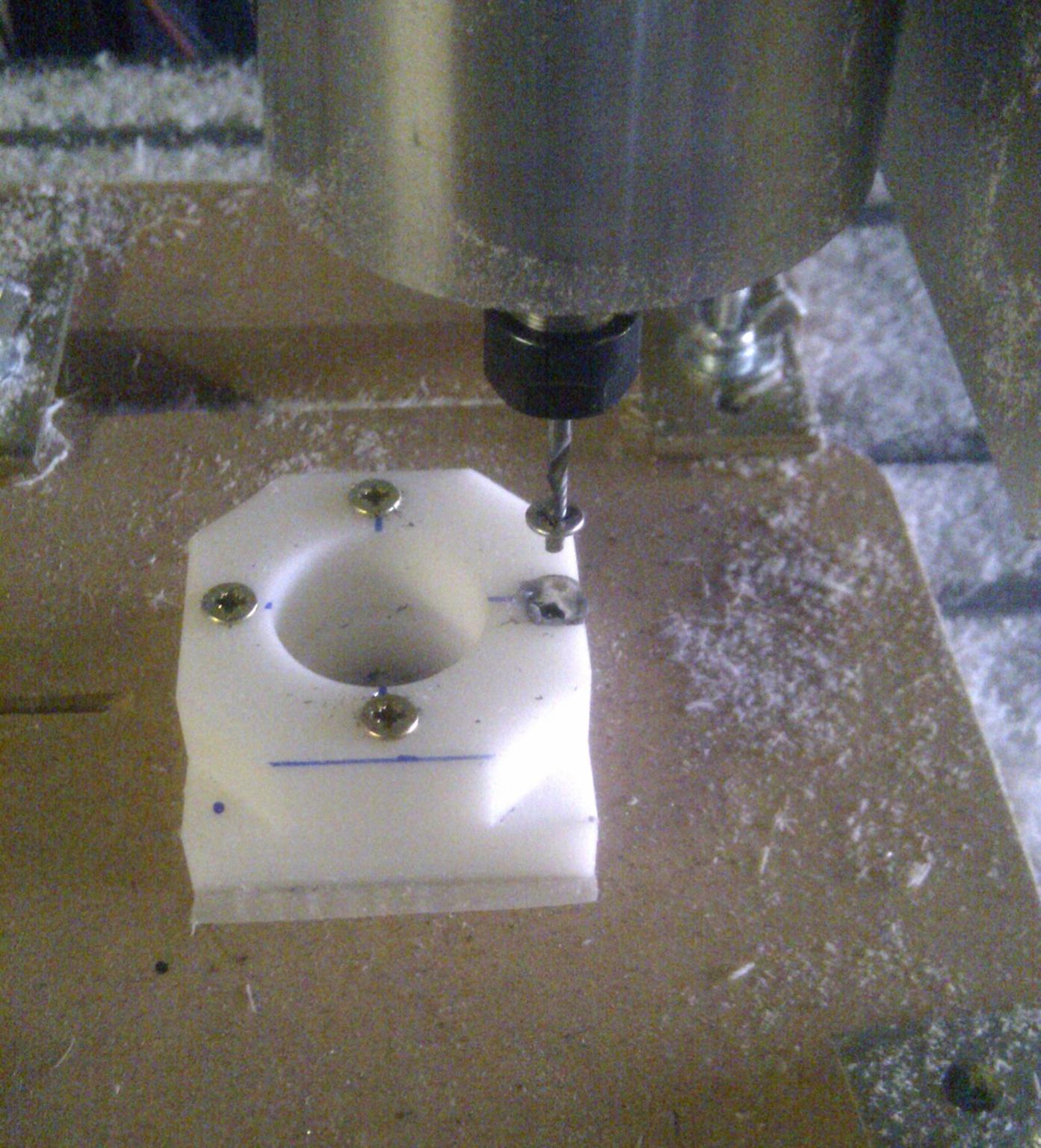

My 1flute cutters arrived so I had to make my first cut in delrin, 11000rpm DOC 1mm feed 1100mm/min. It was quite loud, the delrin was in a vice clamped to the table. It's all a bit like an aluminium drum at the moment, I will have to add a layer of something once I've thought about how I'm going to clamp my work etc

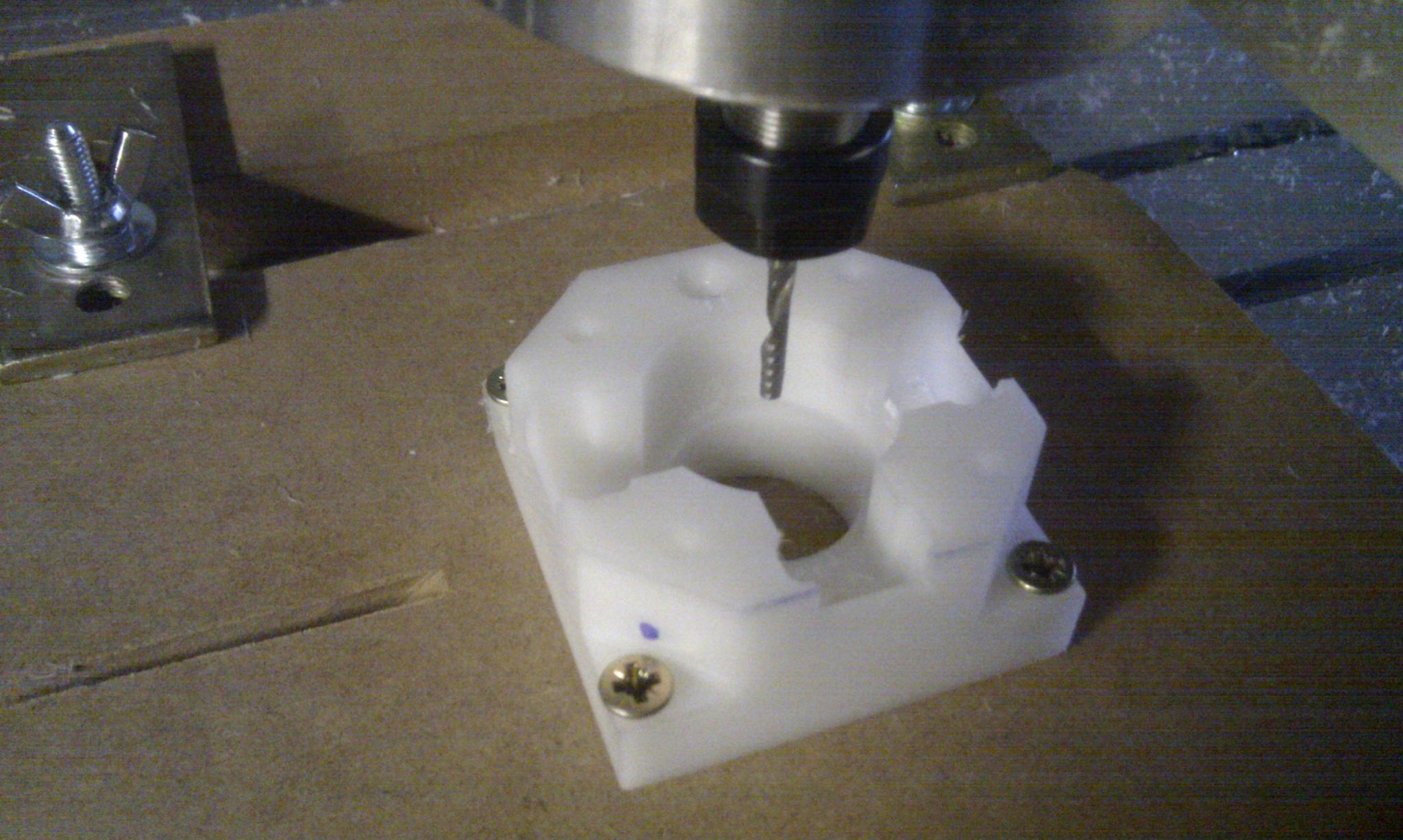

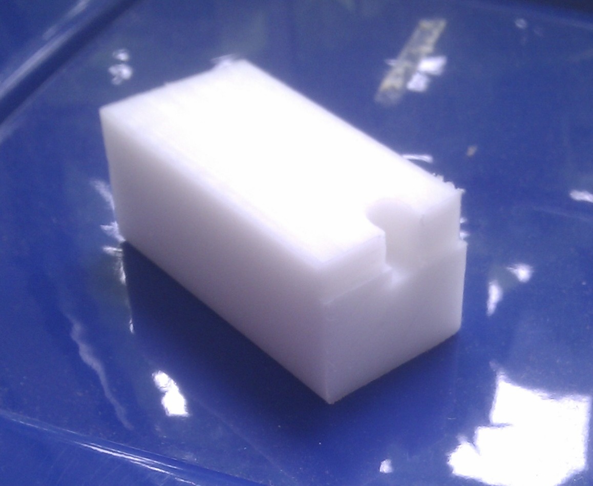

A pair of 2flute 6mm cutters arrived. Very cheap and came in 4 days from UK not HongKong. http://www.ebay.co.uk/itm/190984562714 price was only £1.69 last week ! I've got some more expensive ones as well coming from china, comparisons will come in due course.
So I disconnected Z, and that allows me to drive around in X and Y.
Feed 1200mm/min. 6000RPM.
First I did full width passes along the top at about 1mm doc > all fine.
Then I sidemilled the endface with doc 3mm stepover about 1.4mm. Fine conventional but when I tried to climb mill on the way back I got a loud vibration.
That made me panic :unconscious: and I hit a key (aiming for reverse!) and instead took a cut at full width 9mm doc. That too made a noise but nothing broke.
Attachment 13229
I'm pretty pleased. Acetal is the easiest plastic to work with, and I'm all for making life easy. These feeds and speeds are plenty for the small pieces I have planned.

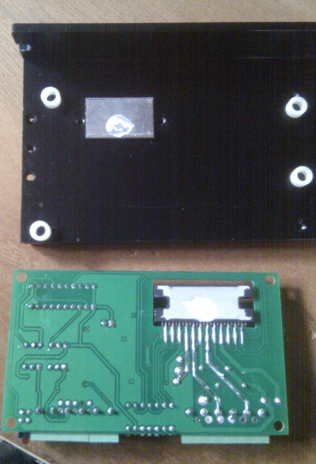

2 new drivers arrived today. Everything now appears to be working. I took one of the dodgy ones apart and the heatsinking was poor - blob of paste covering about 25% of the surface area. A nicely ground bit of aluminium plate between chip and heatink, but it had been chopped leaving a burr which lifts the end!
Before I do any sustained work, I think I will take my good ones apart and ensure a good heatsink connection.
Also spotted one very poor solder connection, so there is a posiibility of fixing the bad ones.
I did take the goods ones apart, and made sure the heatsinking was good. The 2 replacements, and the one original that worked had smaller (but flatter) heat sink pads than the faulty ones. Indicating that the design is at least evolving! The pad edges still needed a clean up though, and the paste was still only 20% coverage.

So what was causing the faults / resets when jogging from the keyboard ? did you change the breakout board ?
2x faulty Tongka M542 drivers. It would appear that the original BOB is OK.

Somewhat risky for a newb like me to have metal screws in the work area, but I took a chance. All went well until I hit the z-axis limit switches (piss poor planning) in the middle of my job. In the confusion I did the same as before, started the job mid program but I'd done a goto zero. I should have noticed it was heading off inthe wrong direction but I wasn't ready ready to pounce onthe stop button.
The tool scored a direct hit on a holding down screw.
Hopefull no damage to my spindle.Attachment 13240Attachment 13241
All seemed to be going well but I've got one concern. The third pocket, is undersized slightly eg 13.85mm instead of 14.0mm in the long axis direction. Does that indicate missed steps?
I ran it again at 70% feed and another sliver got taken off one face, so now 0.10mm undersize rather than 0.15mm.
I think I understand the undersize problem on long axis, I think it comes from slack on the long axis bearings. I can feel slack when I rock the gantry back and forward (on top of the flexibilty).
The setup is SBR20 round supported rails with matching bearings. I don't suppose they are adjustable? or maybe I can buy adjustable repalcements?
