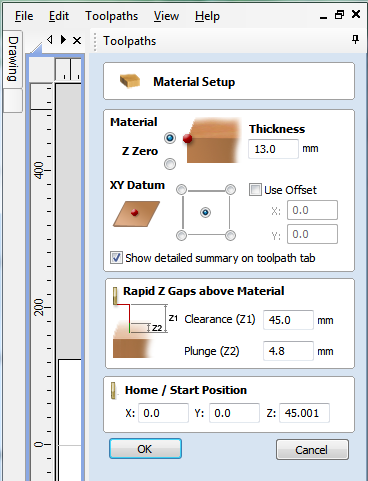

I set a 19mm sacrificial board on the machine today and on top of that I set a small 200 x 120 x 13mm thick piece of ply
After setting the machine to "HOME, I then, using my procedure above, brought the arm axis's to the centre of my workpeice. Positioned the cutter to the correct marked centre and zero'd X & Y.
Then I brought the head down and jogged until the cutter (A 3mm dia single flute end mill) just touched the surface and zero'd Z
In my V Carve software I set the XY to centre of the work, and the height of the material as 13mm. Reference start for Z axis was top of workpiece at centre.
When I started the machine and set it all in motion the X & Y axis travelled to the exact set point in the middle of my piece as expected, but the Z rapid plunged into that point to the collet nut depth ! (Until I hit the E Stop button)
What did I do wrong? I'm missing something here and feel a little dumb.... Newbie cock up I know... Loooong time since I did this and it's a fun learning curve again

By default V carve sets the material z position to the bottom of the job. Did you change it to the top?
Also did you have the "model in material" set to "gap above model". .. Clive
Re: Initial workpeice tooling set-up instructions using a pendant controller type mac
Clive S
By default V carve sets the material z position to the bottom of the job. Did you change it to the top? Clive
Hi Clive, yes I did change it to the top. The diagram shows as you say the default at the bottom of the workpiece, (Which I also tried) but irrespective of how I set it the Z axis is wrong... I'm wondering now if I am sending the wrong G code to the machine.

Ok, Material setup screen on RHS reads as follows....
Material Z Zero, red spot top left corner. Thickness 13mm.
XY Datum centre spot selected. No Use offset" ticked.
Rapid gaps above material
Z1 45mm (Need to clear a clamp) Clearance
Z2 4.8mm (Plunge)
The preview shows the cut ass I would expect.... about 4mm into the work surface
I'm thnking I've set something wrong here...

Ok you have a different version to me. you could post the .crv3d file if yours is the same then I could check it. But the gcode should also do. ..Clive

The V Carve program Material Setup window is shown on the BMP pic which might help when I post the one I have from the machine computer with the info I have in it and the code
Attachment 13235
I'm sure it's me not setting the software correctly.

Mine is different:-
Attachment 13236
as you can see so the gcode will help. ..Clive
