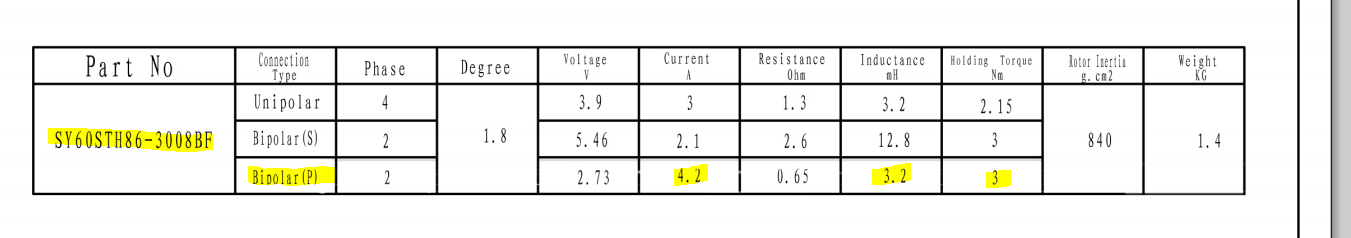

Definitely the 23 motor
The motor you point to is not a very low inductance motor. You need similar as what Zappautomation sells:
http://www.mycncuk.com/attachment.ph...id=13385&stc=1

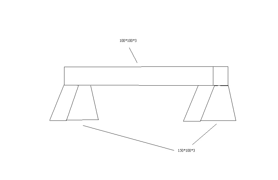

I plan to reduce the gantry weight using one steel box 100*100*3 welded to two pieces of 150*100*3 gantry side

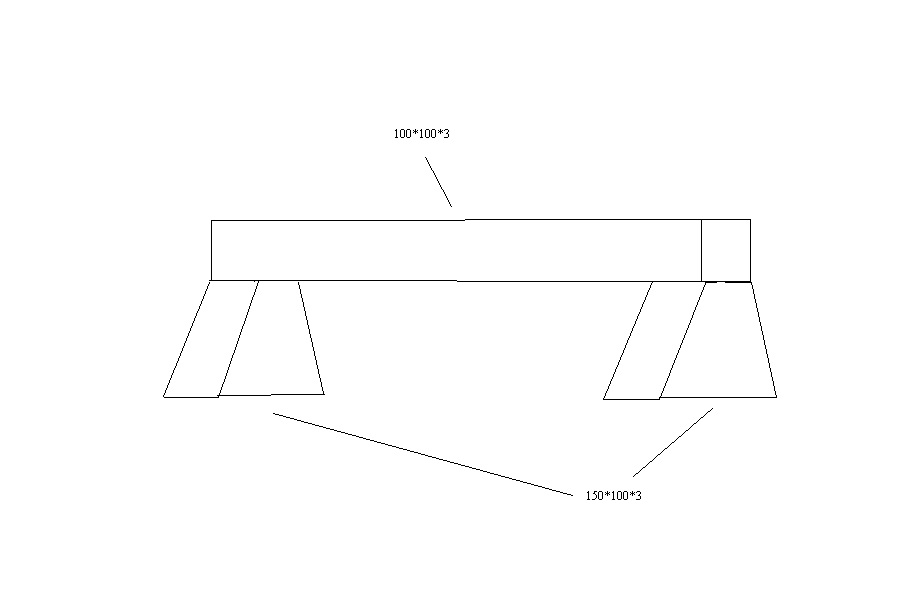

This gantry will bend and twist like crazy. Aluminum is out of question if gantry not reinforced. Irving told you also about the rack and pinion and aluminum.
The difference between mediocre machine and a good one is not $$$ but the amount of time you do a proper research and later make right decisions.
Better read some build logs here and things will begin to clear. Or you will regret later. I don't see how rack and pinion will be much cheaper than ball screw at the current China prices. And the rotating nut assembly is not so much different than the RP assembly money wise.
No offence but most of all - Z300mm, seriously? On a first machine, big machine and making decisions about motors without making a detailed drawing not having clear idea about what material you will like to cut mainly.
So why don't you just take a breath, read the forums, make your drawings, show them here, discuss them, correct them, etc. Start from the bed structure, gantry, Z, rails etc.

Well you really have got a problem with this selection because the motors and PSU voltage don't match together well.
R&P needs the JK86HS78-5504 (NM 4.6 - 651 oZ 5.6A 3.4mh) or the JK86HS115-4208 (NM 8.7- 1232 oZ 6A) and with only 60Vdc you don't have enough voltage to get good performance from these.
The JK57HS112-3004 (NM 3 - 425 oZ 3A 6.8mh) are not suitable for R&P and are better suited to 1610 ballscrews but again with only 60V and high inductance the performance will be lower. They really need 70+Vdc to get good performance.
My advise would be don't buy any of them has they are not matched nice but if I must choose then I'd say go with 3Nm and 1610 and build to this size.
If you can push the Voltage upto 70-74Vdc and use toroidal transformer PSU then you could get away with JK86HS78-5504 (NM 4.6 - 651 oZ 5.6A 3.4mh) and 28T R&P with 5:1 ratio.
This would give pitch equal to 22mm (Mod1.25 28T DP = 35 x pi / 5=22 ) which would give decent resolution for wood and good speed so you could tune motors down so they run slower where torque is higher and still maintain good feed rates.
Really the only motors you can use are the JK57HS112-3004 (NM 3 - 425 oZ 3A 6.8mh) and JK86HS78-5504 (NM 4.6 - 651 oZ 5.6A 3.4mh) and both these need more voltage, esp the 4Nm 34's.
The JK57HS112-3004 (NM 3 - 425 oZ 3A 6.8mh) with 70Vdc would perform best.

and i hope this PS match The JK57HS112-3004 (NM 3 - 425 oZ 3A 6.8mh) with 2510 and 1610
is one enough for 4 nema 23 steppers
thanks

what is your opinion about the design of steel machine above
Inertia of 25mm screw is too high for a 2.8Nm motor
i pay this PS 70~90V with previous Nema23 3NM is this work also double 1610 with 1750 mm length work good or not?

Ok well it,s been said but will say again to backup. Forget Single screw down centre gantry will twist at this width. Forget 25mm screws unless running nema34 with high voltage AC drives.
Now the sqrt(3.8 mh) * 32 is just a guide and in practice you can go higher without any issues or shortening motor life too considerably. (One thing to note because your in a Hot country I would consider putting cooling fans on the motors, PC CPU fans work well)
The PSU you linked too would work ok but first I would look into making your own.?
It's very easy all you need is toroidal transformer, 1 x brdige rectifier and capacitor/s. Obviously these need to be sized to give the output your require which we can help with.
You must have electrical component suppliers like RS components in your country so I would enquire about costs because Unregulated toroidal PSU is much better for CNC when your running near the drives Max voltage.
So Definately go with 2 x 3nm/1610 running 70V. Will warn thou that at 1750mm length with 16mm screws your at the point when whip at higher feeds can cause problems so you may still need to limit motor tuning to lower rapid speeds.?
Also the mounting and alignment will need to be perfect, which it should be anyway, but if your off just a little then this is amplified at this length which can introduce whip and resonance.!
So hopefully now you see why WE all have been asking you to slow down and think about it becasue so many things affect other parts of the machine and for good machine you need balance and components working in harmoney not fighting each other.!! . . . . In CNC we Make LOVE(chips) not WAR. .Lol
