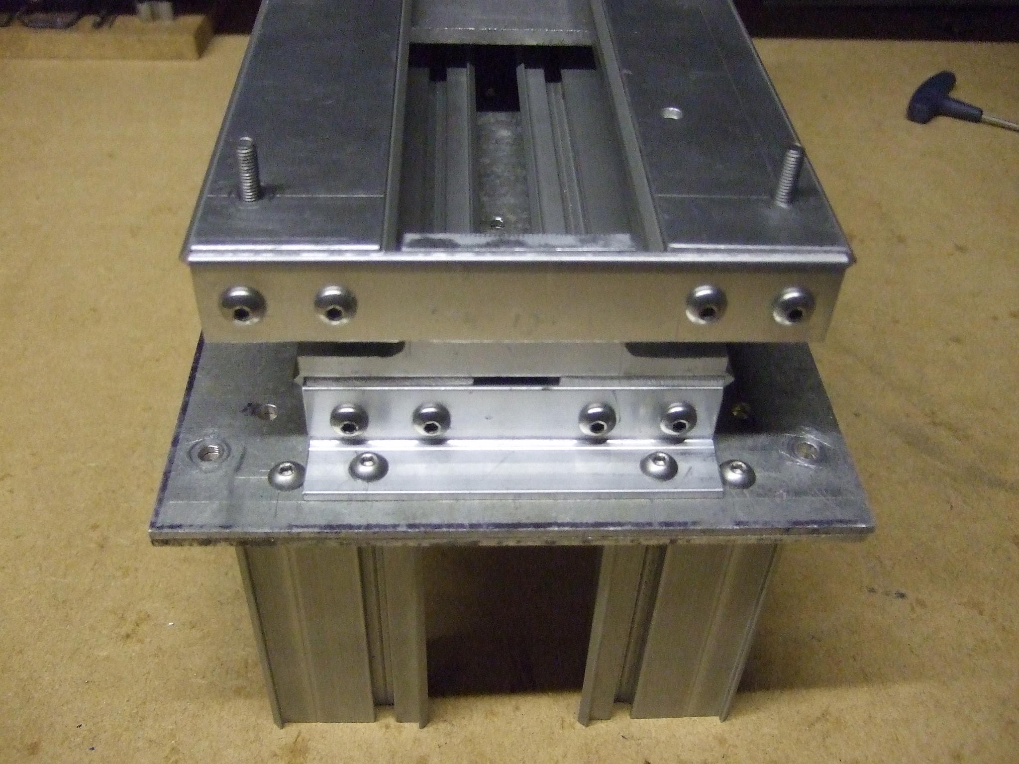

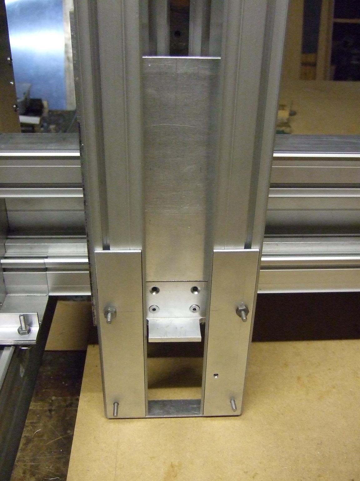

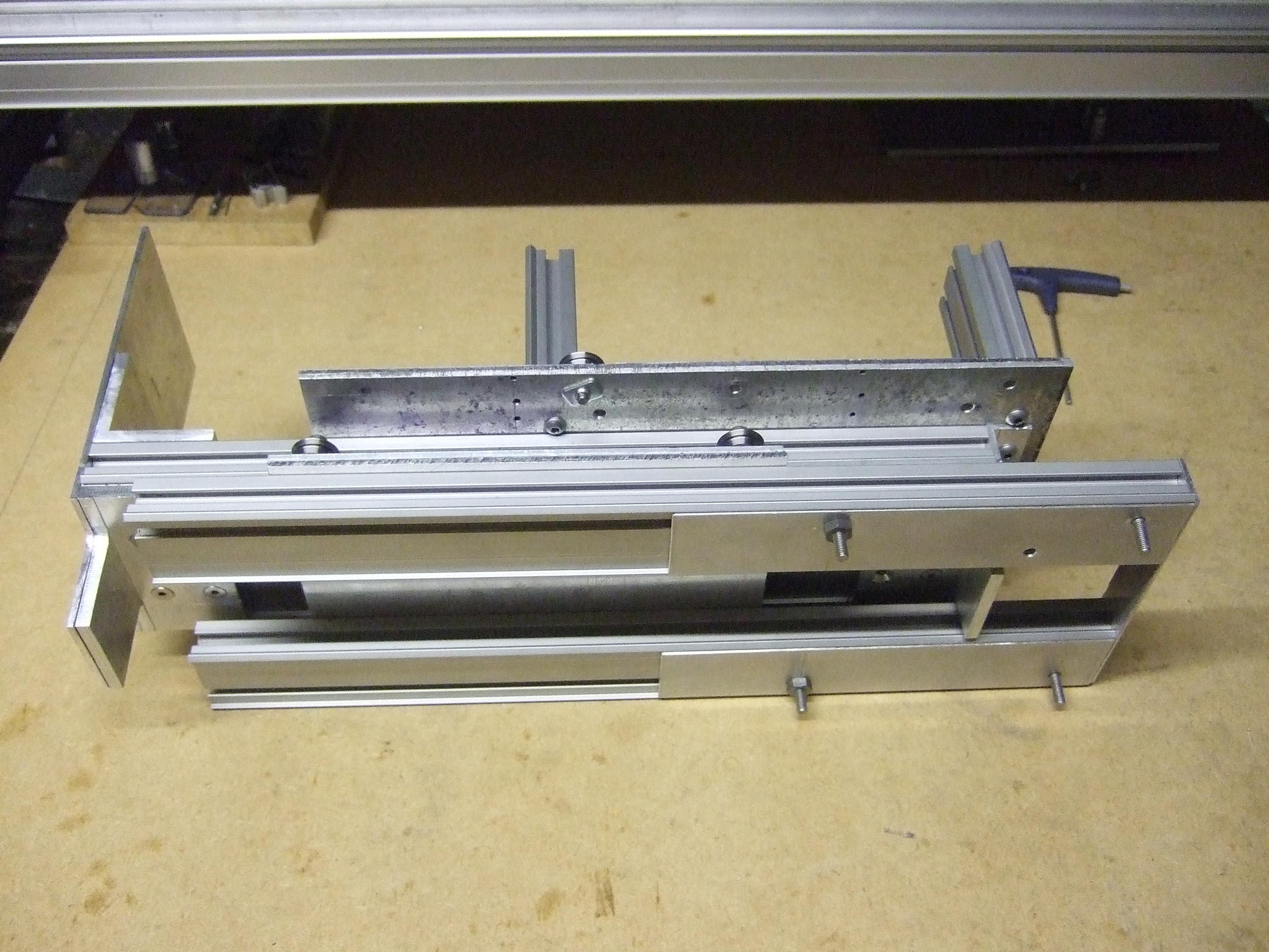

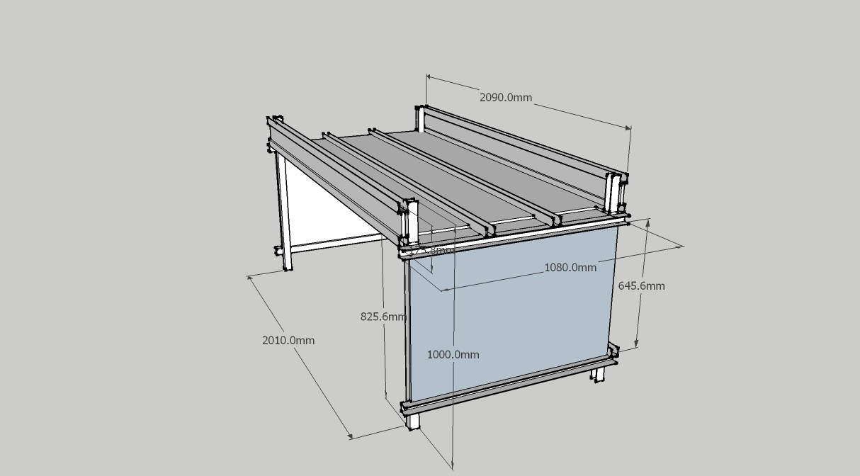

7 Attachment(s)
Re: Reducing the space in my garage.

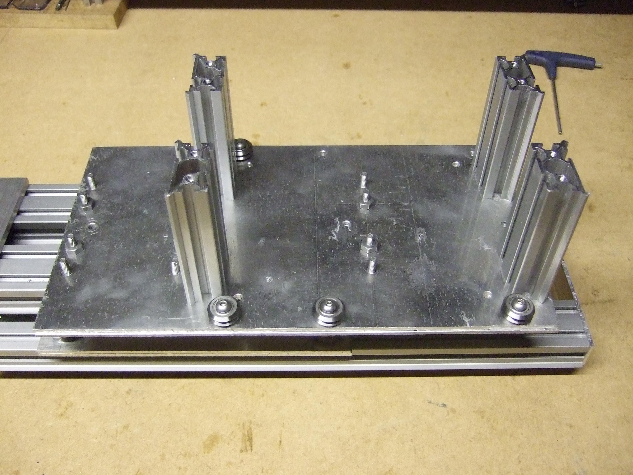

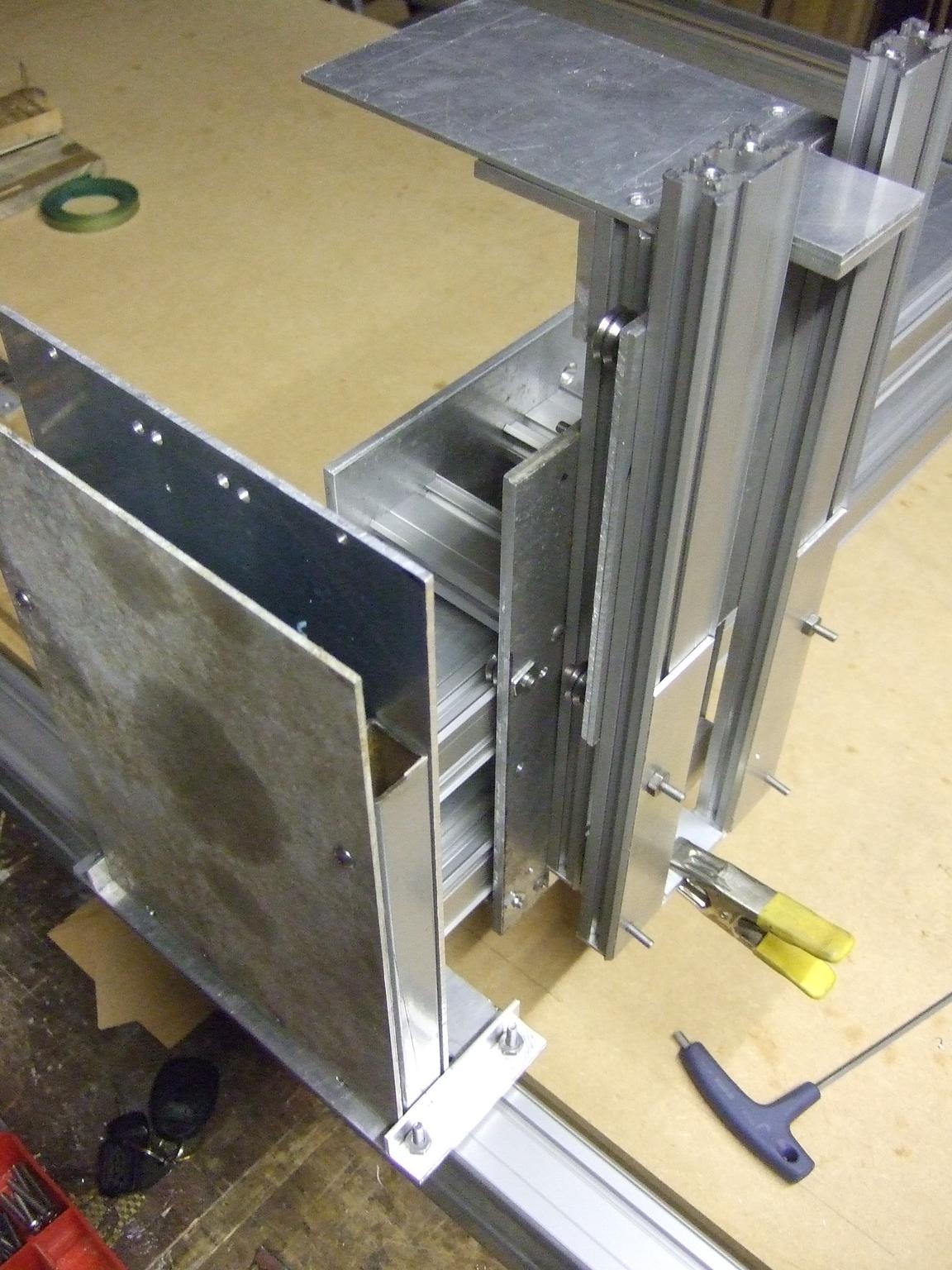

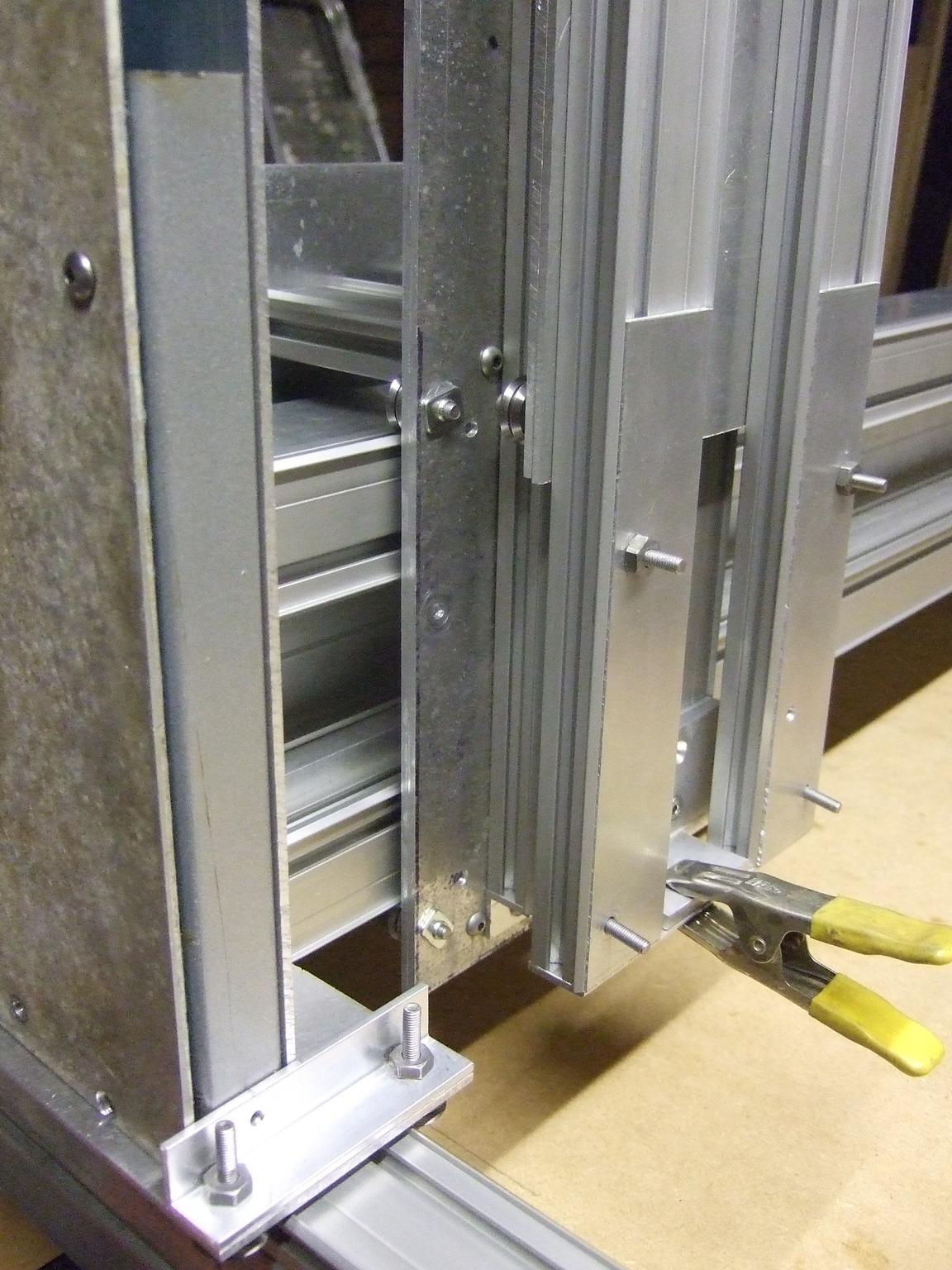

Table design using dexion and images of the build so far.
The front plate of the z-axis is currently made from 2 x 3mm aluminium plate. The final build will separate these two plates, increasing stiffness and absorbing vibration., I will use sheet ply and a vibration dampening material.

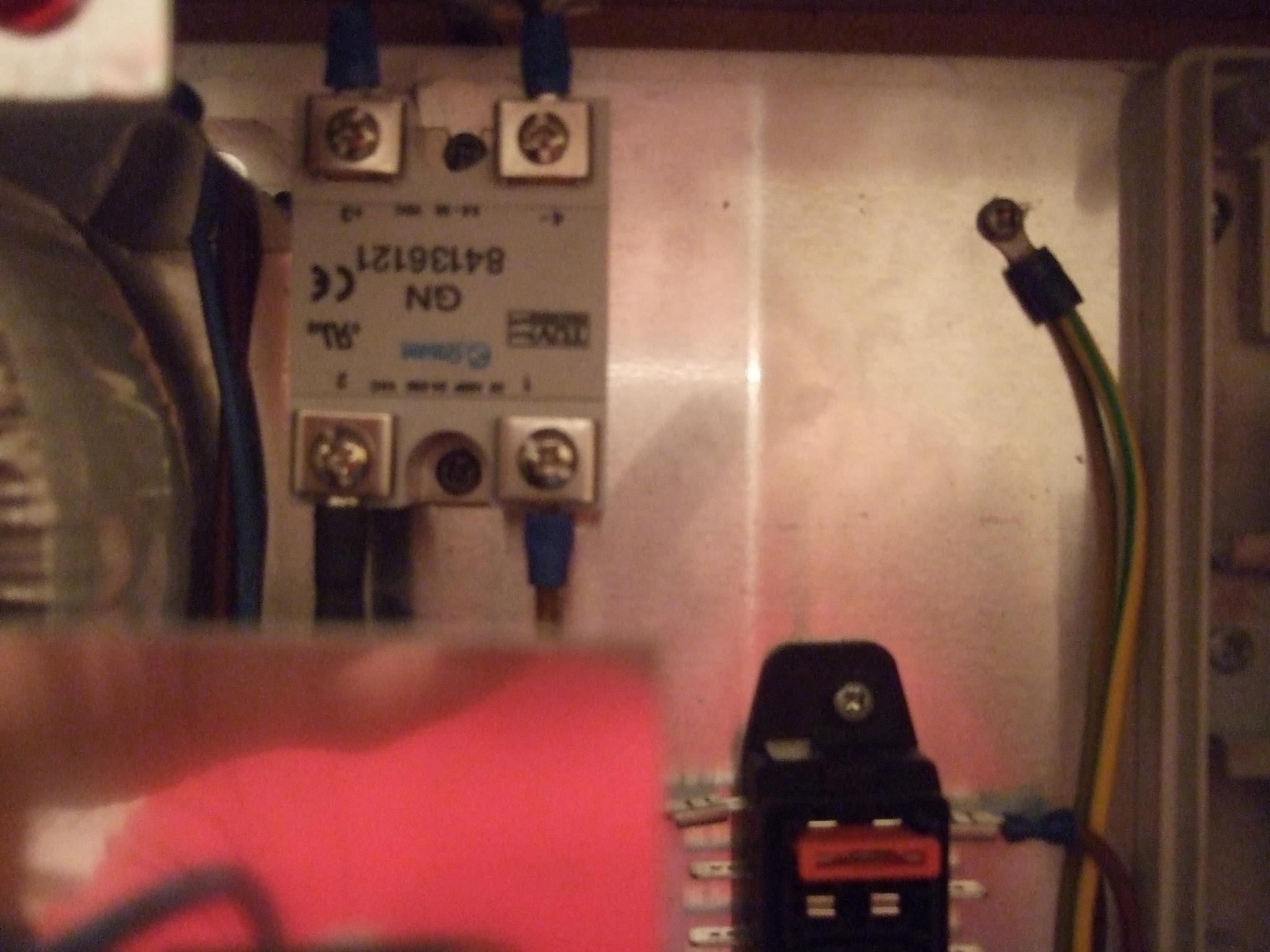

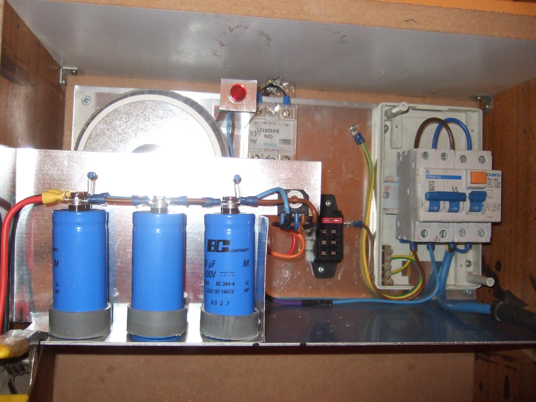

Per an earlier post, I’d run through ‘Gecko: Step Motor Basics’ and put the details into a spreadsheet, the results reflect the numbers quoted by Jazz. As the basics of building a dedicated PSU have been clearly stated, I will give it a go.
I will follow the PSU circuit provided by Irving, except for the safety circuit, which will be adjusted to include things I already have hanging around:
- NVR Switch, removed from a 240v hobby router table
- Zig CF-8 charging and distribution unit 12v http://www.zig-electronics.co.uk/products.htm#
- 240vac, 25 amp Consumer Unit
- STAC, AC voltage regulator, ST500W (Type D) http://stac-japan.jp/portable/

Can someone let me know if it is normal to blow a fuse in the circumstances?
I am in the middle of the PSU build, per the above thread, page 5. The basic circuit is complete, as shown in the following photographs. The initial test suggested the PSU was working - output 70vdc, so I start to solder a few of the parts together.
Once the basic circuit was complete I tested how the circuit performed with the 24dvc regulated power supply - just arrived, running across the SSR. The test was simply switching it on and then off. At which point, I blew the primary fuse, tripped the primary switch and blew the 13amp fuse in the socket. The primary fuse was a 5 amp spade fuse - as no motors are connected
I've not wired in the Relay 2 NC and I the eagle eyed will notice I've forgotten to wire in a secondary fuse.
Is there an obvious reason for this? Or do I need to provide more detail.
http://www.mycncuk.com/attachment.ph...id=15107&stc=1
http://www.mycncuk.com/attachment.ph...id=15108&stc=1
I think it would be good if you put a schematic up exactly how you have wired it. Is that a RCD on the main fuse? If you have blown the 13A fuse you may have an earth fault. Is there a reason you are using an SCR in the circuit? What type of MCB have you used ie B type etc? ..Clive
As Clive said, a diagram would be best. However I'll risk guessing - if you're connecting the transformer to the mains without a soft start socket, then the inrush current from charging the capacitors may be too high. Also, are those automotive type blade fuses and are they used on the mains or 70V circuit? If so you shouldn't use that type there as they're only rated for 12-24V. To be fair the fuse still seems to have worked... but that's maybe not the point!
I'm not an expert on electrics but I wouldn't use the automotive fuse on mains AC. Either MCB or DIN mounted glass fuse holder designed for AC would be my choice.
I did a lot of looking into fuses for the DC side and concluded that it was ok to use a 5A 12V automotive blade fuse at 5A 70V because the fuse would blow at a certain power which is the current squared times the fuse resistance. The voltage didn't come into it until the fuse blew and the gap created needed to be big enough to prevent an arc ( therefore still allowing current through).
That was where I got to it anyway. I also saw Irving use one ( with a disclaimer)!
Clive - you wrote SCR did you mean SSR as in solid state relay?
Thank you all, I can see I've made a mistake by using a spade as a primary fuse. The intention was to use a slow blow fuse, per the thread. I have one ... but because it wasn't on the purchase list, it dropped off the build list.
I will draw a schematic and add a parts list, that will help clarify my issue and hopefully put me back on track.
