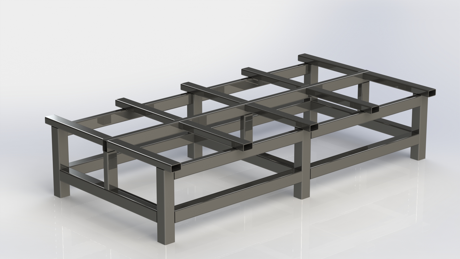

OK so... We start off with a nice and heavy base.
Base is constructed of 100 x 100 Cold rolled box section for the main legs and 100 x 60 on the base table.
80 x 80 Extrusion will run alone each side of the table with smll slots in the box section to allow for slight adjustment. then locked off with angle brackets
http://www.mycncuk.com/attachment.ph...id=13897&stc=1
Im still not sure if i should lose the leg in the centre to allow me to run a brace under the table to help a little more to aid the crabbing of the gantry. this will also open up the possibility of using rotating ball nuts in the future.

Over complicated derek with not enough support for the bed. The spacing of the cross beams is too far apart and I would make them full width and support from under side.
Less is more.? Go bigger on the steel structure but have less of it. Check this out to get an idea what I mean.

Now. you have really threw a spanner in the works! after seeing that i just want to buy one outright! haha
In terms of not enough support, shall i just run the crossmembers striaght through as you say? i had planned on putting an Ali extrusion bed over the top of this also...

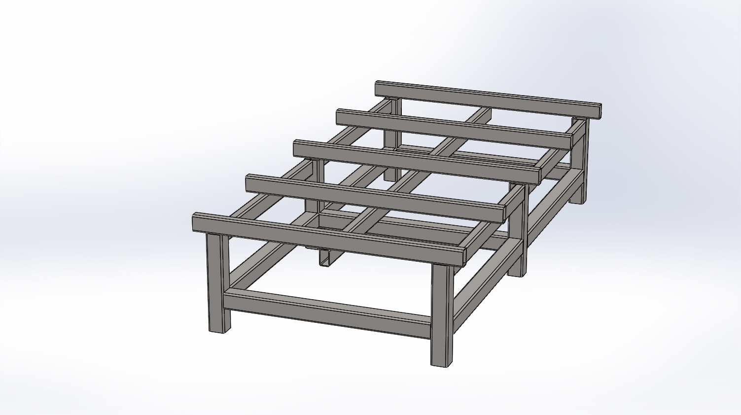

Is this what you had in mind?
Ive turned the bed supports vertically to give a little more support and transfered the long one to the bottom to support
http://www.mycncuk.com/attachment.ph...id=13898&stc=1
Yes and No. Yes to one piece supports but the spinal beam needs supporting from below not just fastening under the bed supports as that's doing nothing really.!
Yeah pal there is 3 pieces under the spine as per drawing 1. I ain't so quick with solidworks just yet so thought I would see if that's what you meant first.

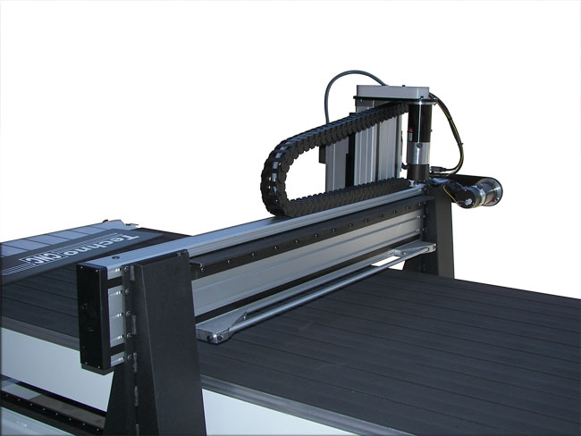

I dont suppose anyone knows what this bar is for on the bottom of the gantry of the Techno machines do they? Im guessing that when its tightened it pulls it square of some sort?

Nevermind ive found ou what it is
"a special steel backing beam and torsion bar are integrated into the axis for added stability. The torsion bar acts like a sway bar on a vehicle, which in turn keeps everything straight and taut when cutting loads change. The steel backing beam provides extra support to the linear rails, greatly improving the router's rigidity."

One more thing with frame I swap the sections around and make couple of length changes. I'd use single piece top rails from square section and rectangle section for lower pieces see pic to see what i mean.

No I wouldn't have it like you have at really because any bending or warping of the cross beams will directly affect the profile and rails and take away accurecy. I drew it without the cross beams more to show the single piece top rather than 2 pieces but other than that it's meant to be just same as you drew it.
I wouldn't do it your way at all because it will make getting rails on same plane harder and any movement of cross beams will directly affect profile. The surface bed sits on isn't so critical as you will surface the bed parallel to the spindle but the surface the profile/rails sits on must be flat and on same plane each side or allow for the profile to be adjusted onto same plane.

I'm not sure I follow what your saying pal... I understand removing the vertical from the centre and putting a cross base in as the sides. Are you saying not to use the 9 cross members on the top now? If so what would be the best way to mount the extrusion

Ok so all the parts for the table had been ordered and i was too late to cancel it, so i will have to work with what i have an modify the best i can.

Ditch those vertical supports along the centre that just drop to the middle of a beam below. Instead triangulate them back to the feet.
Or have crossbeams that are stiff enough by themselves.
In other words, proper support or no support.
