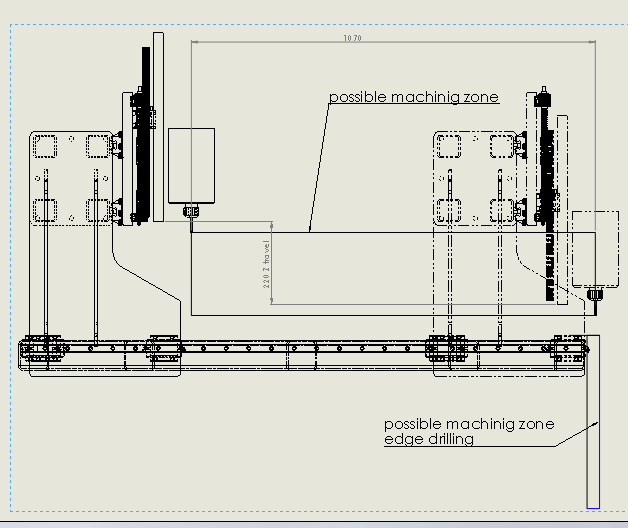

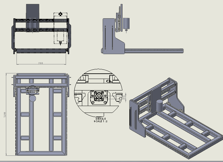

Hello Everybody,
My target is to built a gantry for home use since I do office job and miss the miller work. (I have three sons so hope they follow the way)
The travel is 1000 x 700 x 250 mm with 1000 N cutting force in Plastic, AL, with 0,05 mm total accuracy.
After studying the relevant threads some contradiction still need to be solved.
I.e. my friend who build some CNC machines(not like this) says you only need one ball screw in the middle.
There are many ways but the proved, reported solution is my solution.
I hope with your help and skill I can reach my goal so please correct me where I am wrong.
Base is not finished in the attached figures.

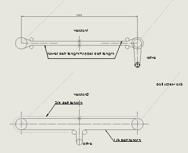

- 1500 mm long rail position-side or top ?
- Is there any good carrige pattern to eliminate the double ball screw?
- At belt synchronizing version1 or version2 is the better? -my logic says the equal belt length in any drive direction give more accuracy . http://www.mycncuk.com/attachment.ph...id=13921&stc=1http://www.mycncuk.com/attachment.ph...id=13922&stc=1http://www.mycncuk.com/attachment.ph...id=13923&stc=1

1. 1500 mm long rail position-side or top ?
2. Is there any good carrige pattern to eliminate the double ball screw?
3. At belt synchronizing version1 or version2 is the better? -my logic says the equal belt length in any drive direction give more accuracy .
1. As far as I'm aware the bearings and rail do not care which way you have them but you need to think about how you will mount them so that they are level with each other across the frame, and that they are the same distance apart along the frame.
2. On a 700 wide machine I think you will need 2 ball screws.
3. As you say, the equal belt length method looks best.

3. As you say, the equal belt length method looks best.[/QUOTE]
When I am saying equal length I am thinking of the extra synchronizing belt that has the same upper and lower length .
In the lower figure the drive is symmetrical so I am confused which of you mean the best

vargai
Thanks form the prompt answer,
Version 2 where the motor is central.
Re: Accurate Strong Gantry
The price of the belt and pulleys will be same as the price for one driver more. So if you invest in one more motor you would have it properly made. Not that it would not work like that with one motor.

PS. It would be better if the spindle center is inside the bearings that move the gantry looked from side. Means you should offset a bit more the gantry to the back. You have to imagine that when all is mounted and weights what it weights the center of the weight must be in the center between the 2 bearing that move the gantry.
understood what you mean, just wanted to reach the perimeter of the machine table with the tool to have access for edge drilling that is advantage at high work piece -but this is not main issue.
When I think of a standard VMC the real heavy consoled spindle house running up and down on a vertical rails with about 400 mm or more offset and the bearings stands it- it is their job.
I am using 25 mm bearings that is IMO strong enough for normal operation, however I will consider your suggestion-every detail can be important.
Perhaps it will help to support the rail side form above against the constant torque and lowering the console lever according to your suggestion

I have a similar set up just 90 mm wider. I would not do it again, setting it up without backlash is a pain.
Next one wil have a dual stepper, a leadshine easy servo, which is a stepper with encoder.
In this design I would box up the 4 beams so they become one, that is much stiffer.

Hi Sven,
Yes , the four box should be redesigned somehow, originally I wanted to tie the boxes with 3, 4 plates to work together after placing the
ball screw
What does the similar exactly-how did you make the synchronising?
Nothing is written in stone-just thought to skip the step with stepper and make higher grade machine but do not know too much about stepper.

I have the second setup in your diagram, with the motor in the middle. It is impossible to get enough tension in the belt without putting big loads in the spindle bearings.
I added a guide to push the middle section of the belt above the motor to reduce floppiness. still not good.

I would like to know where is limit in weight with the moving gantry that can be drive on reasonable way.
My redesigned one is still 100 kg made of steel with a 18 kg motor just for cheking.
I don't think I can go below 80-90 kg.
I don't care if it requires 20-50 W more just pls advice if this is over sized for a general strong gantry
The general opinion is that if >70kg you can not move it adequately with 2x3nm motors so you need bigger motors, which now puts you into position to find bigger but at the same time fast enough or go with servo, which to me seemed the better option.
Now i am looking back at your gantry design. What size are the profiles, why 4, why are not connected each other? Whats your idea there? At that size machine
2x 100x100x3 or 100x100x4 welded together with separation for ball screw or not /if back/ will be ideal. 100x100x3 weights ~9kg/m and the 4mm weights 12kg/m, So you co8uld still move that gantry by 2x3Nm nema 23
silyavski
Now I am looking back at your gantry design. What size are the profiles, why 4, why are not connected each other? Whats your idea there? At that size machine
The modification is being processed hopefully more optimal now but from steel I have no to big margin with Z+Y plate gantry legs and all stuff (some item was hided on my dwg ) so it will be 100 kg anyway
When I saw my friend machine with the moving bed I said I would not want to move to and fro 120-150kg mass with material so it would be moving gantry.
Entering to this 700x1000 mm machining zone with rigid steel design I have to revise myself.
I am seriously thinking of the moving bed option now it is just 5-700 mm longer space and can forget many trouble i.e the dual motor, heavier spindle
My goal is a bit better an more accurate machine than a router so called semi industrial so within a 4000 -4500 GBP budget I would like to reach the best performance.
