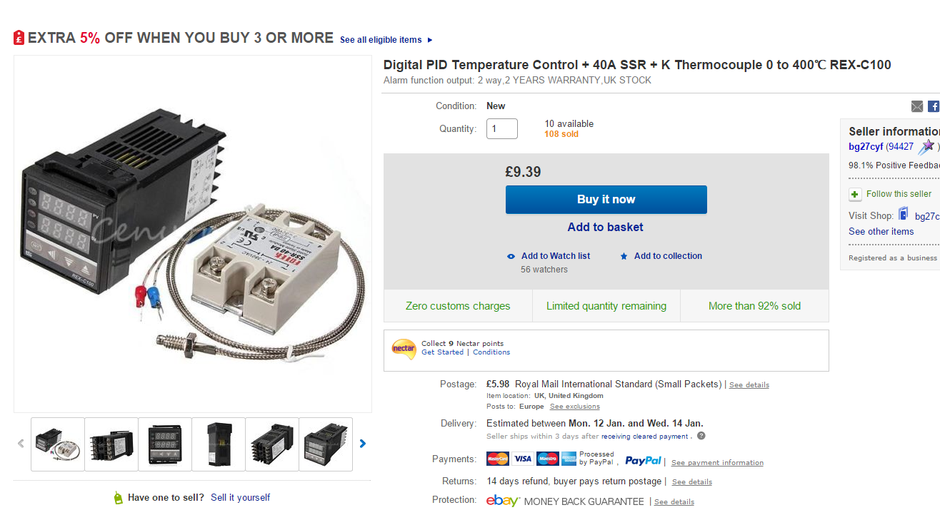

From the boards you suggest i will no doubt buy the thermocouple one cause i like to see exact temperatures on a display. Another thing is to search for PID temperature controller on ebay + thermocouple, you will need also cartridge heater. All here depends what voltage you want to drive all, what hot end and what fits there. The heater and the motor should not be driven from same supply.
So to resume: you need PID temp controller, thermocouple, heating element ~40-50w, PSU for the heating element, PSU for the stepper driver, stepper driver, geared stepper motor , Hot end, Extruder
Hope that will save you some time investigating. yes, there are cheaper around, but it needs to be reliable, or so the guys say. I dont want to spend my time cleaning nozzles

Based on your info. I would probably go for the Thermocouple PID. The the prometheus hot end. The better of the extruders (whichever that one is ?)
I guess I can use another M542 Motor Driver for the 3D printing ? and use my PSU that is powering the other 3x M542's.

It doesn't matter. If you buy the thermocouple controller it has input for 2 thermocouples , so just add /screw, stick or whatever/ the second thermocouple to the bed

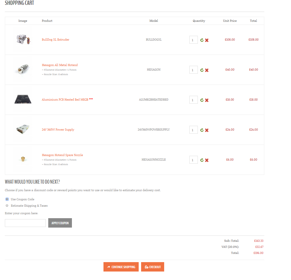

Ok, Im in the oozest shopping cart. What filament size should I be starting with do you think ?
If I am using the bulldog extruder, I think it is 12V, so 12V PSU.

Ok, I have bit the bullet ! Made an order with ooznest.
Just got to buy a good heat bed (470mm X 300mm) and Heat controller.
