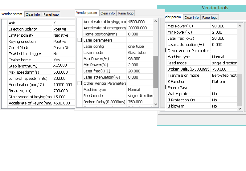

Hi Thanks for your replies. I've been playing around with it and discovered the x axis is off by 50% so if I double the x axis value I get perfect circles and squares. No explanation anywhere to why this is happening, I've noticed also that the laser head only goes to the middle of the x axis arm, so again 50% even if I use the control panel on the laser to move it. Mt machine is 500x 700 and the x axis will only go to 350. All my parameters seem correct. Any one know what could be causing this. Fed up with this machine, would not advise anyone to buy one :-(http://www.mycncuk.com/attachment.ph...id=14865&stc=1

Hi
I don't have a CNC machine of any description so can't help with the software side of things but from what you are describing it would appear that the stepper ratio setting is @ fault, ie you need double the amount of steps to get the correct movement of you axis, should be any easy enough fix for someone that is familiar with the software you are running, hopefully someone with more knowledge can help.

We used to sell the Redsail machines many years ago. From memory, the M700 and M500 lasers from Redsail are driven directly in the X and Y axis without reduction belts. This means the X and Y stepper drives should have the same dip switch settings (the micro toggle switches on the motor drives, between the two connectors).
If these are identical, check the Vendor param/ step length(um) values. Again, the X and Y axis values should be the same (or almost, as belt tension stretch may mean that the values need tweaking a little to get accurate results).

Hi thanks very much for the reply. I managed to sort out the x axis problem by halving the values etc. Now though, I have it perfectly aligned and It won't cut. Even when I check each mirror to make sure its central, then keep the laser head still and pulse at full power it doesn't go through the wood. I seem to get about 1mm engraved if that. Alignment is perfect it just seems there is not enough power even if I have it at 90%
