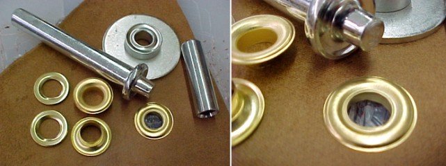

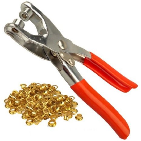

Any leather eyelet pliers will do the job and if they don't reach, then refabricate something similar with longer reach from them . If it was me i would simply instant glue each side a washer. If the glue is good it would stick forever.
Plus, nobody could convince me that the PCB eyelet which they sell for 10cents is not in fact leather eyelet.
http://www.mycncuk.com/attachment.ph...id=15153&stc=1
http://www.mycncuk.com/attachment.ph...id=15154&stc=1
