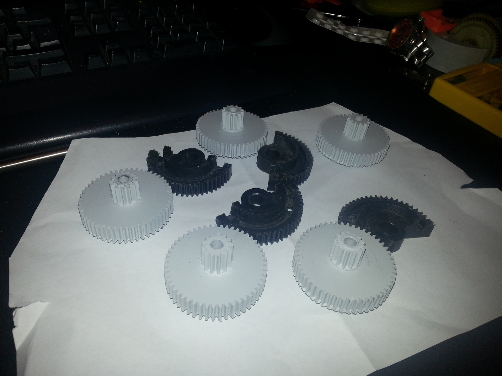

What 'decent' Milling machine?
Having previously designed and built a CNC machine, I learnt a lot about what works and what doesn't. I dont want to waste time trying to get a machine to work as needed, I managed to get semi decent results, the kit was decent, but not sure my design did it justice.
So looking at this again however keen to buy something that is ready built and works.
I have 2 main requirements, a bit different, hoping that there is a machine that can do both.
The first is cutting of 2 gears, in brass or plastic. I have previously milled these from the 'top down' but had issues getting 100% centre when the one gear was flipped over. I believe now the better way to do that is to make 2 parts and join them together. A lathe is probably better to make the 'blank' and then use something to cut the gear slot. I dont know if these gears are custom or not. I have measured them and cannot find a module number they comply too. Some pics should be attached.
The second need is bike parts using Aluminium. I need something that can automate the production of a number of pieces as far as possible. Parts will be things like rear sets, levers etc.
Ideally it should have a auto tool changer or one where I can simply remove the tool and apply the new tool without having to reset the Z all the time.
Ive looked at a number of machines from companies like Axminster, Amadeal etc.
No fixed budget, cheaper is better but willing to look at machines that are anything up to £10K. Doesnt need to be new, 2nd hand also welcome. My preference is something that connects via USB like the PlanetCNC card or similar.
Size wise, not massive, but I dont want to buy too small and be stuck. A milling area of 300mm x 300mm sounds reasonable.
Any suggestions?

All the hobby CNC's you mention above are similar in quality and finish. It is the aftercare that you should learn about.
You are doing the right thing in budgeting for a turnkey machine if you are interested in producing bits professionally.
Get something with either an ISO 30 or R8 spindle. Some of the Syil machines come with pneumatic drawbars that save time and really make life that much better. Worth finding out which ones.
ATC's are useful but you can live without them.
Enclosures are VERY GOOD! I wish I could enclose my mill.

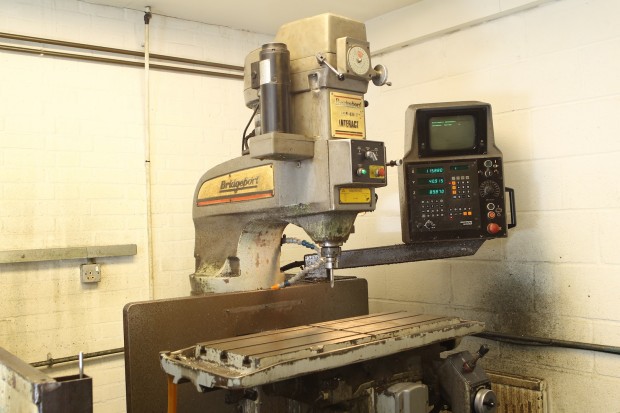

Thanks. I did see a few bridgeports. What do you think of the 2 Denfords I linked?

Depends. Small machines are way overpriced compared to used "real" machine. Cause people are lazy to organize moving or installing 3 phase at home, or fiddli8ng with VFD or just make small parts and don't have space.
I still don't have a mill but from looking of what motorcycle parts people order to my friend Jeff, i dont see that machine capable of doing them. Fork yokes for example. As i said stay away from small machines.
Man, my mill vice is as big as this machine if you know what i mean. You can not fit a good vice, the part and the bit on something so small. Not to speak of tilting vice.
You need a good used machine that comes with some stuff like holders, vice/es/ and if you are listening to me- that comes with servos. Yes its a good thing to retrofit steppers, no problems, but machine that comes with steppers is an amateur machine.
Cause you will hit the floor when you hear the prices of a good vice, good 4rth axis and so on if you want to buy them separately. And if you manage to find a good machine and retrofit only the electronics / something like CSMIO/ IP A / you could have a look at https://www.youtube.com/watch?v=TlQgMk6te_Y so you spend wisely you 10k

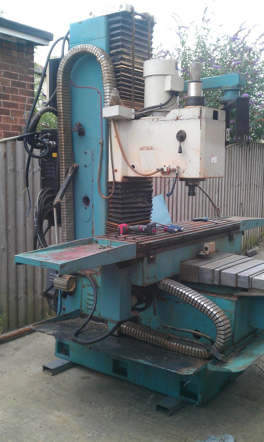

Here's a prime Example of what £600 buys you in Old money.!! . . . . Purpose built CNC not converted Mill with 1000x500x450 travel. DC Servos, 7.5HP 40 taper spindle with power drawbar, Ground ballscrews and linear ways.
All this machine needed to get working was the controller replacing and 3 phase power. It uses Brushed DC servos which I will be replacing with modern Servos and the Spindle will be run from a Converter.
But the point is that if you had 3 phase power another £600 would have had this machine fully working and running like it never did before on it's old controller.
There are old machines like this coming up all the time at very low money and if you throw 2-3K at them you will have a very very good strong accurate machine will all modern components.

The difference between th 2 bridgeports is the series. MK1 & Mk2 They look like this.
Attachment 15349Attachment 15350
