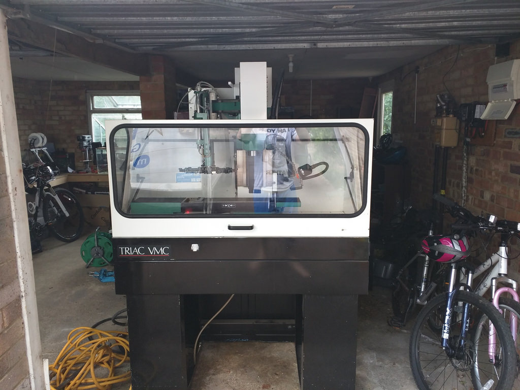

So very pleased to start this thread. After my previous thread of 'what decent milling' machine, I found a school owned Triac VMC for sale. After a massive struggle to transport the unit and buying it unseen, it was delivered this morning. The mill was sold with a few extra tools but with a fault that the OS does not boot up. On the basis that I will likely retrofit some / all of the electronics, I considered this in the purchase decision and costing.
Initial thoughts are wow, its massive. Its also fairly heavy, as we had discovered when manually unloading it. The lads had loaded it up the previous day and clearly hadnt learnt about getting an engine hoist or similar to help.
I will upload pics in a bit, but the mill looks fairly clean, little use. I could not lift the front door to see much more as its interlocked and needs power to unlock.
Not a lot of unhappyness, apart from when they left, I tried to close the garage door and could not. Fortunately a bit of an effort and the garage door was closed. There is a bit of damage on the bottom as the machine has been man handled to move it but nothing serious.

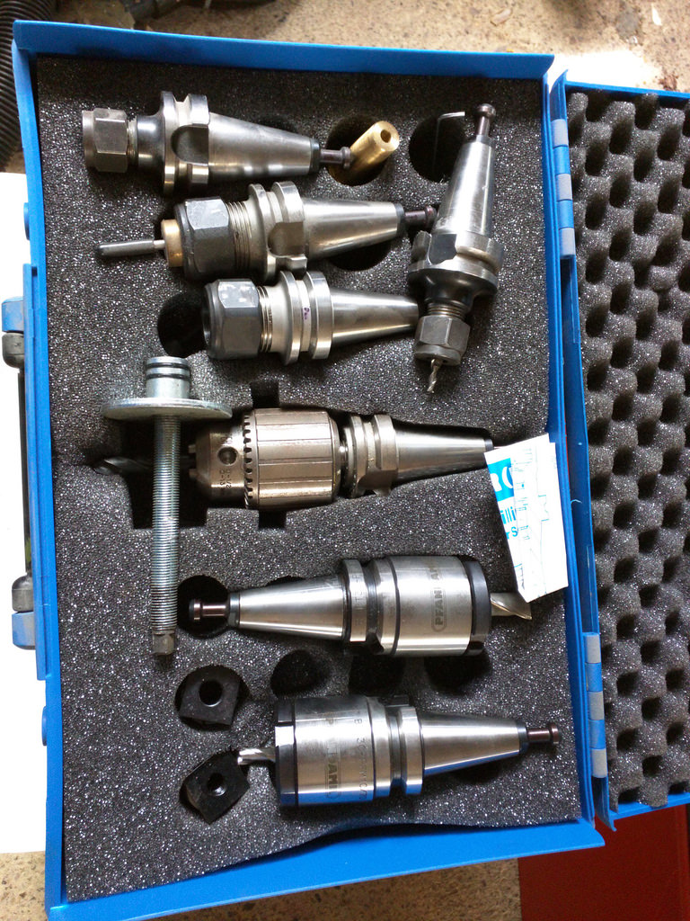

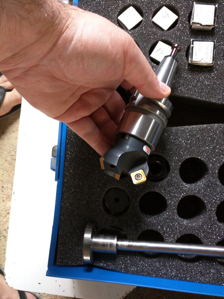

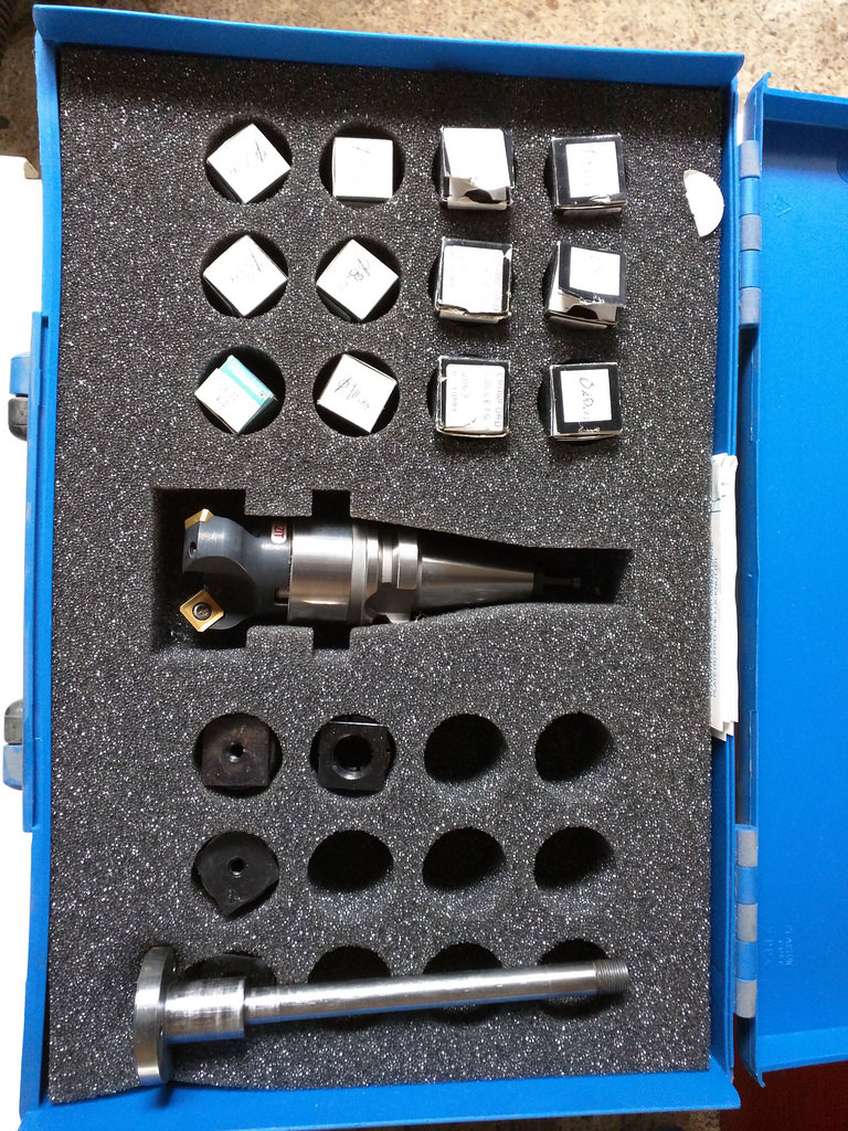

The machine has come with more tools than expected and also a semi decent looking vice. I suspect if I add up the tools and few extras, some value already.

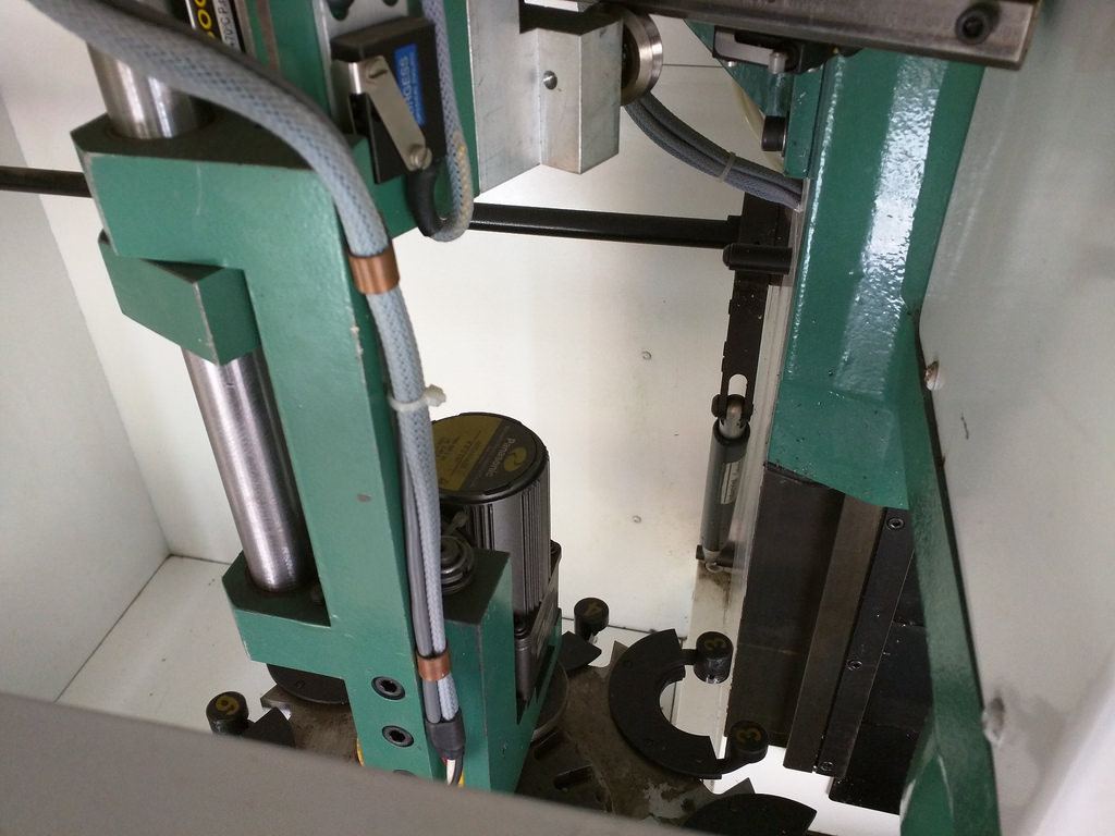

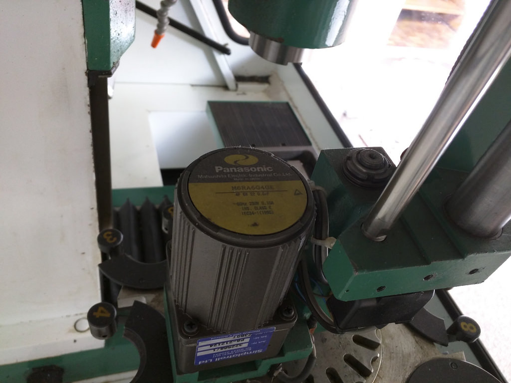

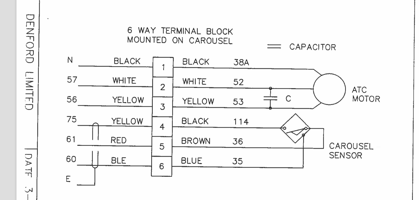

OK, this is the ATC wiring diagram. I am assuming that its a servo on the basis that there is some encoder wiring. Would this be correct? The panasonic unit seems to be some form of geared motor.
http://www.mycncuk.com/attachment.ph...id=15571&stc=1
For the missing bits, the cover of the ATC is off but I dont think anything goes into the cover, not sure, will check when I get home.

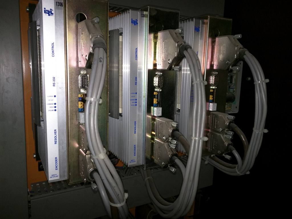

Re: Denford Triac VMC with ATC Conversion / Fix
These look to be the XYZ drivers. Assuming that they are in working order, are they usable / decent?
http://www.irtsa.com/IMG/pdf/me1300re.pdf

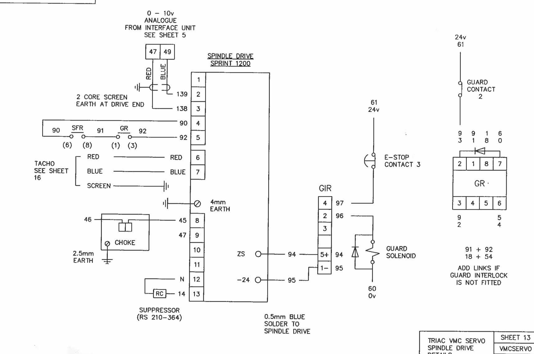

Spindle Controller is http://www.sprint-electric.com/techn...0Man-iss-h.pdf
Sprint 1200.
Any thoughts on the quality of this? Unless its faulty, will aim to reuse this.

You could probably replace the transformer with a single phase one provided the overall rating is sensible. Or replace the whole PSU.
If it is a DC motor with the usual thyristor controller then that will probably run happily from single phase with some careful re-wiring. Actually checking the manual you referenced above it has a single phase mains connection anyway!

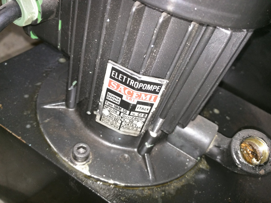

This is the coolant pump. Id like to have this option if I can. Small power, so must be an option to sort this. Id like to upload the schematic (in pdf somewhere) and then link it for reference to anyone interested.

NO you need the IP-A because the servos are Analog servos and won't accept Step & Dir signals.
You will be able to re-use motors and drives. The motor manual should tell you type of encoders.! But Single ended will have 5 wires. Differential will have 8 or more wires.

I think that the pump can be wired for 2 phase 230V, as you could see on the plate

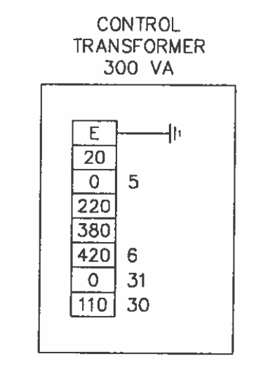

OK, up early, cant sleep. Some of many questions:-
Current plan is to use the CS Labs IP-A controller. Gary from Zapp (and JazzCNC) seem happy that this should work based on the info shared. Let's assume it does but I may have a drive or motor faulty (I cant test them at present), what do I do then? These motors / controllers look to be too pricy to replace like for like. If I get something that uses Step / Direction, I need a different controller? Also, if I am looking at 4th axis for later, how do I plan to take that into account? I dont want to buy and IP-A and S model, the costs are too high and I dont know if you can use both together.
In terms of other considerations:-
Convert to single phase. The coolant motor can be wired for this, problem solved. It looks like someone has fit a newer 24V PSU as per the pic below. Will use this for 24V logic.
http://www.mycncuk.com/attachment.ph...id=15586&stc=1
I need 110V, not for a lot though, if needed, can fit a transformer for that. There is also a 15Volt feed that comes from the 110V line to supply power for the Axis Drive Logic, I assume I need this for the retrofit?

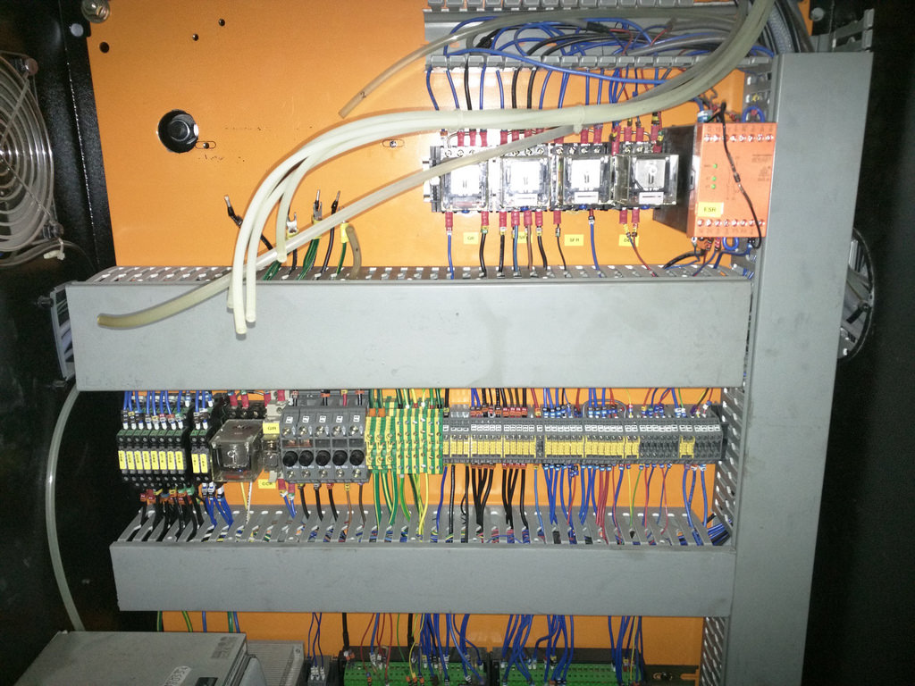

The remaining 110V items are a mix of relays and solenoids, mainly for the pneumatics for the ATC. I am missing all the solenoids and the pneumatic ram for the left/right of the ATC. i2i (thanks very much for your time yesterday), may be able to provide the details / measurements for a replacement.

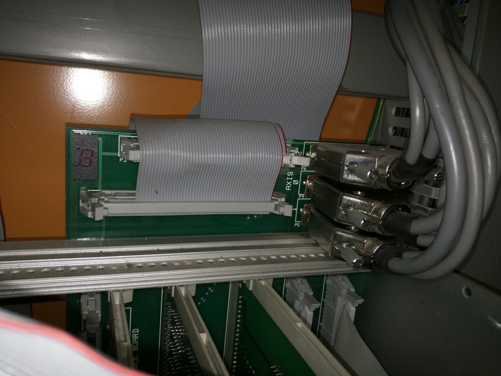

There is a board where the X Y and X axis connect, do these breakout anywhere that allows for wiring to the new controller?
http://www.mycncuk.com/attachment.ph...id=15587&stc=1

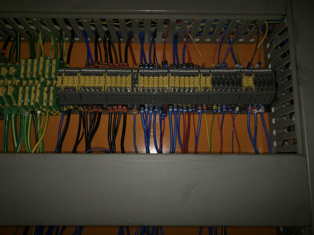

There is then the terminal strip however this doesnt seem to cover all connections, mainly power (wire 31 / 32 etc)?
http://www.mycncuk.com/attachment.ph...id=15588&stc=1
In terms of connections needed to make this work, missing anything below?

Does this look like I can feed with 220V instead of 3 Phase to get 110V?
http://www.mycncuk.com/attachment.ph...id=15589&stc=1
I suspect so but ideal to get some confirmation - saves me needing to get a 220 / 110V transformer.

At present, Im 99% sure the IP-A will work. Im checking wiring and it seems to match. 6 wires for the resolver, 1 ground, 3 for the motor.
Page 36 of the IP-A manual shows what's needed and seems to match page 32 of http://www.irtsa.com/IMG/pdf/me1300re.pdf
Yes it will work. Resolver comes from Motor to Drive and as nothing to do with IP-A. Encoder output on Drive goes to Encoder Inputs on IP-A to close the loop between controller and Drive. At the moment you'll find it goes to the Controller that's fitted.

OK, so some progress.
Completed:-
Converted most of the power system to single phase. Need to still sort out the coolant pump however.
Removed the old PC to make space for the CS Labs controller.
Looked at a lot of the wiring, for a long time.
Worked out that from the 3 Axis connectors that used to go to the old PC, I can basically input and output to that 15 Way D sub connector to get encoder signals out and speed reference in as well as satisfying some of the logic requirements.
Worked out where the Spindle Drive 0-10V can be connected to on the standard block. Some of the logic that enables the drive I am not sure about yet.
Fairly happy with the progress although so much to look at and find on other sheets / cross reference, takes ages.
All going to plan, I should be able to move all drives and start the spindle tomorrow unless there is a unit faulty or something goes wrong (hope not).
Will use a laptop at first to setup the CS Labs unit and get going until I can build a PC into the cabinet. Not sure about space as the CSLabs unit takes a fair whack of space, might make another plan.
