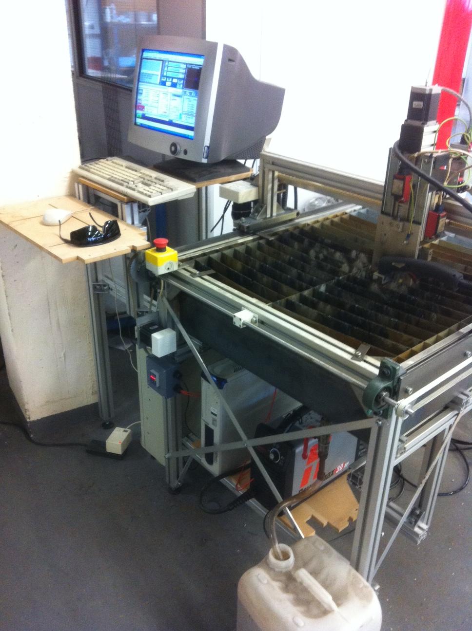

This is my first build - it was an educational exercise that got pressed into mini-production:redface: It worked really well on my Powermax 30XP but that was a hand system and difficult to use on CNC, I then upgraded to a PM45 and now the table cannot go fast enough !
I am now building a new, bigger table to match the PM45.
http://www.mycncuk.com/attachment.ph...id=15631&stc=1

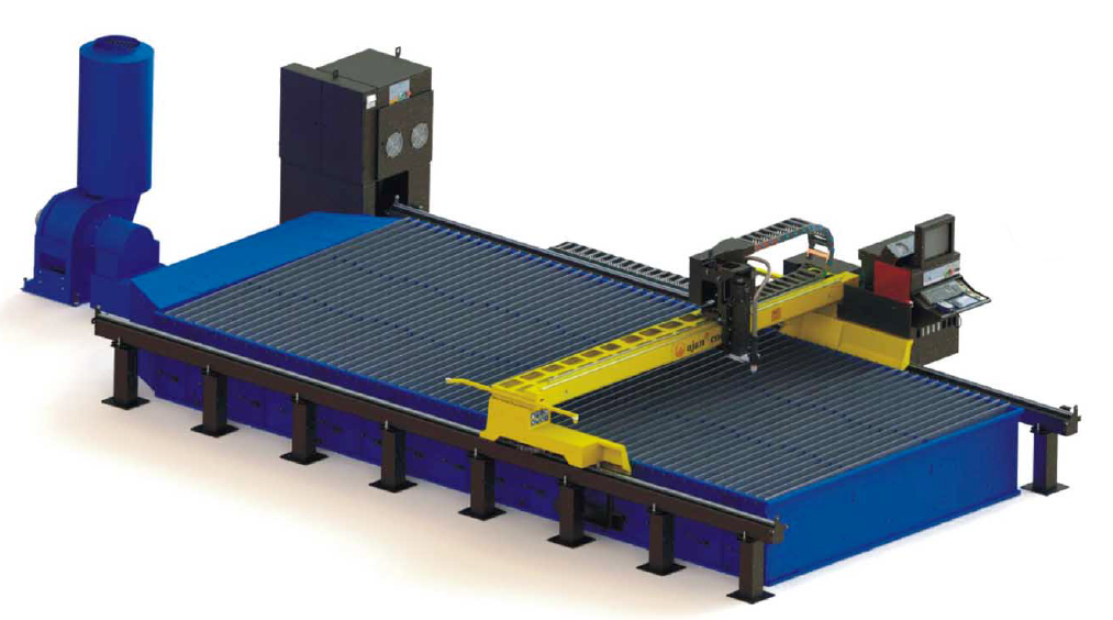

I am almost ready with my mixed universal machine which will do plasma also, usually at the back side of the table. That for the moment untill i have time to build me a dedicated plasma machine. So i investigated this and that.
here are my thoughts on building a dedicated plasma machine, especially one your intended size. I can further elaborate on the "why" if you have any questions
Preliminary:
- study commercial designs that size
- decide on a budget and don't cut any corners cause that machine size is not for hobby
Machine:
-make machine and table SEPARATE
-build left side and right side as beams only , supported by legs, leveled by screws that screw on integrated in floor plates
-for left right structures, use sth like 120x120x4mm at least, better would be sth like 140x140x4 at least, best would be beam like 200x200x4. The bigger the better, the longer could be the element, the simpler.
-RP obviously, use proven design with community support , don't go for belt to belt drives following a hype, unless you have made previous working machine, you want top make money, not test ideas . Avoid expensive RP, special shapes, special gear boxes, etc. In other words maybe go for the CNCrouterparts design and i would even buy from them the pieces for a piece of mind
-spend time on the design and make it truly modular, cause one day even this one could be short for you
-rails - on such a machine no doubt i would use at least Hiwin20 rail, but best would be the low wide rail / MGW15 size/ which is stainless by the way , so are the carriages and the balls. Other benefit of using the slightly more expensive MGW is that you could make the gantry rail only 1, same with the Z. One rail only.
-motors- no need to tell you to use servo motors, i hope you have that clear already. you will need the speed for cutting thin stuff without bending. If you have doubts forget them and use servo motors, at least for the closed loop, cause i dont want to think what would happen to a geared , even light, RP gantry flying at tremendous speed cutting thin stuff that suddenly racks due to lost steps. i will tell you- it will be bad.
- ATHC, one thing that is clear to me is it must be "real" , no semi THC with simple arc controls there. meaning it must control the motor on the Z somehow, a motion control. I bought the Neuron THC. Its a new one, more or less is same or even better compared to the CANDCNC , who by the way is not my favorite guy to deal with. If you dig deeper you will see some ridiculous statements made by him, here and there, even at his web, talking about chinese machines and warranty and so...
Now i still can not tell you how good the Neuron works, but i can tell you is made in EU, Andrei is very helpful and knowledgeable guy. I received mine without any hassle and Andrey said at the moment the machine is running we will make Skype contact and he will adjust whats necessary remotely for a first run. What more do you want as a support?
-Plasma is not 100% necessary to be Hyper therm . Now here many will cry, but they are the best. Yeah, but ...if i was buying from USA in $$, maybe. Not with that EU price. First of all consider Thermall Dynamics/Victor or re branded as ESAB and other, here in EU. The magic word is CUTMASTER/ . 20-30% cheaper and original consumables are much readily available everywhere and much cheaply.
Secondly consider German-Chinese machine from eBay with quality control better than pure Chinese and with 5 year warranty. I have such and confirm that the MIG, ARC and Plasma work like a charm. Now change the Chinese plasma crap torch with universal Thermal Dynamics torch like SL60 or SL100 and you have a winner.Still not tested though but soon will report. Now even cheaper if you find Radnor which is the sam
Andrey who makes the Neuron told me in some conversation that many people in Russia change the torches with Binzel torches and all works like a charm.
Hope that helps. I am talking a bout a superiour build, that does not necessary has to be very expensive.
http://img.directindustry.com/images...40-6010713.jpg

wow guys thanks for the replies there great so far.
silyavski I was thinking of something like the image at the end of your quote build my table first use it if I need to then progress to cnc it asap. I'm new to this whole scene but I willing to try anything as long as I'm learning from it and it has something to do with my industry.
I'm thinking of a bench approx 12'6 x 6'6 so I can sit a 12x6 sheet onto it with finger or hook room. Might even place it in a room 20x8 ish with a little overhead gantry to keep it all tidy away.
The table will probably be 75x75x5 square tube and 50x50x5 square tube with a water tray similar to this. http://www.mycncuk.com/attachment.ph...id=15633&stc=1
And the left/right sides will probably be the 140x140x6mm at least. What will I make the gantry out of?

Davek0974

Re: New Build-12x6ft Plasma Table
No, thats not my machine on youtube.
My one is belt drive not chain as well ;)

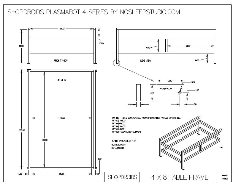

F1transportationserv
Hang on a mo', stop drawing and start thinking...
You have to support the slats that support the work piece and you have to support them through the water bed. I don't see slat support. A water table 5' x 8' is 40 square feet so every inch depth weighs slightly over 200 lbs. You have to support that to, add some triangles perhaps.
When you weld this thing up it is going to bend. Suggest you do not weld the gantry supports because you will only end up trying to correct the misalignment with a THC. Best if you correct misalignment with screw adjustment or, let the gantry assembly rest on the table so it conforms.
More if you want it... :very_drunk:

Yes I was thinking of an adjustable 'Z axis', the diagram of the table was only a rough idea.
I'm thinking a basic frame 75x75x5 with the braces out of 50x50x5. I'm looking to cut 6 and 10mm mostly maybe some 12mm sheets so I need to build a table braced to support a 12ftx6ft x15mm sheet if need be I will increase the sizes or just make it all outta 75x75x5???
The image of the table I attached had a .dxf file of the slat support designs I must redesign these to suit the size of table I go for and I will price them for cutting in a local engineering shop.

You can say 75x75x5 until the cows come home but it still won't mean anything. It isn't what you use it is how you use it. At the moment you are trying to build a bridge without appreciating how a bridge works. More James May, less Jeremy Clarkson please.
It might be worth mentioning that all your problems are down to the idea that it will look really neat if you lift it off the floor. If you sit it down on the floor all your problems evaporate, well, so long as the floor isn't flammable :encouragement:
What i said in the long post before is still valid, so maybe read it a couple of times more, cause you will get there if you think more and more deeply :hysterical:
for example:
-Hiwin 20 size rail/ or MGW15/
If it was ok Hiwin 15 size rail, i would have told you that. The savings from HGR15 to HGR20 are very small if none, but with the small blocks on the 15 size rail you will have much more problems designing the thing.
I was talking that if you design it properly you could even use 4 rails and only 4 blocks in the whole machine. Using the long HA blocks, where each block is 90mm long. And for sure 4 rails and 8 blocks if you dont feel like minimalist design is for you. After all if you buy from China 4 bearing blocks more, it will be only 120 euro more in the whole build.
As you were told, there is no problem connecting Hiwin Rails, especially in plasma build.
-While on a small table speed is no problem, on such a size you need things to be really fast. I would go as far as to say that you need 800ipm real life speeds with serious acceleration there . Cause bad things happen on plasma when deccelerates and you have crappy THC . You will need to cut thin stuff something like more than 10000mm/min
-Again - THC is a must
So , make the machine separate from table. Forget the stupid table for now. Invest money and effort in the actual machine. Later having THC you can support and cut the shit on a basic frame, which once you start earning money can upgrade as per your desires.
How hard could be to sit down and design a modular sides design from that 75x75x5 or whatever. Like at the photo bellow. As i said personally will use at least 100x100x3 . You are talking about 3.6meters long+ 4 legs 1m high each side. But size really it does not matter if you use THC and simply is strong enough not rack the gantry.
http://www.mycncuk.com/attachment.ph...id=15639&stc=1
-simple 1 beam gantry with one rail. Similar to the video before. Forget about the monstrous machines from pictures. they are made to route and drill also, driven by powerful servos, etc...
