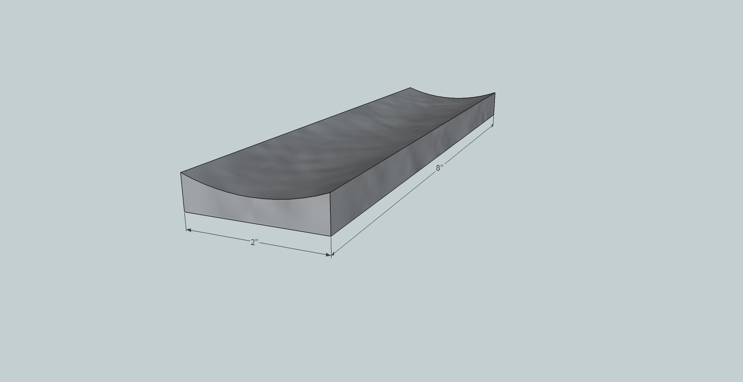

This is generally what we want to machine:
However, the part we are trying to machine is a block that is 4" x 4" x 1/2" thick with a cylindrical shape cut out of it so it appears similar to this:
http://www.practicalmachinist.com/vb...-fretblock.jpg
Again, it is not 8" x 2", it is 4" x 4". The radius required is 5 17/32".
So basically it's a block minus the cylindrical portion removed. I have tried several different CAD programs including FreeCAD, but could not getit to work. Call me a CAD dummy.

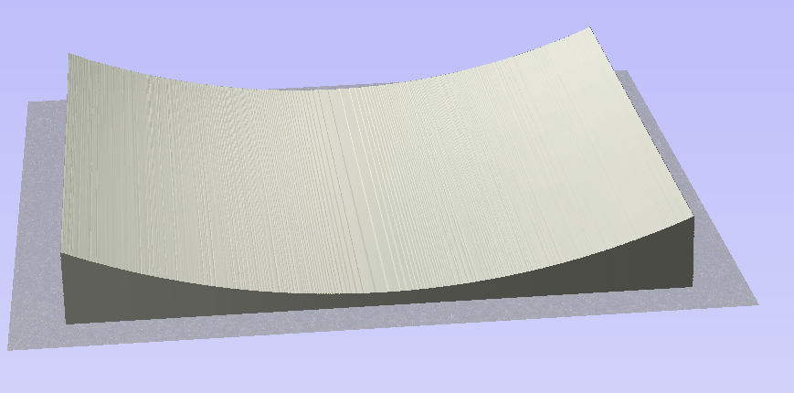

Re: Cutting a curved shape from a block of aluminum
Attachment 16573
There you go 4x4 saved as a STL let me know

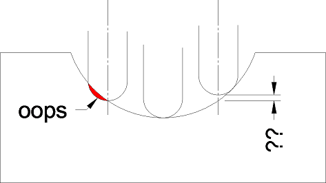

Also, by programming a ball-nose tool to trace an arc, it will not cut the same path, unless the tool radius is zero! This is due to the way the contact point on the tool moves - my quick diagram should make it obvious:
Attachment 16574

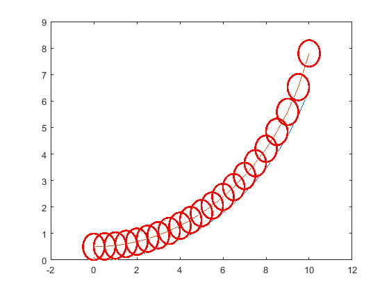

To cut the correct concave profile, you need to cut along a diameter which is the tool diameter subtracted from the diameter of the surface you wish to cut. Having looked more carefully, I can confirm that Terry has done this (the line #1000=[#1040-#1030]), so barring other errors, he is not a muppet, at least in this case.
I plotted a graph to demonstrate. The blue line represents the desired surface, red line is the toolpath (so an arc of radius [r_surface-r_tool]), and the red circles represent the tool. You can see it touches nicely at a tangent.
Attachment 16575
So, sorry Rufe0, but in Jazz's words, you apparently are a muppet!
