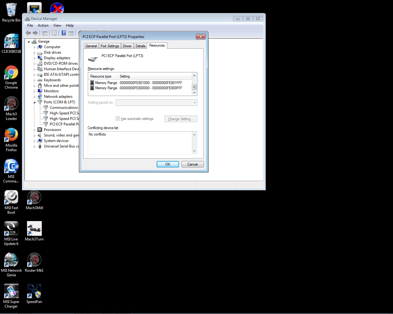

im new to this game and I'm converting a seig x2 plus. But having serious problems with a pci parallel port card as lpt 1 or 3 to run the machine, the trouble is it wont even do the most basic communication
actions
1) oem drivers set up and working
2) Device manager shows a new mulitfunction adapter - the same as the card make, using resources at EEOOO-EEOO7 (in the properties tab)
3) but the new pci parallel port in device manager oes not have the make perhaps just a generic?
in the resources tab it shows --- i/oEE00 - EE07 not available.
I dont seem to have any communication to the b o board in the machine. is there any way i can reallocate the resources?
iv tried all options in the device manager, none work all give the same " not availiable" error
I tried disabling the mulitfunctional adapter but as expected the parallel port dissapeared from device manager
The computer has been completely "bombed" and returned to factory settings. I could put xp on the machine, but don't realy want to because other ap problems
so is it the card or me? Do I get another which allows a resource allocation to be manually set rather than automatic as with this one, but then what do I set it to?
ps im running vista home, and will one day be able to use mach 3.......
Any suggestions?
thanks Graham

Just for a bit more background - what PCI adapter card are you using? I have one in my CNC PC that works fine and I'm happy to check settings if it's the same or very similar one.
Re: Parallel ports problems

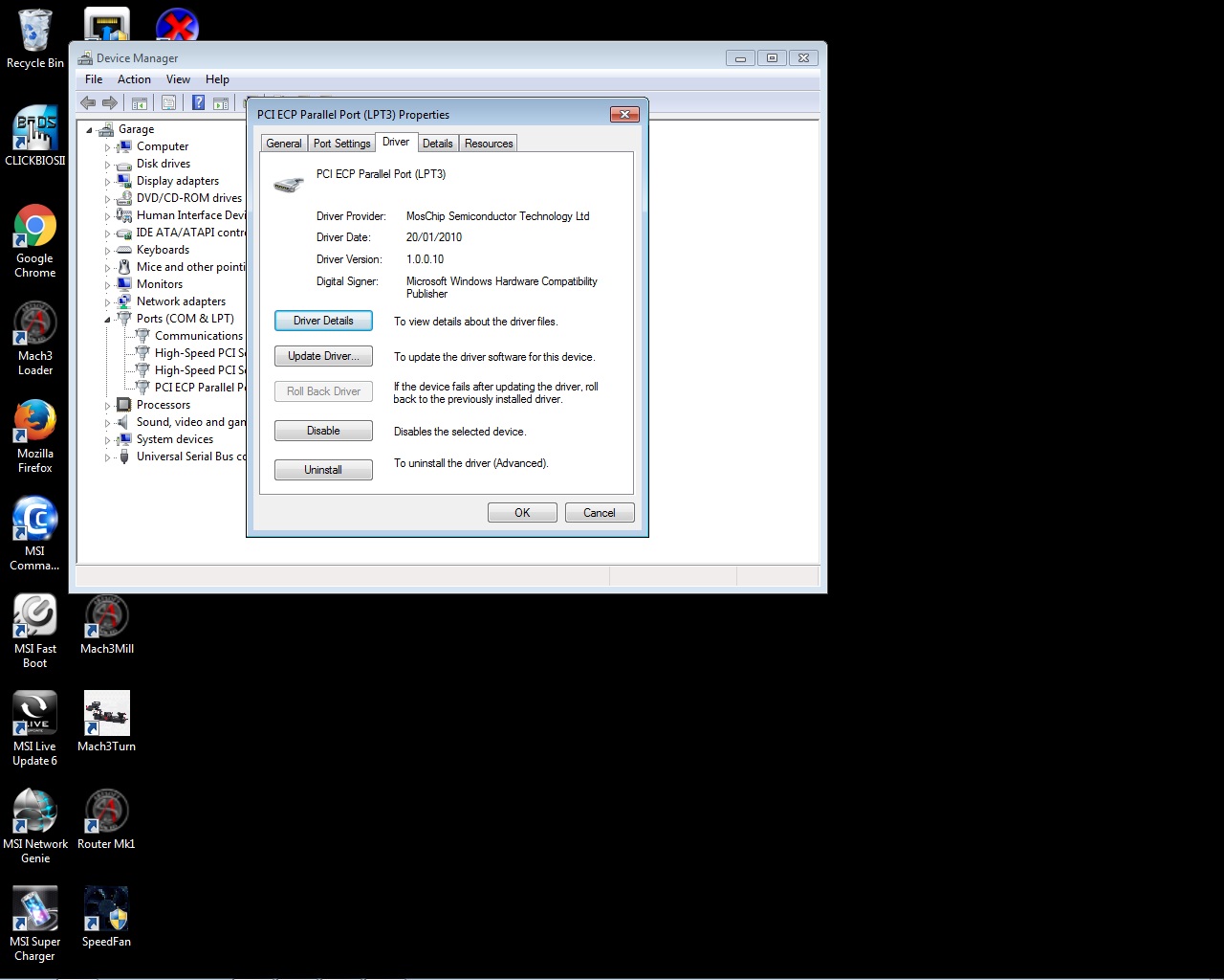

The red flag on the device indicates that the driver is not properly installed. It could be that the driver is not compatible with Vista. Software for a lot of add on cards was not developed after XP so you could be struggling. My dedicated CNC machine uses XP without any unnecessary 'features' I have PP card installed as well as the onboard LPT. Both work OK.
If you go into Device Manager and click on the PP you will get a window with General, Driver and Details tabs. Under details there is a Hardware Id in the list. If you select this you should get the hardware id, which you can copy and paste into a search engine. It might point to a manufacturers page with drivers to download.
It is a slim chance, but it is the best I can offer. It worked for me with XP.

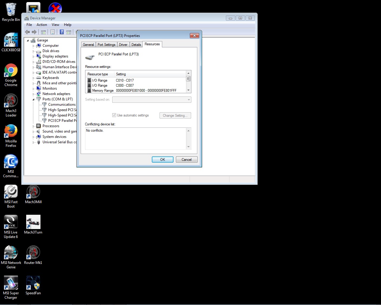

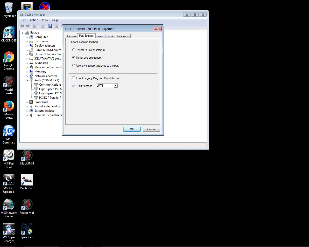

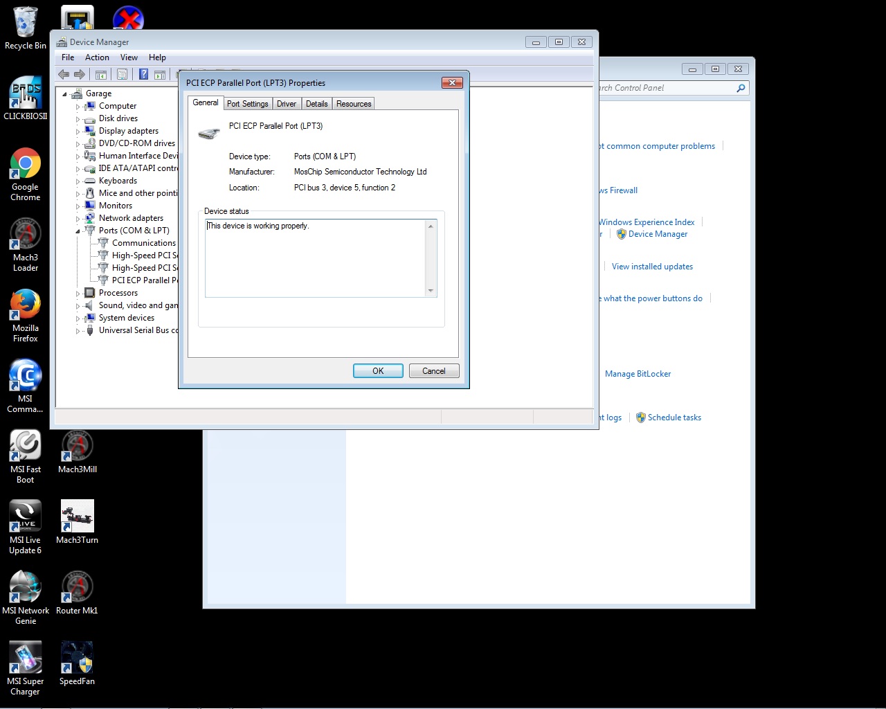

I'm using one of these on an AMD A55M-E33 motherboard.
Here are some screen shots of device manager entries, which may or may not be useful!
Attachment 16716Attachment 16717Attachment 16718Attachment 16719Attachment 16720
I'm inclined to agree with Rob - most likely issue is the wrong driver. Are you happy that you have the right one for your system? Again, FYI, I'm using Win7 64-bit. Sometimes you might need the corresponding Vista version (32- or 64-bit) if there is nothing newer around and these seem to run OK on Win7.
