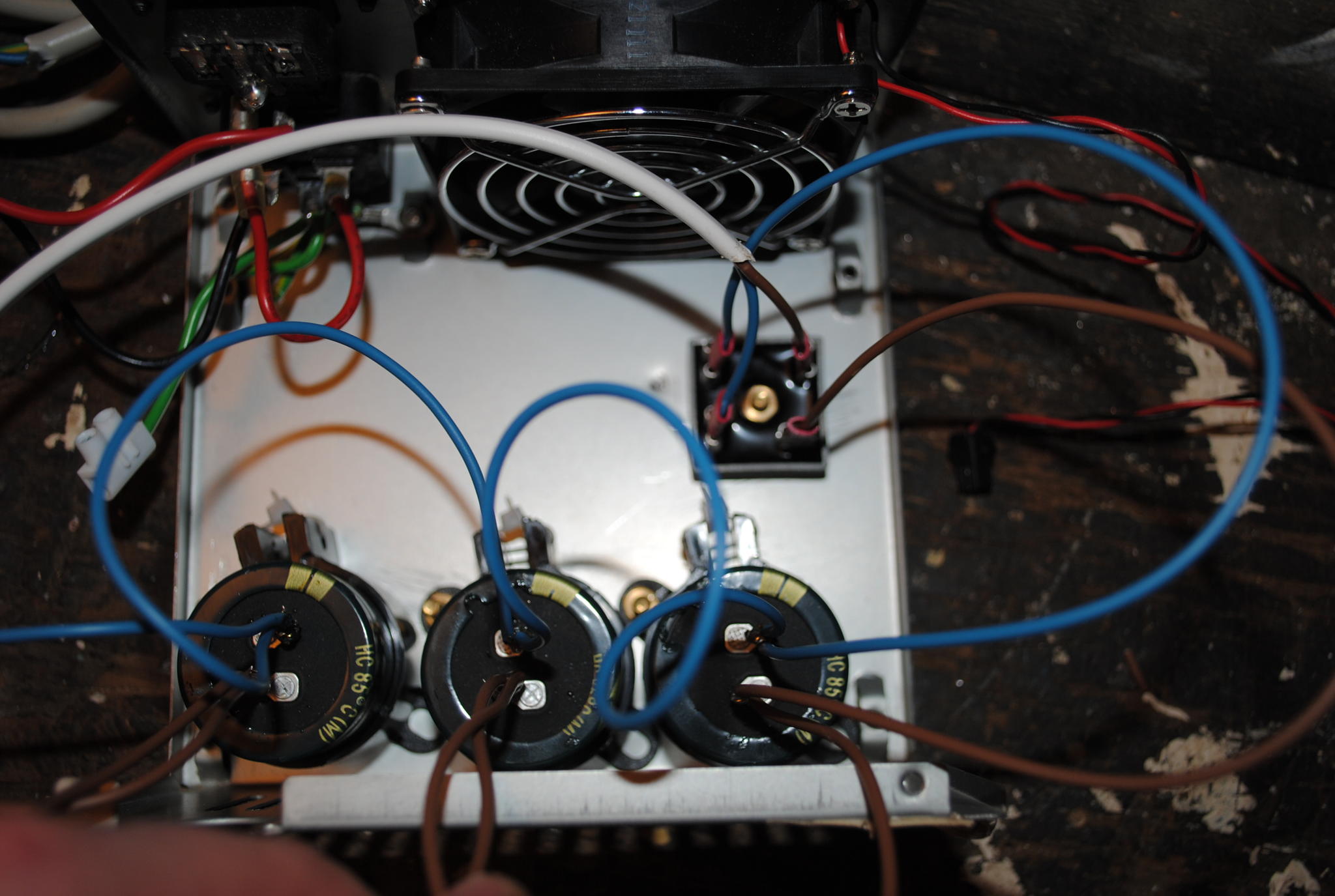

How did you measure the o/p current? have you checked the continuity of the o/p coils with an ohm meter.
How have you wired it exactly. Has it got two sets of input coils? A picture would be good

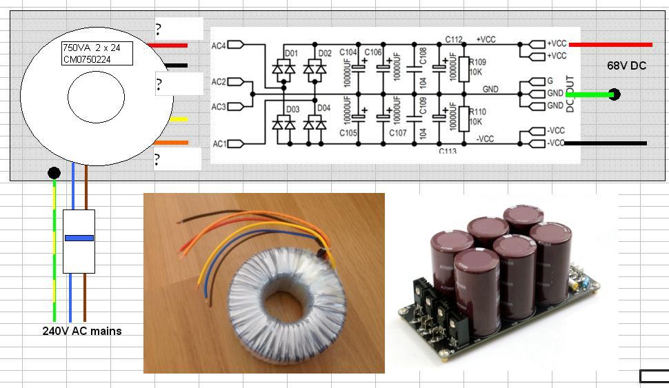

Hello Clive :D
So sorry, my post lacked a few details about the setup. Give me a few minutes and I'll get some pictures. In the meantime, here is the list of parts I ordered (Jazz checked them before purchase):
Attachment 16795

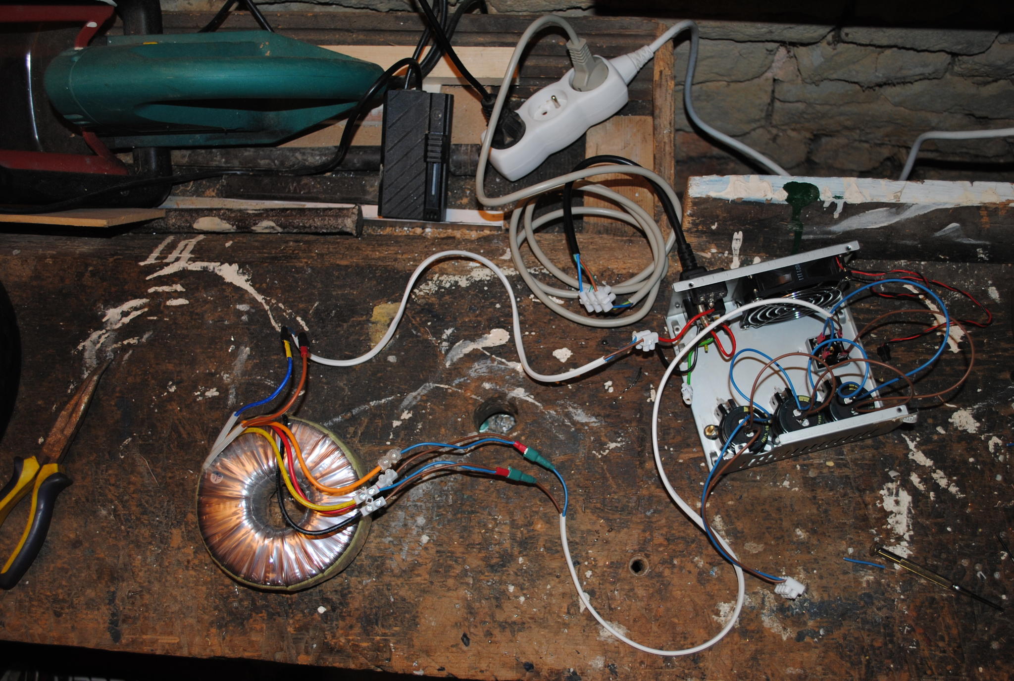

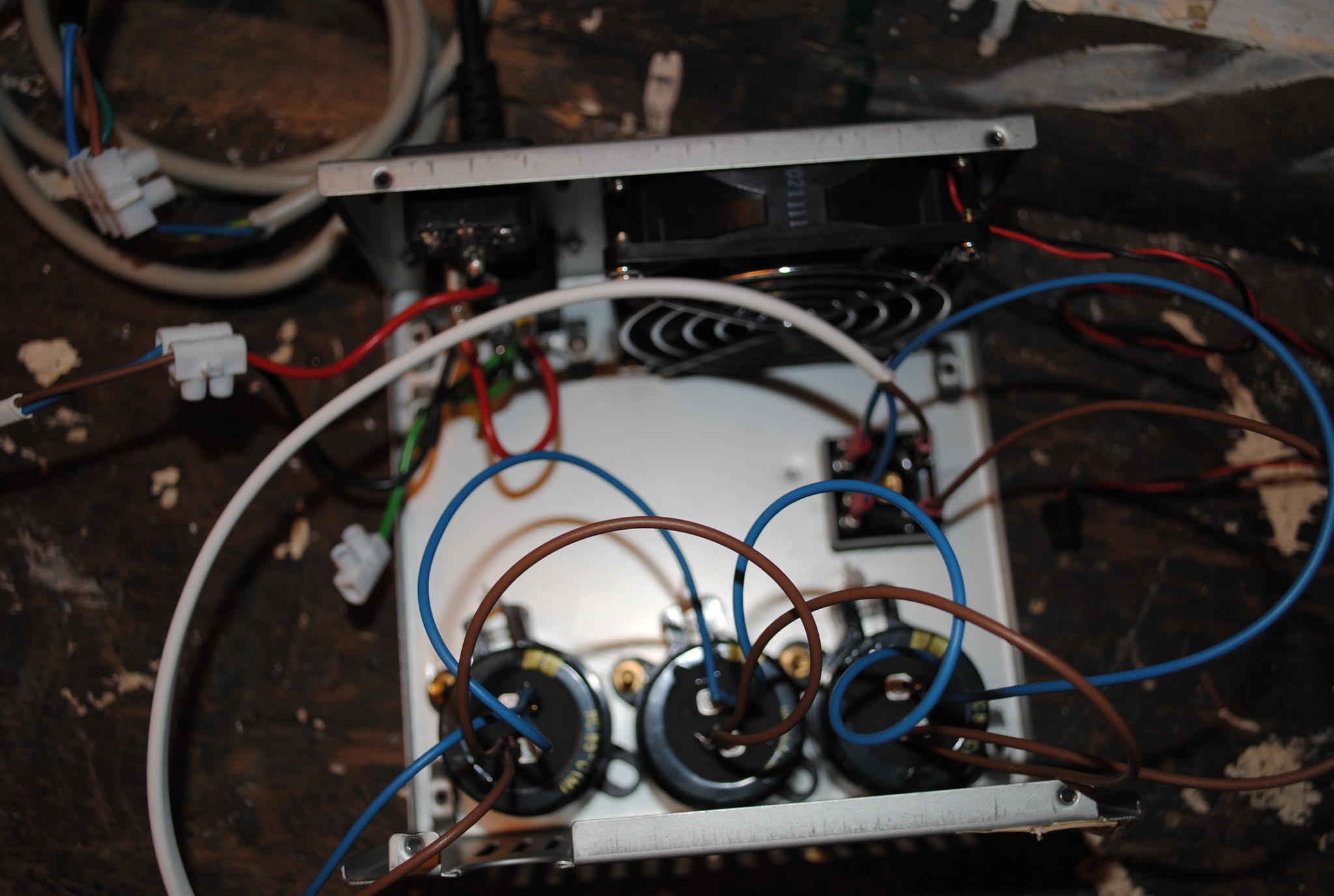

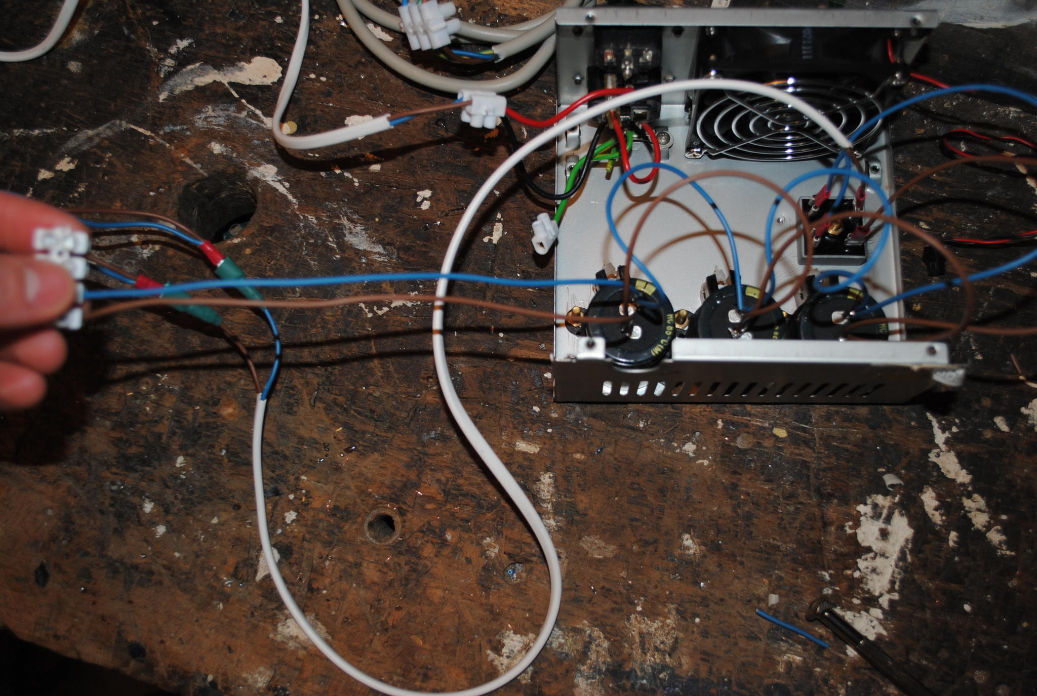

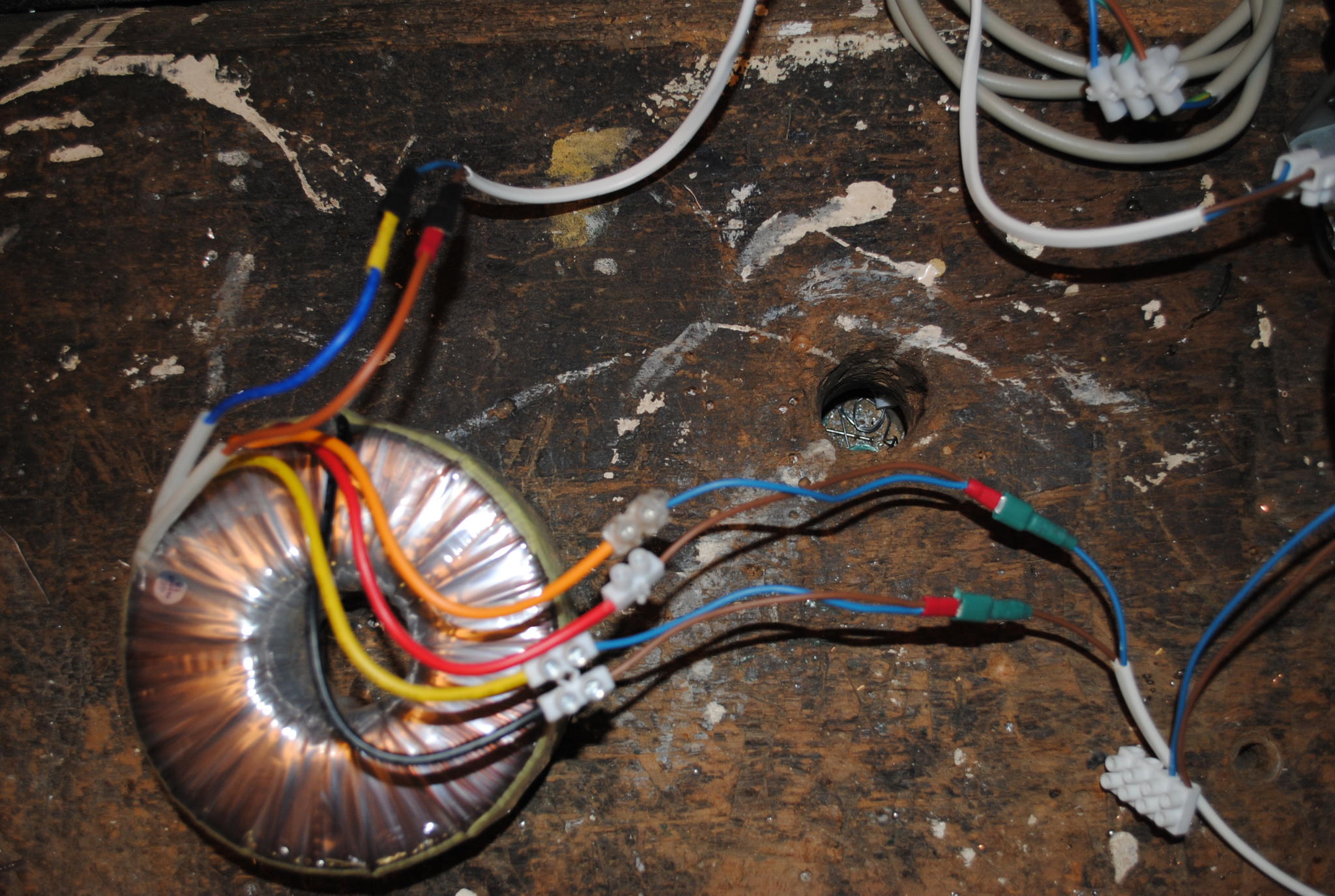

The transformer came with no ground wire, only load and neutral. Here is how I wired things:
To answer your question #2:
DC to transformer:
230V brown (load) on transformer's brown
230V blue (neutral) on transformer's blue
Transformer wired in series: (AC pins are vertical and diagonally opposed, DC pins are vertical + horizontal where horizontal is DC+ ans diagonally opposite pin is DC-)
- black and yellow together on one of the AC pins of the rectifier
- red and orange together on the other AC pin of the rectifier
Rectifier to capacitors:
DC+ to first capacitor's +
DC- to first capacitor's -
capacitors wired in parallel: + to + to +, - to - to -.
Capacitors to screw terminals:
+ to on terminal
- to another one
nothing is connected to the terminal
To answer #1:
The first time I measured from the screw terminals. Then, after unplugging everything to find out the transformer is not outputting current, I put my voltmeter on the black+yellow pin (they're crimped together on a ferrule) and on the red+orange (also crimped on a ferrule).
Not sure how to perform the second part of your question :/ ?
Photos will follow in a few minutes ;)
Here you go :)
Attachment 16797
Attachment 16798
Attachment 16799
Attachment 16800
Attachment 16801

I think you have the transformer wired wrongly. Firstly to make sure no damage has happened, disconnect the secondary side of the transformer at the screw terminals and measure the AC voltage between Red and Black - should be 25V AC, also check between Orange and Yellow - should also be 25V AC. If this is ok then the transformer is working.
Assuming that you are making a 70V DC power supply. Connect the Red lead to one of the AC terminals of the rectifier and the Orange lead to the other AC terminal. Then connect the Black and Yellow together. These should not go anywhere else. In this configuration the secondary windings are now in series.
Apply mains power and measure the DC voltage. You should see 70V - 75V DC with no load. Be careful as the capacitors will take quite a long time to discharge.

eurikain I think Graeme is correct. But lets start with basics First disconnect the transformer and measure the resistance of the primary (blue and Brown) wires it should be quite low if you don't have a meter just use a battery and lamp to see if you get continuity. If that sis OK do the same for the secondary coils. It probably is OK.
The next step is to connect the primary (brown and blue) to the 230V supply and then as Graeme states measure the voltage on the two secondary coils if you are getting 25V on each you are good to go.
Try that and report back.

That confirms it the primary is open circuit so see if you can send it back under guarantee.
What you have done is put a dead short across the secondary and burnt the primary out. Next time put a fuse in.

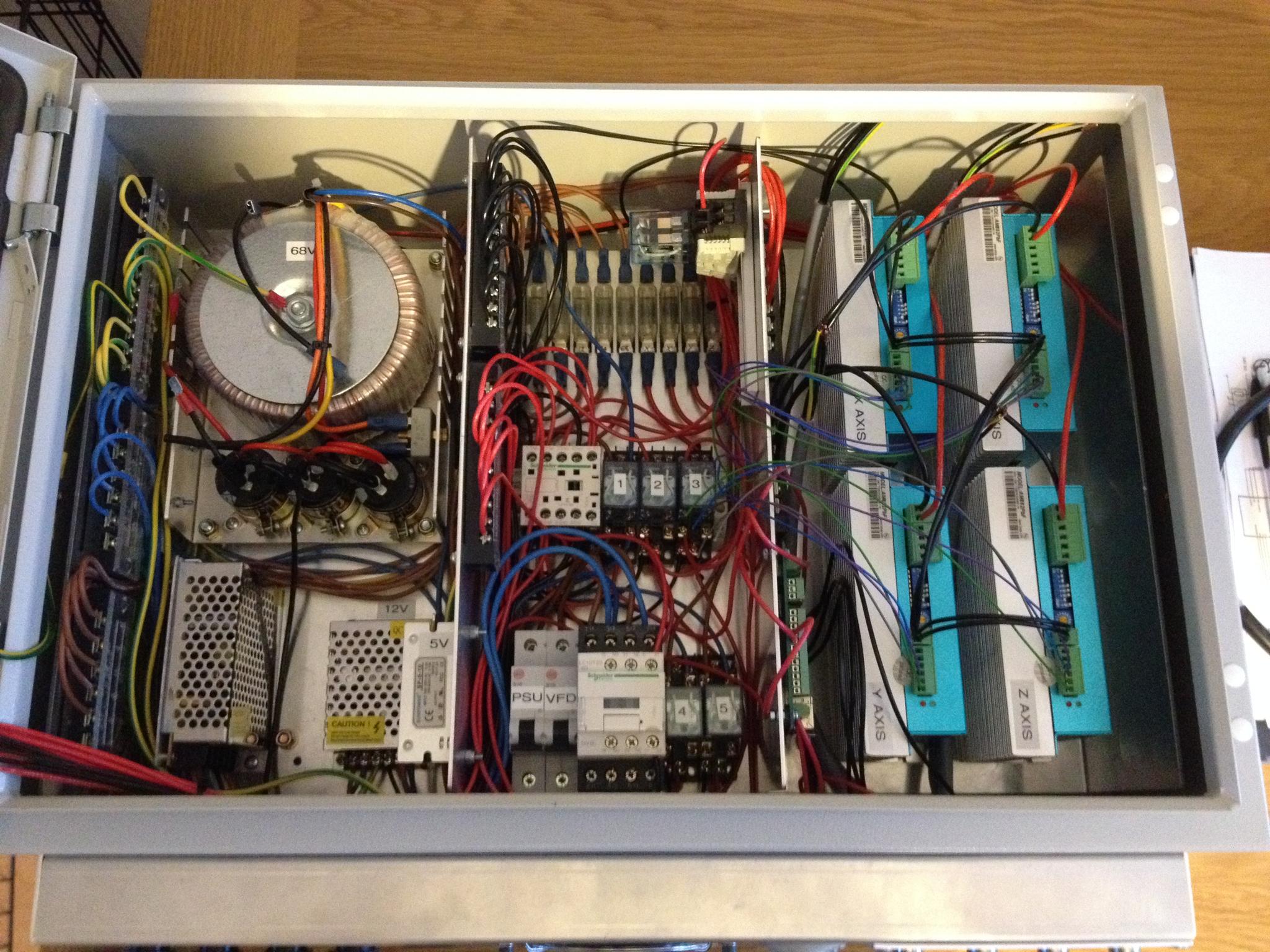

Re: Toroid transformer no ouput
For info here was my power supply build. Bit late now (!) but you can see the colour coding on the transformer, plus I also noted higher gauge wires on the secondary which I matched. Remembering back to my school days when the transformer coil drops the voltage it increases the current, which means larger cables. So I think that on the primary you have high voltage and low current (small gauge) and on the secondary you have low voltage and high current (large gauge).
http://www.mycncuk.com/threads/6988-routercnc_MK3/page5
Post #43 onwards
Hello routercnc, thank you very much for the link ! I have one question though: when looking at your diagram, I see that while wiring both yellow and black together you also wired them to the star point. Is that correct ?
On Wednesday I will go get the fuses I need. I will solder the capacitors and crimp terminals with bigger wires. The nice thing about the set I have is that I am using an old PSU box from a PC and it fits perfectly inside a desktop PC box. Plus it has the integrated switch, and a good start for a star point.
I'll keep you guys updated. Also think it's time to start my build thread.
Which post did you see those wires connected to Earth? Can't find which one you mean
routercnc
Post #43, image #3, the yellow an black are drawn in front of AC2 and AC3, which go straight to GND..Attachment 16803
NO none of the wires from the transformer connect to a star point that is only for all the earths. Also do not connect an earth to the bolt that holds down the transformer unless you do it at the bottom and not at the top like this pic showsAttachment 16802 as it creates a shorted turn around the transformer. I hope the guy that built this doesn't mind me using it to show the problem.
I see :) Thanks for the advice :) Jazz had noted that before as well :) Sounds like this guy's control box will blow up some time hu :s
It's funny because I had seen this image before on Google and always thought the setup looked quite nice :)
eurikain
Attachment 16803
OK, I was trying to re-use an existing circuit board and use the capacitors from it. I did not use that board in the end so ignore that picture for what you are doing it is not relevant.
Also, I'm no electronics expert and judging from your posts you aren't either. This is dangerous stuff so post pictures and diagrams before you switch on and get your electrical friend to check things first. I also wear eye protection with anything high voltage - when a capacitor lets go it is quite a bang and bits can fly off it.
