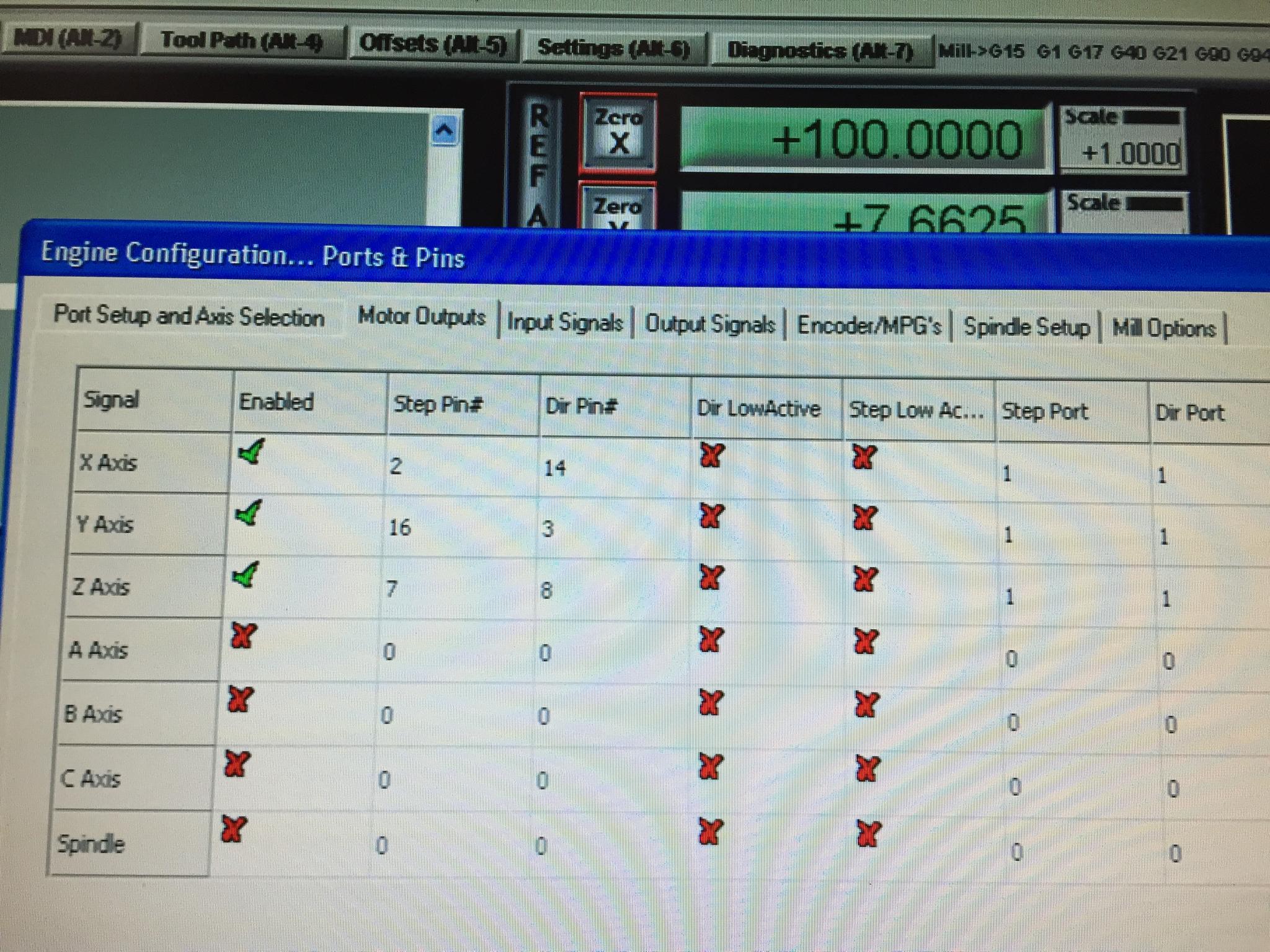

Wondering if anyone knows why my stepper motors keep stopping and starting when a program is running but in jog mode they run fine. Only new so Mach3 might not be set up ok.

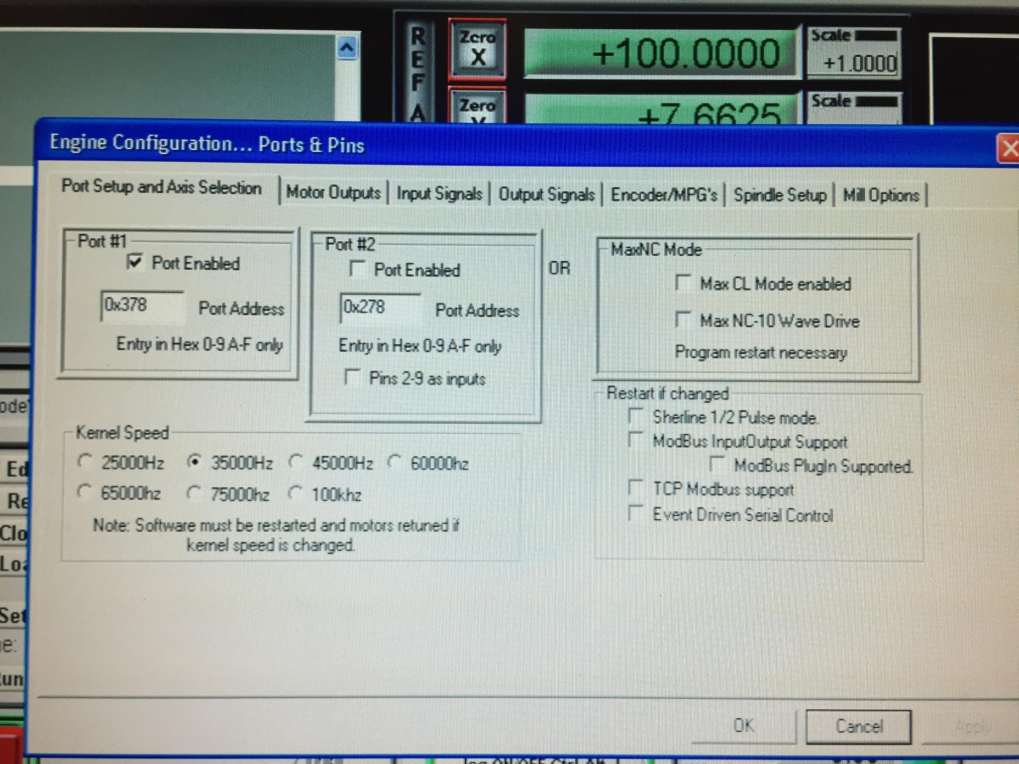

Ok well first turn the Kernal speed sown to 25000hz you don't need it that high. Going to high here stresses the parallel port.
Next the fact you are testing on the bench and not fastening the motors down will cause resonance which could be some if not all of the problem.

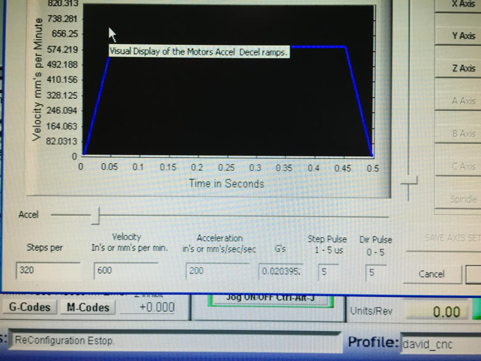

Also the Steps per setting how did you come to the figure of 320.? . . . . And What are Micro steps set to on your drives.?
Are each axis set to the exact same step per figure and tuning.? You must select the Axis on the side bar to correctly display for that axis and then save after every change.

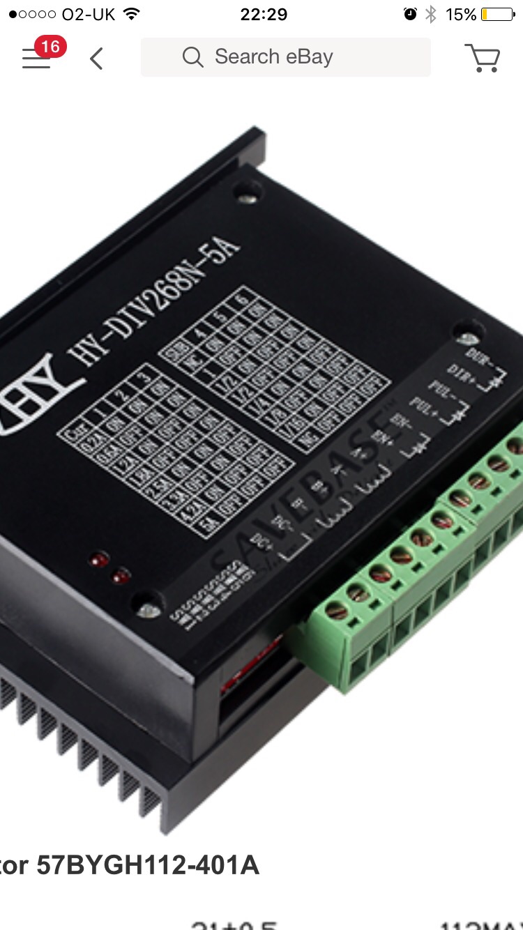

I will try and upload pictures of driver.
Once again many thanks for your time and patience
Attachment 17029Attachment 17030
These are the drivers which are being used on the motors. They are set for 3.3 a
Ok well 320 is ok but it should be worked out accourding taking linear pitch into account. With 1600ms then 320 would mean 5mm pitch. If your not using 5mm pitch and just bench testing then try 160 in steps per which would be like 10mm pitch and it's less work for the Parallel port to reach the same velocity.
This won't be your problem but it's a good starting point.
To help the parallel port you could also turn the micro stepping down on the drives to 1/4 (800ms) and set the Steps per 80.
Some times due to resonance you have to play with the MS to find best setting to match your motors. The quality of the drives plays a big part here and also how ridged the machine is. Hence why often Steppers don't work well on the bench.!!
EDIT: Ok well after seeing the drives then I'm not one bit surprised. Sorry to say this but they are Cheap nasty units which won't have much if any resonance handling capabiltys so it's no surprise motors are complaining.! They also often have slow electronics so it could be a timng issue.
One thing I've seen work before with these cheap drives is to toggle the Step low Active setting. (it's technical so won't get into why, just try it)
Also playing with Step Pulse Dir Pulse may be needed because the Opto's could be Slow so the Step pulse needs widening.
First try setting the Step pulse to 5 and Dir pulse to 0 and see what happens then if no change then toggle the Step Low Active.
ok i attached the motors to the cnc and still no change. i aslo have change the ms to 1/4 and 80. still nothing.
where can i find the step low active setting.
Here.

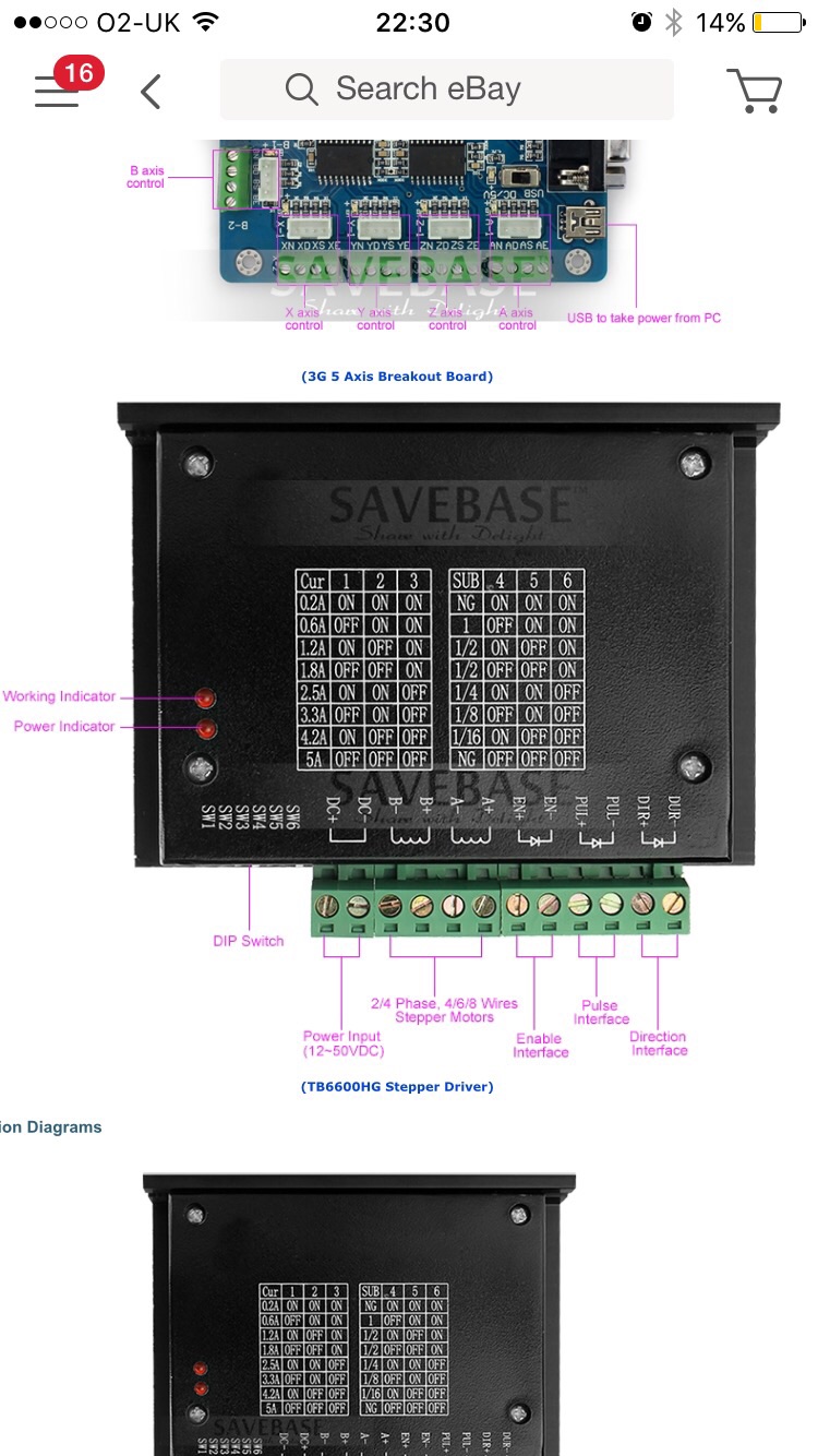

what should the normal voltage be ? is there any way i could send u the maual for the drivers?
Introduction
The TB1H is a high performance microstepping driver based on the latest original TOSHIBA high-efficiency TB6600HG IC. The TB6600HG adopts PWM chopper-type single-chip bipolar sinusoidal to ensure the low vibration and high efficiency. Moreover, the brand new design with BiCD0.13 (50V) process technology on the chipset also ensures maximum 5.0A output current and 50V output withstand voltage. Consequently, as long as the current range of the stepper motor is within 0.2-5 amps, all the 2 Phase or 4 Phase of Nema17, Nema23, Nema24 and Nema34 stepper motors will work perfectly with this new-type TB6600HG Stepper Driver.

Then you have the Drives.?? They are TB based drives and very very delicate things when it comes to voltage so don't what ever you do run them more than 36V or you'll fry them. 24V is safer but this does affect performance you'll get from the motors.
In all honesty they are Rubbish and not something I'd recommend building a machine based on but now you have them.!! . . . Well use them until they die.!
