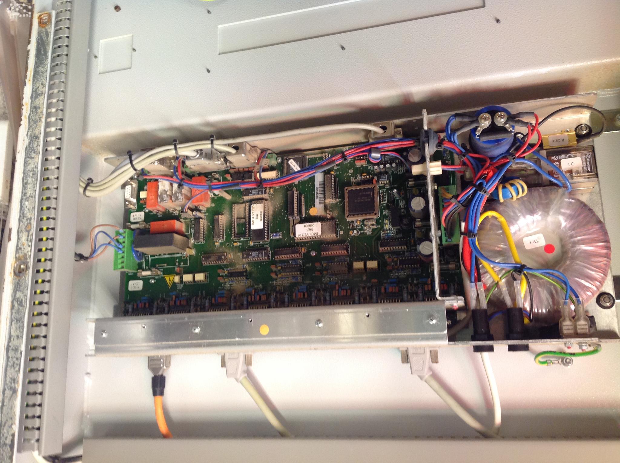

Evening guys
well the machine arrived today. It does power up in as much as the door light comes on (but the door wouldn't open, I had to unscrew the handle to open it) and you can turn the motor on, you can see the motor relay engage but the motor doesn't kick in but I guess this is controlled from the software.
Anyway, the huge important bit which I'm dying to get your advice on, the electronics.
to my dissapointment, it's an all in one board and all the axis plug into it. The picture is very big, sorry, I will resize asap but I'm on my iPad and it's late
Attachment 17225
Same image here as it seems to be flipping it upside down on the forum: http://raynerd.co.uk/wp-content/upLoads/image.jpeg
i guess the electronics and large transformed on the right is for the motor or is that simply the PSU for the entire machine.
Does it looks like I've any chance of running with mach3 or do I need to strip the board and start fresh with new drivers. I'd be confident in retrofitting 3 fresh drivers and to be honest, I'd probably have to manually turn on and off the spindle motor via a switch to start with. Consequently, I'd pretty much rip out all the electronics. If I was to do this, is it entirely certain the motors would be ok or would these need swapping, in which case the project has just got massive as it would require a full strip down of the entire machine and not just the electronics panel.

Cant see anything that would stop you converting the boards to the typical motion controller+ Breakout board + motor drivers. But we will still need to see the motors, hopefully they are compatible with the standard types of stepper motors ( good reading on here: https://learn.adafruit.com/downloads...per-motors.pdf)
I would keep the powersupply and reuse the safety equipment then stick a motion control board and either a leadshine MX4660 or a gecko G540.

Chris I would remove the main board and replace with good quality Digital Drives. Don't be tempted to try doing this on the cheap it will only cost you more money in the end.
I would also buy individual drives rather than All-in-0ne board like G540 or MX4660. Not because they are not good but rather because they are not cheap for what you get.
Steppers are most likely re-usable but you will need details to know how to set new drives etc. ie: Amps also how many wires to detemine how can be wired.
If power supply may be re-uasable depending on it's output. If less than 36Vdc then I'd replace it.
The rest will be re-usable, ie: E-stop, switches etc.
Now regards the BOB and parallel port then it's mine field.!! . . Cheap nasty Bob's can send you bonkers at best of time, couple these toPc with ropey parallel port and you'll soon be smashing your head against wall in frustration.
So my suggestion is Don't do it. Buy Decent Ethernet based Motion control card and connect it to Good BOB.
Only Motion control cards I suggest are ESS or Cslabs IP-M. Now when it comes to BOB's then my first choice is not to use one at all, which I'll tell how in min, but if I have to then only one I'll use is from PMDX in states but it's expensive. If really have to then I'll use one from Cnc4you or Roy at DIYCNC. Don't entertain cheap nast ones off ebay.
Now my first choice for machine like this and by long way is the IP-M. This removes all the BOB issues because doesn't use one and comes with all connection terminals. It uses 24v I/O so is very noise immune. Comes with Spindle speed Controller built into it.
It's very high quality unit which is robust and very neat. Manufacturer and software Support is very good.
Now at first it may seem expensive but if compraed to ESS and High Spec BOB with Spindle Speed control then it's not, it's actually much cheaper.
You could go with buying the G540 or Mx4660 and fit ESS but this will still workout more money than doing it with separate Drives and IP-M and still would have lesser quality system.

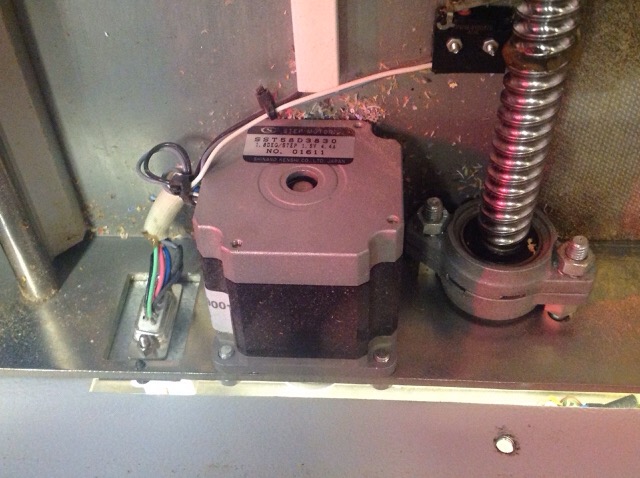

Ok, I've managed to uncover the motors
Attachment 17245
Motors are a Shinano SST58D 3830. 1.5v 4.4A
data sheet here http://shinano.com/motors/docs/SST58D.pdf
Anyone give me any hints on what this means - good or bad news? Please tell me I don't have t replace these!!

They look OK to me. Can you find out what the secondary Voltage says on the transformer (or can you measure the DC Volts across the blue capacitor) in the power supply as Dean (Jazzcnc) has asked before
Re: Isel CPM 3020 - run with mach3?
Ahh across the blue capacitor, thank you! - it measures 24.5v .... Not the 36v suggested!

Ok then it looks like you will need to build a new power supply it basically consists of the transformer, Caps and a rectifier about £45-£50. What part of Manchester are you in?

Like clive says motors are fine and you will be better using a new PSU with more voltage. If tight on budget then Technicly don't need a new psu and the machine will work with 24v even with new drives but you'll get much better performance with more volts. Not changing would be like having a ferrari and never taking out of 2nd gear.!

Jazz, now you have seen the motors, any suggestion as to the best value but quality drivers?

These will work nice for that small machine. http://www.ebay.co.uk/itm/Leadshine-...kAAOSwNSxVIEIl
Run them with between 44-48Vdc using an unregulated PSU. Either build one like clive says which is very easy and done exactly like what's inside the machine already just with larger transformer and capacitors. You will probably be able to re-use the bridge rectifier may even be able to re-use the Capacitor depending on it's size and just add another.? Thou for the cost you may be better just replacing.
WARNING### Capacitors can give you nasty shock when charged up so don't go fiddling unless your sure they are dischraged. Always check with a meter before touching across termianls.
