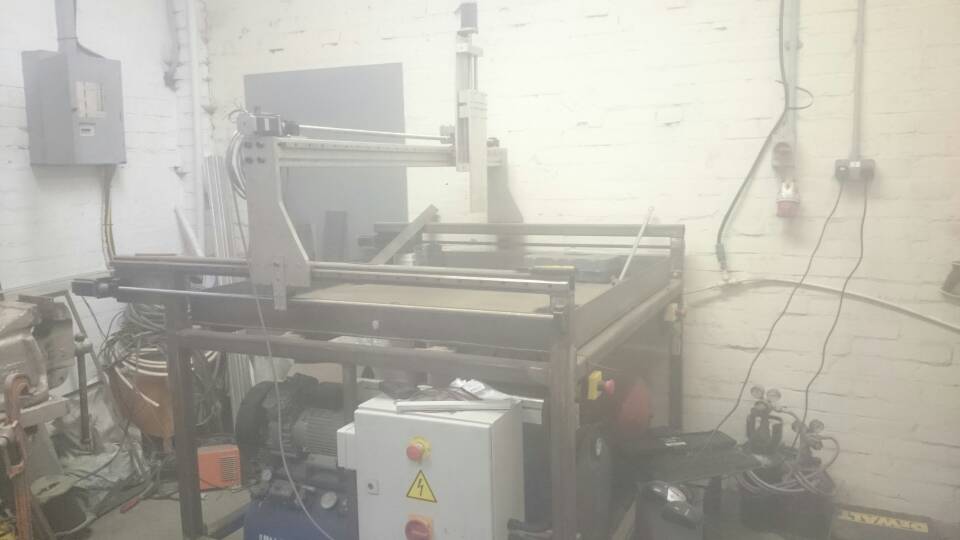

Cnc plasma build need help plz
Hi
ive been building a cnc plasma but cannot seem to get the speed up in Mach3
The motors run super slow
im using a dell 755
wantai 3nm motors
leadshine em503 drivers
5 axis Bob off flebay
24v Siemens psu
1605 ball screws
any help will be appreciated by myself and anyone else stuck with this problem
i will post pics of my build so far
but I've gave up on it for now till I can find more info
thanks in advance
lewis

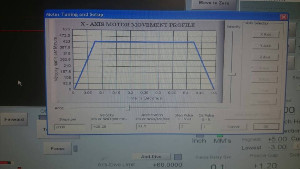

post a screenshot of your mach3 motor tuning page? also advise what the microstepping resolution it. if you are direct drive to the ballscrews and they are 5mm pitch, then it is quite simple to set up.

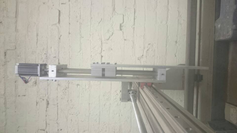

5 Attachment(s)
Re: Cnc plasma build need help plz
Sorry couldnt figure out how to upload images but ive got it now
I think one of tje leadshine drivers are faulty as there is no power to 1 motor
Hope I can find the problem with it being super super slow
Sent from my D6503 using Tapatalk
Your not helping us here much mate.? Thou the one pic that is anygood tells me you probably have the Steps per setting wrong.
This is why I asked for the micro step details further down which you still haven't given so can't give you accurate figures but I'll explain how to calculate it.
Take the Micro step amount and divide by the ballscrew pitch. Ie 2000ms / 5 = 400 Steps Per.
The fact you have such low voltage and using 5mm pitch will slow down the speed you'll get but still you should reach 2000 - 3000mm/min Velocity easy enough. Set Acceleration about 800 for starters.

Yes so try these new numbers and see what happens. Think you'll find a bit of difference.!! You'll go from Max velocity of 750mm/min to potential velocity of 9350mm/min thou you'll never get that with 24v and 5mm pitch screws.
25000khz / 2000 = 12.5mm per Sec * 60 =750mm/min
25000khz / 160 = 156.25 per sec * 60 = 9375mm/min
So has you see the Micro steps make big difference. So high Micro steps with low Pitch means more pulses to do same speed and you only have so many pulses. In this case 25000 per sec.
800/5=160 steps per
Also just to make clear the Steps Per setting isn't a number you can play with to suit the speed. It's a Fixed number based on the number of steps required to move one unit, in this case 1mm. This number is got from the calculation of Micro steps divided by screw pitch.
Lewywri89
Its just very confusing that the motors turn fast when im using the protuner software
The reason is because the Protune uses the drives own built in Pulse generator and it's default Micro stepping settings. It doesn't use Mach3 at all.
The reason why you are getting such low speeds is because you are using Mach3 to provide the pulses and you have limited number of pulses available. Now because you have set the Steps Per setting so high the Max speed is drasticly low.
What you have to understand is that Steps Per is a Calculation and MUST be correct. It's not something you can play around with other wise the machine will move the wrong distance.
Provided the Numbers you gave me are correct then those settings will work and you will get more speed.
The Low voltage will reduce the speed and Torque you'll get from the motors but it will still give you much higher than the Max 750mm/min the 2000 Steps per allowed. Difficult to estimate how fast because lots of factors come into play but I'd say easily 2000-3000mm/min for starters.

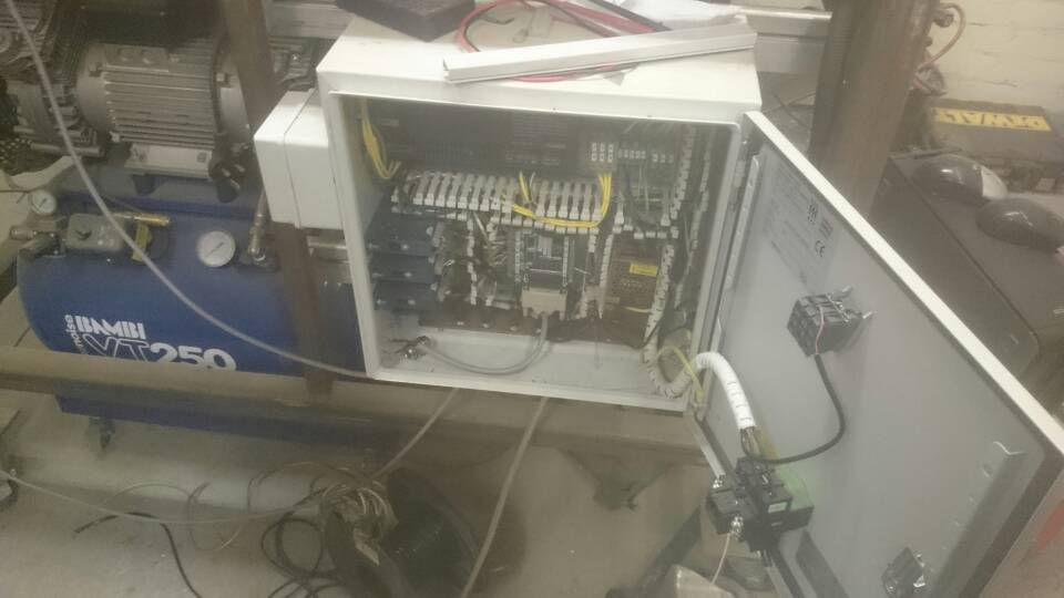

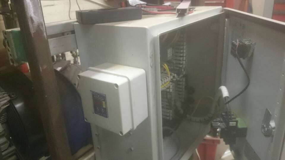

What make you think you have blown the drives? post a pic of the faulty drive and say how you think you have blown it. Also why will you need two power supplies?
The first one has no visual damage but no power to motor
The second is damaged from plugging the rs232 cable that I burnt plugging in the first 1 whilst powered on and has now pulled the pins out the socket of the second
Thought 2 psu's for 4 drivers was ideal if not I will need one with 4 outputs won't I??
Attachment 17332
If i soldered a new port on would this help or do you think the internal circuit will be goosed?
Lewywri89
The pic is too much out of focus to see it. Also there might be a fuse in the other drive
Thinking about this and there should be no way that should have happened to burn the plug up like that. I would check that there is not a potential difference between the case on the drive and the pc.
Attachment 17333
I had it running the other day but so slow it was barley noticeable
But since I plugged in the software cable in when it was on one drive wouldn't work
Then I didn't notice the cable pins were burnt until I plugged into the next drive and couldn't unplug it
The port on the first drive however looks fine

Ok we have confussion going on here because there are 2 ways micro stepping is shown or described. It gets involved but i'll try to explain quickly.
Typical stepper takes 200 steps to turn 1 revolution. Now Micro stepping is explained two ways either total Micro steps Per Rev ie 1600 or the number of 200 pulses ie: 8x 200. Both these mean the same thing.
So when your seeing 512 in manual then that means 200 x 512 =256000 micro steps per rev which is massive and you can never use.
Now you need 1600Ms so then you need to set Micro stepping in Protune software to 8.
Now where it gets confussing is the Dip switches on the drives relate Micro stepping Ie 1600.

All the axis worked but wrong speed/distance
I never managed to change the setting in motor tune page in mach 3 so I presume that was my speed problem but 2 drives out of 3 no longer provide power to motors so I assume these broke
