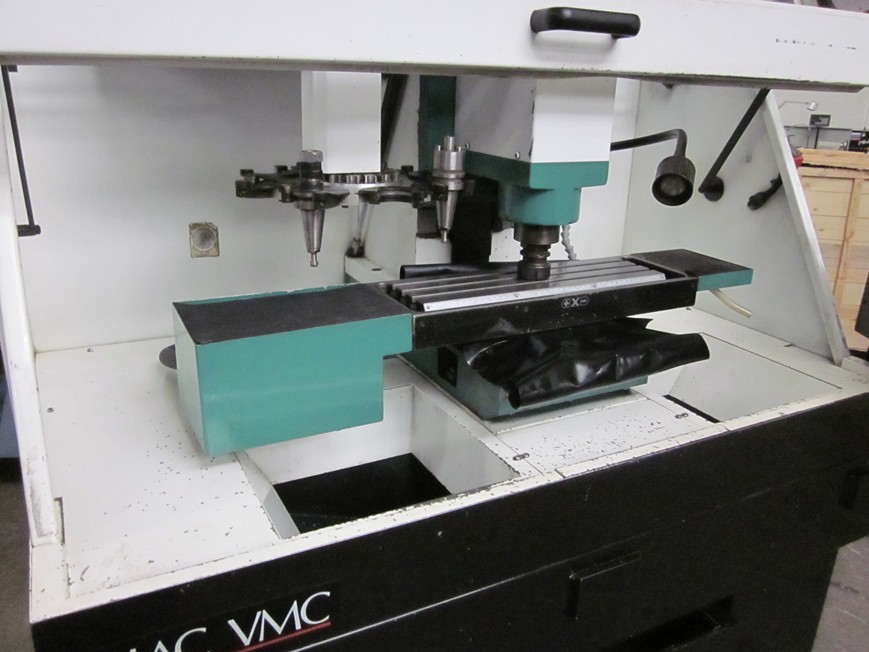

		Denford TRIAC Servo VMC 1PH
		Rare Denford TRIAC VMC for Sale. Excellent condition.
Serial No H00675,
Year Oct 2000, 240V,
12Amps, 50Hz,
Single Phase, Control Voltage 24Volts,
Spindle Motor 1.5HP,
1.12kW DC,
Max Speed 4000RPM,
Weight 630kgs,
8 Station Automatic Tool Changer With 3 Tools,
Denford Desktop Tutor Control.
Cabinet glass is with machine. Was removed for cleaning.
https://www.youtube.com/watch?v=54we2GTJL_E
Price £3000 ONO
Machine currently located in Cardiff.
PM if interested.

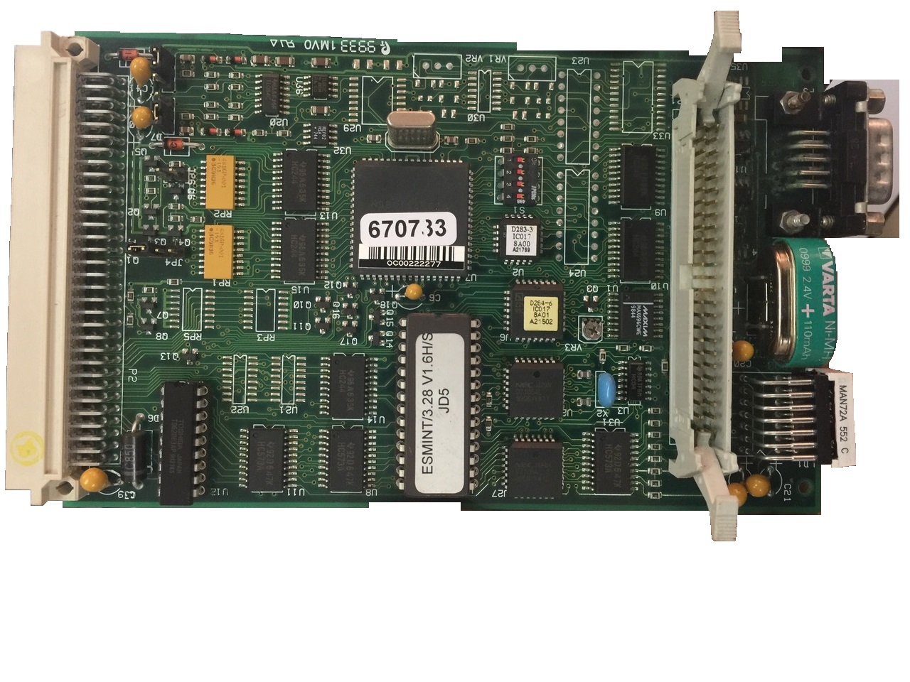

 Hi, Do you have “baldor D281 motion control card for a triac P. C. (denford), red 7-segment LED display type. The firmware is ESMINT 3.28 V1.6H/S - JD5.”
		Re: Denford TRIAC Servo VMC 1PH
Tommy
 Are you sure you have asked on the forum enough times?
andy_con
 I think he has posted in every Triac there there is. My email went mad with all the updates.
Ill need to go through the stuff I have to check. Picture of the card will help me see if I have one.

 :smile:  My apologies for the numerous updates. I have attached the picture of the TRIAC control card. Cheers.
Attachment 20336
