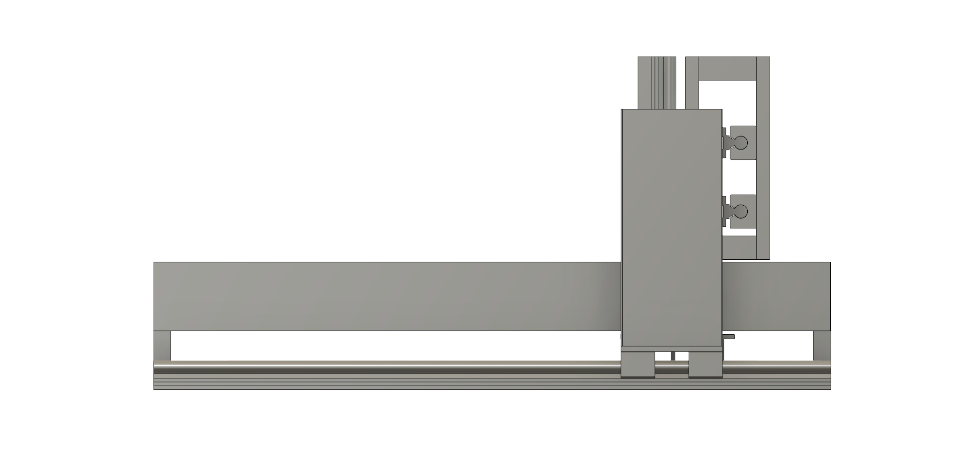

Major considerations, I have a workshop in a spare room in my first floor flat so everything gets carried up and down as required, and I try to limit noise to be considerate to neighbours. Been looking at Fusion 360 which I find simple and straightforward to use with the Seig conversion so knocked up a quick mock up of a machine to get some comments and advice sure there are lots of traps I have fallen in to pictures below .
My requirements call for a 700x400mm work area and max 100 mmZ axis. Not included in pictures are 2 SFU / RM 1605-1050mm- C7 ballscrews driving Y axis, either 1 or 2 SFU / RM 1605-650mm - C7 ballscrew driving X axis and single SFU / RM 1605-350mm- C7 ballscrew driving Z axis with a Chinese 2.2 water cooled and VFD. A lot of my strength I am relying on a solid base I intend to bolt whole thing solidly down onto a welded steel framed table with a solid cast iron top.
Attachment 17984Attachment 17985Attachment 17986Attachment 17987Attachment 17988
Material wise two bed sides are100x100x10mm T section which can be backed up by another 25-35mm plate without losing work area, X and Z main components 25mm and 30mm Ecocast, first draught so nothing much fixed apart from overall size, my idea is based on ease of build, welding in the flat is not an option.

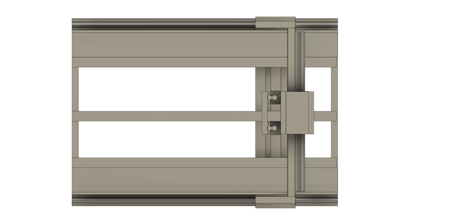

Re: Aluminium Framed Router

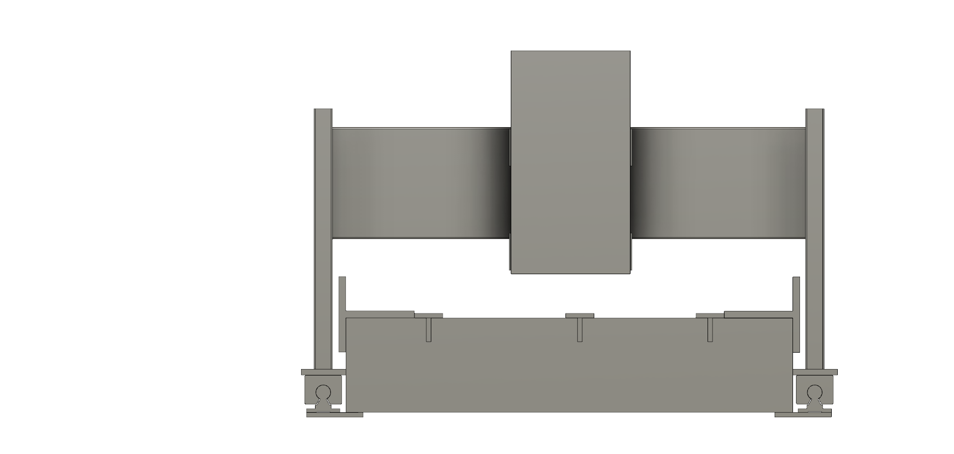

Not sure what your trying to achieve here.?
If you have Cast iron surface plate why do you need the lower frame.? Just bolts the rails to the Cast iron top.
The gantry and Z axis setup are both very bad idea. The rails on back side of thin plate will flex and resonate. But worse is the length of the top and bottom bearings plates make long lever that will flex like crazy. It will affectively be like putting Z axis and spindle on end of diving board.!!
Suggest you scrap the whole tall sided Gantry idea and go with better setup of building up the sides from the base to give gantry clearence you need and sit rails on top. This can be done with steel tube or aluminium profile.
Then gantry again made from tube or profile sits directly onto the bearings giving a very strong and simple setup. To give you some space back make bearing plates that offset the gantry back slightly and mount the rails on top n bottom. Put ballscrew on backside with Z axis top bearing plate extending back so can connect with ballnut.
This setup will be much stronger and easier to build.
Also forget buying Ecocast or ground tooling plate with these rails because the base of them will have more error than normal aluminium plate so it's wasted money.
Ecocast already dismissed offered some stock from a company due to close.
Idea behind lower Plate 3x1 1/4" to make unit stable if moved off base bolting rails straight through plate and cast top so idea to have some rigidity while building off plate as thats being ground.
Raising sides and shortening gantry was considered using 6x2 box section between cast plate and mounting rails shortening gantry sides considerably sounds like this may be worth while also removes bottom plate.
As I already have all of the Angle and T sections that I used in original design (reasoning behind much of my design) and have been offered all the plates in original design for £100 inc vat for 6082 grade stock will have to see what is available have to look will be buying more depending on space in my lock up when I see the total stock today, if nothing better available backing the 1x6 635mm X axis with available 3x1x1/4" angle would allow top bottom mounting X rails and firm up cross beam.
Back to the Drawing board and try again, thanks for the input.

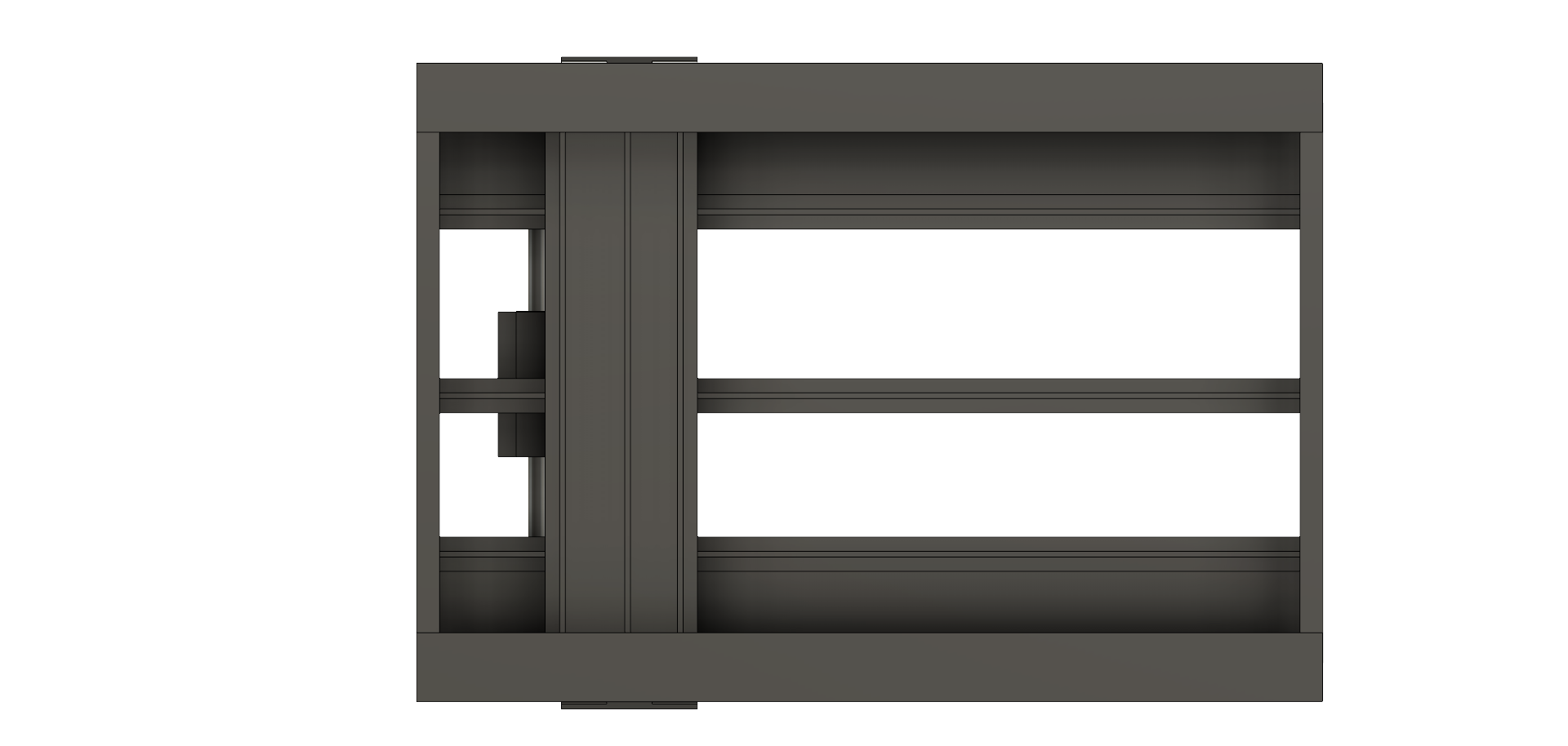

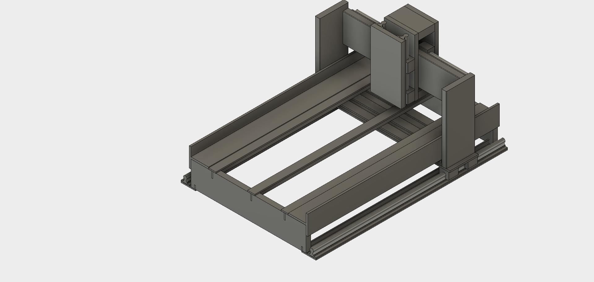

Had a quick look at design and Knocked up version 2 this is a draft few peices omitted till I collect stock material acquired today like side of gantry just turned original on side for now and nor bothered actually mating same to bearings more for concept than actual design, also brackets mounts for screws, motors etc missing.
Hopefully overall design and more importantly rigidity improved pics below sides now 6x2x1/4" Aluminium Box, cross member on X axis now original 150x30mm Backed by 2@3x1x1/4 Angle faced to 75mm x 25.4 to fit.

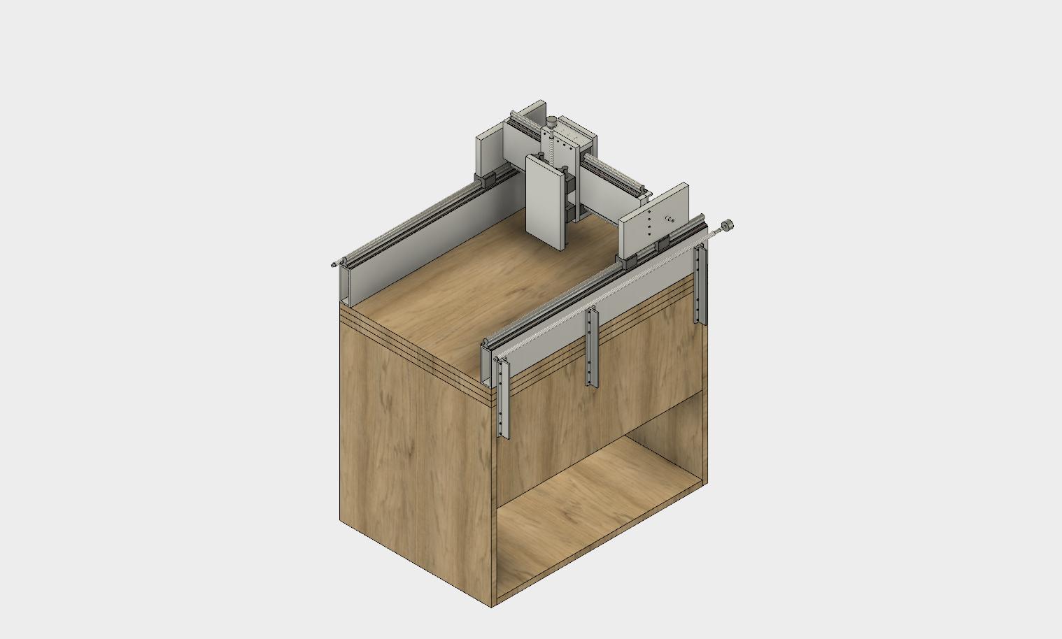

First chance to do any work on build today half a day off so made a start, first job decide what to do about the steel and cast iron base I intended on using, top has been ground flat and its ready to go but Base weighs in above 3Cwt and Top just over 4Cwt all to be carried upstairs.
For time being I am going to put base into my lock up and try a different base to as all work in flat is likely to be lightweight, I will be selling my flat and buying a property with a workshop so the base will either be used then with this machine I originally designed for it or with version 2.0 which I have no doubt will be built.
So alternate base? As welding out of question in flat I have gone for simplicity, two sheets of 25mm MDF to make my base, bed laminated 75mm MDF whole base sealed glued and screwed, it's solid, time will tell if its solid enough, I cannot see any problems with type of work it will do whilst in the flat.
As base was drying I decided to drill and tap side rails which are 6"x4"x1/4" Ali box I used M6 with 30mm washers to attach rails to bed, M4 to mount external supporting ribs 300mm 38x38x6mm T section, M4 again to mount 20mm supported rails quite happy with the afternoons work, rails have a little adjustment available and I intend on locking them down with either loc-tite or epoxy when final adjustments made, currently as close as I can measure having just dropped them on and pinched up they are within 0.5mm over 1000mmm on the parallel.
Couple of pics below showing latest design and progress.

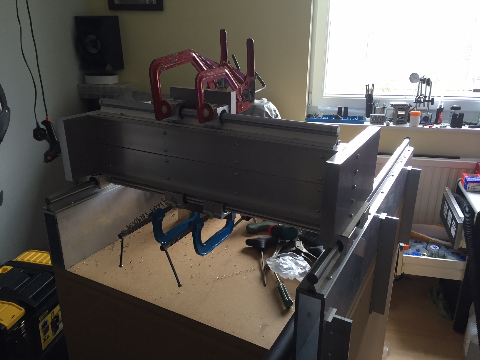

Grabbed a couple of Hours this afternoon again and made a start on the X axis, by far biggest lump of aluminium thats been machined on the Seig since conversion, think I upset it when I put the fly cutter on to true and parallel top and bottom to accept rails, it started spitting needlles at me with a vengance!
635x150x30mm 5083 Plate backed by two lengths of 3x1X1/4" angle which was drilled and plate drilled and tapped for M4, top and bottom trued, paralleled, drilled and tapped M4 again to mount rails.
Stomache was thinking throat had been cut so stopped now to eat, just two ends of crossmember to machine true and parrallel and it is about ready for ends/gantry sides to be mounted, I am thinking pocket the gantry sides 1/16" to accept crossmenber for strength and ease of alignment doing so also positions them nicely to centre of Y axis bearings.
Spindle and VFD just arrived got a good deal on these £146 delivered and they look ok, now I'm cooking with gas.
Build is going OK a good start with 9 hours in its starting to take shape, if you sort of squint and look sideways that is, as my old dad always said "a blind man would be glad to see it"!
Thats a solid piece of gantry! Must weigh a bit?
Have not tried a flycutter yet, but I suspect the same thing will happen when I do :)
Have fun with your build!

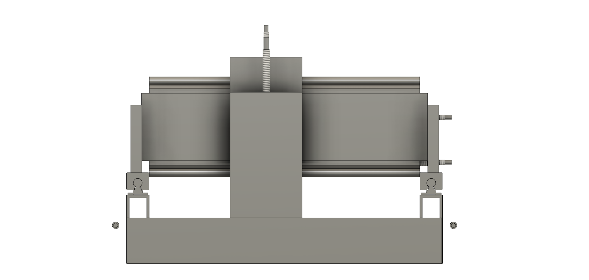

Have a Y and now almost an X and I have a few spare hours over the weekend to come up with working drawing for Z and start machining. Impressed with Fusion360 so far simple to use and with a little tinker of the code before running mach3 the little seig conversion goes about its business with little complaining, nice to get some decent size lumps on it to cut eventually and make some decent chips.
Ended up pocketing 4mm each side to centre the gantry raiils onto Y axis bearings. the work area I will be able to use now confirmed as minimum 780x450x100mm

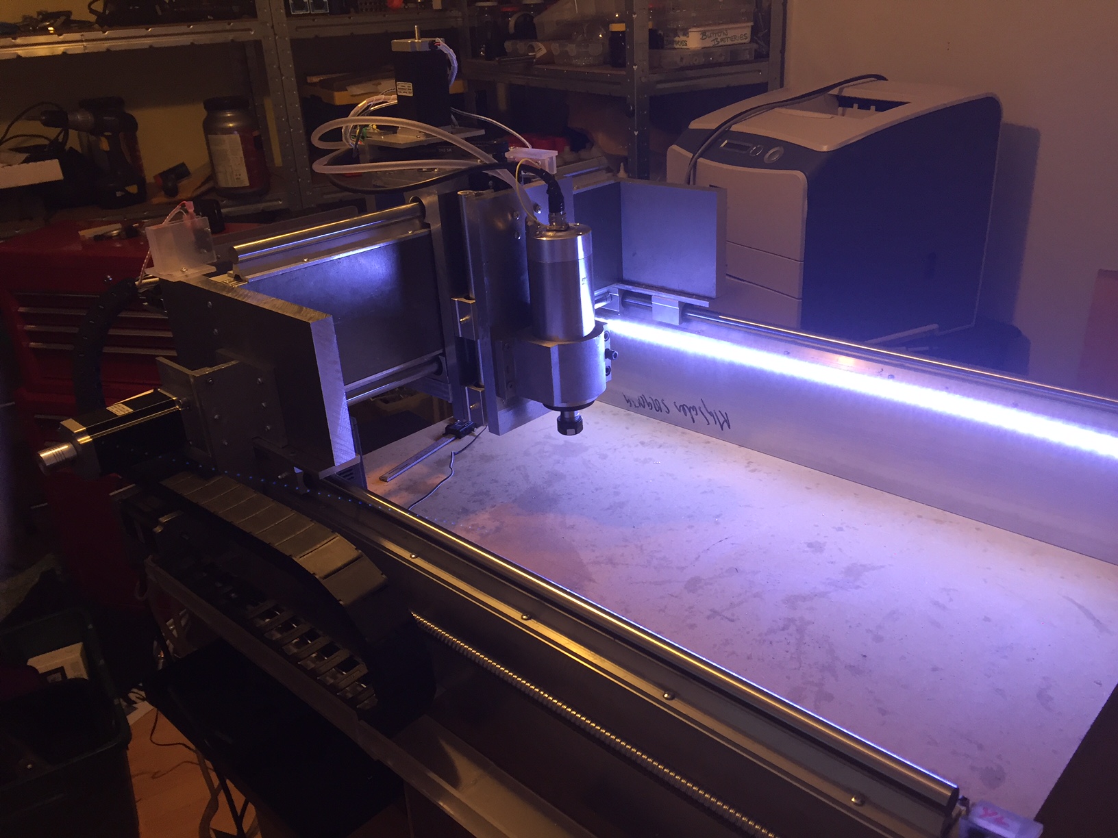

So much for a day off only ended up working till 9pm, had to plug it in a try it when I got back, spindle fine, Z axis fine, Y axis with A slaved no problem, X axis just a rumble and rock from motor, too tired to even think about it tonight can't be too serious it didn't go bang! The two working axis have proved already it has all the speed I will ever be able to use in the flat and then some if it lived in a shed the shed would have been rocking. Would have been nice to have it all work but 4 from 5 is better than a kick up the backside.

No problem Lee Fleebay had a 20% off everything offer for a few hours on 6th or 7th of April so I grabbed the VFD and spindle then, full price is £182 ans I got £36 discounted. Still has original offer ships from Germany about 5 days.
http://www.ebay.co.uk/itm/2817523492...%3AMEBIDX%3AIT
I have set up cooling in a 25ltr can of distilled\deionised water removed 10 ltr and added 5ltr of Mono Propylene Glycol to prevent any algae etc, Trying a new idea with pump though a minature 8.5w with 10ft lift seems to be ideal and totally silent.
http://www.ebay.co.uk/itm/3913989923...%3AMEBIDX%3AIT
Great thing is fits into can easily so drill three holes in cap 2x9mm for hose and 1x3mm for cable drop pump in and screw on cap sealed unit, return pipe above water and only noise is the trickle of water from the set up if you listen carefully.
Will post some video as soon as last motor sorted while tuning Y and slaved A tweaking it up, at 5m pm with 2000 accel the whole thing began to walk/run accross the room quite a weight on gantry, so I am going to have to machine either keys or flats or get some decent resin to lock timing pulleys securely, I've tapped 2 x 4mm grub screws into each pulley but would not trust them to hold at the speeds it was moving especially on round end of Ballscrew. I can't see torque or speed being a problem apart from trying to tear my hard work to pieces if I push it to hard.
Another bargain I found may be of interest was the spindle mount under £20 delivered from HongKong and it arrived in 6 days was thinking about machining a large bearing mount but at that price not worth while.
http://www.ebay.co.uk/itm/1317724808...%3AMEBIDX%3AIT
