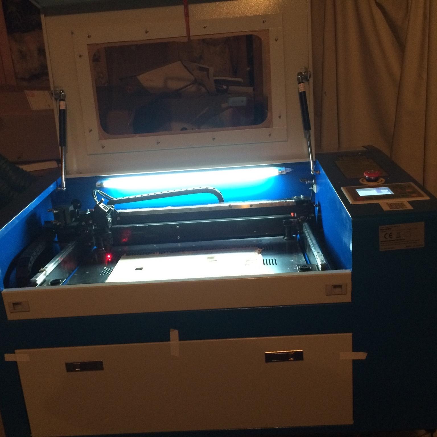

Hello guys got my machine and will be putting it together over the Holiday weekend, I am excited to try it out and see what it can do, I will let you guys know how everything goes thanks again.

Pics or it never happend!:beguiled:

My CNC machine the journey begins Attachment 18540

Now I need to know how to use inkskape to design with my machine
Re: I need Help I need to get a decent CNC machine don't have to much to spend
Remember to treat temperature of coolant as essential if not fitterd fit a thermal cut out to coolant system, and use minimum required power to maximise tube life, 30 minute running hot or over driven can kill the tubes. Also buy the laser quality MDF and PLY as they cut easilly compared to standard products also maintaining tube life.
