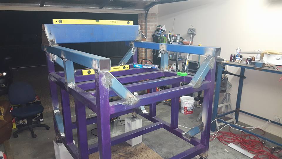

Hi guys,
Dave here. I'm designing a new machine for the office in the hopes of carving precision rifle stocks (4 axis) and whatever else is required from hardwood and aluminium. :)

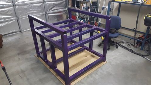

The build is already underway and frame currently ready to be painted.
Details of the build
Linear bearings: SBR20 fully supported rails - X:1300mm - Y:1000mm - Z:450mm
Ball screws: RM2005 Chinese - X:1350mm - Y:1050mm - Z:500mm
Steppers: Nema23 - 23HS45-4204S
Drivers: M542H
PSU: 48V 600w DC
Frame/Chassis: 65x65x3mm box steel
X axis chassis: 75x75x4mm box steel
Gantry cross beam: 200x100x5mm box steel
Gantry supports: 300x125x10mm steel angle
Z axis supports: 200x480x10mm steel plate

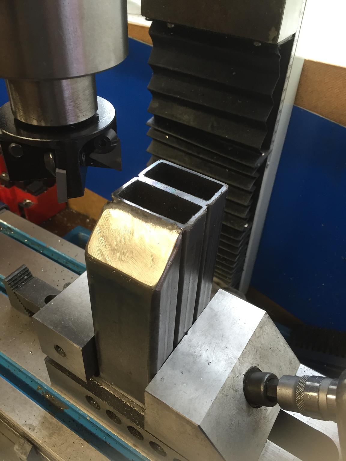

Contrary to most builds on here I do not have a CAD diagram to show as the build is a running design at present. I have very little CAD skills unlike my wife, who regularly makes designs in Solidworks.

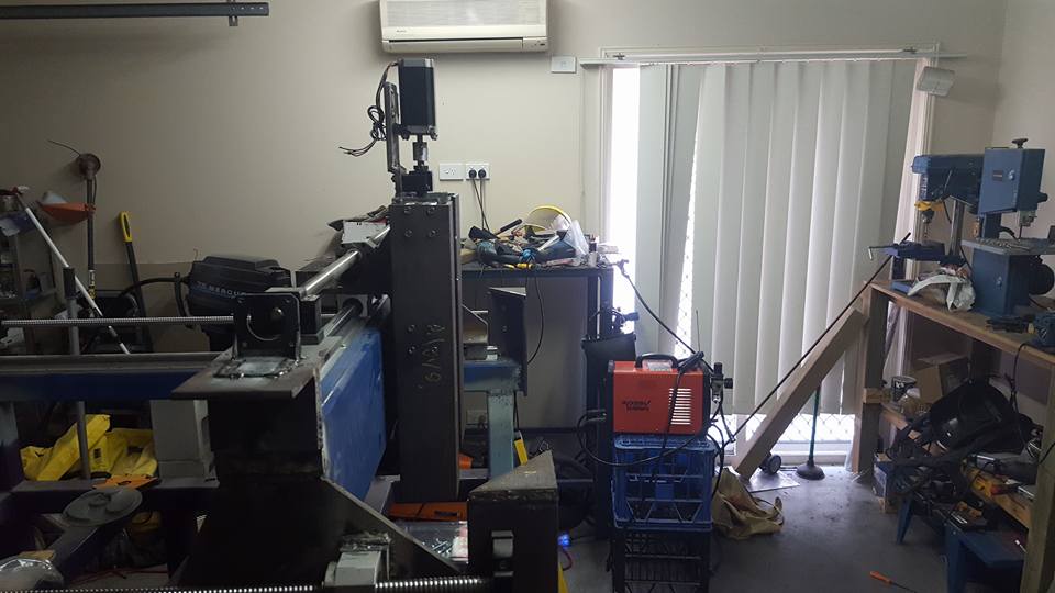

Here's some pics of the current build:
original design
Attachment 18672

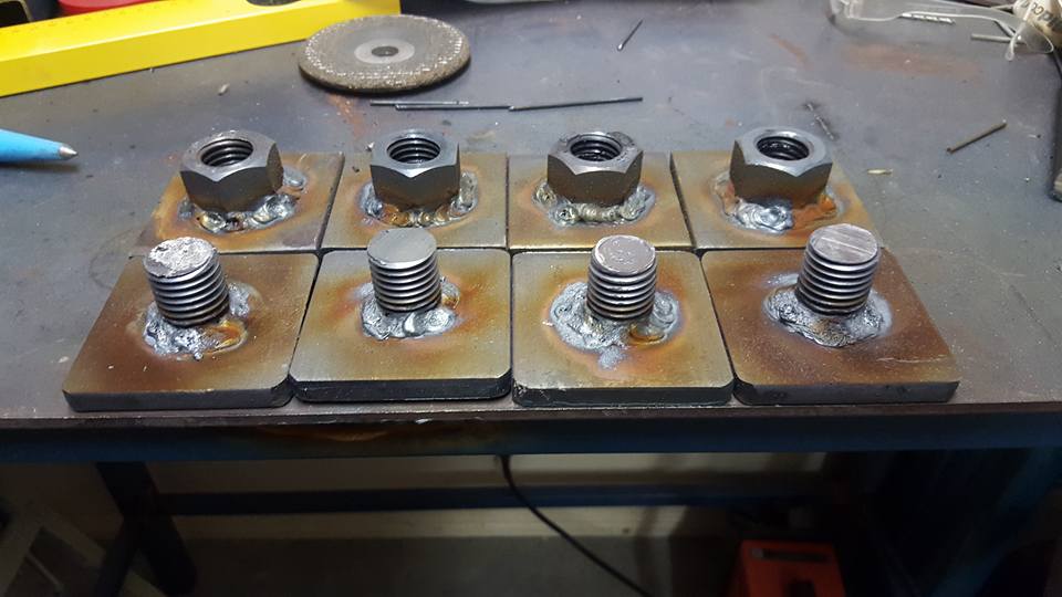

Adjustible feet
Attachment 18671

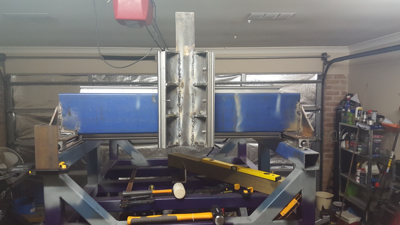

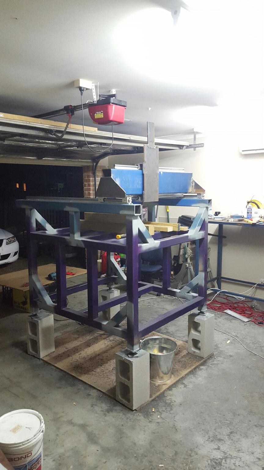

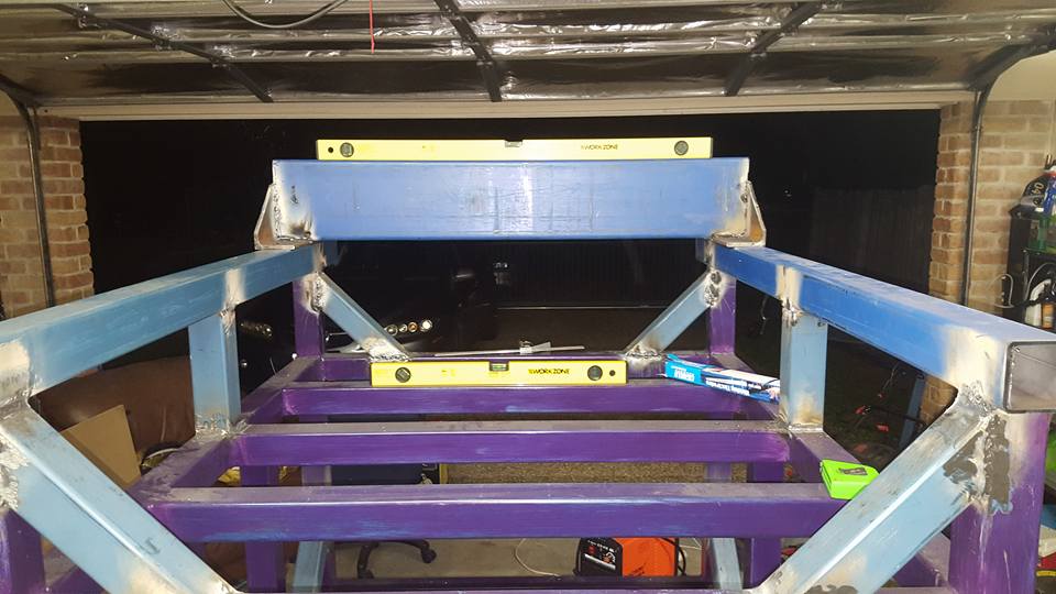

Front on view - all level within ~1mm
Attachment 18673

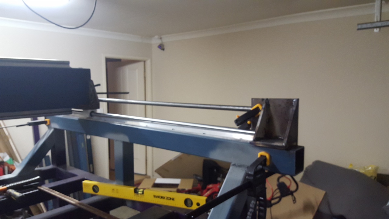

Side view
Attachment 18674

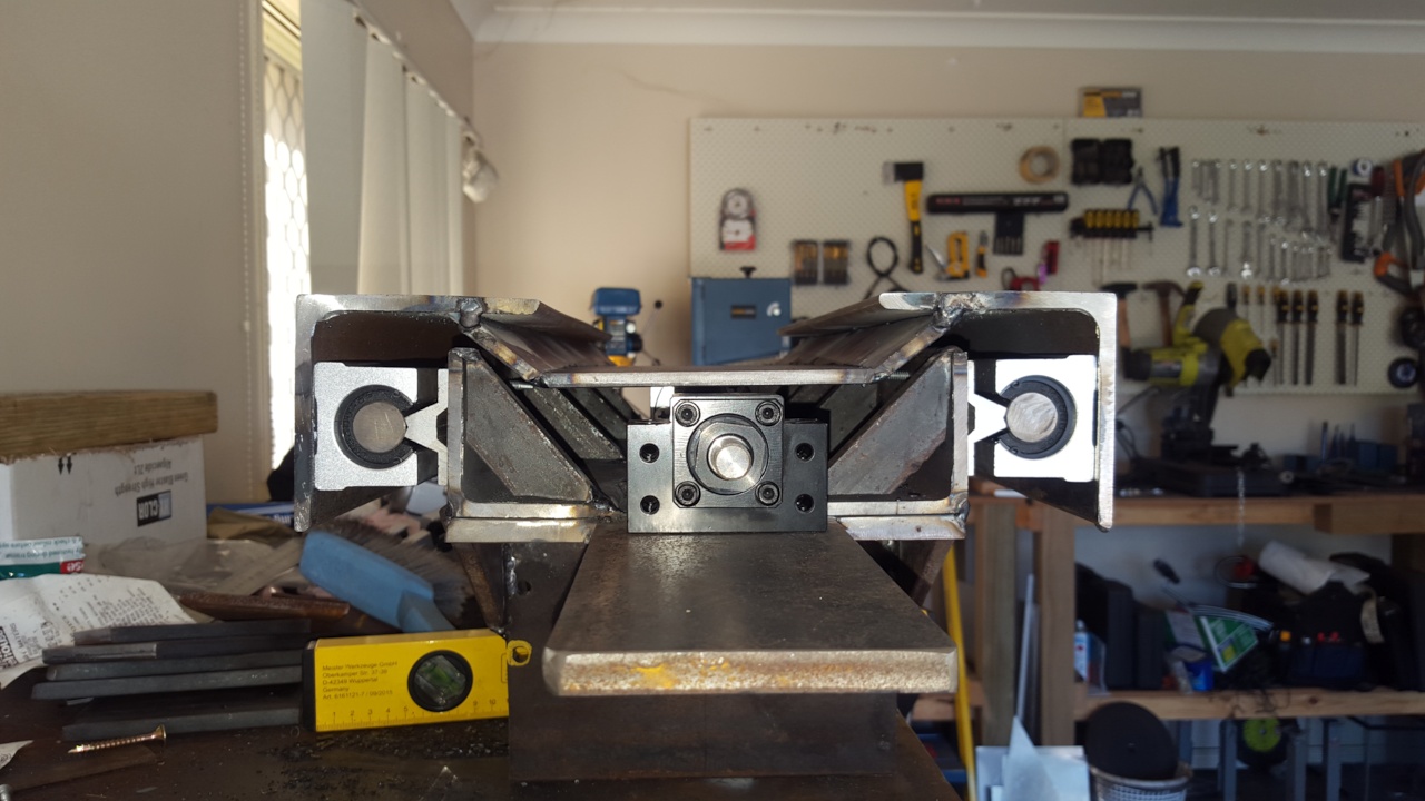

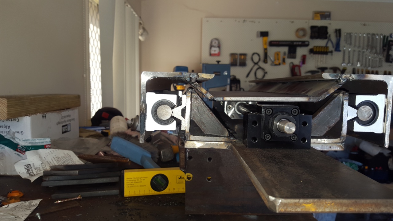

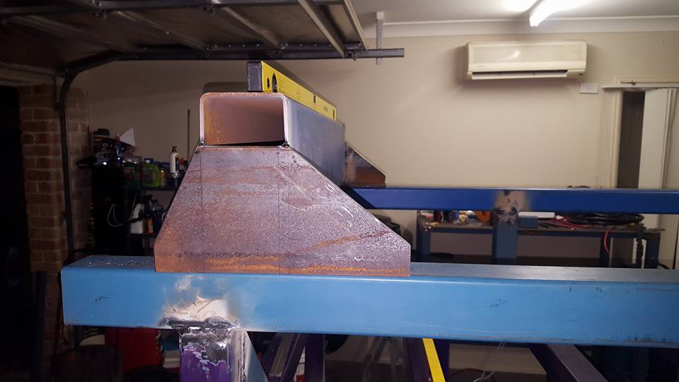

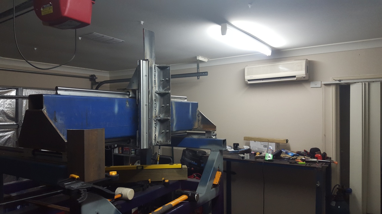

Z axis setup.
Attachment 18675
Gantry side on.
Attachment 18676
Anyway, thought i'd share guys. let me know what you think. :)
- Dave.

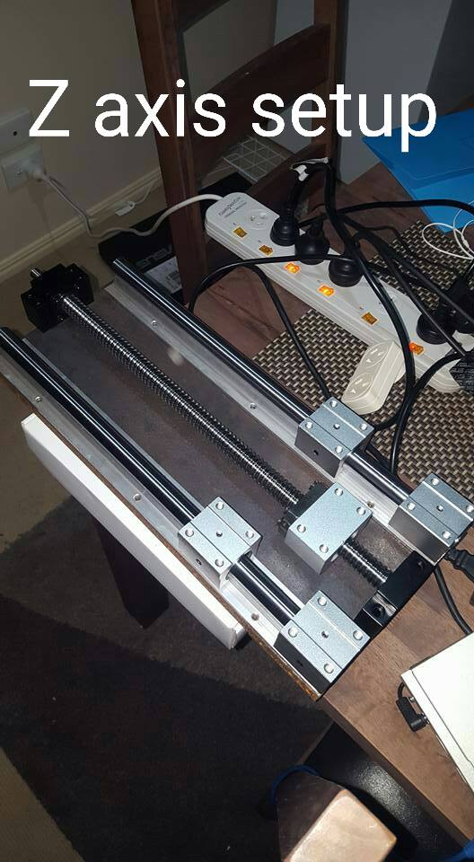

Ok. Z AXIS design time. What is the acceptable leverage ratio of a sturdy Z?
My length of linear rail is 450mm. I was hoping for 300mm
Of cutting depth but it seems like there would be excessive difficulty keeping my Z cutting straight with a 150mm (1/3 ratio) binding area for the spindle on a 450mm run. What do you all suggest?
Also, would be wiser to mount the linesr bearings on the spindle plate or on the gantry plate?
Re: New build - Steel - 3 Axis initially then conversion to 4 axis.
Rails on the spindle plate. To make a variable lever. Bearing blocks spaced at 50% of z travel and as wide as possible.
I'll let the resident experts correct me if I am wrong. I'm still drawing up my design. However, this is my understanding.

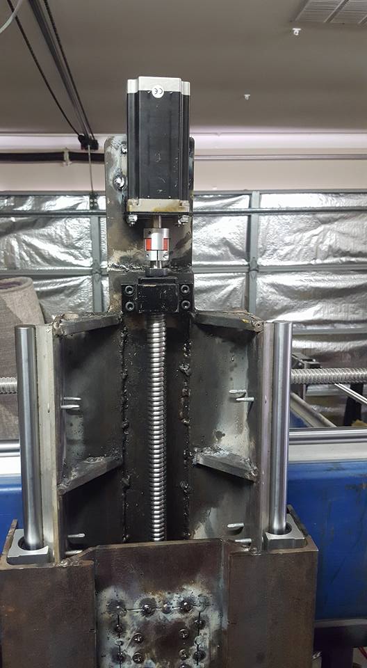

Z Axis finally fitted and relatively smooth with motion (No racking), Some filler welds will be done in the coming days and the wiring should be done shortly. :) I'm finally starting to see it all come together. I wasn't really sure if my Z design would work, but it seems extremely rigid. Although I've lost 100mm of travel on the Y axis I've maintained a good center of gravity on the Z axis and increased the X axis work area.
Hopefully cutting in January!
Attachment 20049Attachment 20050Attachment 20051
Nice concept of Z axis, only problem is that doesn't allow for any adjustment other than shims. How smooth it travels up and down?
Asking as I machined similar stuff on chinese mill and wasn't parallel.
Same thing for entire machine - you are mounting rails directly to profiles - no machined base, no epoxy for leveling (parallel, squareness?)
I do not criticize you - just wander if you aim for accuracy in your machine.
Tom J
Pretty smoothly. I do have a video of it turning by hand..
https://youtu.be/lEZzJ3c4UJA
I think the reason for the success in motion is the heating of various sections during the fabrication process.
I like working with steel because it warps and moves when heated.
When designing the Z most of the welding occured on Job with clamps. As the steel heats and warps it smoothly contours around its pressure points. I.e: the fasteners on the bearing blocks and the tension applied by the SBR25 rail.
Not to mention meticulous time spent hammering the fudge out of it at times :) the outer walls were hardest. They have a slight warp in the 6mm and needed lots of bashing and even driving the car over it.
Cutting a square for the ballscrew bracket was the best idea. As it allowed me to drill it then weld it back in with just the tension of the ballscrew to warp to.
There really was no other way though. Accessing the correct drill points would have been almost impossible to get right as it was completely blind.

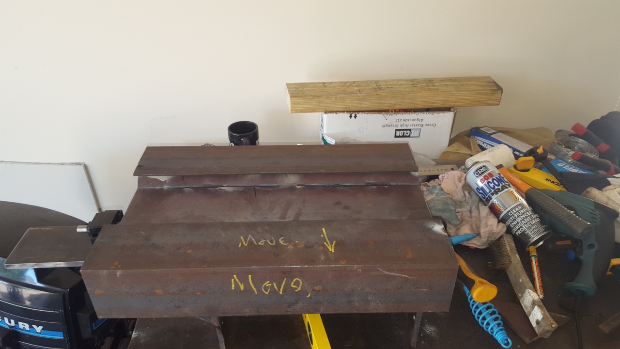

Sent from my SM-G920I using Tapatalk

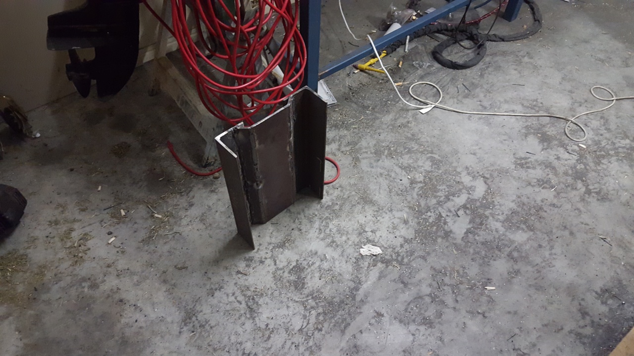

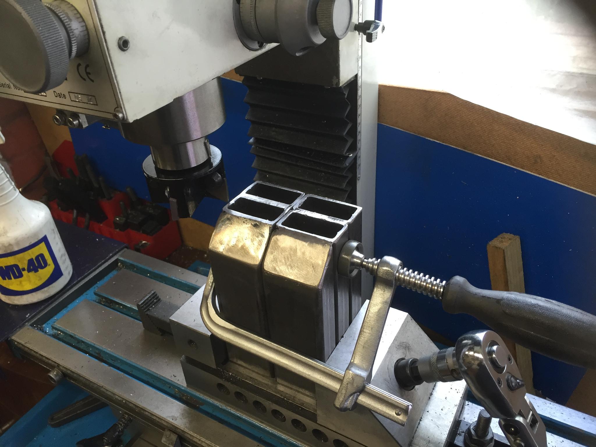

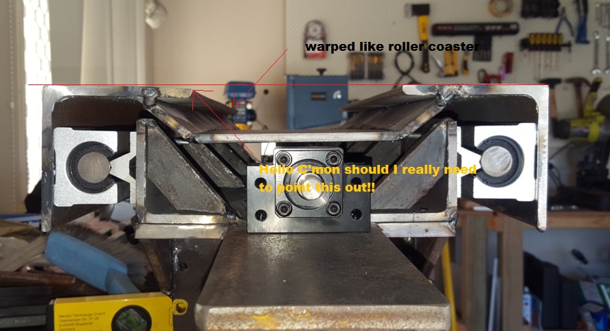

My first bed was ok till I weld those flat bars 8mm thick - it warp badly in the middle
Attachment 20096Attachment 20097

Looking goid mate! Tack welds are the way to go. And lots of clamping. I would have got a piece of say 35x70mm box tube and clamped it in several places to the flat bar piece you were working on. Then going from the outsides in to the middle as your box frame will also slightly warp from the welds. Tack everything first then repeat the clamping process all over again with your filler welds.
It's hard with long runs like that. Partly the reason bojan S uses C channel for his bed. Although I find welding much easier, drilling and bolting would have given a better result.
Whats the link for your thread?
Good job your using round rails because wouldn't get away with rough work like this if using Profiled linear rails.!!
Tom is correct your level of accuracy will be low or will require lot of shimming and tweaking. How much will only come to light when finished and being used at which point you'll wished you'd took little more care when building.:thumbdown:

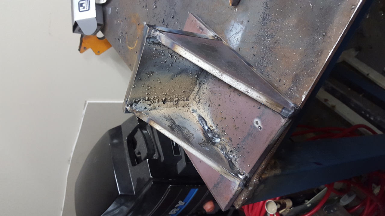

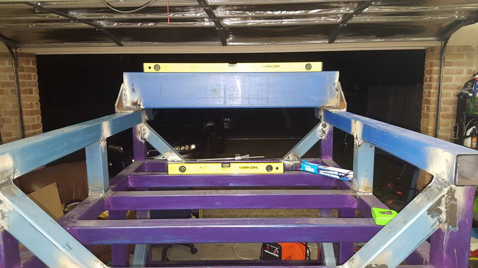

My frame was not more than 1mm warp as I tack it everything and weld one bead at the time, cool down and opposite side and so on. I have to admit that I broke my rule and did not let to cool enough (firstly was warp corners down than after cool opposite) - £100+ waste on steel and gas, lesson learnt. I bit it with sledge hammer, driven by the car and finally filled down, so my 8mm bars became 4mm in places:)
Now I use Tig just to see if I can do better
Attachment 20098Attachment 20099
Tom is correct your level of accuracy will be low or will require lot of shimming and tweaking. How much will only come to light when finished and being used at which point you'll wished you'd took little more care when building.[emoji107]

I could blow smoke up your arse but still won't make it any better when cutting time arrives.:encouragement:
TIG will give a better result but will still warp. Either way it can be a pickle when working with steel. I still haven't decided what bed to go with on mine. I will probably do MDF to start with.

Because I'm not blind and can see there's been no machine work done on any of those surfaces or any thought regards rails being on same plane etc.
I've never yet seen piece of angle iron that is perfectly flat or 90deg and you are bolting straight to the face of one.
Then we have the heat put into the metal which can clearly be seen. You can Stitch it with pigeon Shit and beat the shite out of it all you like but it will still be warped or twisted in some way unless you take other steps to correct it.
All these little things will bite and like I've said your lucky your using round rail. Profiled linear rail would just not tolerate this level of in accuracy and bind up solid.
Edit: Just to be anal and prove my point look at this picture and tell me whats wrong.?
Attachment 20107
Attachment 20107
You are referring to me shaping it? I don't see the problem? what are you suggesting? (genuinely asking)

In post #32 the Z bearings are trapped between the fixed distance between the angle iron sections. This means they cannot sit naturally, or have any pre-load control, and you can't adjust it either.
I'm guessing you welded it together with the angle iron bolted to the bearings? If you release the bolts into the Z bearings do they slide out easily from under the Z axis (which is what you want), or does the Z axis 'spring away' or 'close up'? Ideally this should be a nice gentle fit onto the bearings , or possibly have a slight bit of pre-load.
routercnc
When welded they werent bolted on. Just the outer frame clamped onto both sides with pressure applied. When loosened there is slight rubbing on the bearing blocks but minimal force is required to remove them. If on an angle they scrape and fall straight out. The bearing holes were drilled afterwards with bearing blocks on the rails with no tension. The rear of the bearings were coated with steel blue and the top casing was slid over the bearing blocks creating the guide for my bearing block drilling die I'd made.

Oh so your YES man well tough luck because if it's shit you'll get told it's shit by me.! . . . . Like wise if it's good I'll say so as well but I see nothing here that's good.!
To be fair I've been very kind on what I've commented so far, mainly because not got full week spare to list all that's bad.!
Slixxor
Nothing to do with shaping and every thing to do with being warped and surfaces not on same plane. Then generally just weak poor rough arsed engineering which for CNC won't cut it.
Just because your using steel doesn't mean it's stronger. If the design is weak and poorly built which this is then doesn't matter if built from 2" steel material or 0.1" aluminum (note Ref in American just to so can understand . .lol) you'll never succeed in achieving accuracy or reliabilty.
Look again at this Pic for just few bits of whats wrong.!
Attachment 20111
