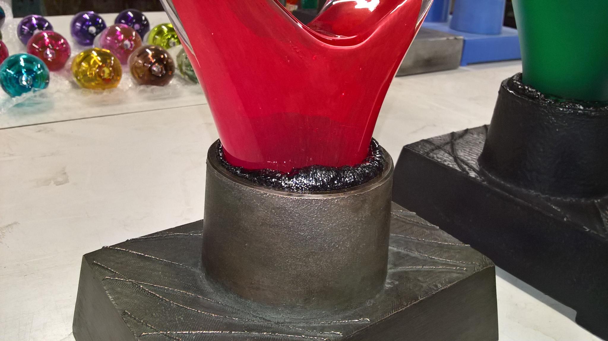

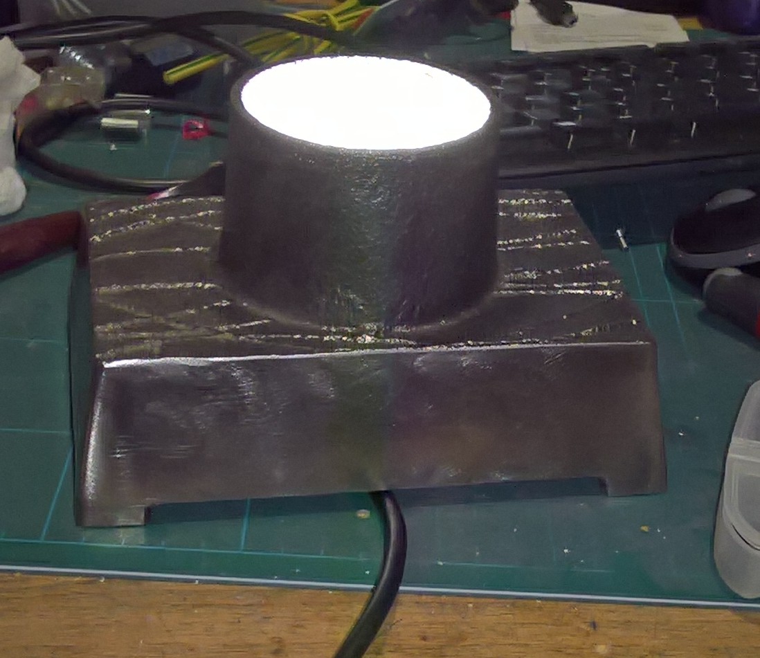

    I need some guidance on electrical safety of products rules. I have made a lighting base for a glass sculpture. It is a sealed LED driver and a 20W LED chip on a heatsink. There is a fuse in the mains side and the mains cable and switch are purchased prebuilt. The cable is with an earth wire and the driver is earthed to a common point on the terminal block, which is connected to an aluminium base plate. I cut the base plate on CNC and there are plenty of ventilation holes, but strategically placed so that it is difficult to reach a mains voltage through them. The sculpture base is either bronze or cast iron and it has the base plate bolted to it. I will have the finished units PAT tested, but I am wondering if there is any other official process I have to go through before they are offered to the public.
    The pictures attached gives you an idea of the bases, but one pic was of a failure of the resin embedding of the glass, so doesn't show the base underneath. The second one was a brief test of the lamp.

    If you can poke any household item through a vent hole and get at mains your product liability insurance might not pay out in the event of a child poking a straightened paperclip through a hole.
    Most current products use strategically placed mylar or other physical shielding to make access to mains impossible without making a real effort to cause damage,
    - Nick

    I will put a 3D printed box round the terminal block. I take your point about product liability insurance.

    I'd look at incorporating a thermal fuse into the power feed such that excess temperature (you'll have to research and determine that) will cause power cutoff, also consider crimped tubular terminations for the mains wires at the connector block.

    At the moment, he produces an item http://www.stuartakroydglass.com/new...s/?galAlbum=44 which is a glass sculpture in a solid steel base. His idea was to light it from below with a fairly powerful LED chip. We are at a very early stage in development, with one working prototype. It has to be soak tested to see how the temperature rises on the LED, and to see if the driver is suitable etc.

    I didn't make it clear but my reasoning for the thermal fuse is to use one rated above the temperature which the light unit might reach in a very warm room under normal operating conditions such that the power would cut before anything got hot enough to melt or burn,
