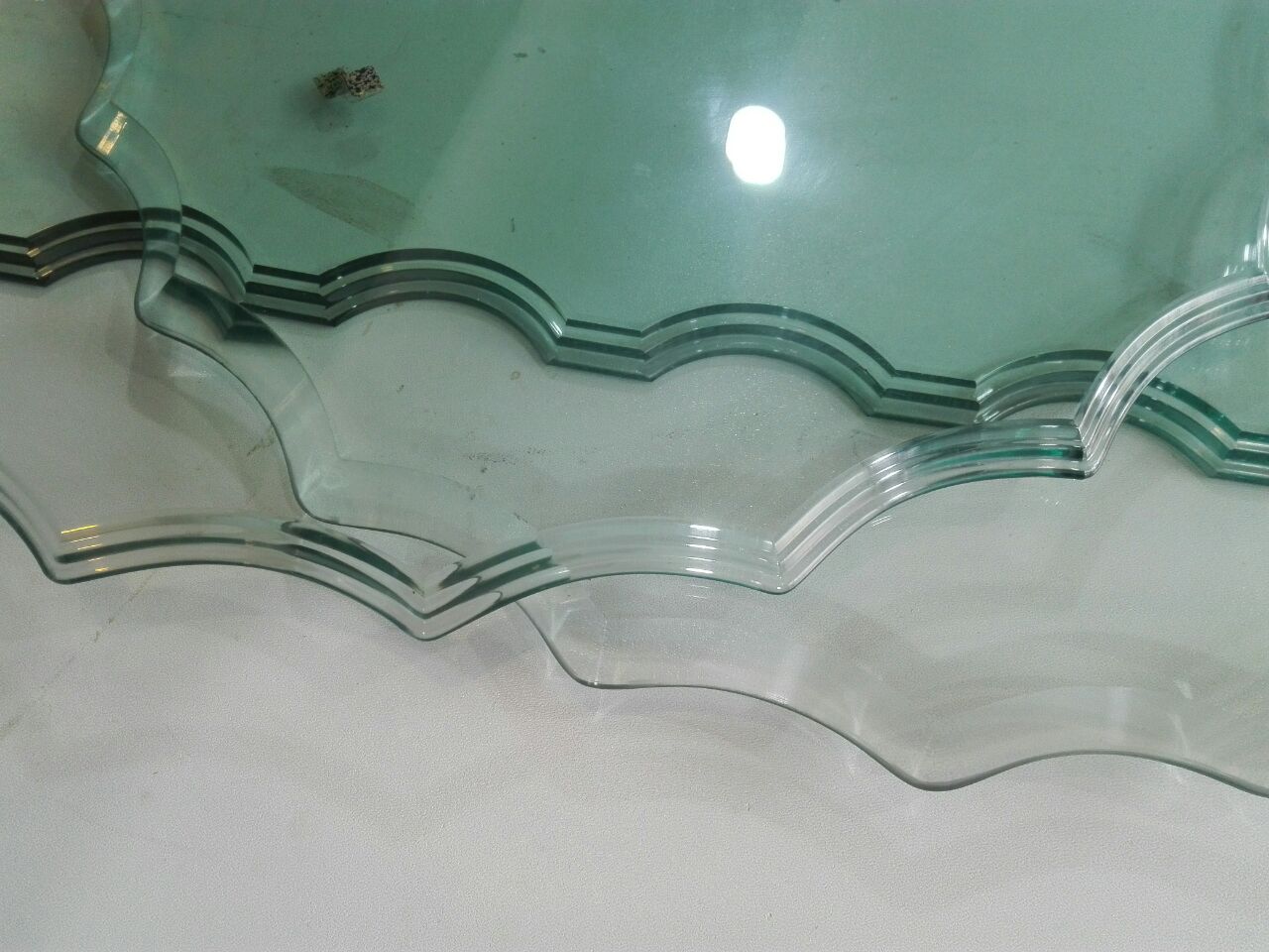

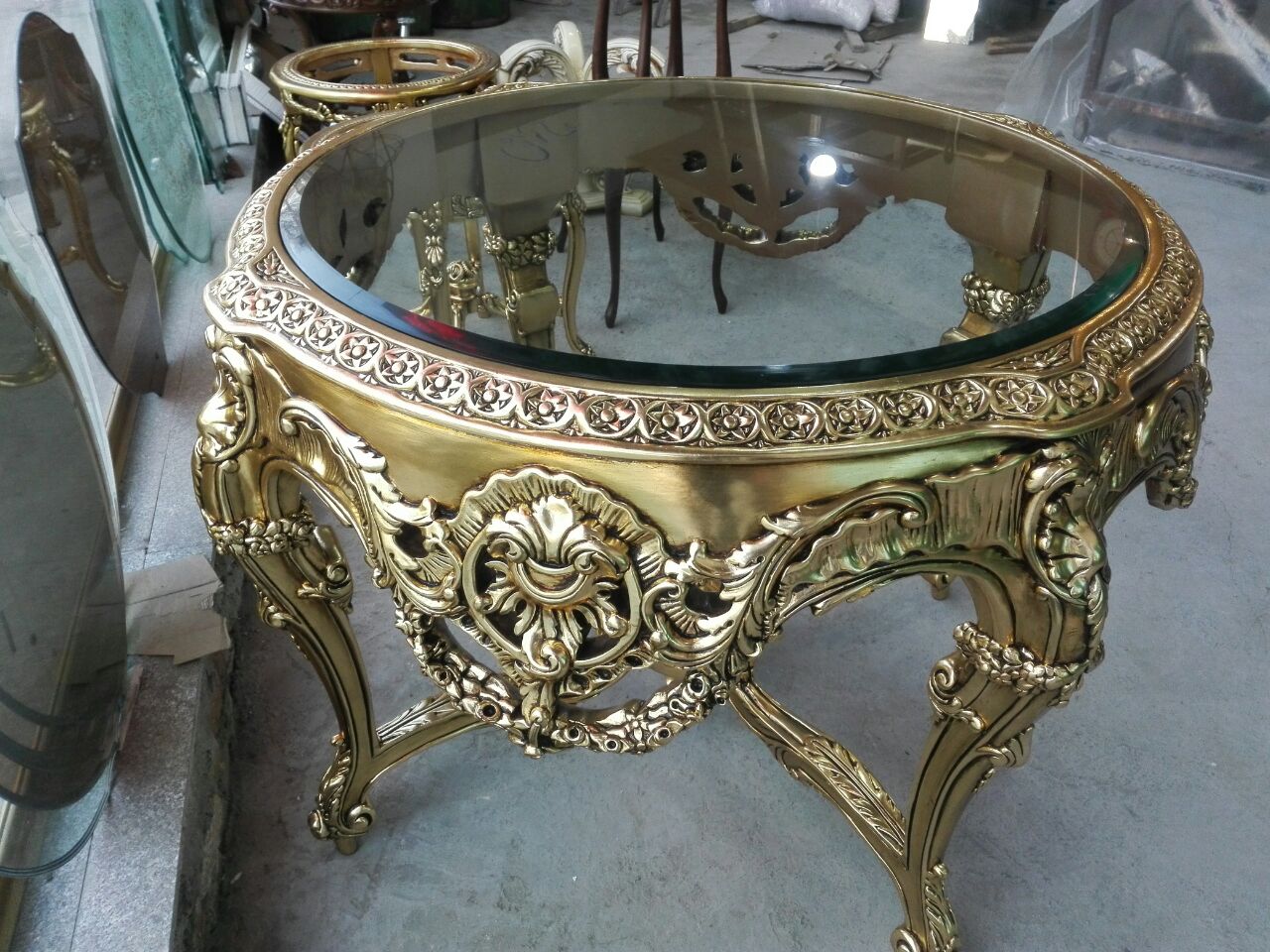

    I have a general question is it possible for a Leaser CNC to Cut the Glass like the ones that I have attached in my attachment?
    if it was Wood I know I could use Profile Cut with right tip. But with Leaser I just do not know.
    Also What are the proper applications in order to Work on Glass? I know for wood ArtCam is one of the best.

    Not without spending a LOT of money, on a very high powered laser.
    The glass in the pictures are ground and polished, which would still be required to get edged like that.

    On issue of Leaser, How about some thing in the range of about 120 W? Would it be enough?
    also on the process itself, I do not think that profile cutting would do the Job, and It must be some sort of 3D relife
    Operation, Could you explain on it, what software do you recommend for it?

    As Garry stated, ground and polished to get stepped edges on glass, not laser.
    Yep, this kind of thing
    https://www.youtube.com/watch?v=z2ysBHglZGw
    (We have 2 of these at the place I work)
