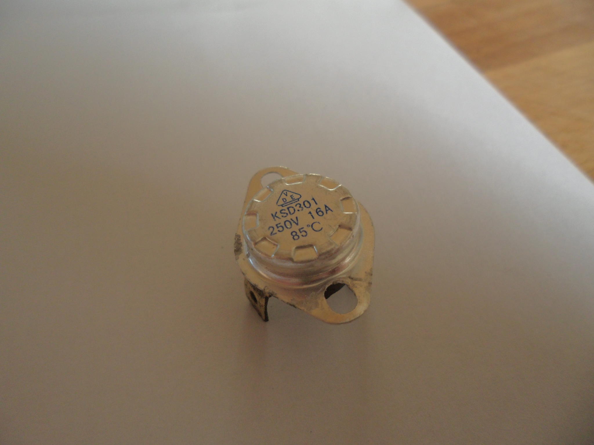

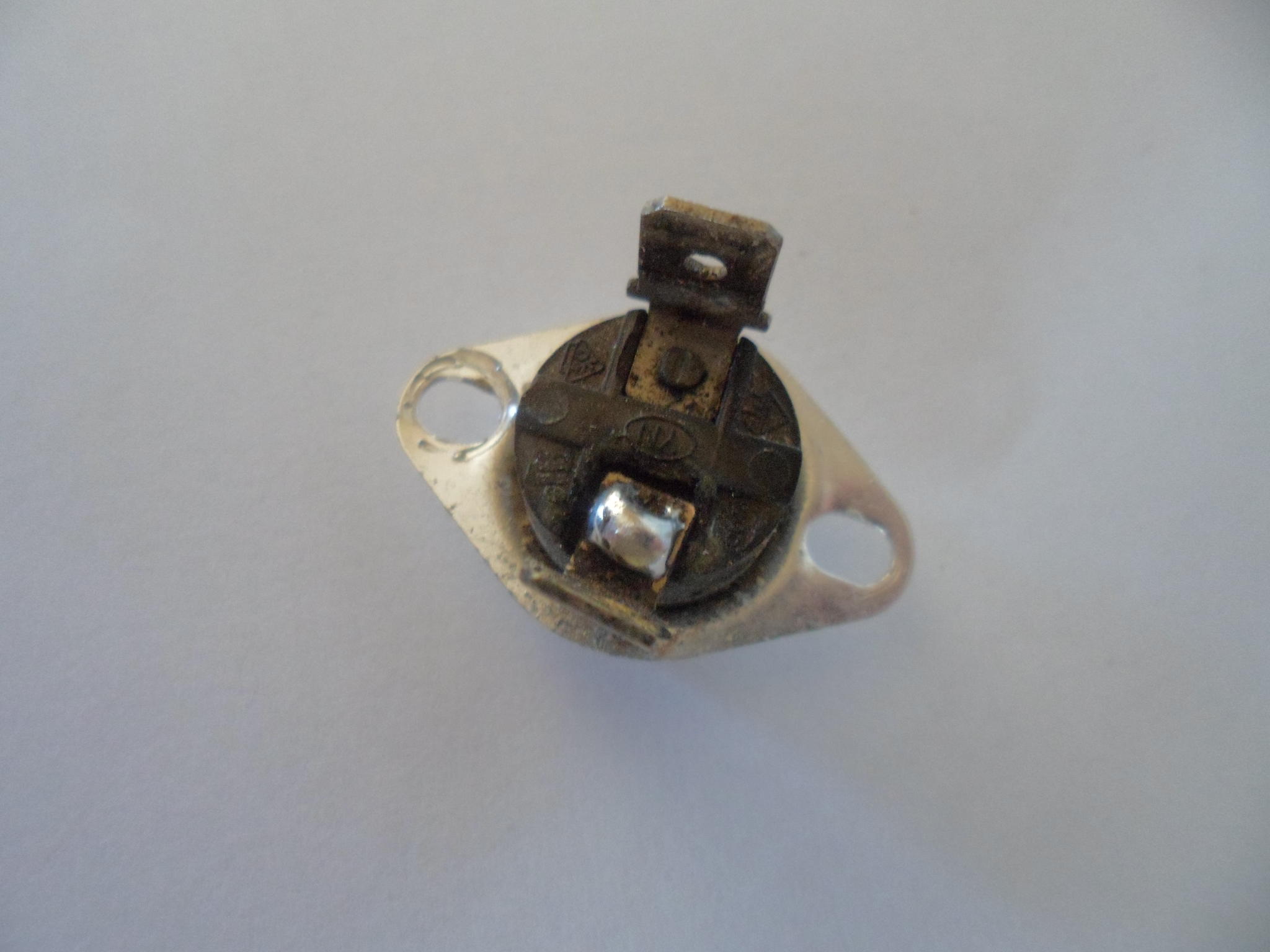

    please can anyone tell what this is
    its out of my workshop heater
    markings on it VDE in a triangle
    KSD301
    250V 16A
    85 DEGREE C
    where can I buy one from
    Many Thanks Geoff
    I suspect it's a thermal fuse and what it came out of isn't working?
    If I've guessed correctly the thing that doesn't work overheated ;-)
    http://sinolec.co.uk/en/19-thermal-c...metal-switches
    - Nick

    Its an over temp. safety cut off switch. You should be able to get one from RS components or a good Electrical wholesaler
    or http://sinolec.co.uk/en/search?contr...submit_search=
    Bi-metallic thermostat. Will carry up to 16 amps and opens at 85 degrees centigrade. Safety device to prevent over heating. They normally close when cooled down again but easily tested with a meter and a boiling kettle or pan.
    thanks everyone
    makes sense what your telling me
    one of the terminals looks to have overheated and come lose tried to solder it back
    looks like a bad contact and caused the wire to overheated and become corroded
    need to buy a new one thanks Geoff

    part ordered delivered today
    fitted to heater works great no longer freezing my bits off
    once again thanks geoff
